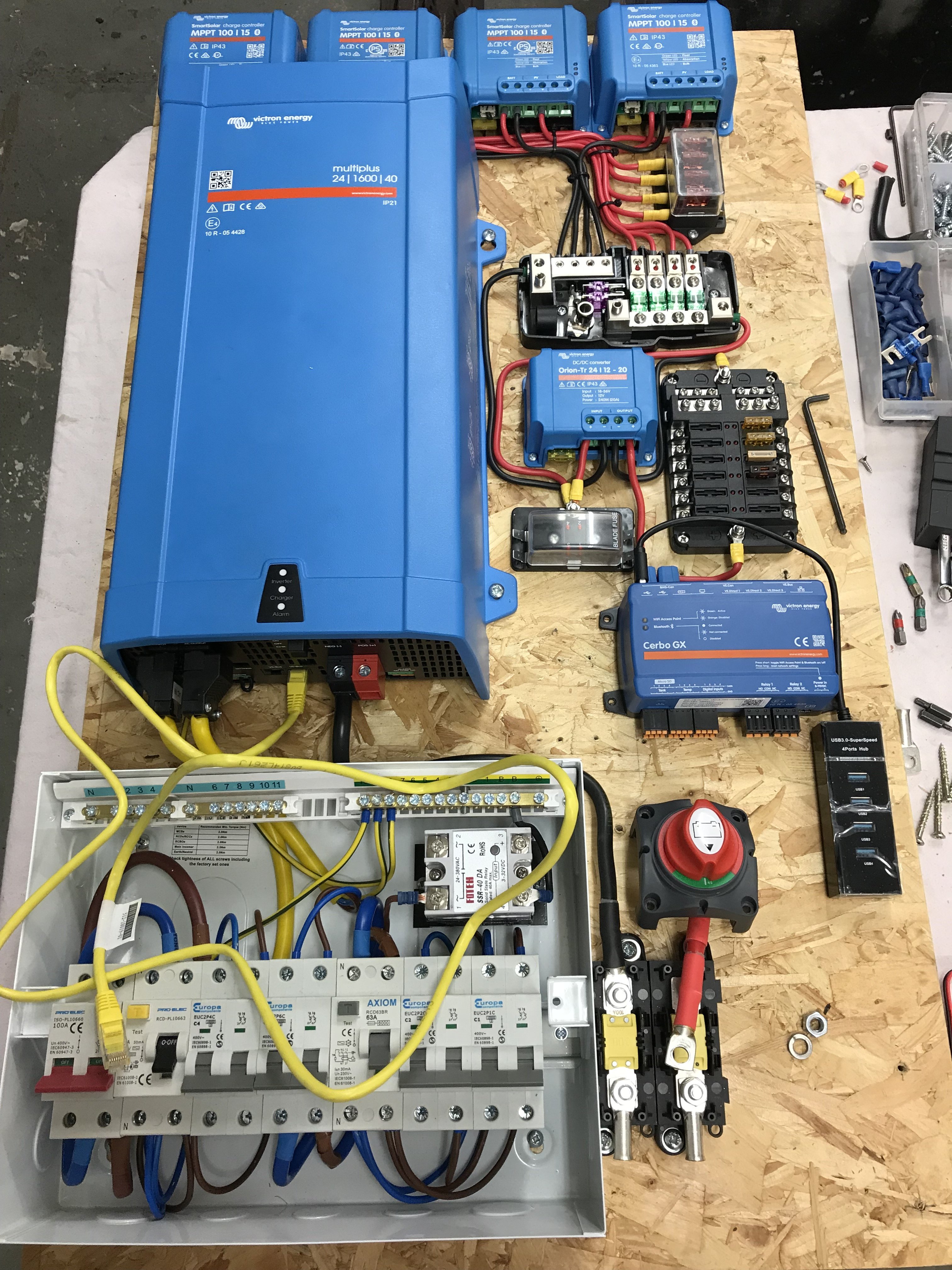

That is very neat indeed (y)
I have just this morning disconnected just about EVERYTHING in my installation to redo. Your cabling is putting mine to shame! (I would post a pic of mine but it would be X-rated for Horror :( ) It's all going to be connected the same again, but look a lot tidier and look more logical now the setup is virtually final (still waiting on my custom programmable VSDR-200 (200A Voltage Sensing Disconnect Relay) as the final piece for the Hybrid Battery but that should be fairly out the way from the rest anyway - hopefully will be programmed and tested in the next week ready to ship to me)

I'm redoing mine primarily to remove some bits and try and get better cooling (I didn't notice before but the 4th battery I added a few months after the original installation is very close to the EasyPlus exhaust vent which I think is both partially restricting its airflow (it was getting too hot to touch when charging at a high rate) and causing the battery to go over 40C with the hot air pushed right at it.
But while that is getting done, makes sense to tidy it up :)

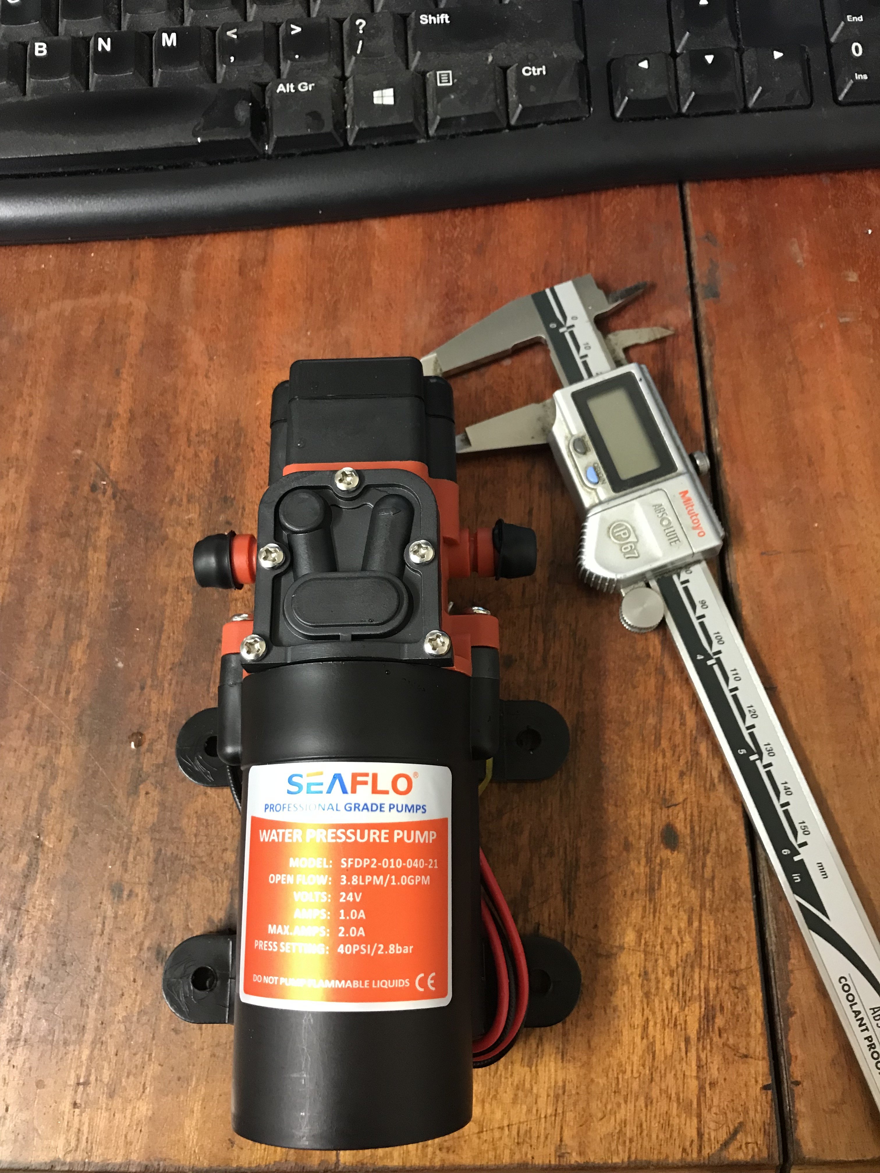

Water pump turned up today, might be a bit big. Should give many years of service though. BTW they did have smaller options.

Just when you think your under control, you end up adjusting things. In an effort to progress this project I decided to make blind leaps based on no experience. Don't do it. Even though I had dimensions and CAD drawings of parts it didn't work. I've had to juggle a few things around.
Make sure to have the bits to juggle with.
Next, connectivity! I have or will have at least five VE direct devices. Three VE direct ports on the Cerbo. So three of them can be taken up with three of the four mppt's. Only three of them will be regularly used for the three arrays of solar panels. The fourth is for an optional external panel. This I think will have to have a VE direct to USB cable. Next is the smart shunt, this again is VE direct. I wonder if the blue tooth will have the level of adjustability the display had? Or can it be set up via the Cerbo? Anyways this will need another VE direct to USB cable, but with an extension cable as the batteries could be up to five meters away. The calorifier will have to be switched via the relays on the Cerbo as the smart shunt doesn't have one.

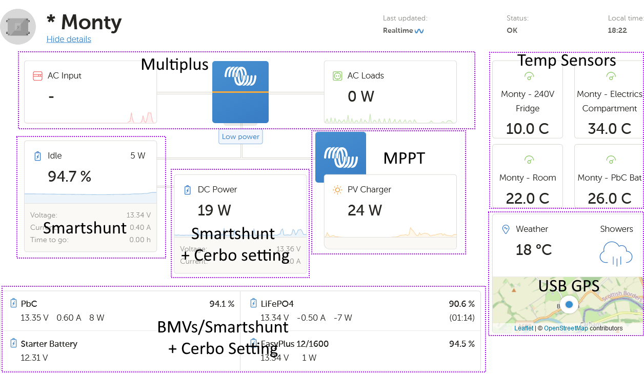

This is a screenshot of my VRM dashboard with the sections in dotted lines and what devices drives each one when it is connected.
If all you have connected so far is the Multiplus, then you are seeing the right stuff.
What you can do if you want is add some dummy devices by enabling Demo Mode but I don't think I would bother if you are getting cables shortly.

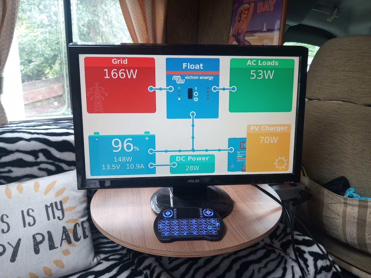

New HDMI cable turned up today, but still no display from the Cerbo. Does the HDMI port need enabling?
I've plugged the display into a pi, still no display as I haven't configured the pi for it. Though the display knows it's connected to something.

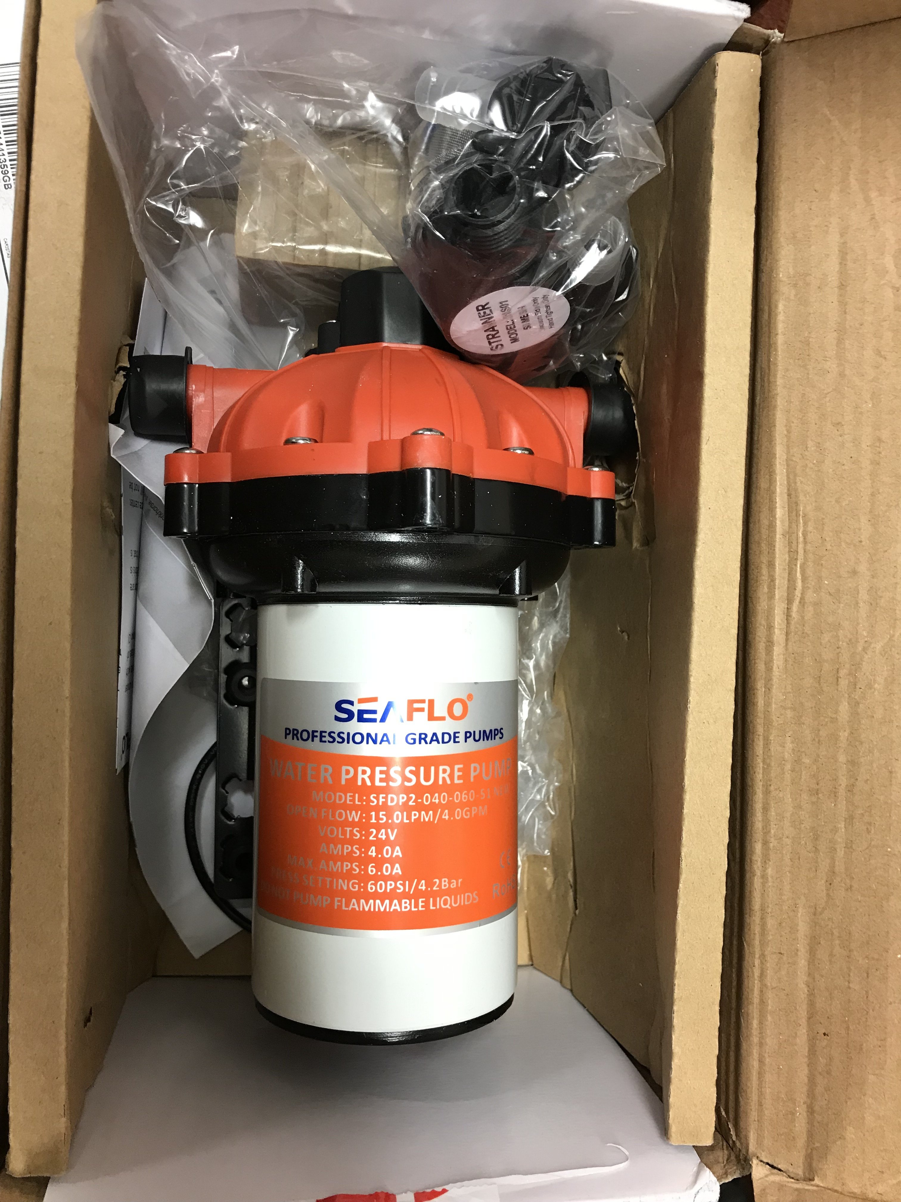

The replacement water pump has just turned up, I think I have gone from one extreme to another. At half the price of the common ones I'll give it a go. A nice big accumulator will help.
I never had any joy with getting a display working on the Pi. like you elude to, you have to mess around with the setup for the Pi and change some code.
As far as the Cerbo goes, it should be a matter of just plugging it in pretty much.
Possibility I can think of ....
The Cerbo's output is a rather small 800 x 480 resolution.
Most screens can cope with that, but you might need to ensure the Screen is already powered up when the Cerbo boots so the screen gets the right 'setup' signal to set the resoution. The 7" screen I use is a native 1024 x 600 and if I turn the screen on AFTER the Cerbo boots, the image is in the top right corner. I tried using the Cerbo with a big computer screen with a 1920 Resolution and that was right up in the top corner, but a reboot of the Cerbo fixed it automatically.
So with everything connected and powered up, reboot the Cerbo and see what happens.
I guess it is possible you have a screen that will just not accept an output resolution of 800 x 480? Try a different screen and see what happens?
How are you powering the screen? the Cerbo HDMI port will not provide any power (just in case you are thinking that? some HDMI ports do I believe?). On the Cerbo GX, the USB nearest the HDMI is designed to provide power for a USB-powered Screen (it has no other use). the other USB ports are likely not able to power a screen.
The screen will work on a pi out the box, it will display something. The standard Venus software is by default in Headless mode which means its not expecting a screen. However it will still output something if connected to the HDMI port in the form of text showing that it is working but not the Cerbo screen. Headless mode needs to be off for that to happen.
Yes life from the pi even without a driver, but nothing from the cerbo. So how we do get the cerbo out of headless mode and in turn get me out of that mode also?

Try plugging in a standard screen with an HDMI connection. This is a screen connected to the Cerbo and sitting on a table top of 50cm diameter ...
