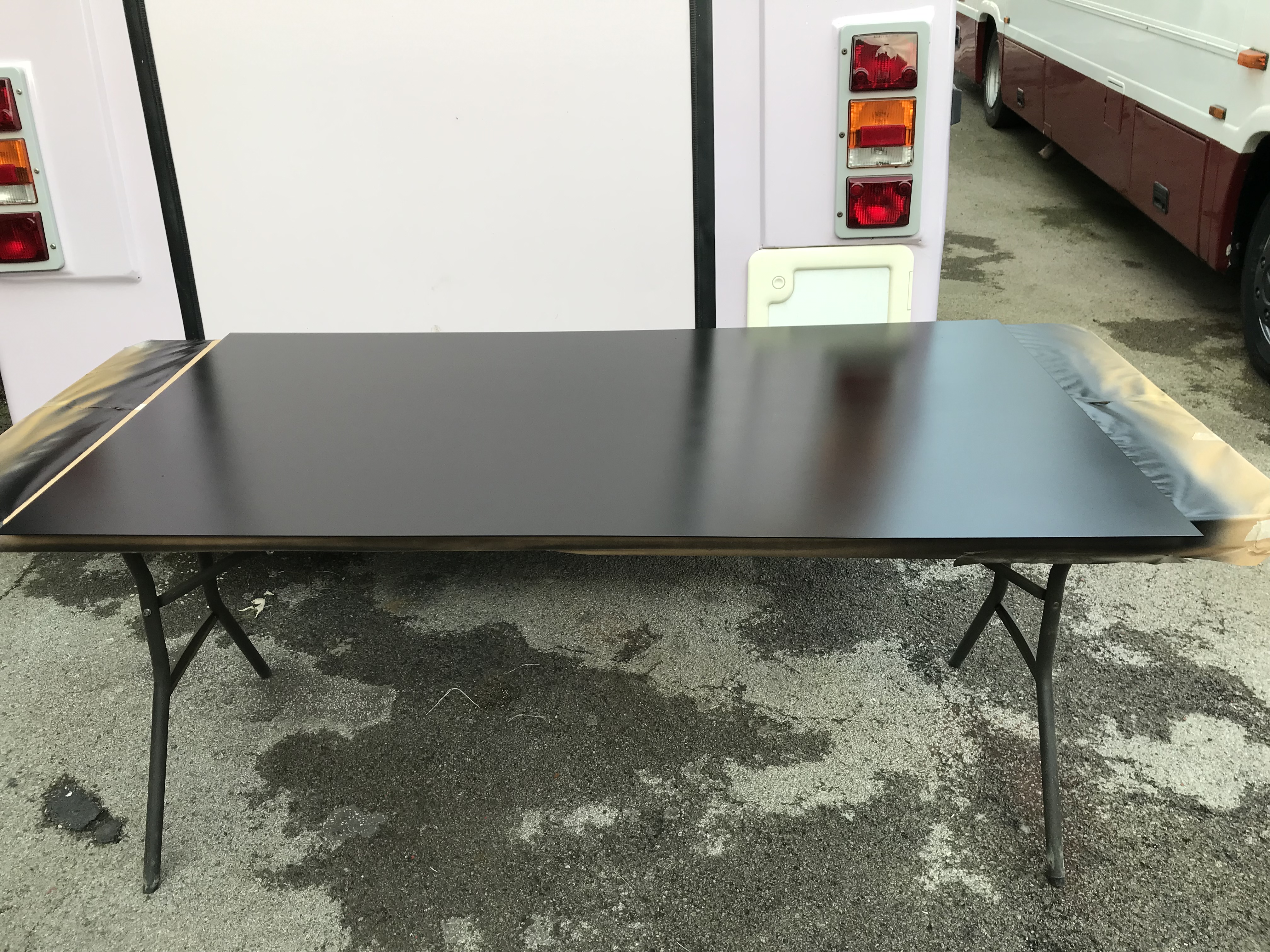

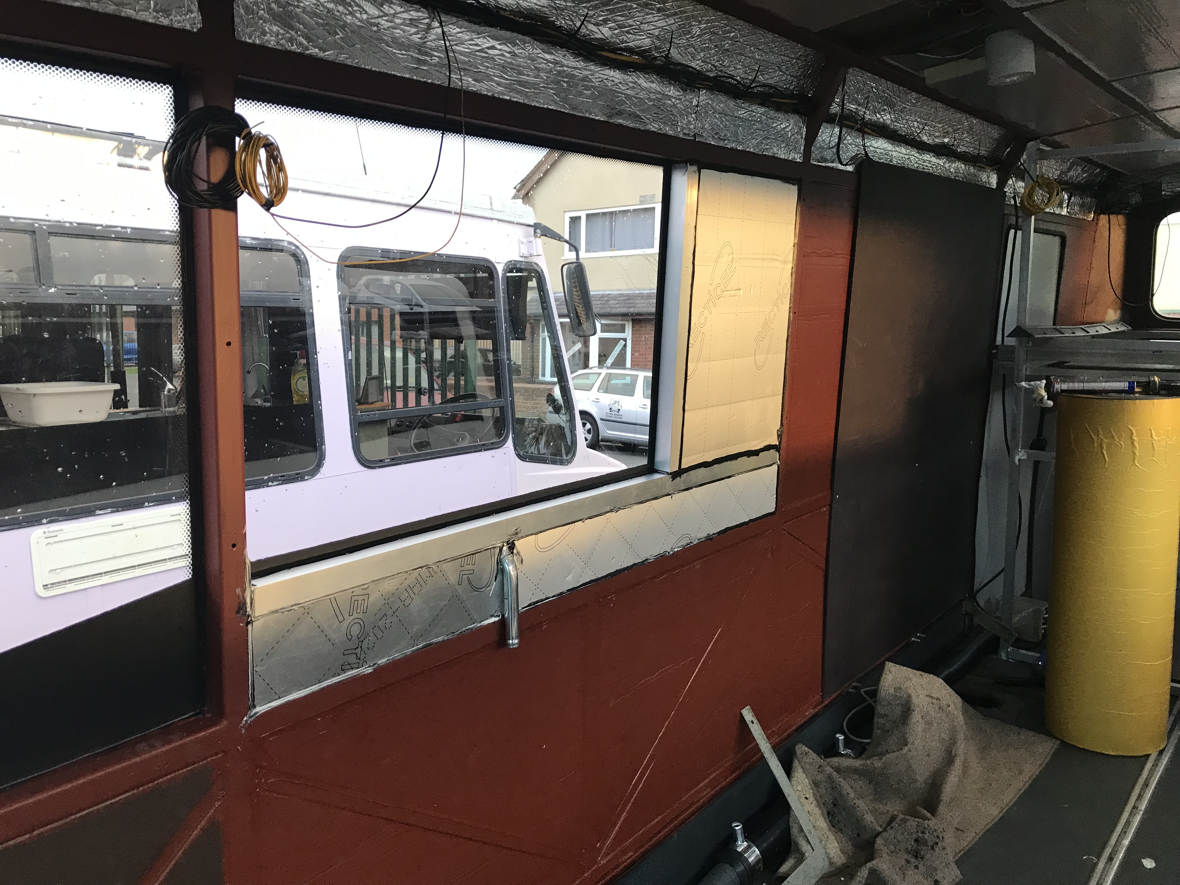

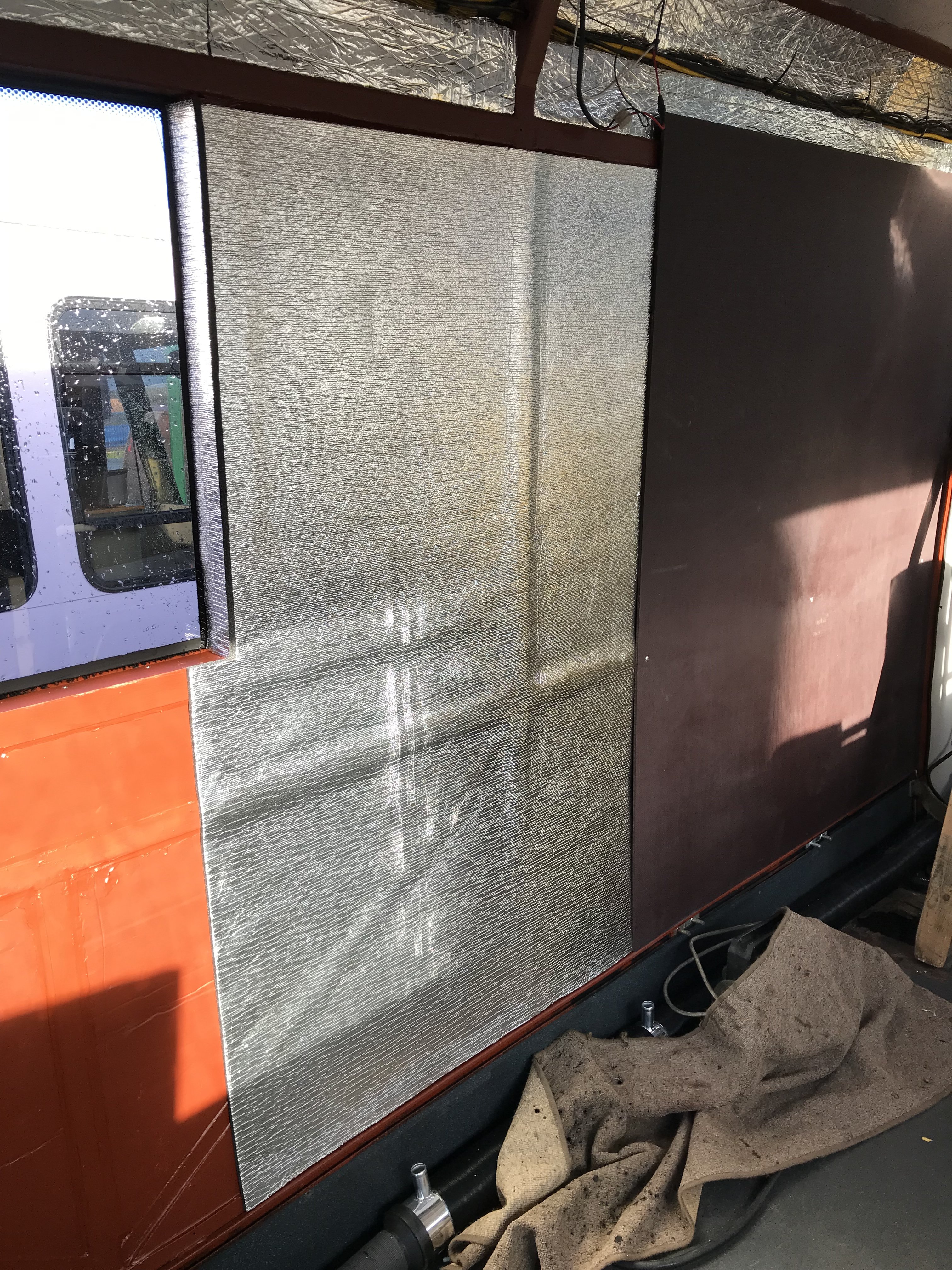

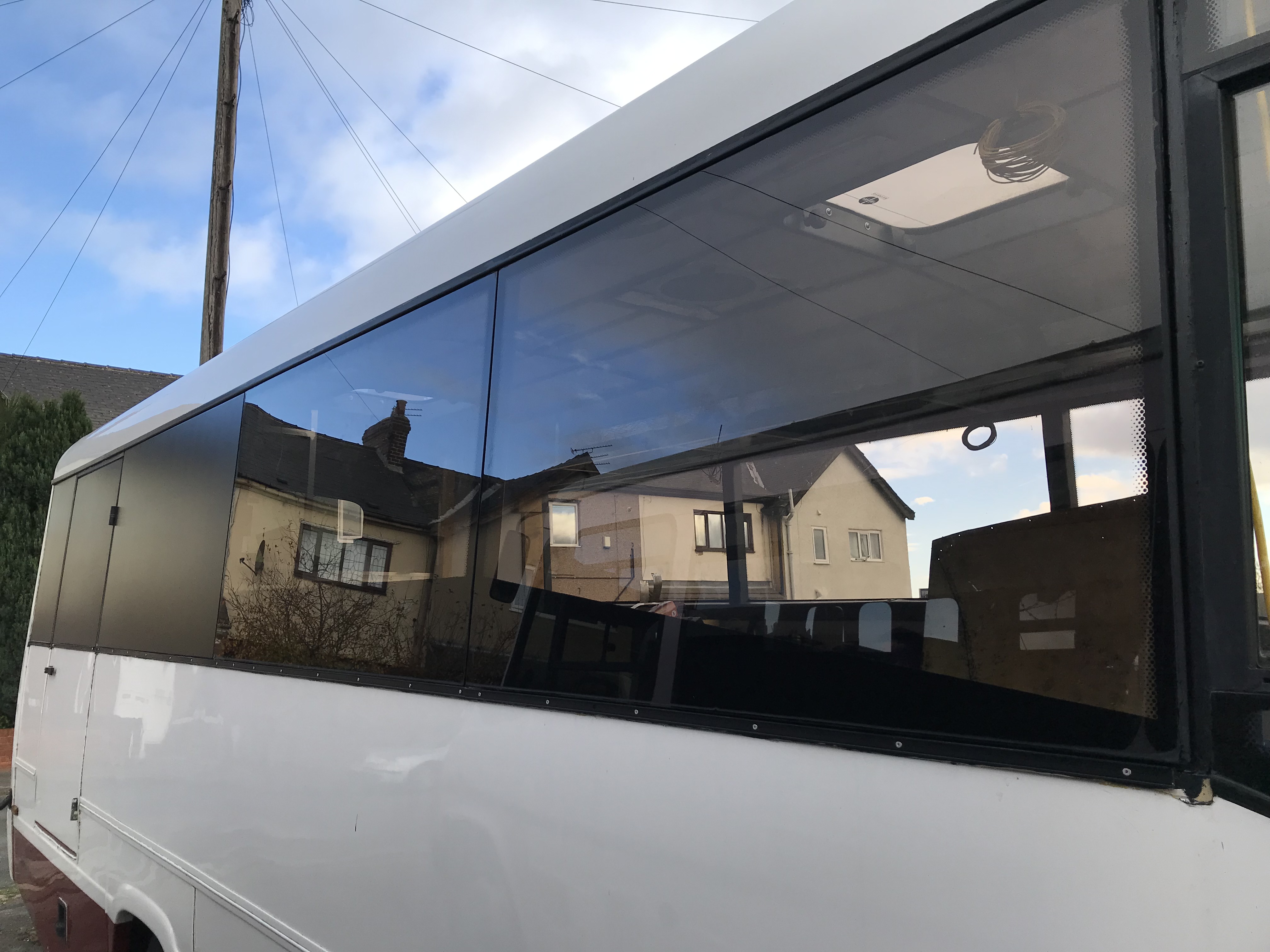

Sometimes weather conspires against you. A couple of weeks ago I had some new window people remove some more glass. Very quick and the glass was intact. Better than me :( Then it rained and of and on continued to do so. Making it very difficult to repair the frames. The other problem was painting the aluminium panel for the shower room. This I had to do outside due to lack of space. Finally got it done today, fly’s, oil spots and the wrong paint. I asked for semigloss and got textured. I thought on the first two panels I painted it was me, but no it was the paint. Oh well only sad people will notice. I just need to clean the mastic of the glass and call the window people to fit them again. Slow progress, but still progress.

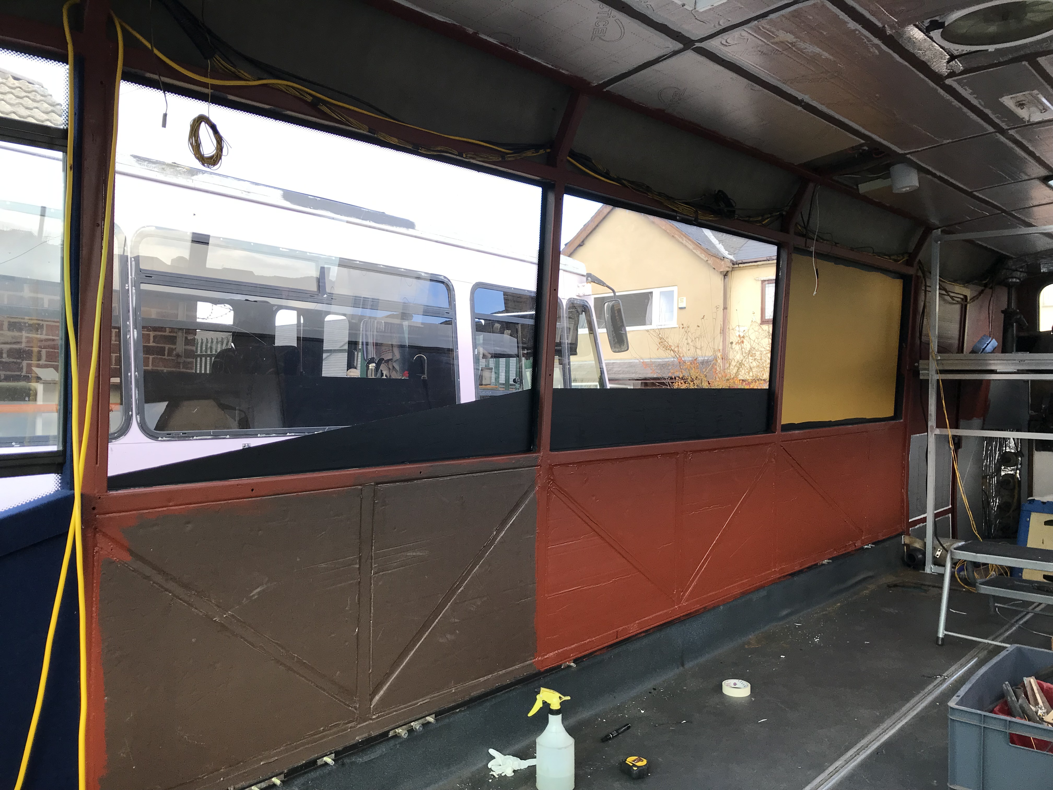

It doesn't seem like a lot, but it feels like a big hurdle cleared to me. Now that the glass and aluminium panels are in place I can continue to insulate that side and think about building the shower room / WC area. I have already blacked out the lower part of the windows to allow for better privacy and to install the demisters. Being a lot of inside work it also limits my excuses for not doing it. ;)

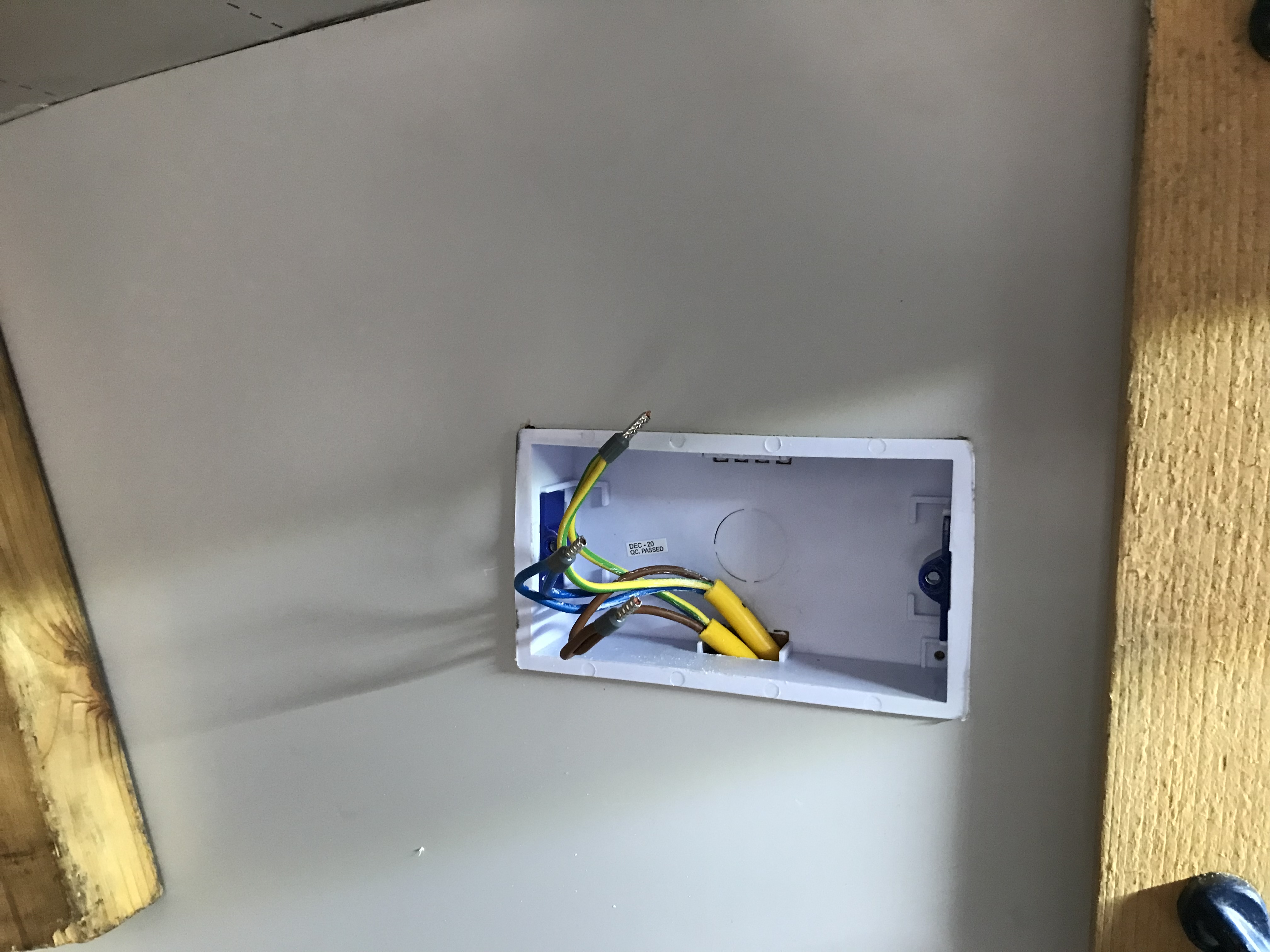

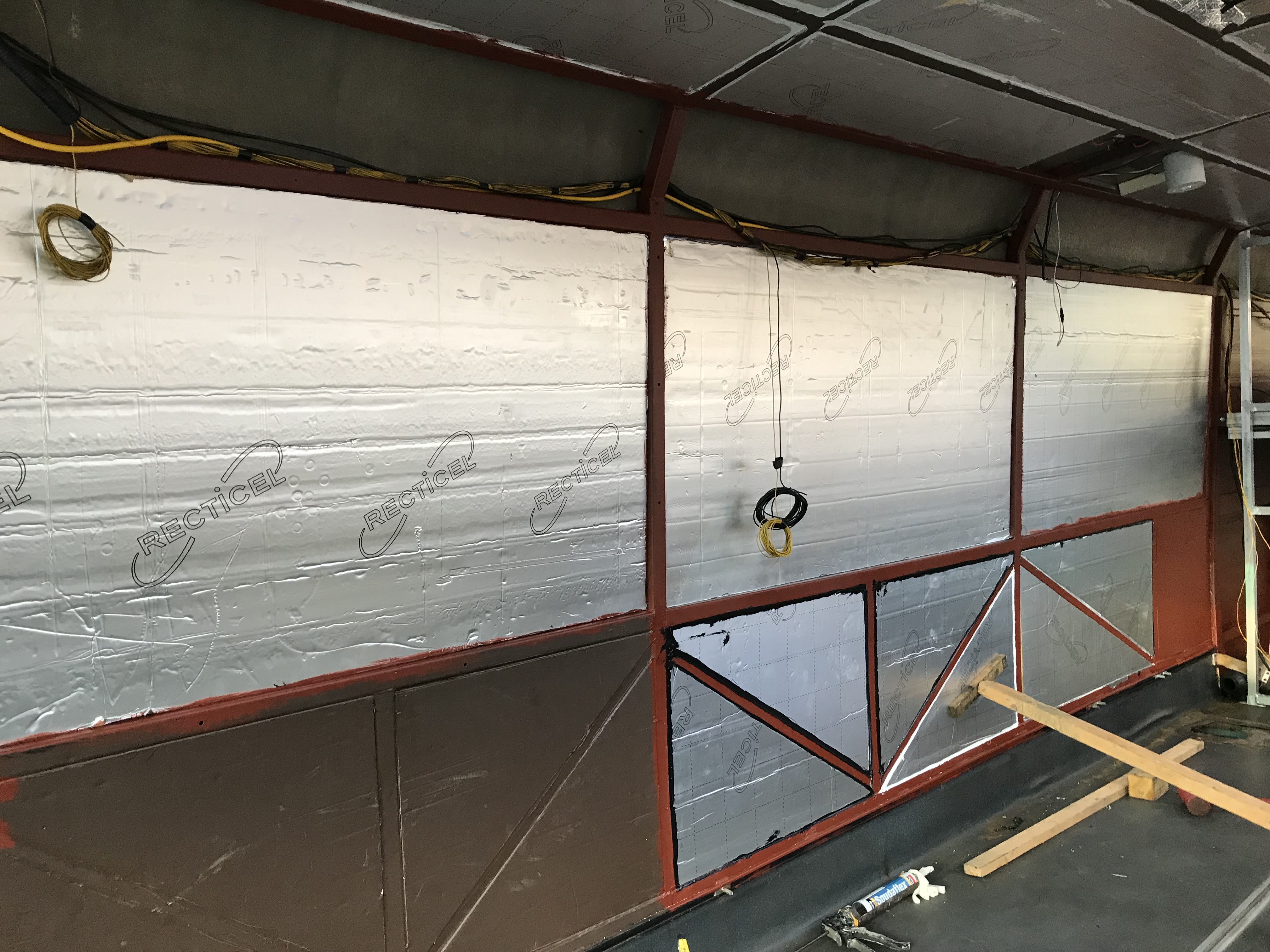

I realised that some panelling hadn’t been bonded, but before that insulation and wiring was required.

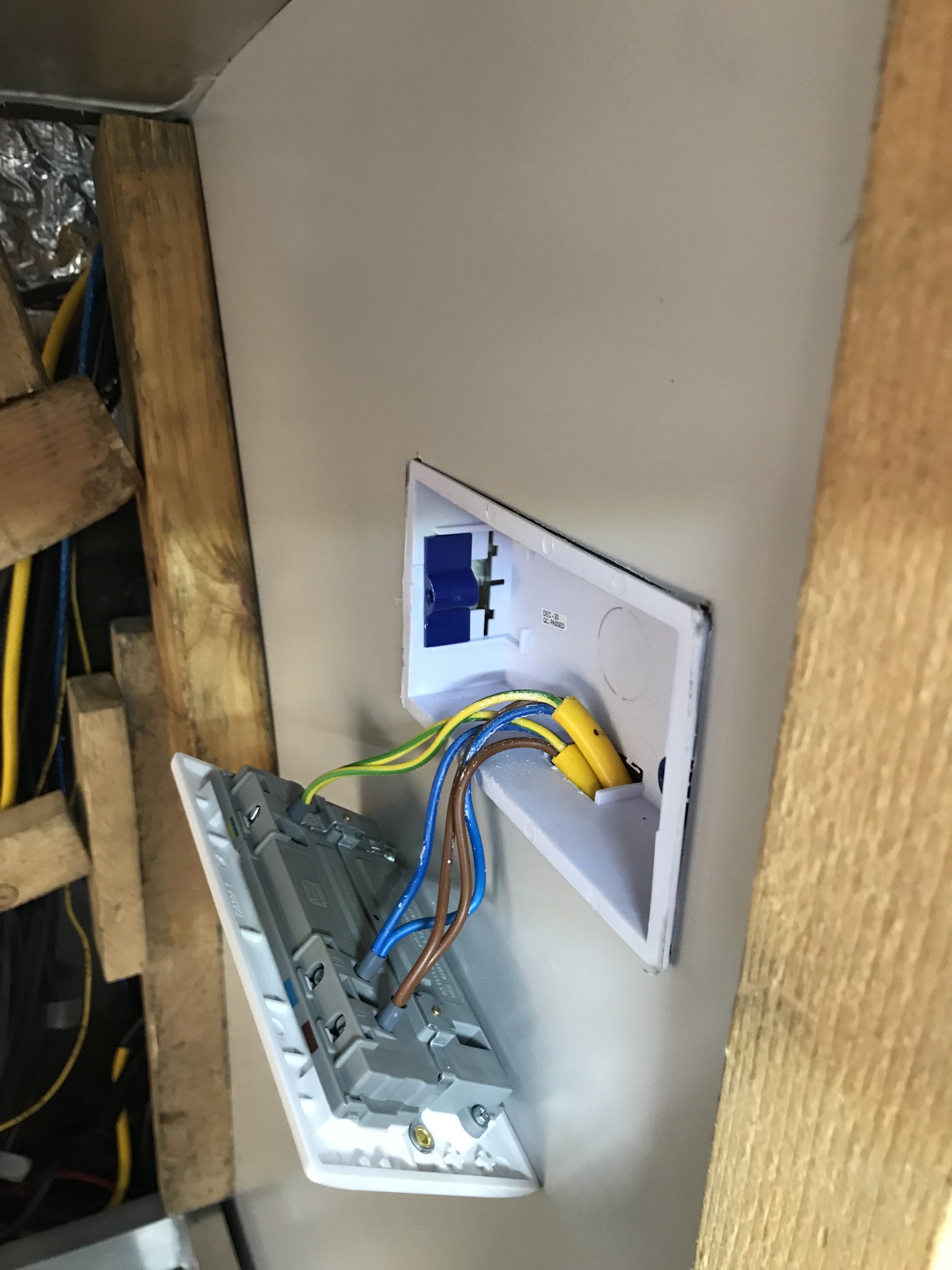

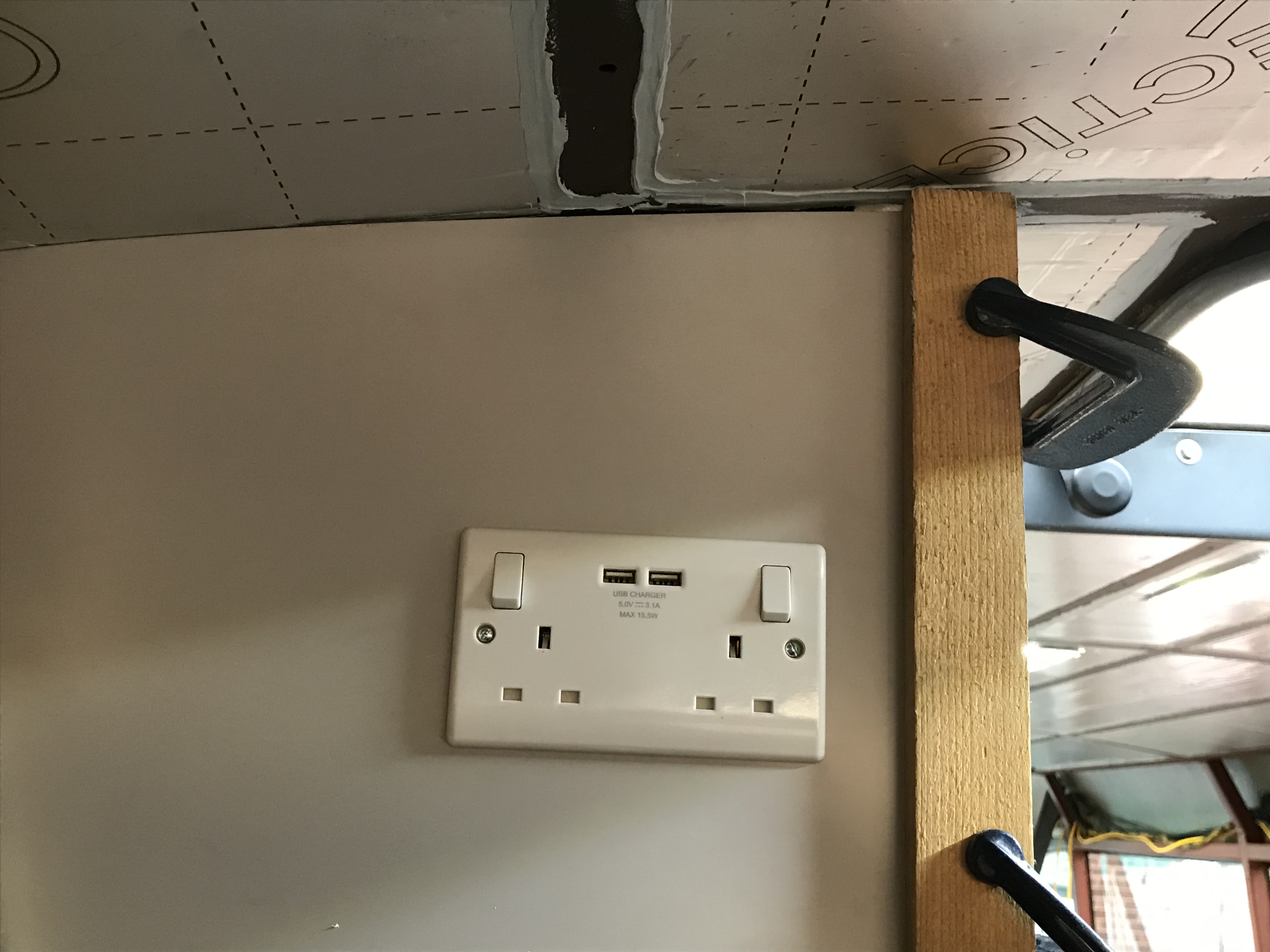

Not a small job and it didn’t go well. I used dry lining boxes for the sockets and have done before. The sockets I chose did not allow for the box sticking out. I have a fix, but it’s over kill. To my shame I did look for those 70’s socket bezels, but fortunately I couldn’t find any.
Once all this was in place I thought this would be a good time to fire up the Multiplus. No power at the sockets. So check all the wiring again, all good. Time for the multimeter, no volts from the multiplus. :( I even took the plug apart and all good. Neon screw driver lights up, but I’m not touching it with my tongue! VRM shows it inverting and displays voltage, but none to be found.
So much for the shower room.

Low and behold the Multiplus made enough mains voltage to turn an electric drill this morning. I guess last night it didn't want to play.

Just one more piece of aluminium to put in the remaining window, the previous window was reduced as well in length. The wardrobe will cover some of the window, so it was just as well to mask the window. I was hoping to cut another buffalo board panel today, but it was better to keep dry.

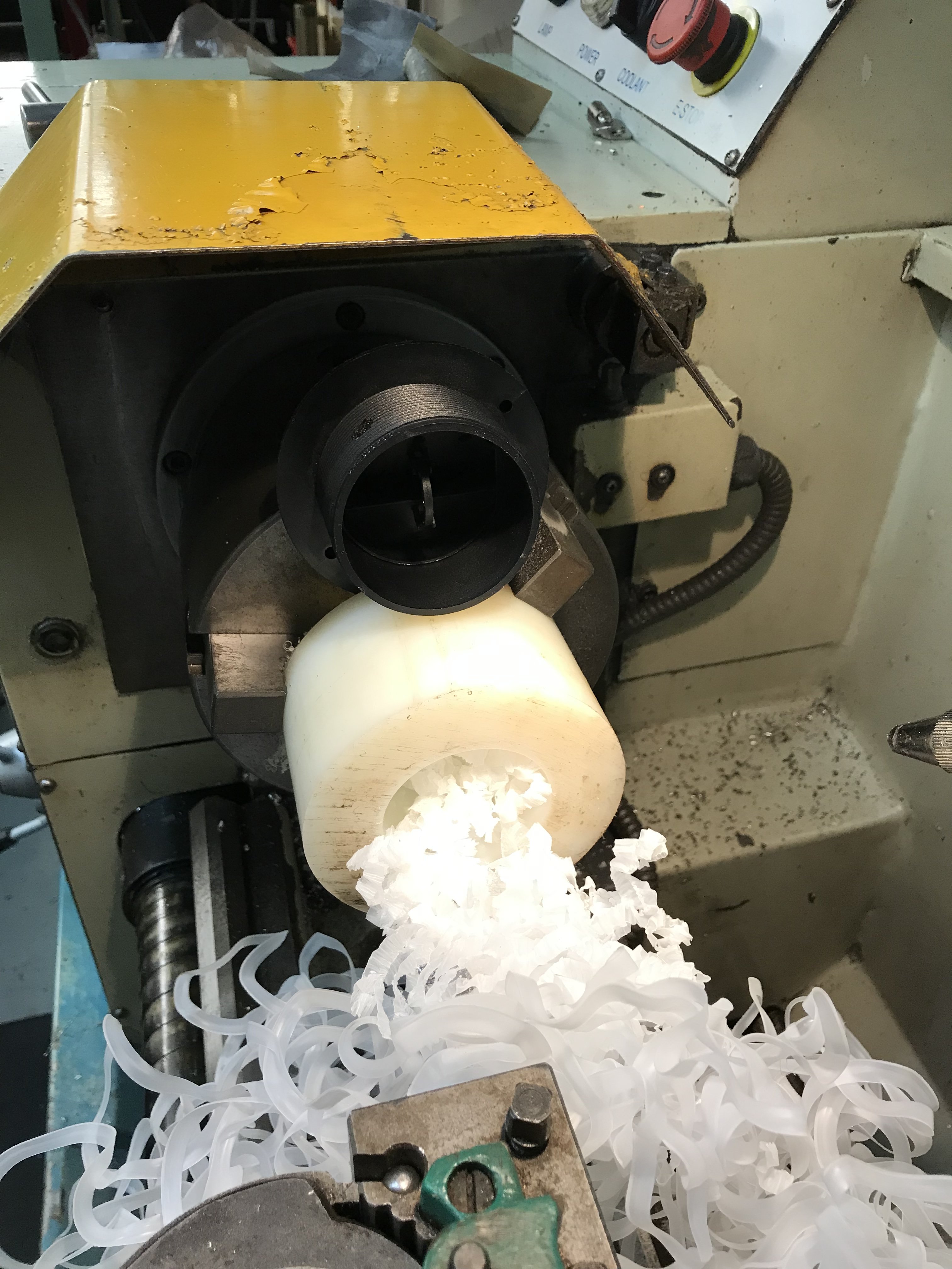

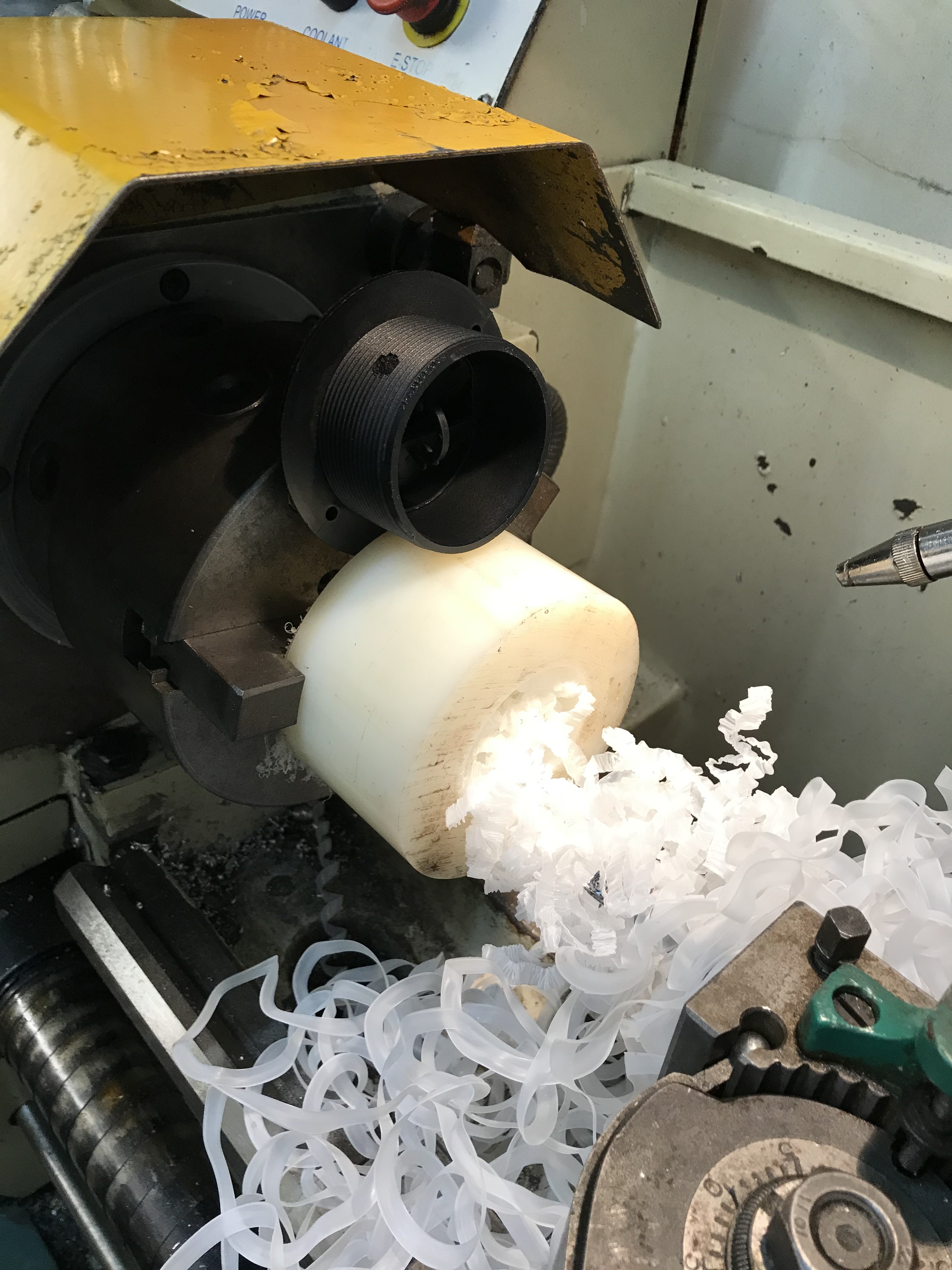

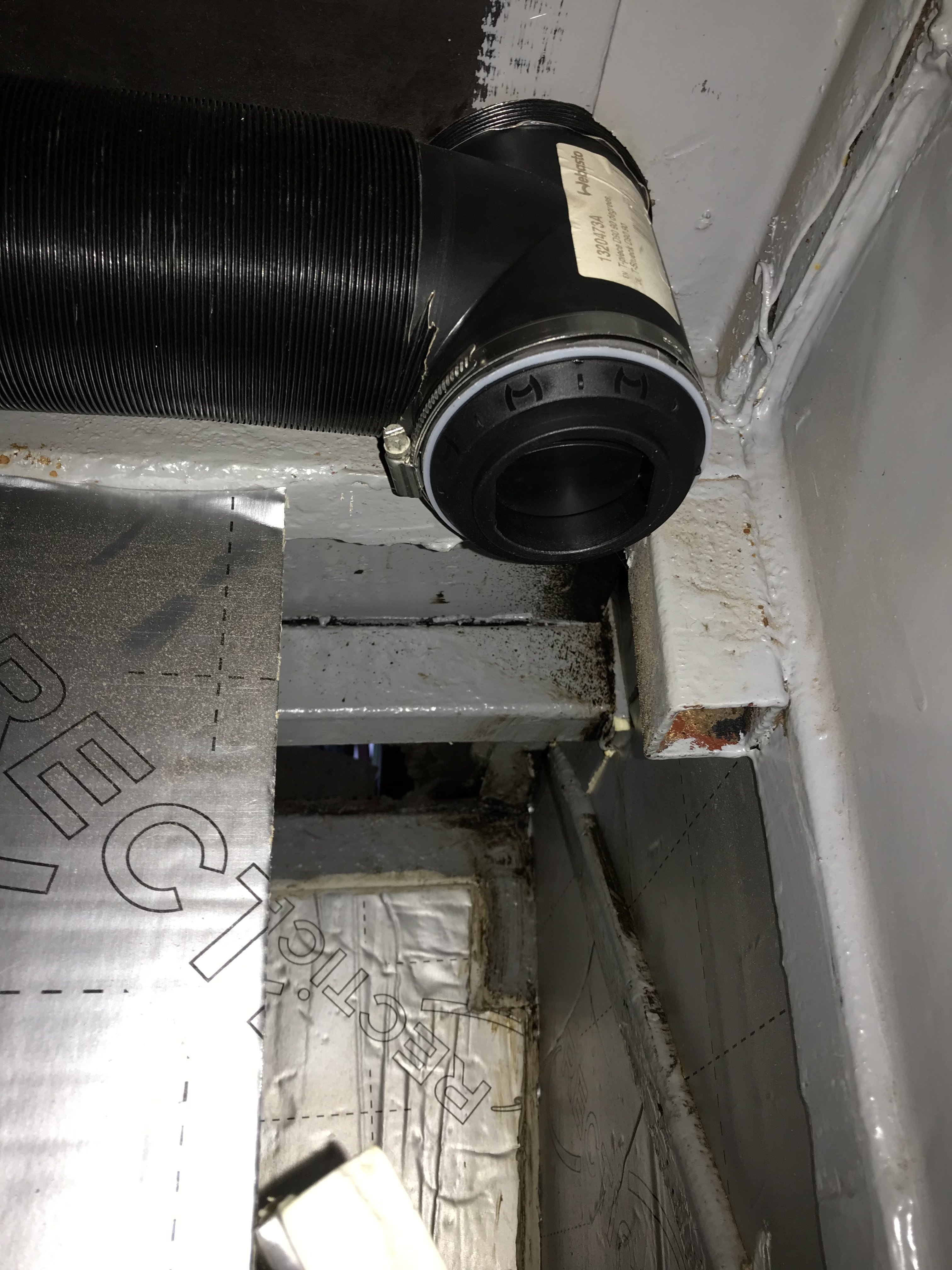

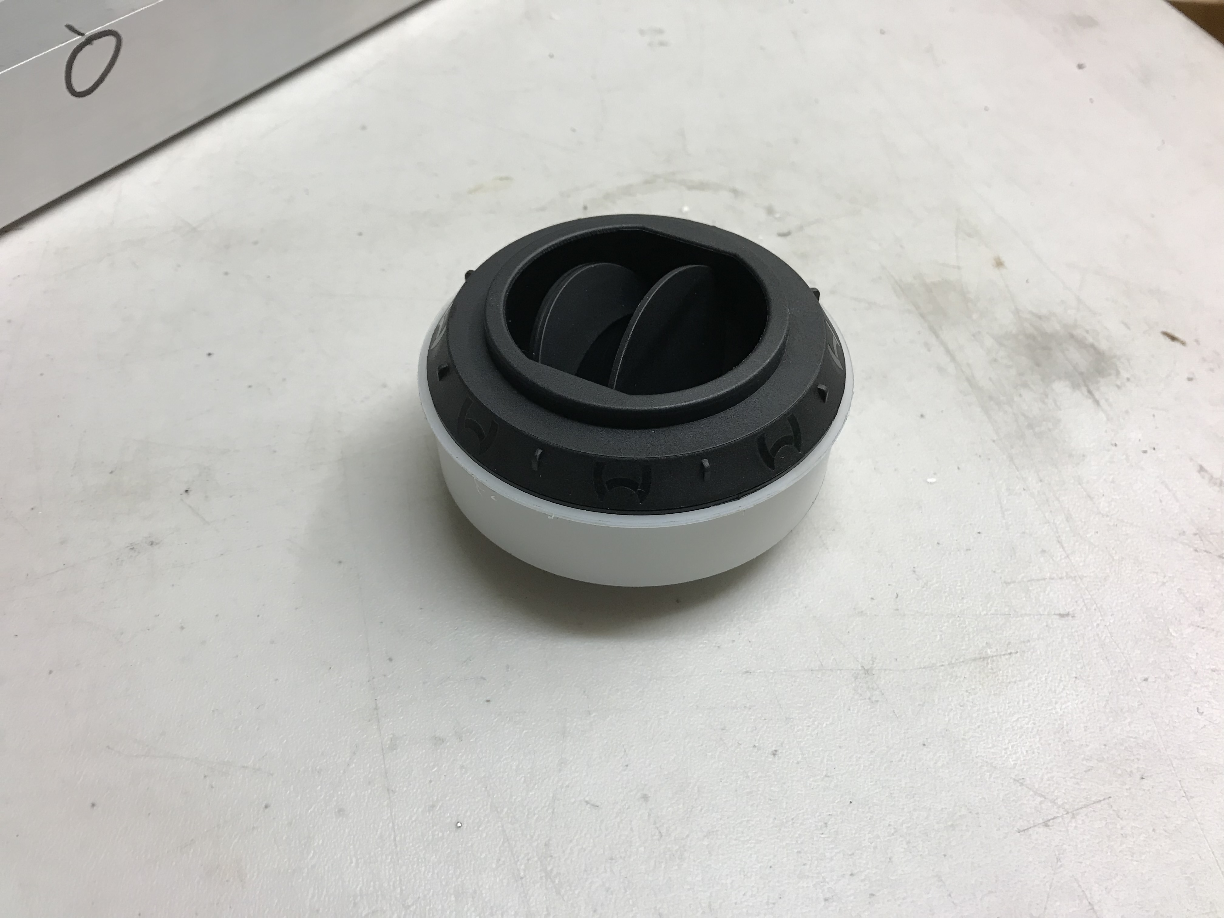

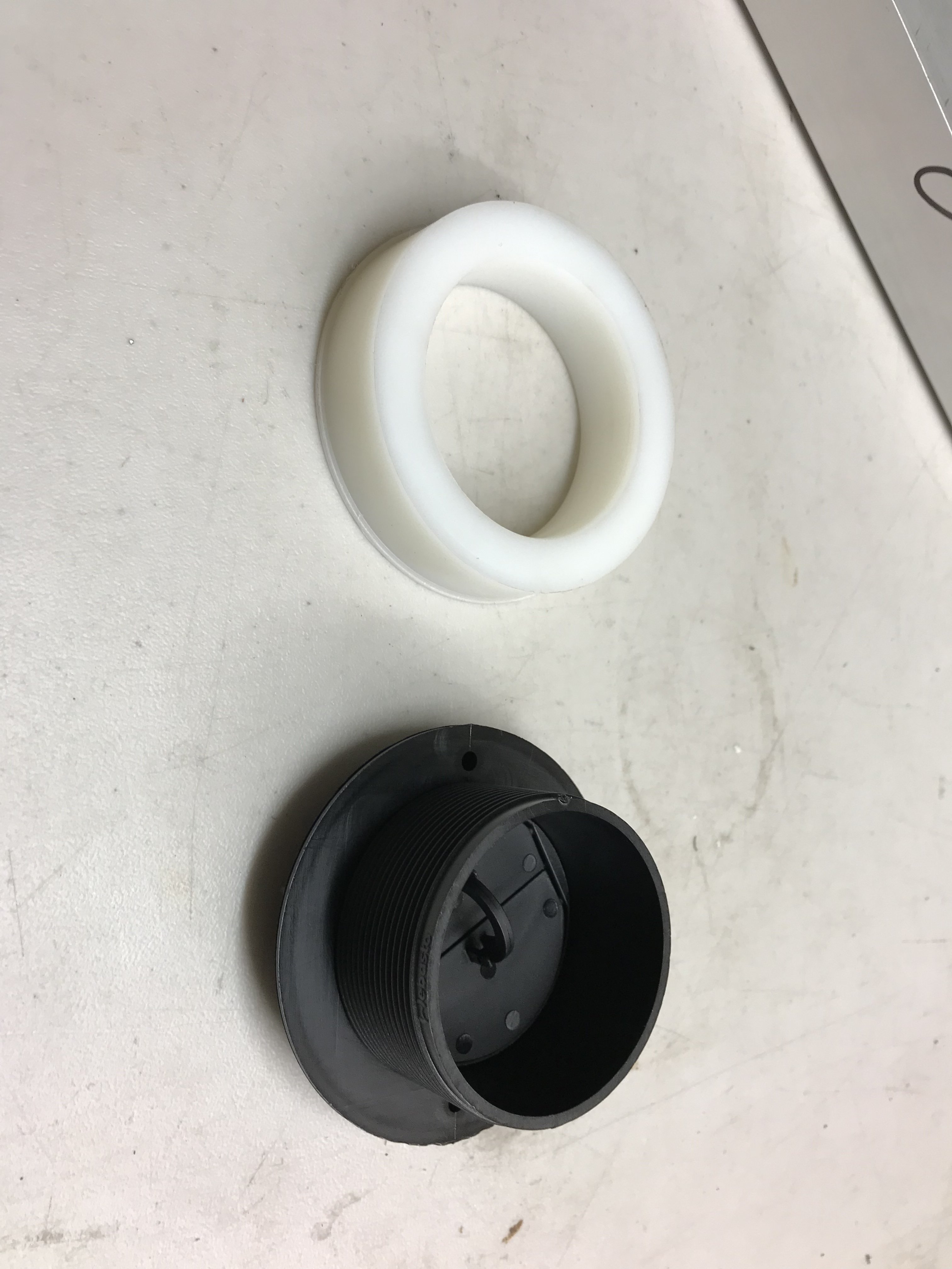

My heating arrangement is somewhat bespoke, with bidirectional ducting. A problem area was below the rear heaters. Left and right ducting is connected together at the back, with the option to heat the garage space. This could be handy for airing the bed that is above it.
The cross ducting and vents are in a vulnerable area, as this is where the frame for our marquee will be stored. My solution was to fit the heater outlets in theTee joints. A nylon adapter was machined to do this.
