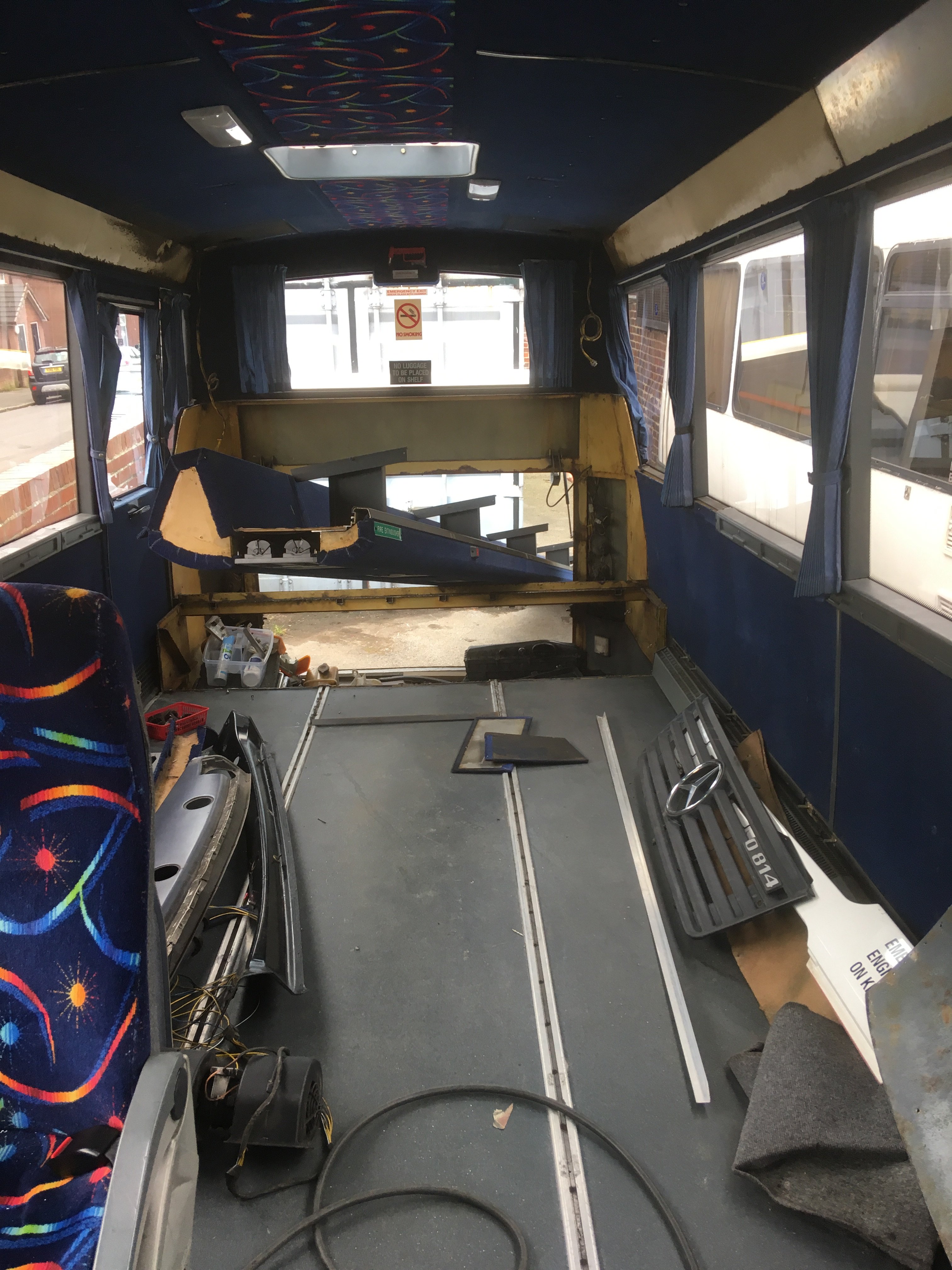

It was not in a condition to take to it's first MOT, so the weekend was spent stripping the seats out and making a fake motorhome conversion. Shock horror, when it was taken to it's next test it passed it's MOT as a Motorhome with just a few advisories.
So back to the subject of Base Vehicles. A coach has a lot of stuff you will not want. It can take a while to remove and dispose off. Just because it was able to pass an MOT or PSV does not mean it's safe to use! I often wondered with Chassis Bulkhead builds of new Coaches and Busses how they joined the Bulkhead to the new Body. From the few I have seen the answer is poorly! I expect coach built motorhomes are worse. The Engine compartment was not properly sealed from the passenger side. This was Plaxtons work as we have the drawings to prove it. Hardboard and lumps of foam were used. I hate to think what would happen if it had an engine fire. Many "Repairs" had been done by trained coach mechanics. The nightmare now is undoing their work and bringing it back to a safe acceptable condition. Most of the strength in the Plaxton Body appears to have been at the back. Sadly it needed to go. The front end will need reinforcements and missing structure replaced. As well as finding a safe solution to seal the cab.

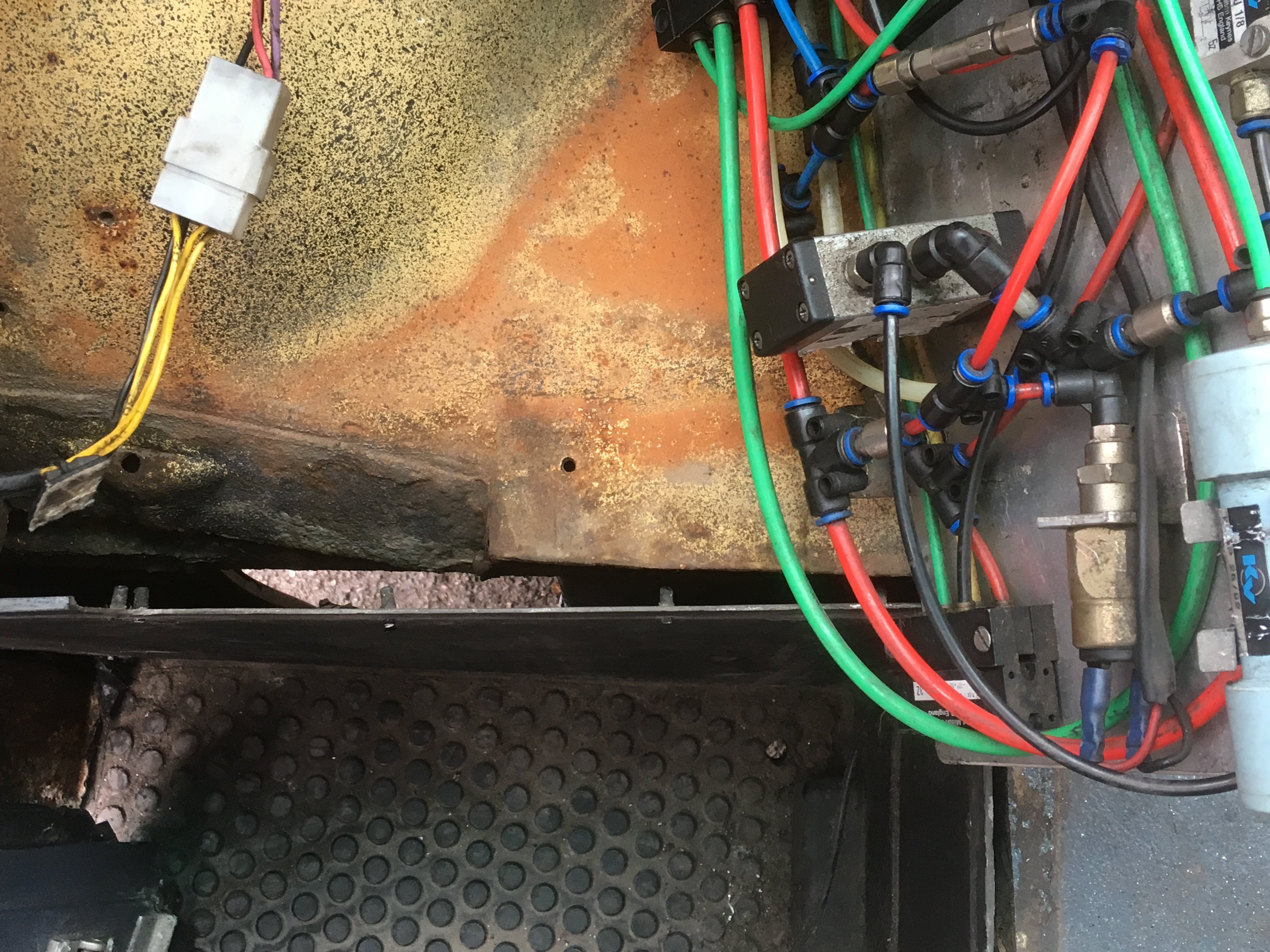

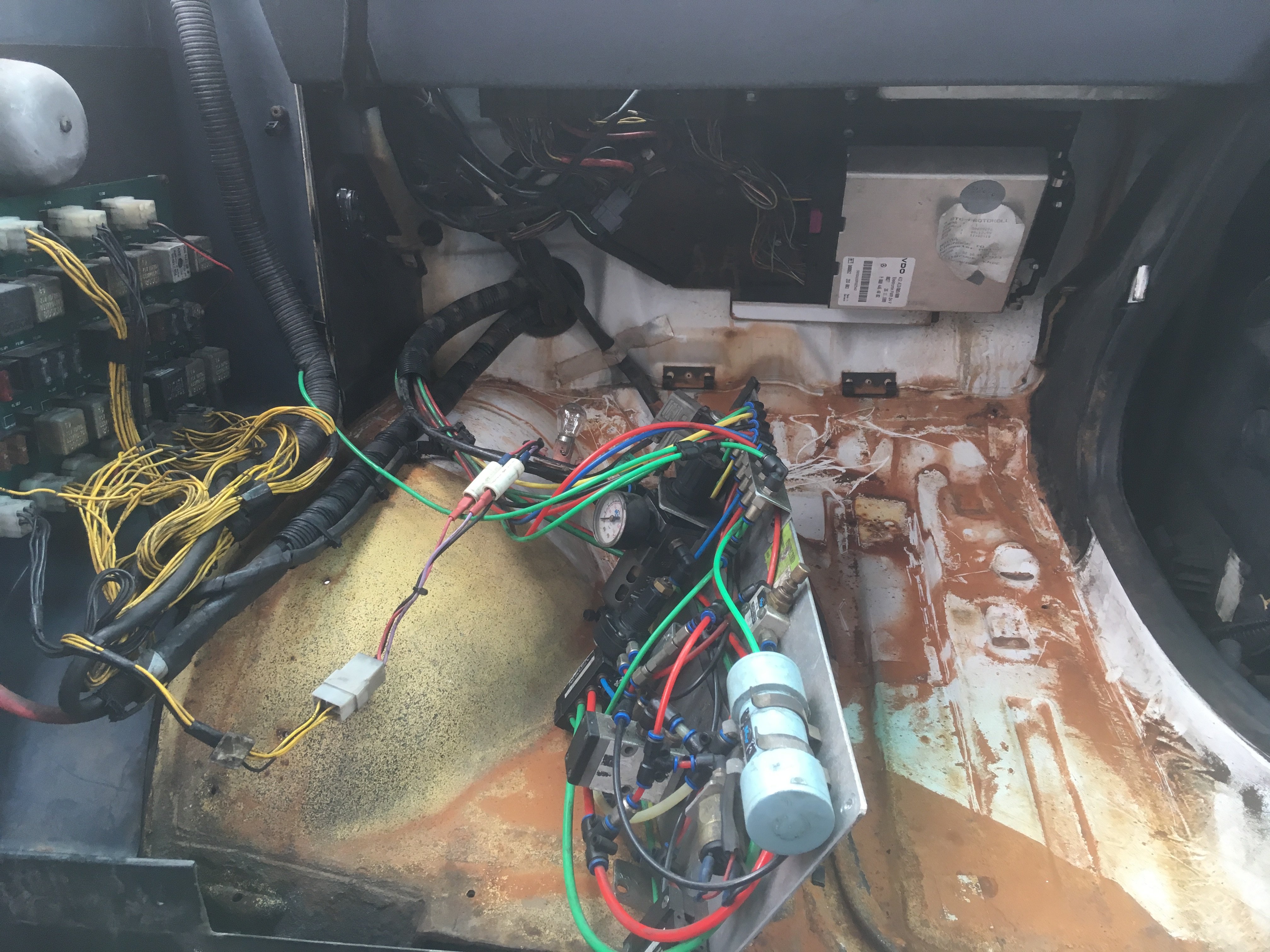

Still digging away to expose "Betty's" horrors. We knew Plaxton had cut away Cab structure with no attempt to marry ends or reinforce edges.
Washing under the front nearside wheel arch resulted in rivers running across the internal floor, so we knew work had to be done in that area.
Finally exposing the steel floor of the Cab we found the proof of the poor workmanship. I can only guess the original build had been sealed with spray on mastic. Subsequent Entrance Step repairs must have removed this.

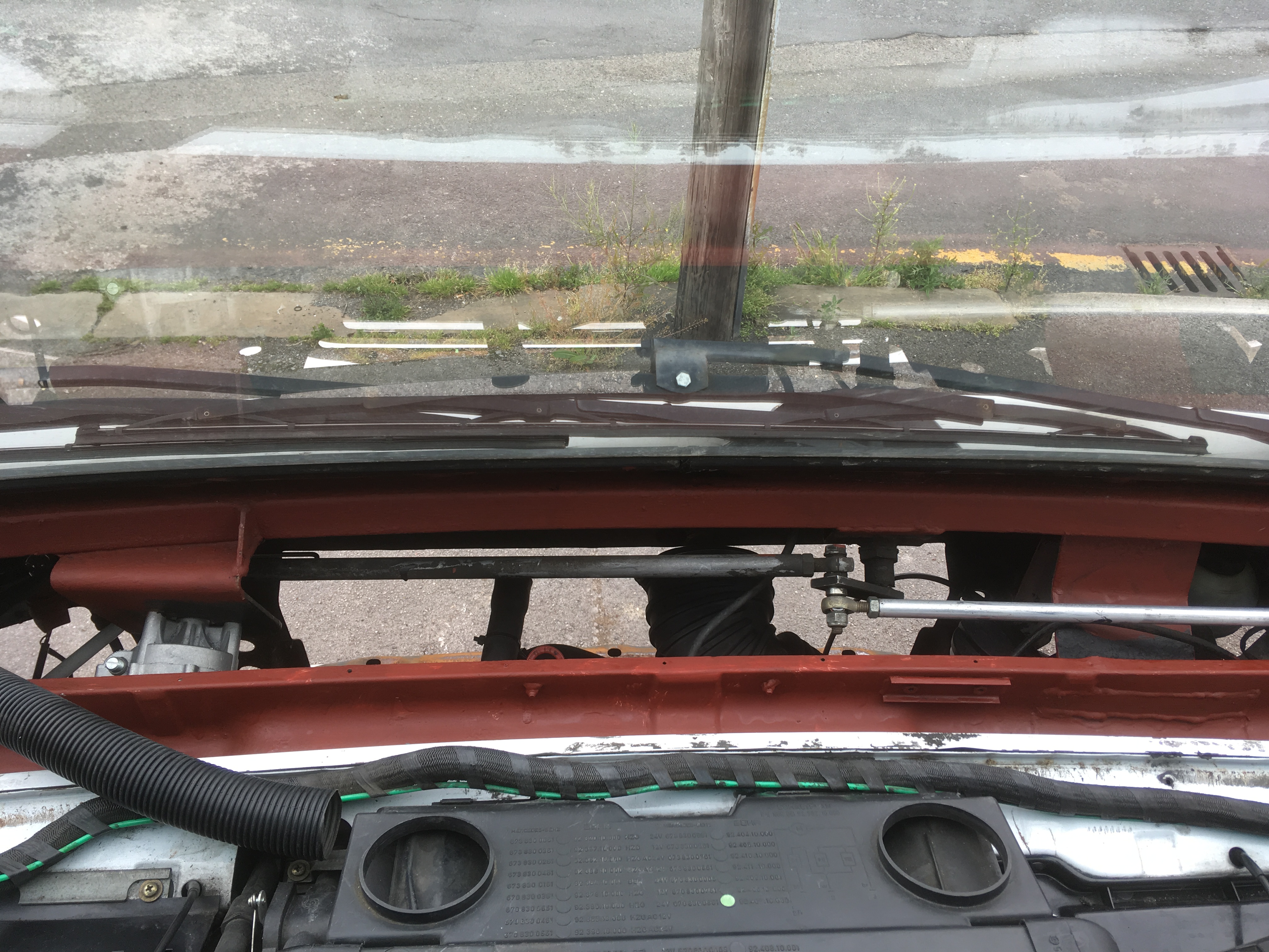

As most of the problems found in the engine bay have been resolved. Leaking water hoses replaced. Turbo charge pipe leaks solved. Wipers and lights working again. The next big job there was to fit the M12 Eberspaecher.

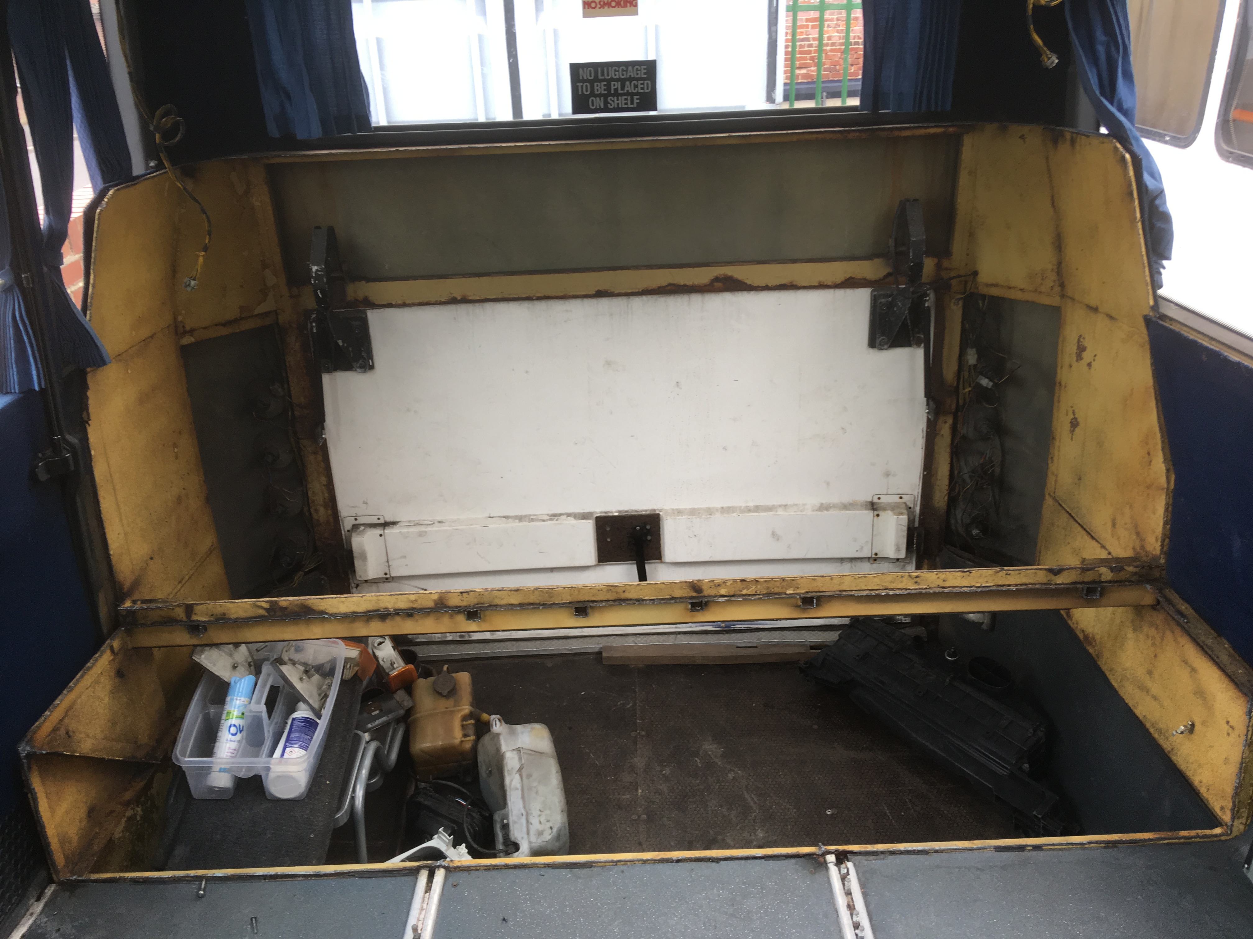

To mount the Eberspaecher access was required to the other side of the bulkhead panel.
Many glass fibre mouldings, trim and plumping had to be removed to be able to see the other side of the bulkhead.
So it was decided the next area to concentrate on was the wheel arch and floor around it.
What a pleasant surprise to see so much steel, normally years of windscreen leaks destroy the floor.
This area might be an easier fix. sssshhhhh.
