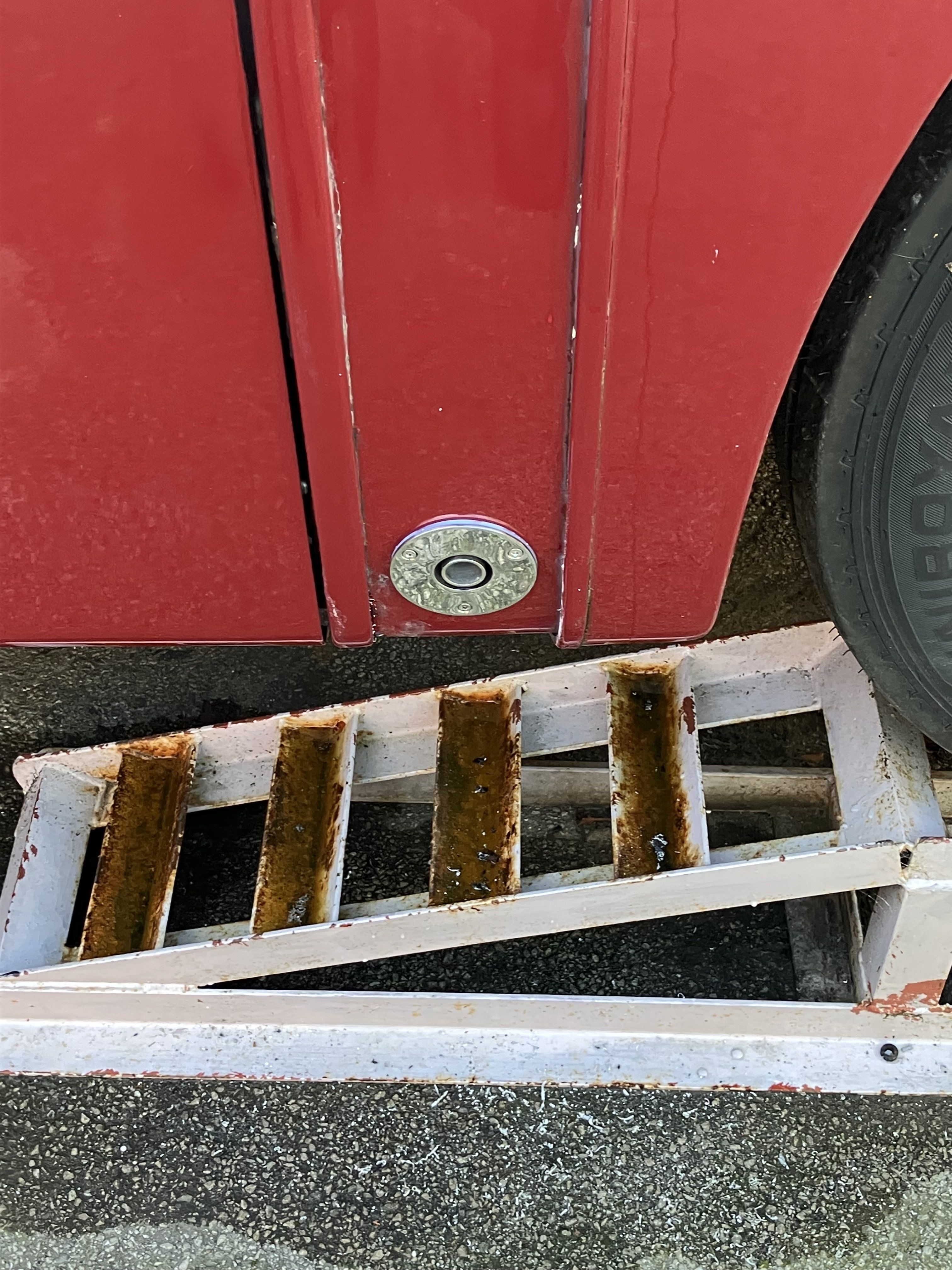

A small amount of progress, but it's progress.

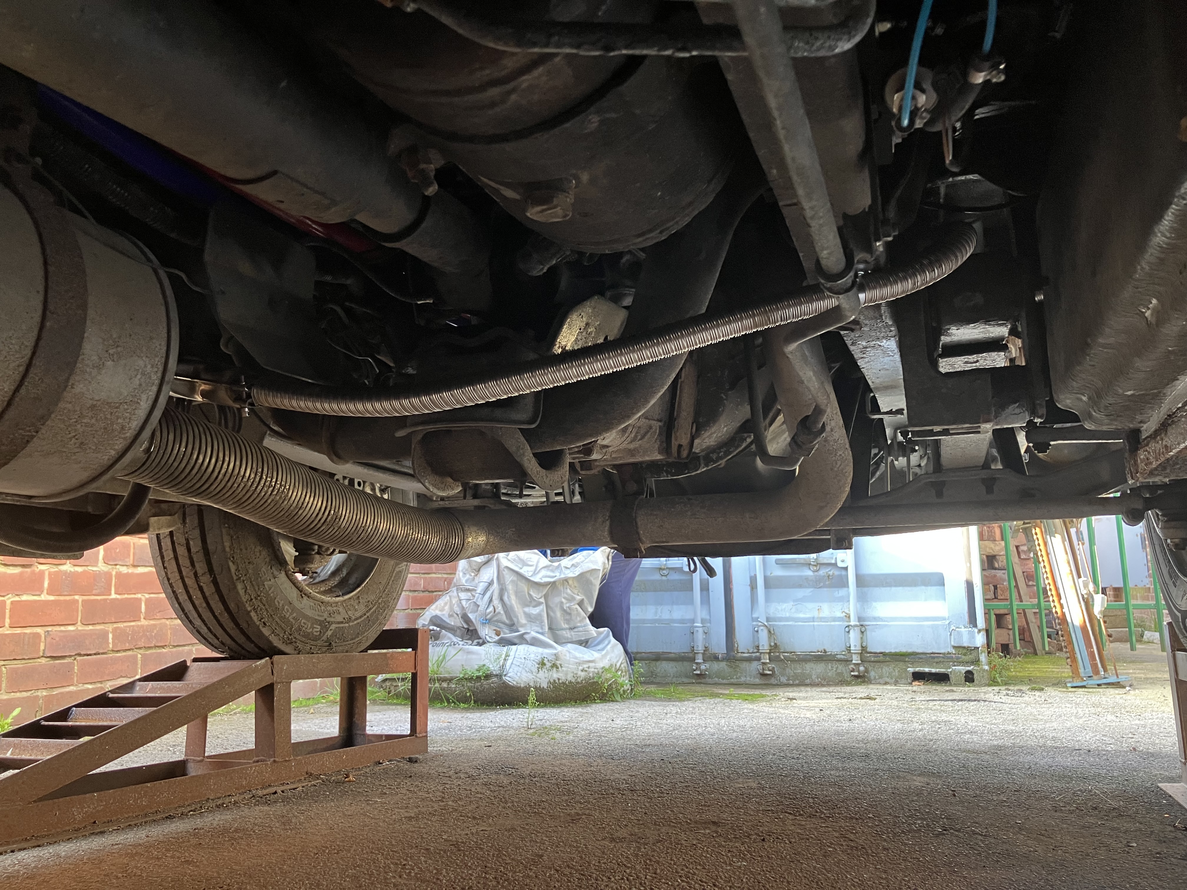

Like using skin fittings for eberspachers.
The heater is mounted under the step, but I'm limited for good spaces for the exhaust outlet.
Hence, I've gone from one side to the other.
Still some more brackets required, but at least I now know where it's going.
When it turns up, I'll lag the pipe to help avoid setting long grass on fire.

I was hoping to insulate the eberspacher exhaust pipe this weekend, Mellors sent the wrong size hose clips. Not the end of the world. The Exhaust lagging was posted through a letter box in a blue door. We don't have a blue door, let alone a letterbox.

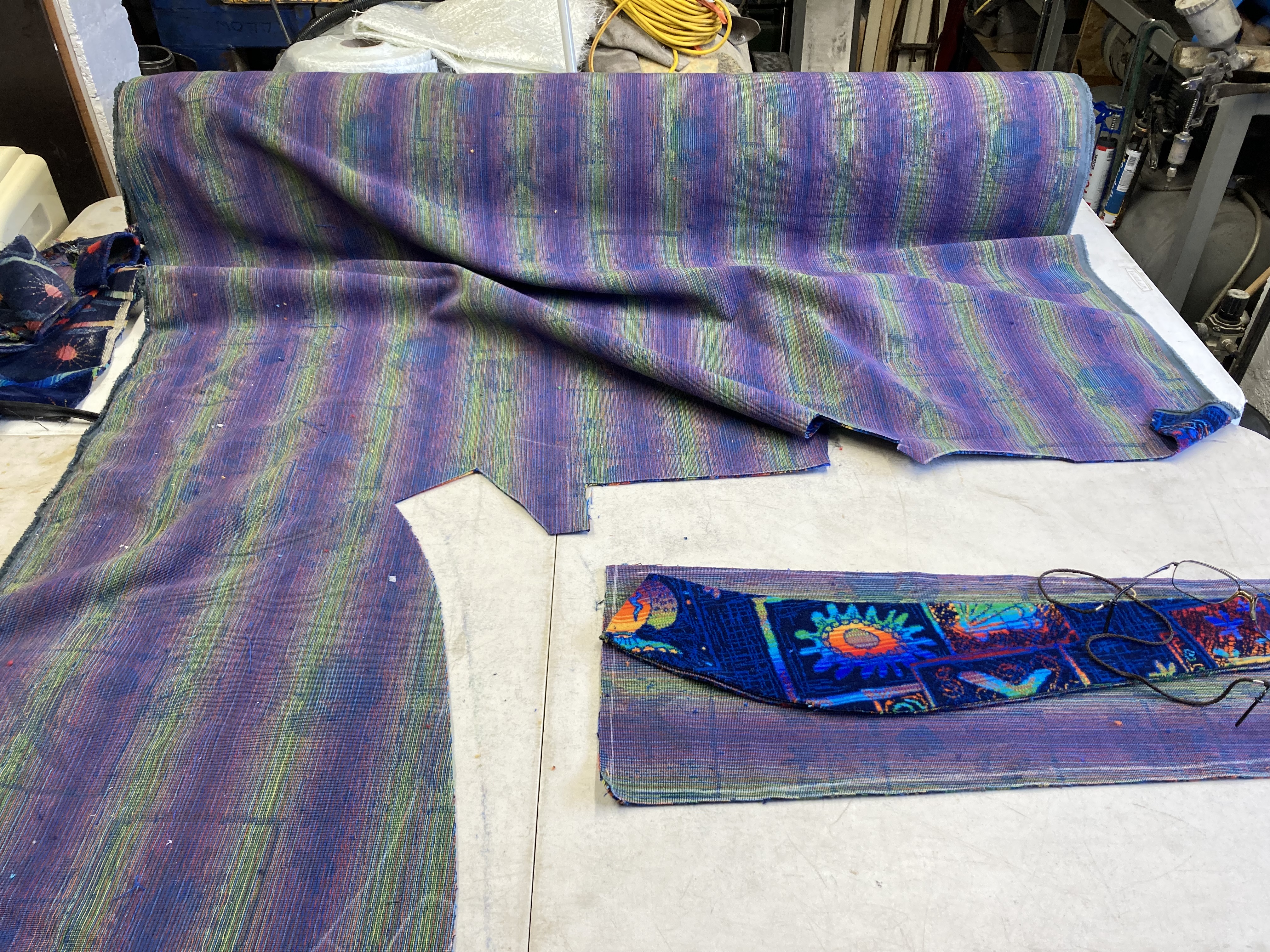

Progress on the driver's seat until I found I had ran out of cotton!
