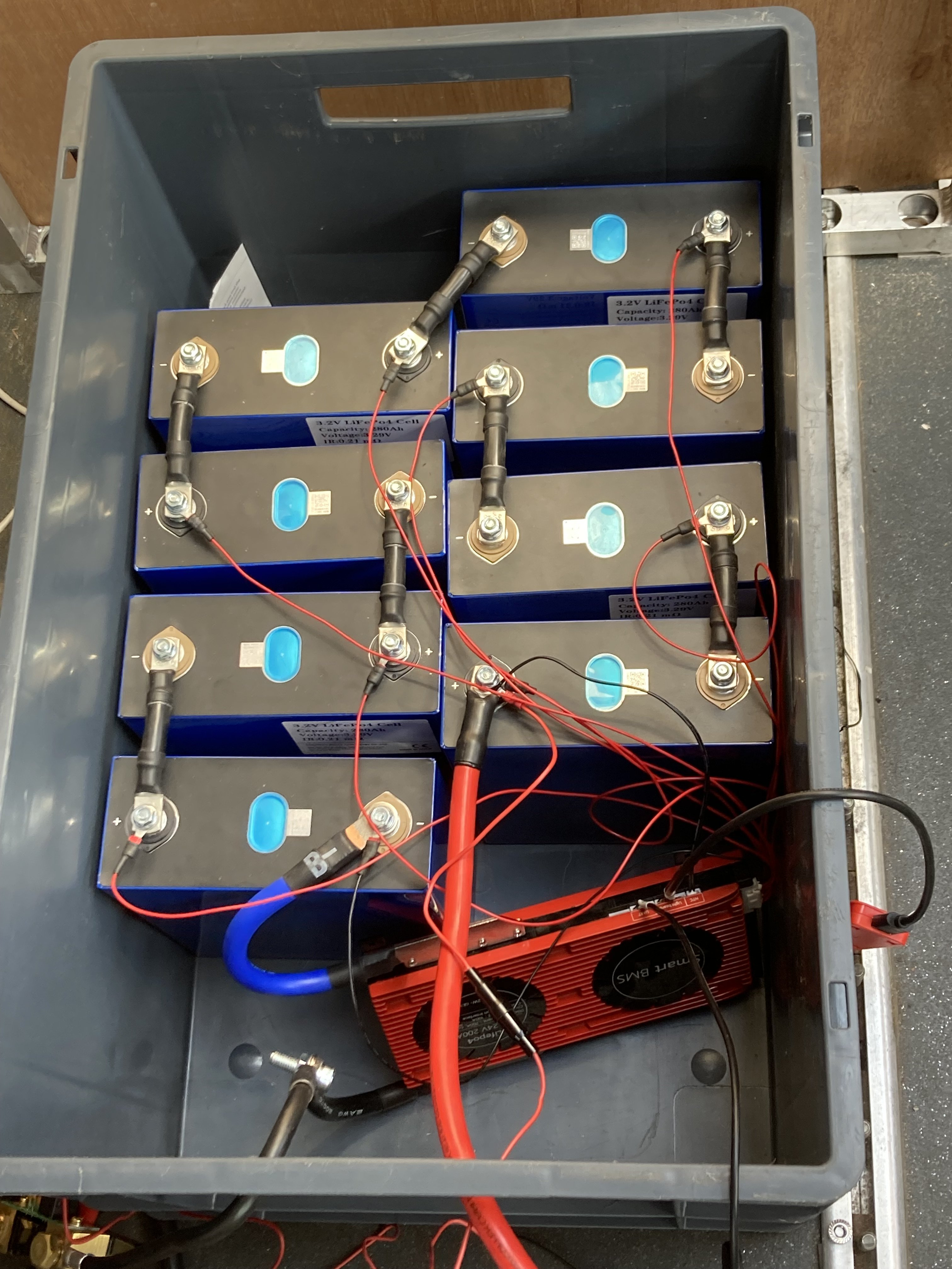

Whilst attempting to tidy the workshop I thought I'd evict Betty's lithium batteries.
So I got distracted and put them in a box.
I then got to thinking they really need charging, so roughly connected them up.
Solar panels now getting a good workout.
I wonder how I'll know if they are charged?

is that a Bluetooth equipped BMS with a phone App?
you can put a Meter on each cell of course and check the voltage of each cell. When a lithium cell is charged it takes no more current so when the charger/controller (think you are using a Victron with BT?) goes down to zero current, that is the bank done.
I was hoping that David. I don’t know if the Multiplus or the mppt’s are in control of the charging. The voltage hasn’t risen much, but about 2.4kw’s have gone in so far.

With Lithium you don't see much rise. The voltage has only a very slight rise from around 20% SOC all the way to nearly full.
Fully charged now and floating at 27 volts. It will be interesting to see how they power the fridge and more so the calorifier. Lots more work to do before I’m at that stage.

Thanks Dave, for now I've just put a couple 6 amp ones in. First test was a vacuum cleaner followed by some power tools cutting panels for the shower room. I managed to take the batteries down to 98.5% So it looks like it was a good choice with the batteries.
