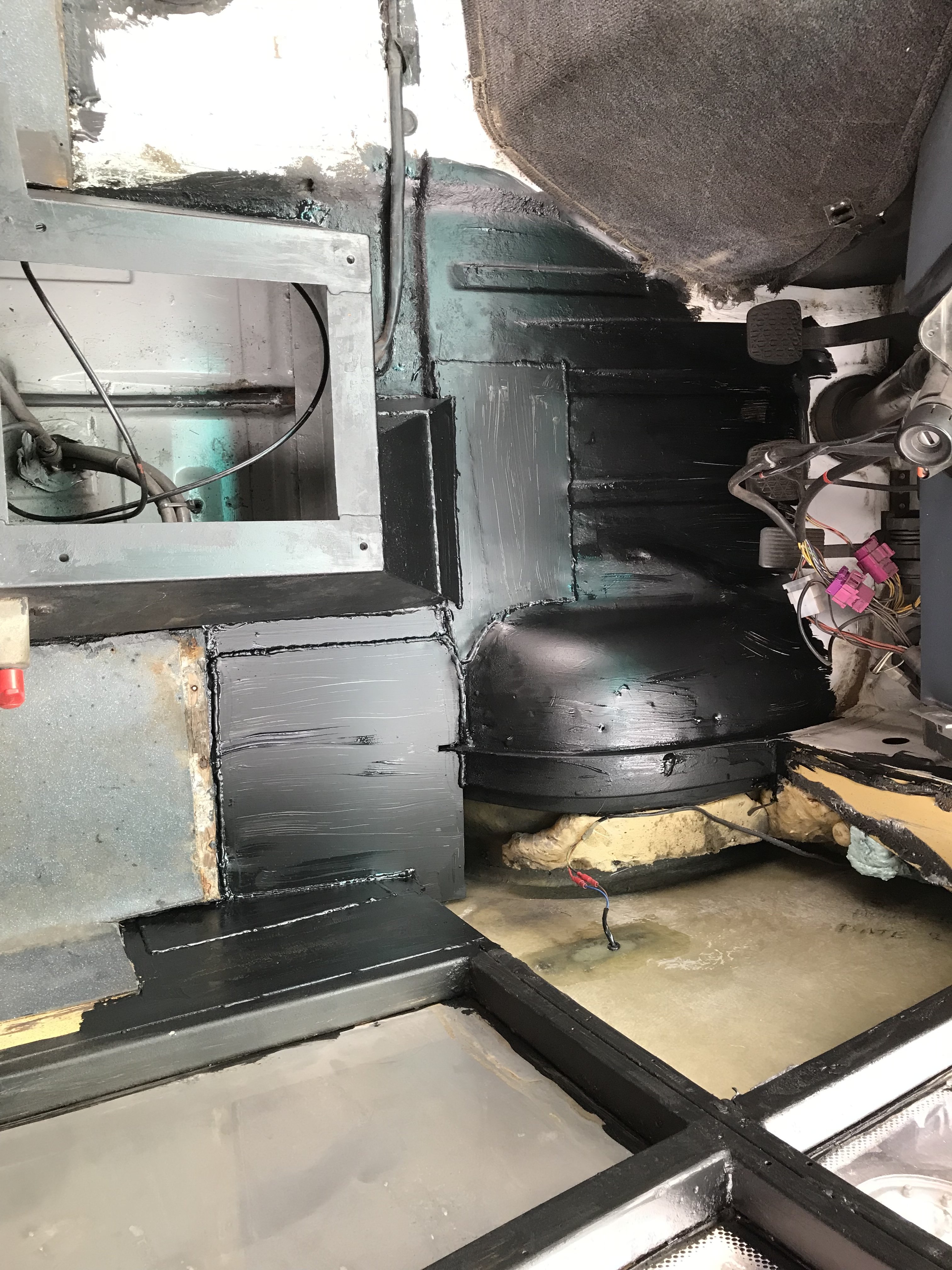

Just when you thought the demolition had ended, I made more holes in it. Or rather cut the existing ones bigger to find good steel. I knew this area was dubious by the pop rivet and mastic repair in the floor.
Everything had to be ripped out of this corner to improve insulation and hunt for leaks.
I still have the underside to repair, but at least this is a good start.

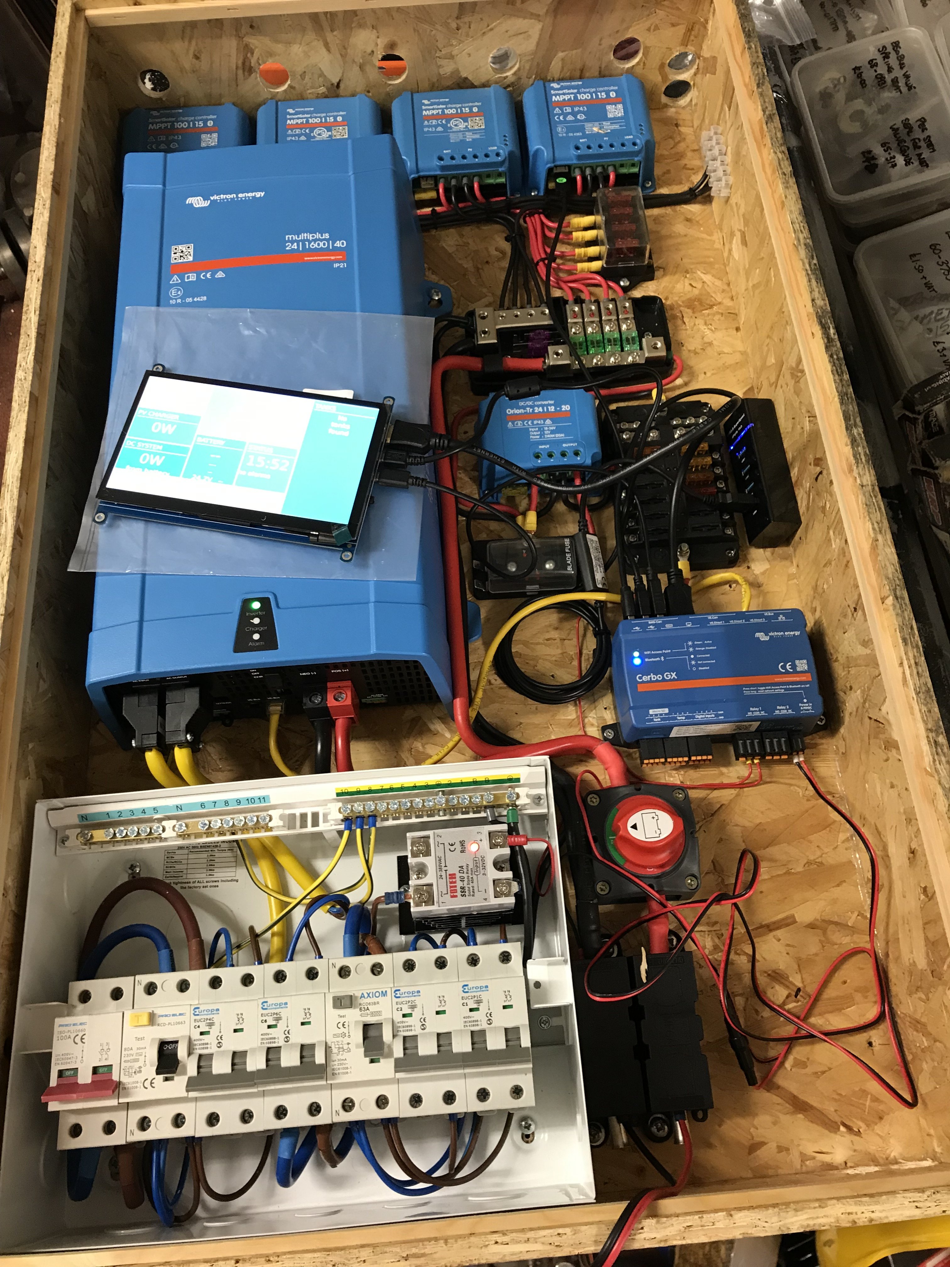

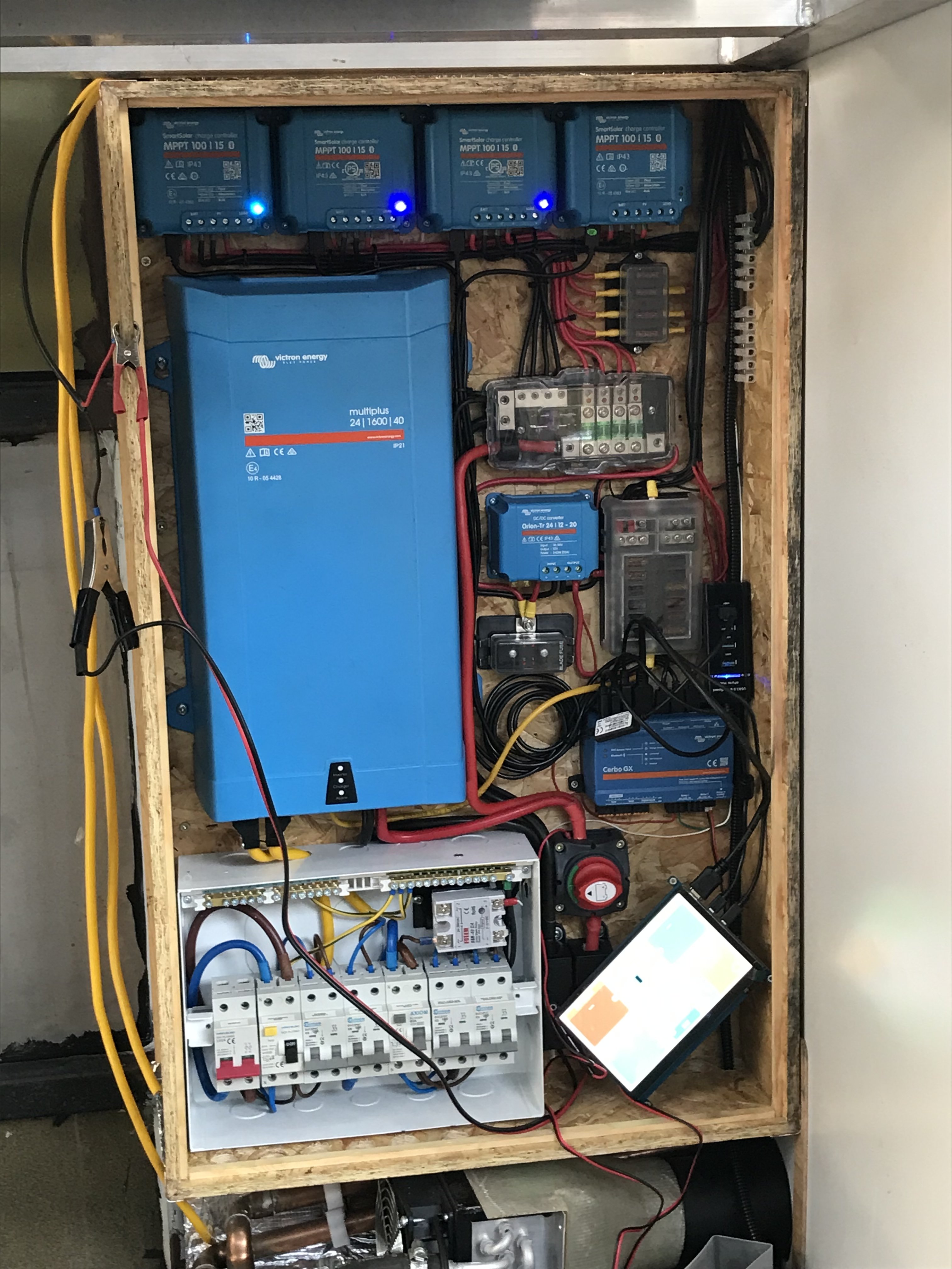

We have life, including a working touchscreen. Guess it didn't like my other monitor :(

Betty has some consumer power again, just as well in today’s heat. I’m so glad this was built externally, just finding the correct wires in the umbilical leading to it was horrible. Just what you want with electrics is to wash it in sweat.
But what is going on? Engine start batteries being used as a supply and they are discharging! The penny drops, I’ve been fiddling, maximum charge current set at 3 amps. Easy fix, later in the day. More insulation required as it was so hot with all the fans running. Discovered that the roof hatches and fans mask the solar panels. So I expect the extra portable panels will be required in the summer too.

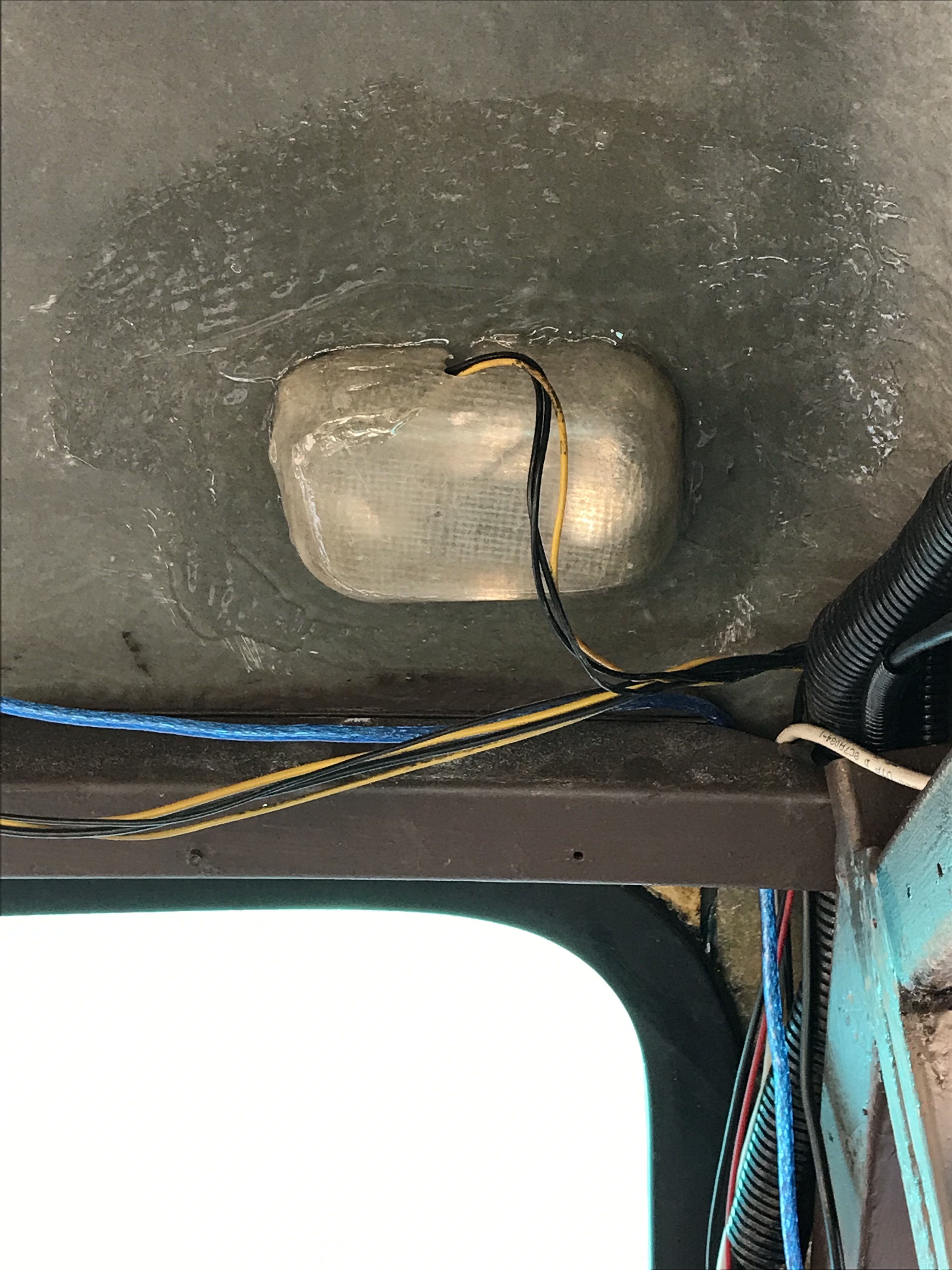

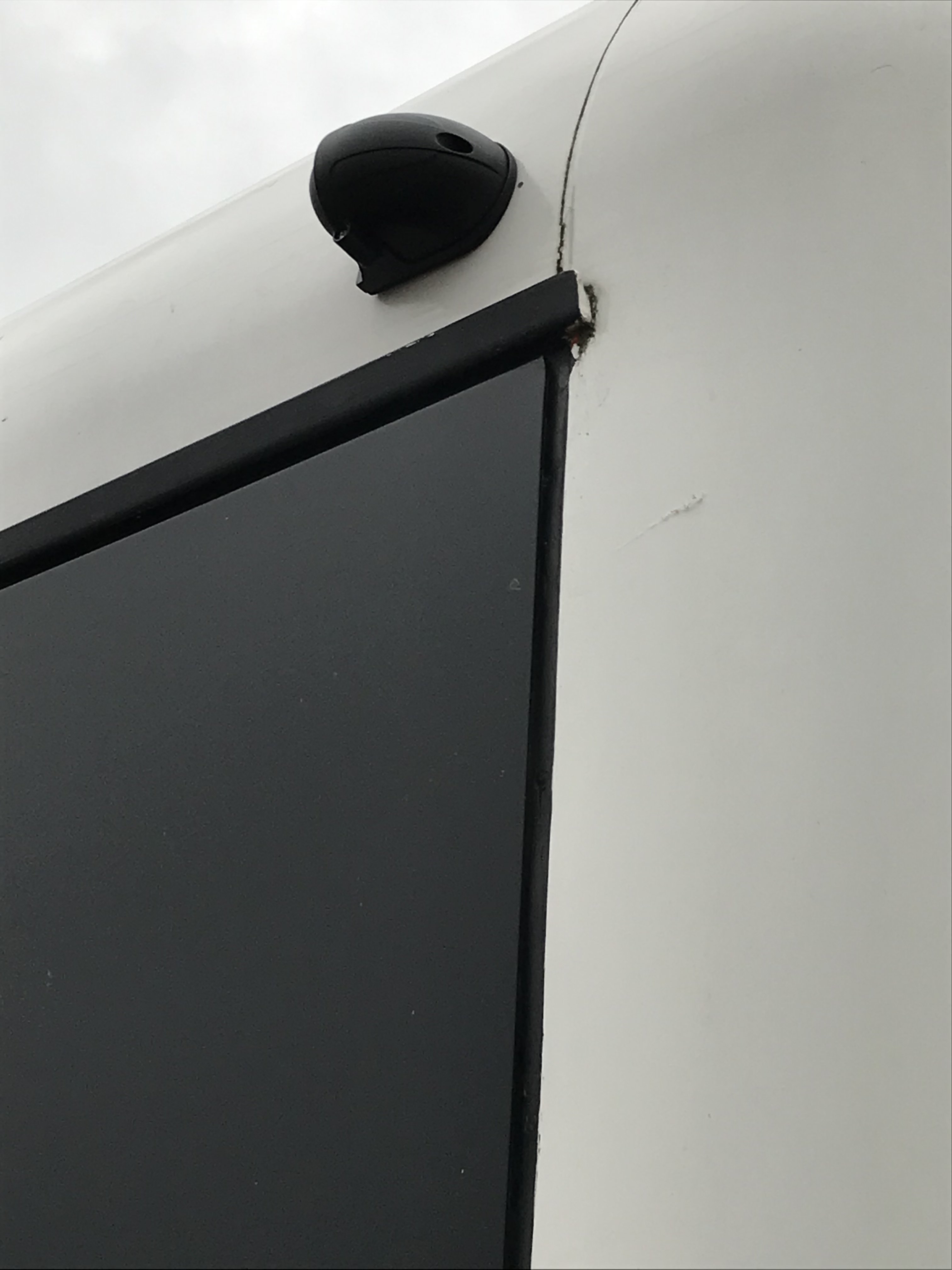

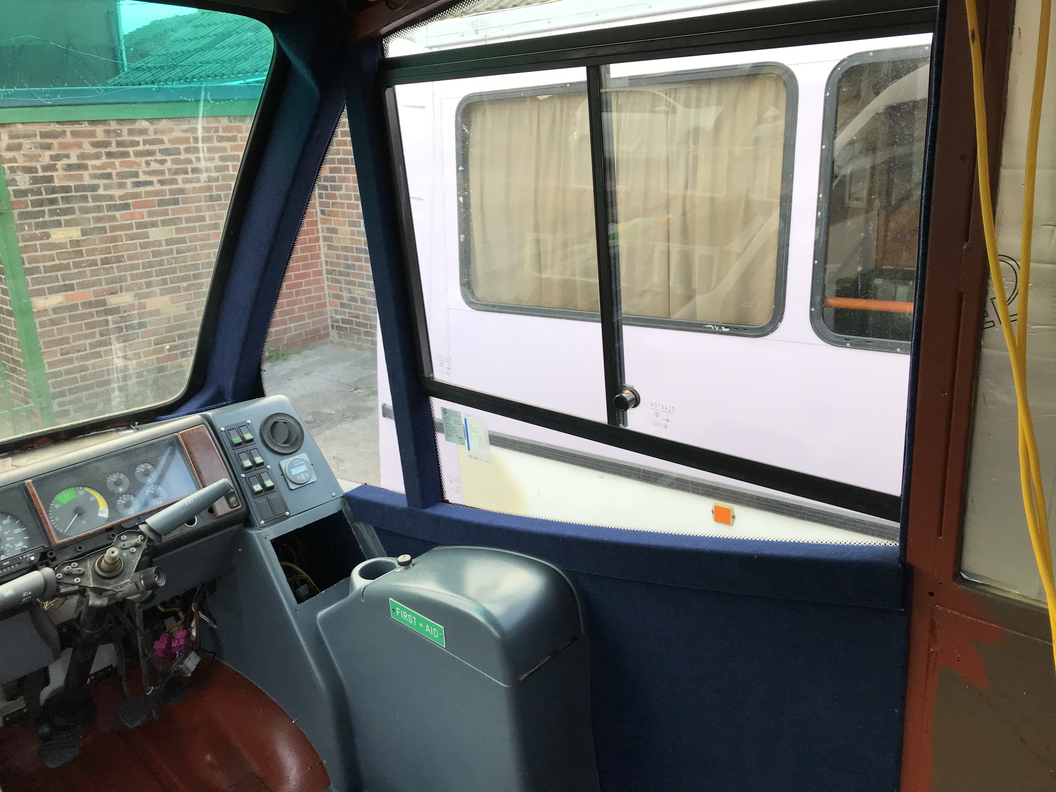

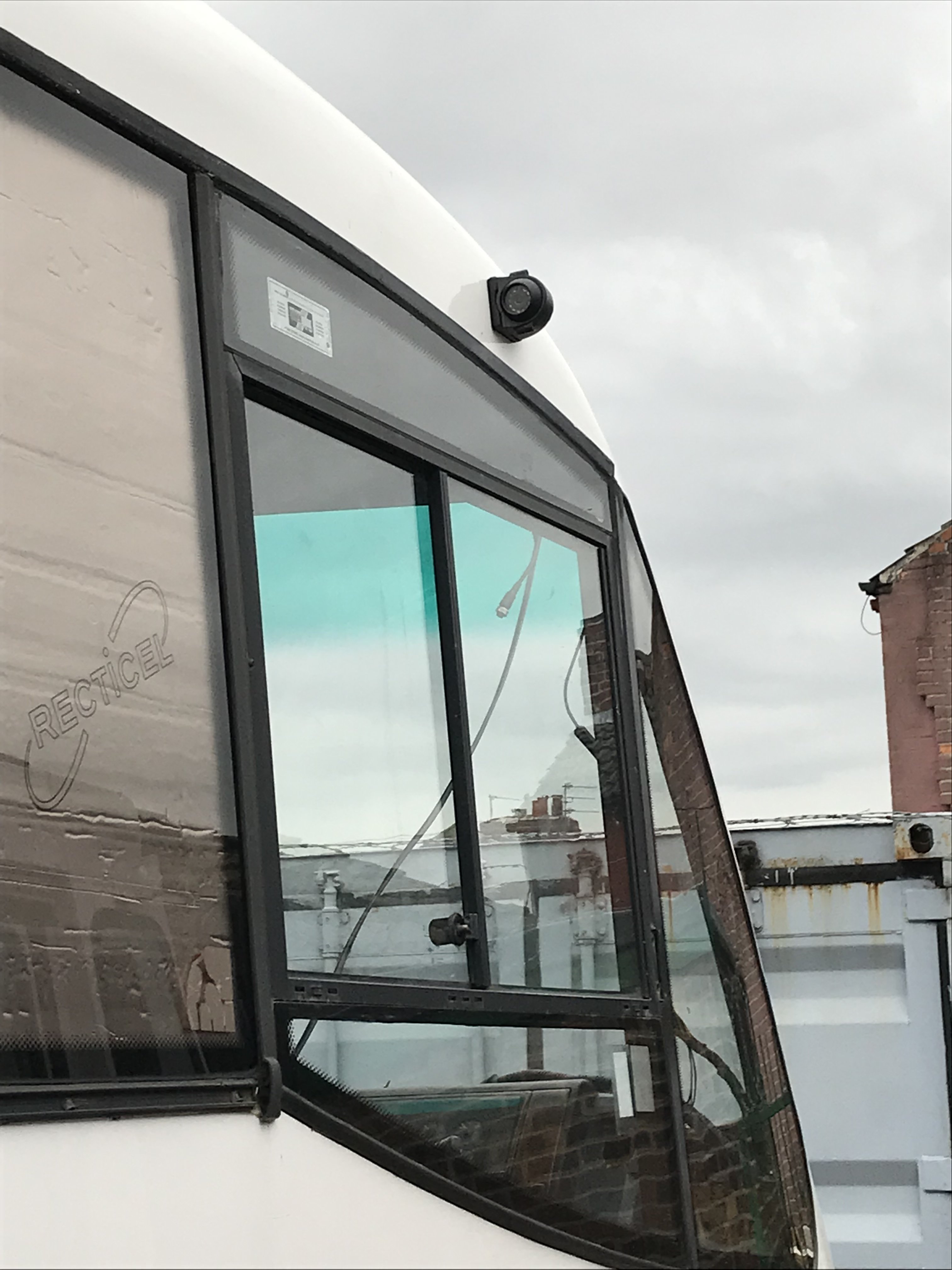

This weekend’s violations, sorry I was so upset dealing with yet more rot I forgot about photographing it. I knew there would be issues around the emergency exit, so I guess I ignored it for as long as possible. Cut out and repaired in a day, so not to bad. A new step trim still needs to be fabricated in aluminium. The rubber seal is not in the best condition so I might have to hunt some of that down. As the door had been opened, it was a good opportunity to ask Anita to strip the remaining fabric and trim. An aluminium door was reviled, what a shame the body was not made that way. After lunch I got carried away with a knife and cut the window out. The window was heavier than expected, As it finally tried to leap out a corner was still hanging on and cracked. Better than the previous attempt. As it was aluminium framed it was quick to clean and prime, ready for the new aluminium panel to replace the glass.
So that was the excitement, the rest was titivating with little jobs as I found them. Apart from fitting some security cameras. This will be handy for viewing my “death angles”. Bloody French ;)

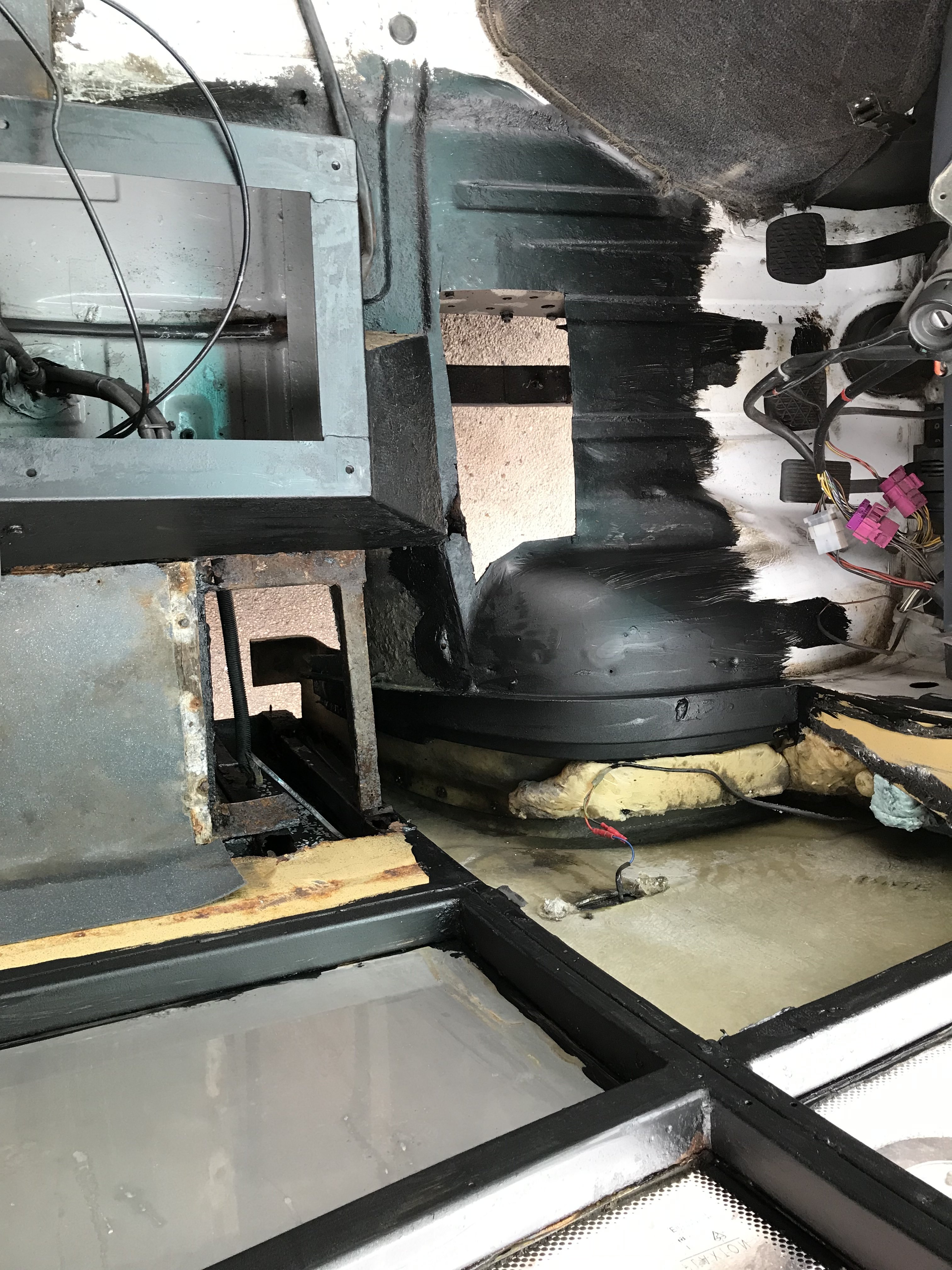

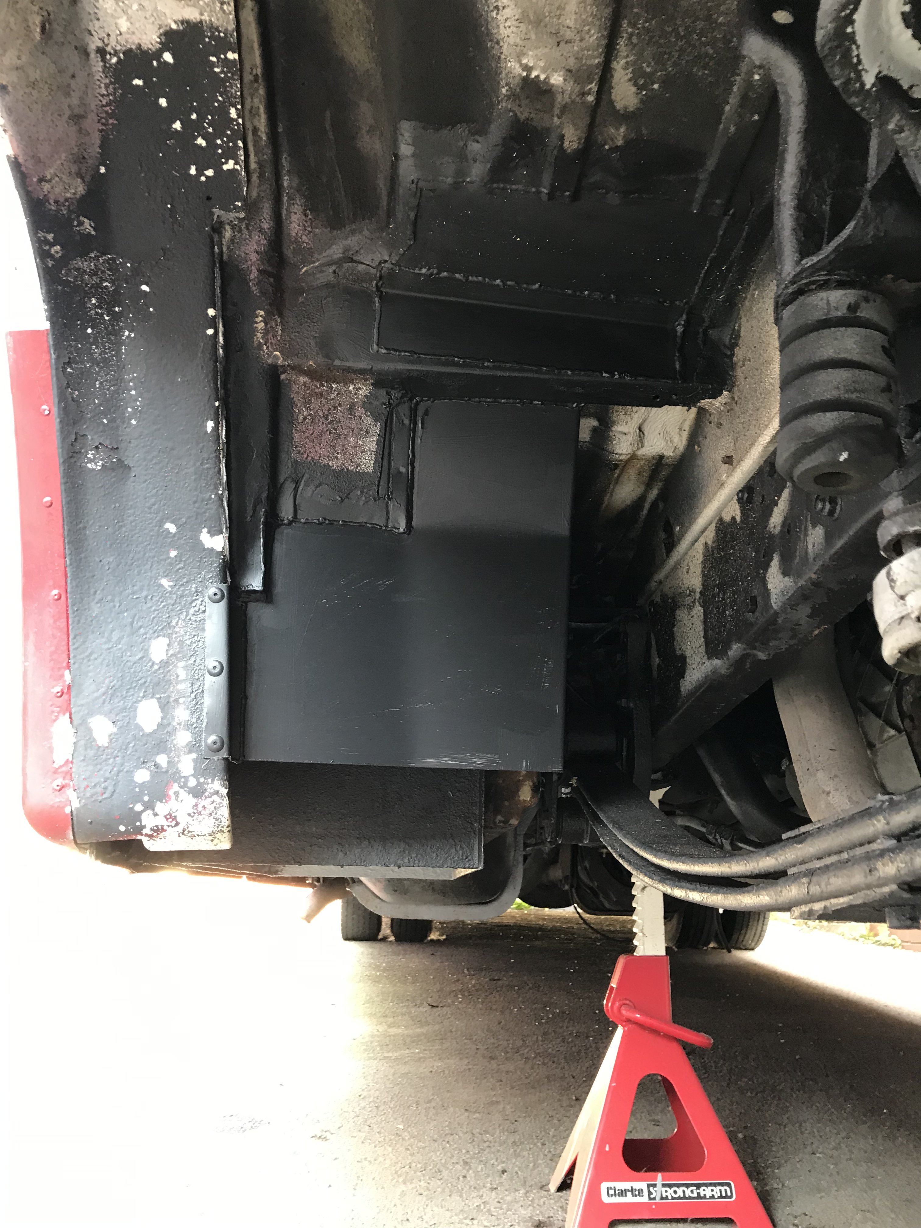

Another big leap, all the welding now done behind the front RH wheel. I still find it hard to believe that if you cut away the rot and structure, it will pass a PSV test! So much easier with the axel removed.

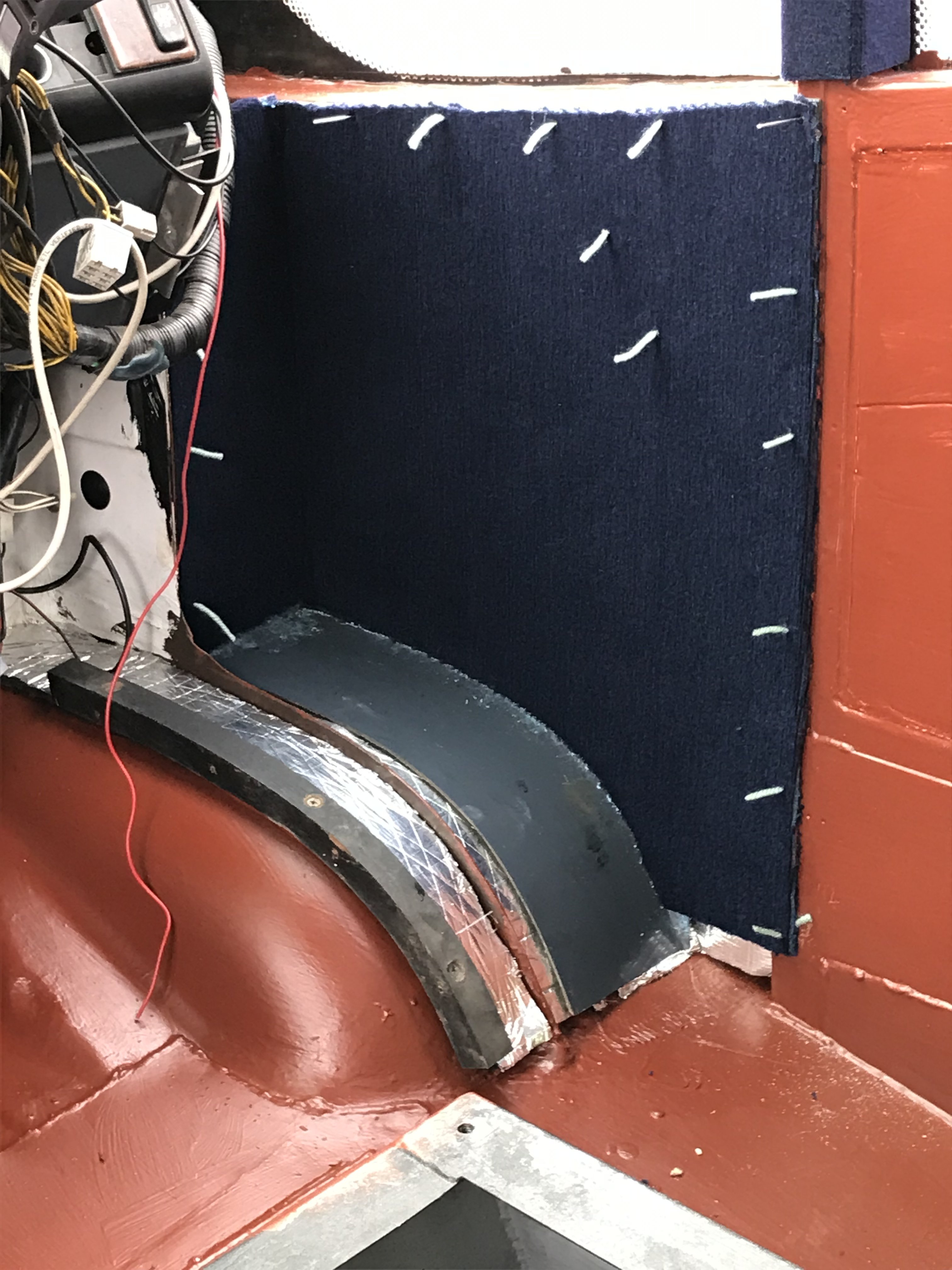

After more insulation I trimmed some more panels and tried to shoehorn them in. It’s a right swine trying to find the screw holes. I think everything was fitted poorly originally as nothing fitted as I would have liked. It’s not the smartest work and I’ve never claimed to be a coach trimmer. At least it’s better than it was.

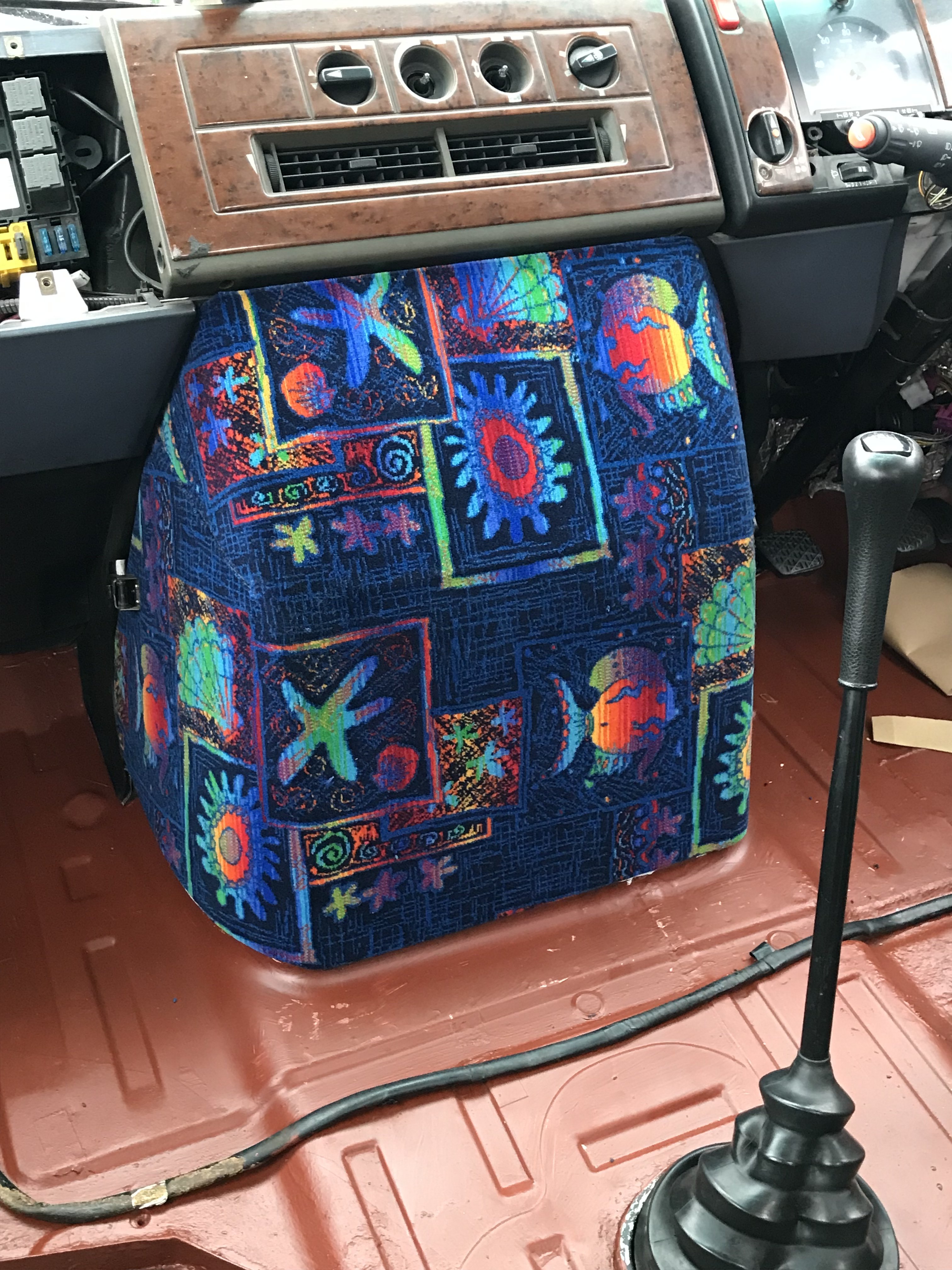

I managed to buy a trim panel that covers the steering column and top of the pedals. Unfortunately it was for an early model and didn’t fit over electronic throttle pedal. So look up the part number and see if anyone has one. Low and behold eBay Greece. Just hope it’s not left hand drive.
As I didn’t fancy it I volunteered Anita to insulate behind and under the pedals. I decided to tackle the engine cover. It had a horrible quilted bag over it. Under this the features in the cover had been panelled over. I was worried that these would show.
The fabric was made by Camira fabrics as we wanted some cheerful highlights. Not cheap, but this build is a money pit.
Fear kicks in when you start thinking about the cost of making a mess of it. I thought the safest way would be to cut the fabric too big. Cut too small and you waste the lot. Once I was happy with the start position. I spray glued the middle of both parts. This allowed me to pull on the fabric to work out the trim cuts.
It’s not as neat as I would like, but better than I expected. I’ll blame the scissors.
Whilst at it, I silver foamed the inside to help cut down on noise.

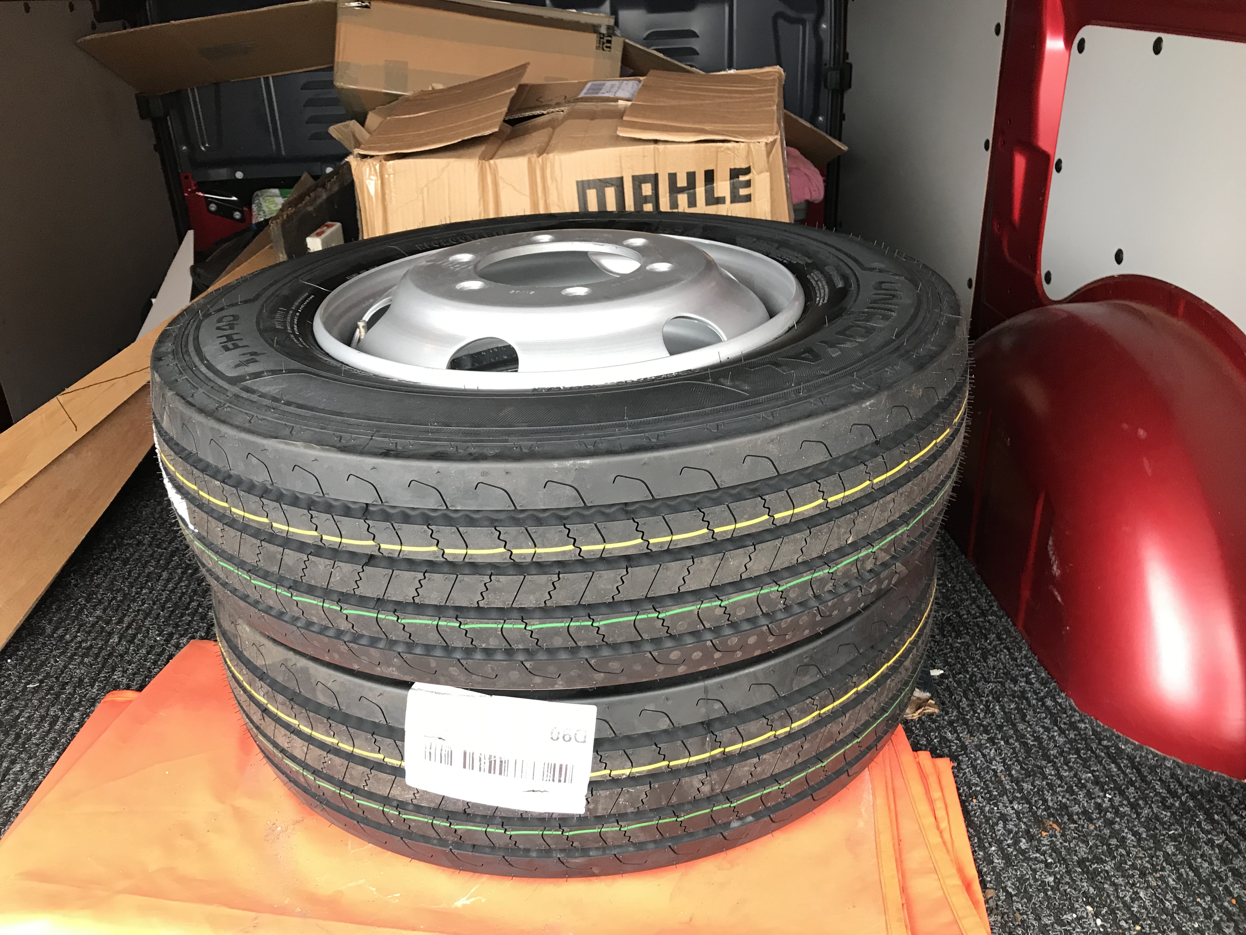

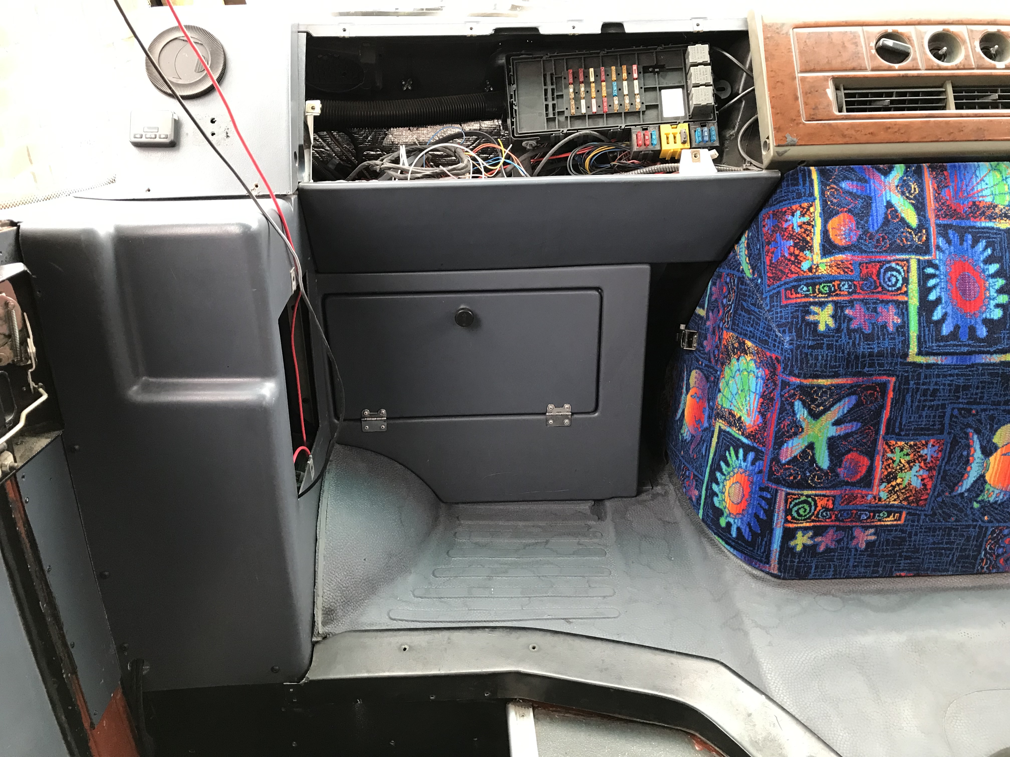

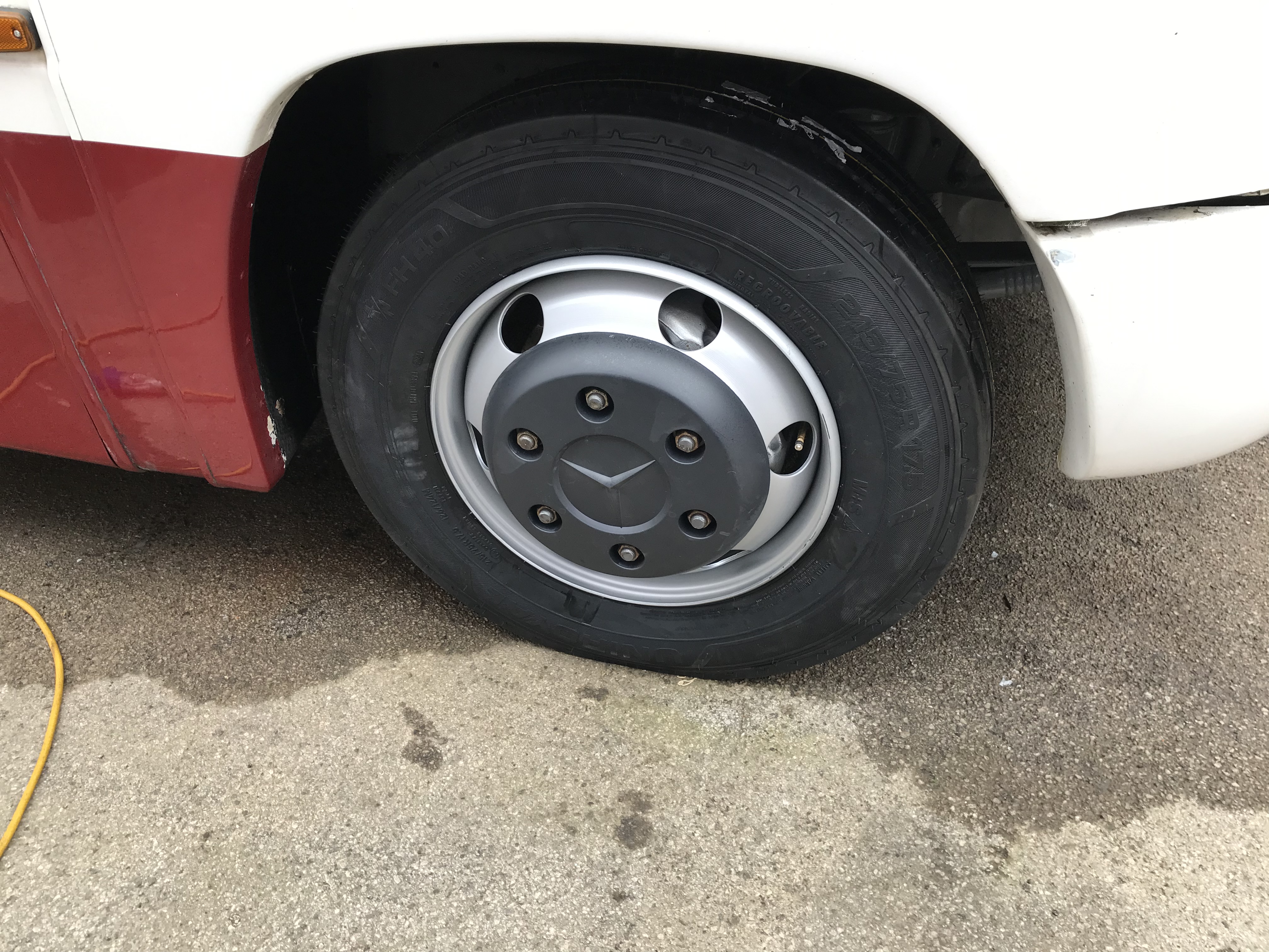

Not a huge amount of progress and only one day available again this weekend. That said it’s finally back on it’s wheels again. I still have to get the wheels aligned enough to drive it to an MOT, but it’s good enough to move it around for now. A bit more wiring put in place for the radio, and some more insulation. The front mat is horrible, but still good enough to keep the noise down. Anita did put down some silver foam insulation first. The extra thickness did make it a bit of a fight to get some of the panels in, but it’s coming along.
The drivers mat will be hidden with a tailored carpet. I’m hoping Monday I will have an email saying they can supply new foams for the Kab 714b drivers seat.
The big surprise is how well Morris Traffic Film Remover brightens up the old panelling.
