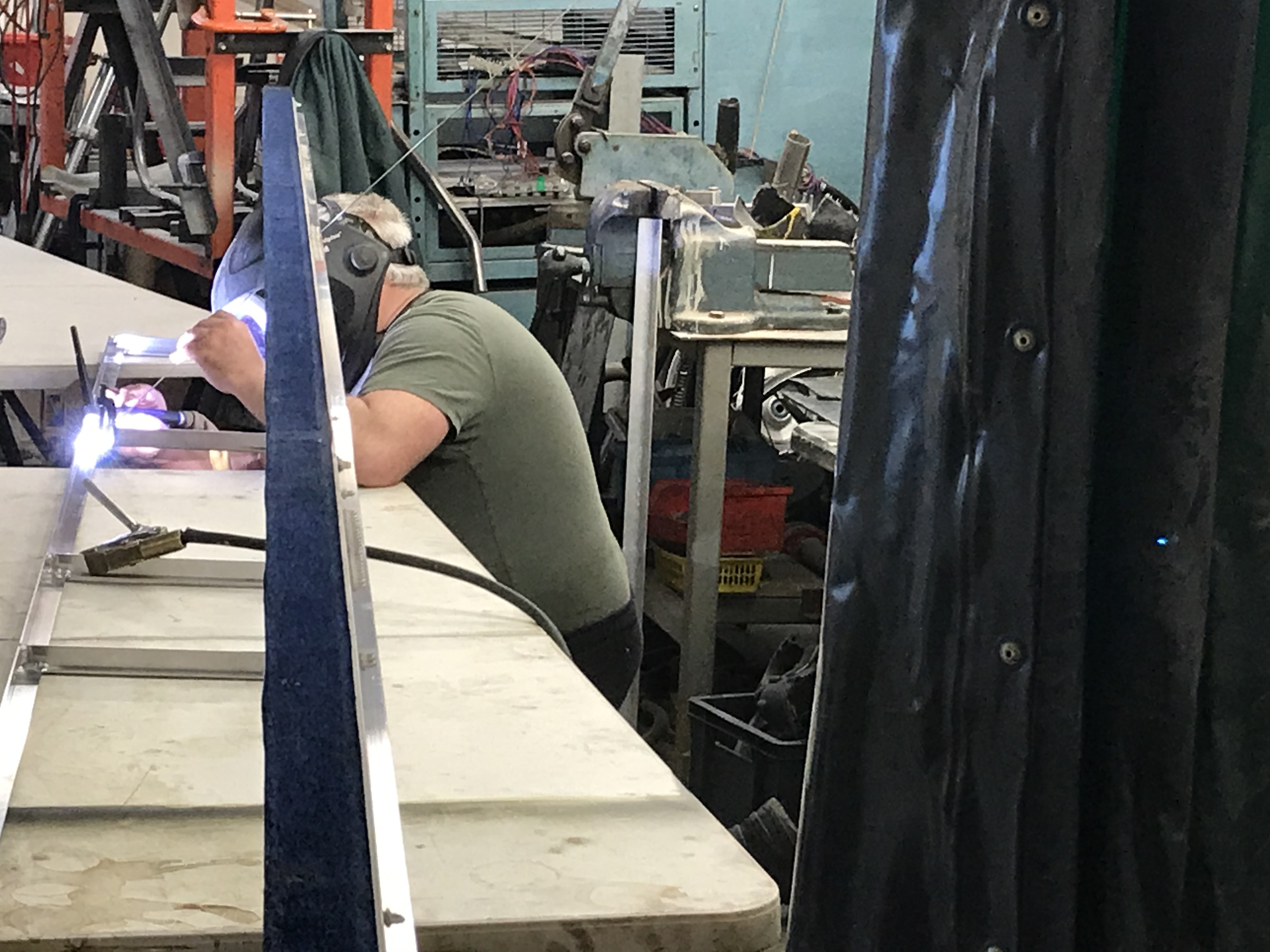

Thought I would muscle in and post something seeing as Mark always does the posting. Here he is cussing whilst doing the welding for our overhead storage lockers. Its a job he has been putting off but its taking shape :)

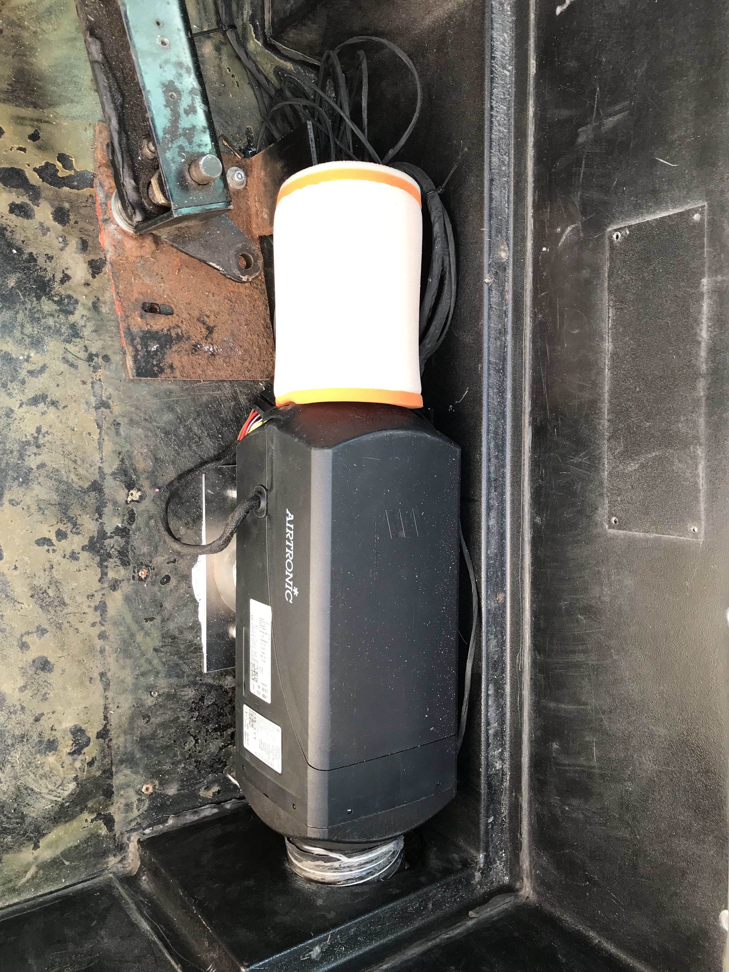

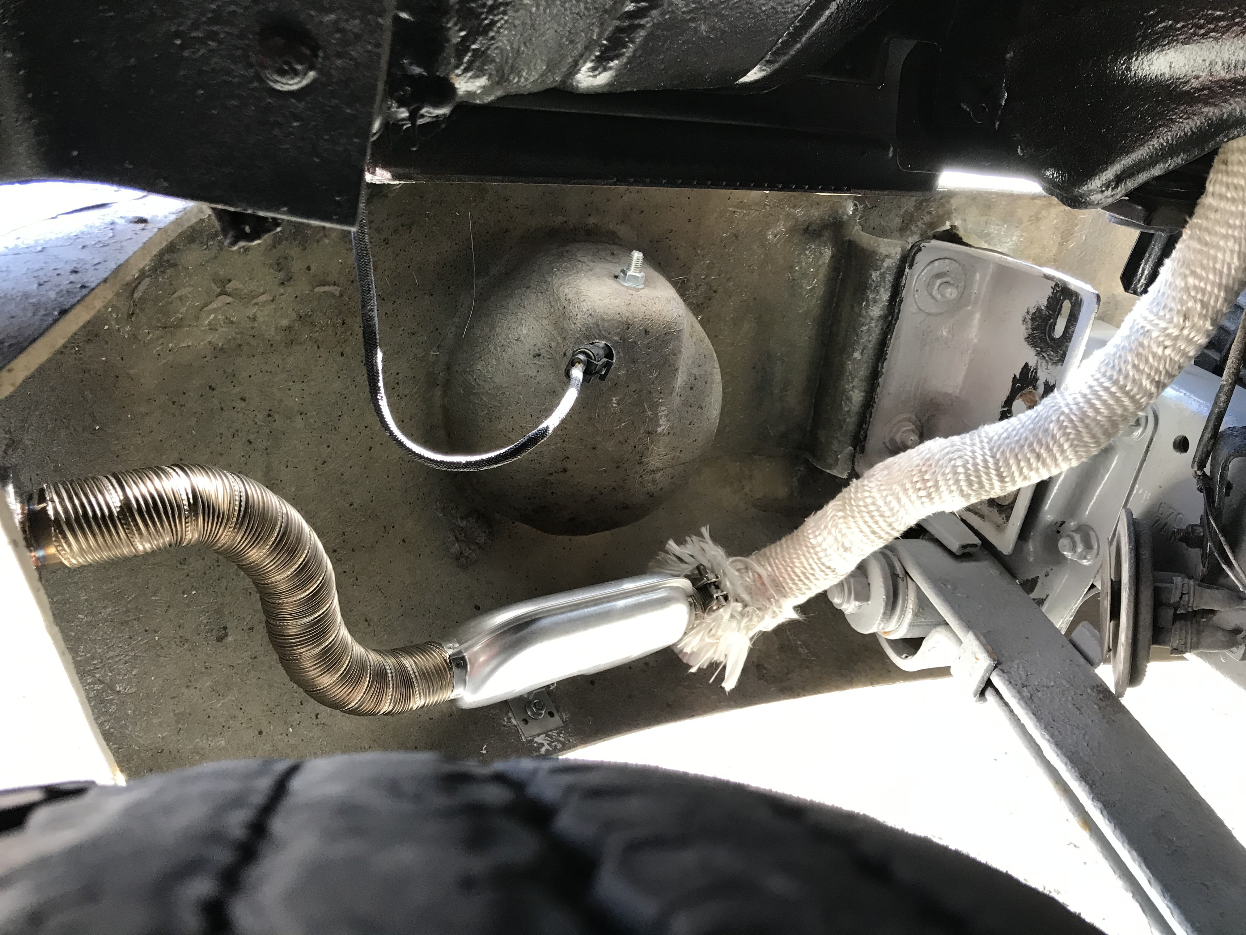

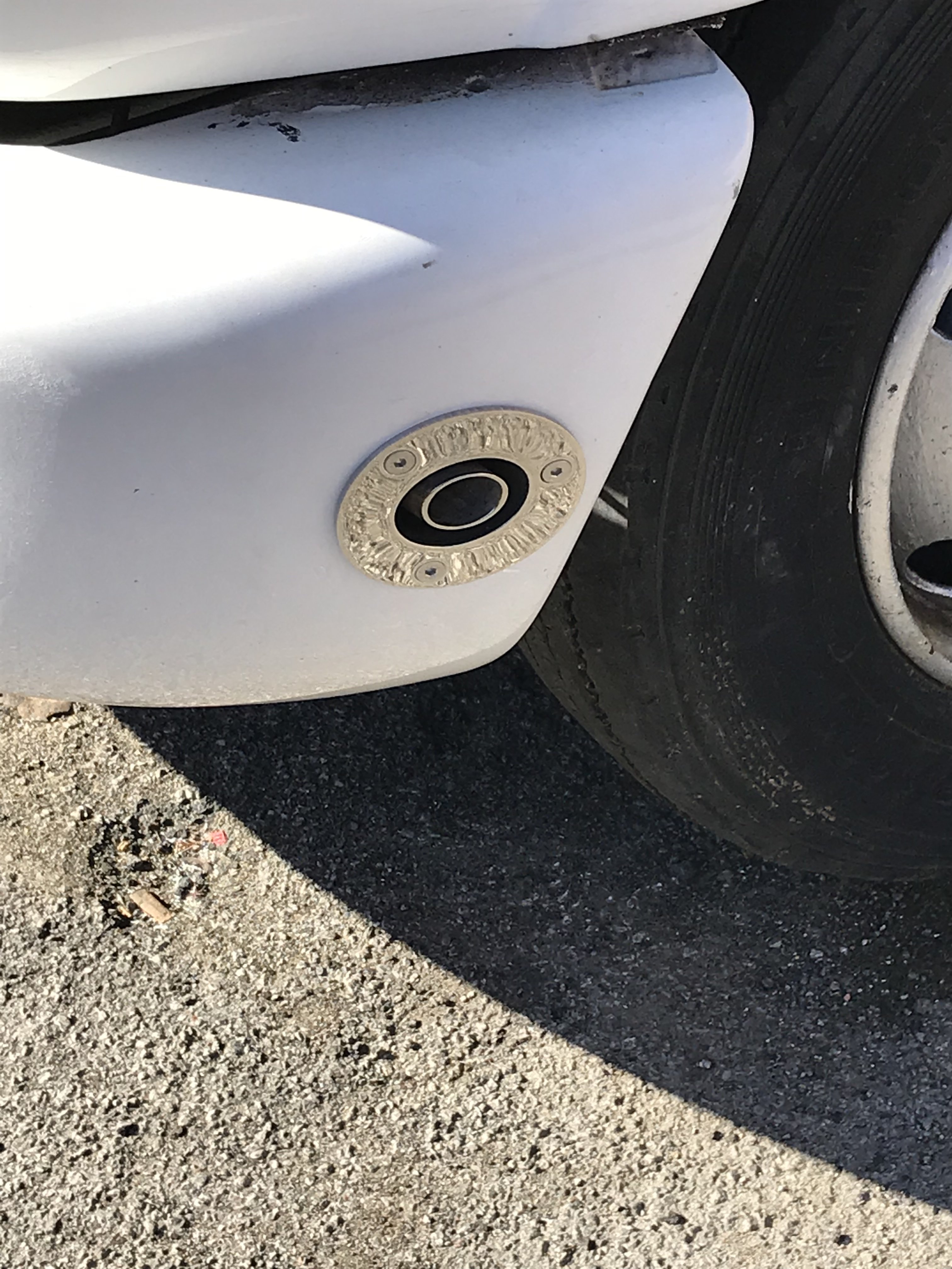

The MII eberspacher has finally got an exhaust outlet, though still some tidying to do.
No sign of the air eberspacher from Mellors yet. :(

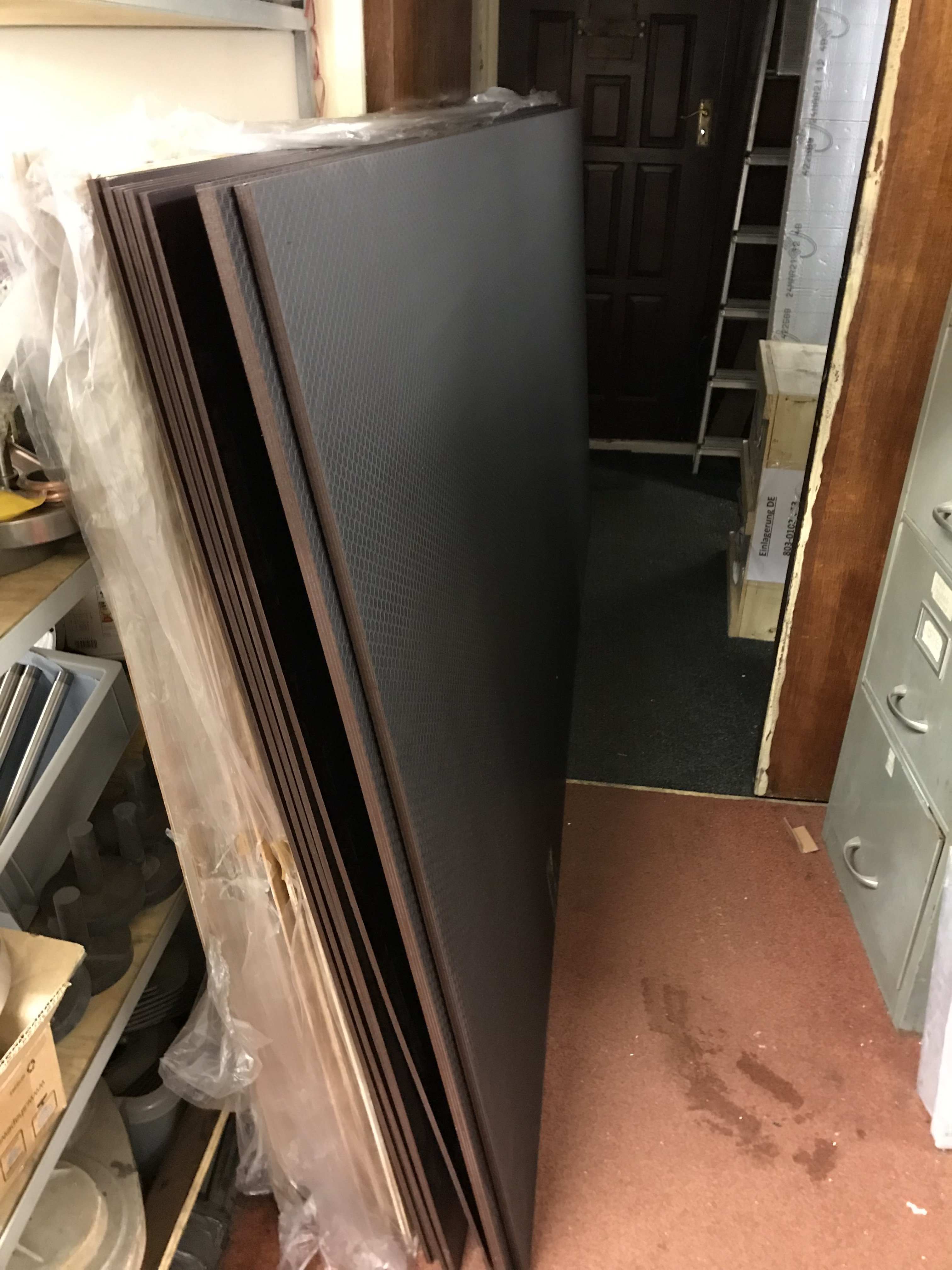

This morning sheet material arrives from Latham's. All 0.26 tonnes of it. Now it's stuck in the door way until we have time, weather and space to work with it. 12mm for the garage floor and entrance step. 6mm for the inner shower room walls. 3.6mm for the roof and wall paneling.

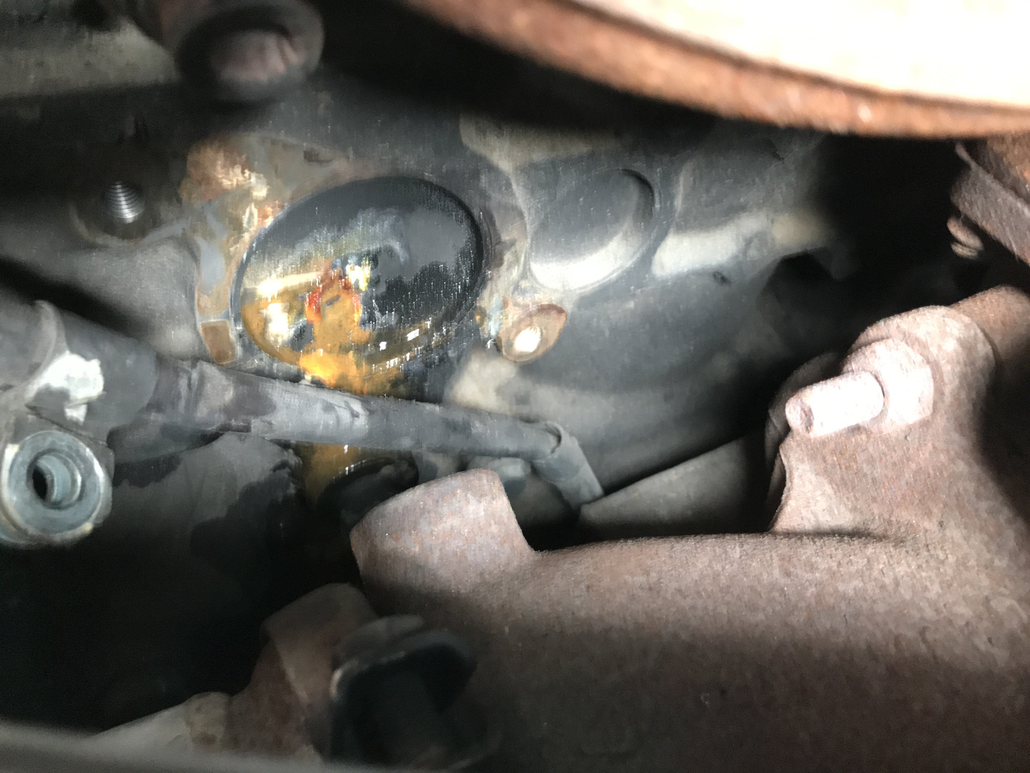

Anita has a look underneath and spots a small waterfall from the back of the engine :(

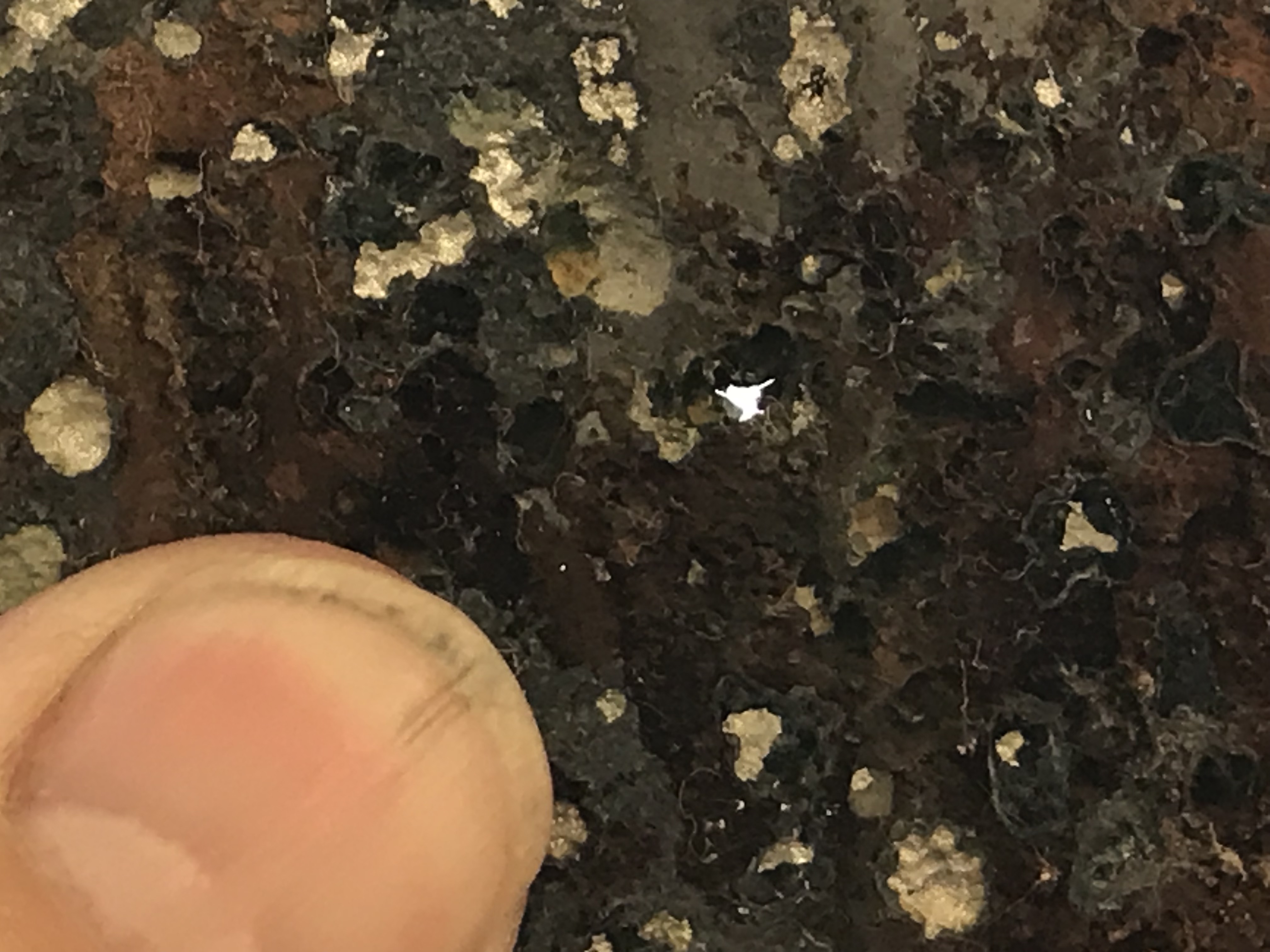

Engine cover off and removes a cover and a bracket to expose a naughty core plug.
In the fight to do this I drop Anita's phone I was using as a torch. It didn't hit the floor!
Can't see it from the top, so Anita does the back wiggle and goes underneath to find it resting on the exhaust.
Out comes a very Black Anita, me thinks she'll have to wash the bottom again. ;)
Core plug removed and measured. Ordered a new one from Mercedes, let hope they are still in stock.

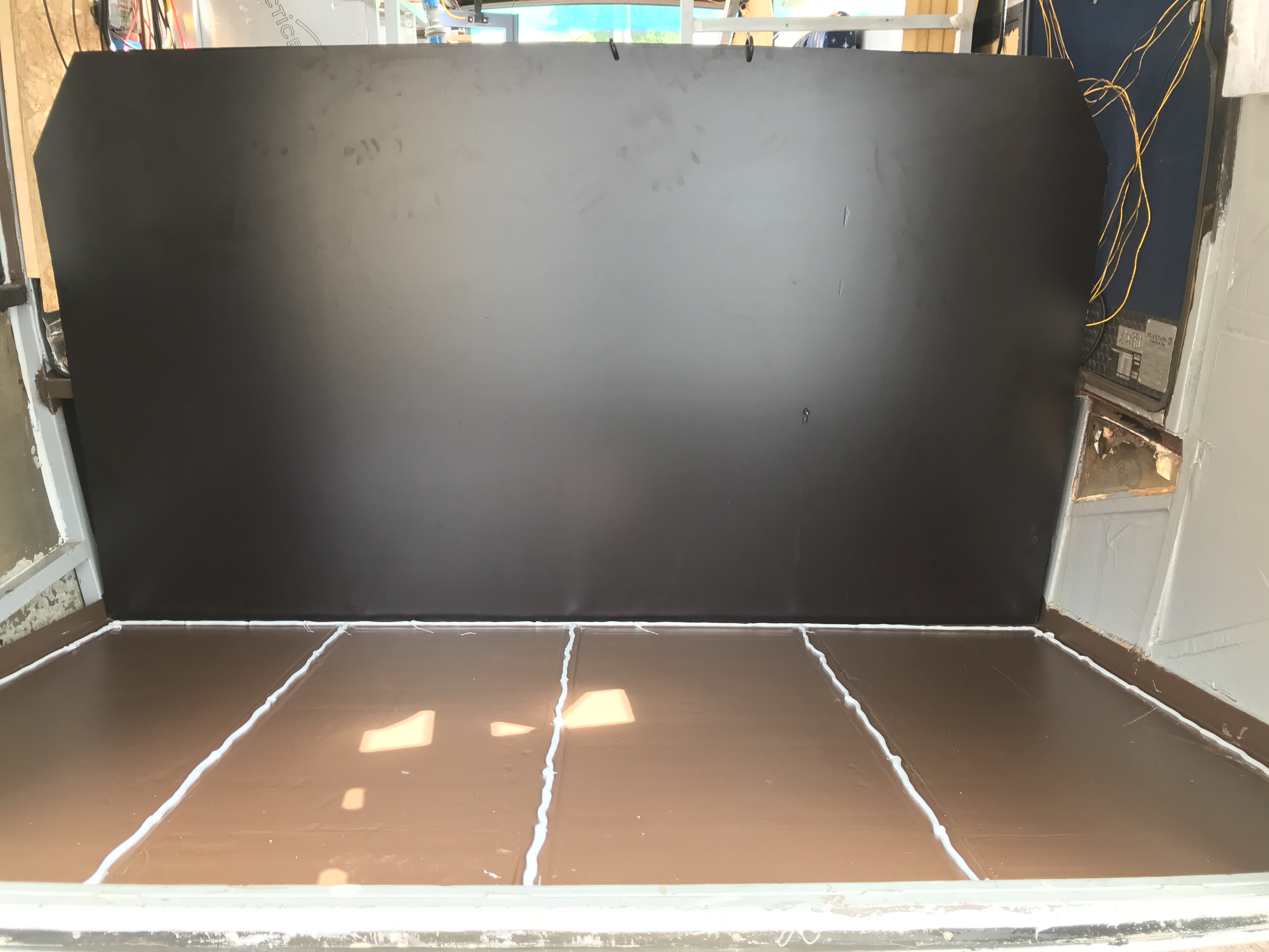

The next task was to cut and fit a new floor panel for the garage. The original was in two pieces, but I was convinced it could be done in one. Extra coats of paint were applied to the frame first to give it a cushion. Left to dry overnight. After doing a test fit, it was decided not to remove it again. A generous bead of pu mastic was applied to the steel work before refitting the panel. Then the labourius job of screwing it down. I will remove all the screws one by one and seal them with flexible epoxy.

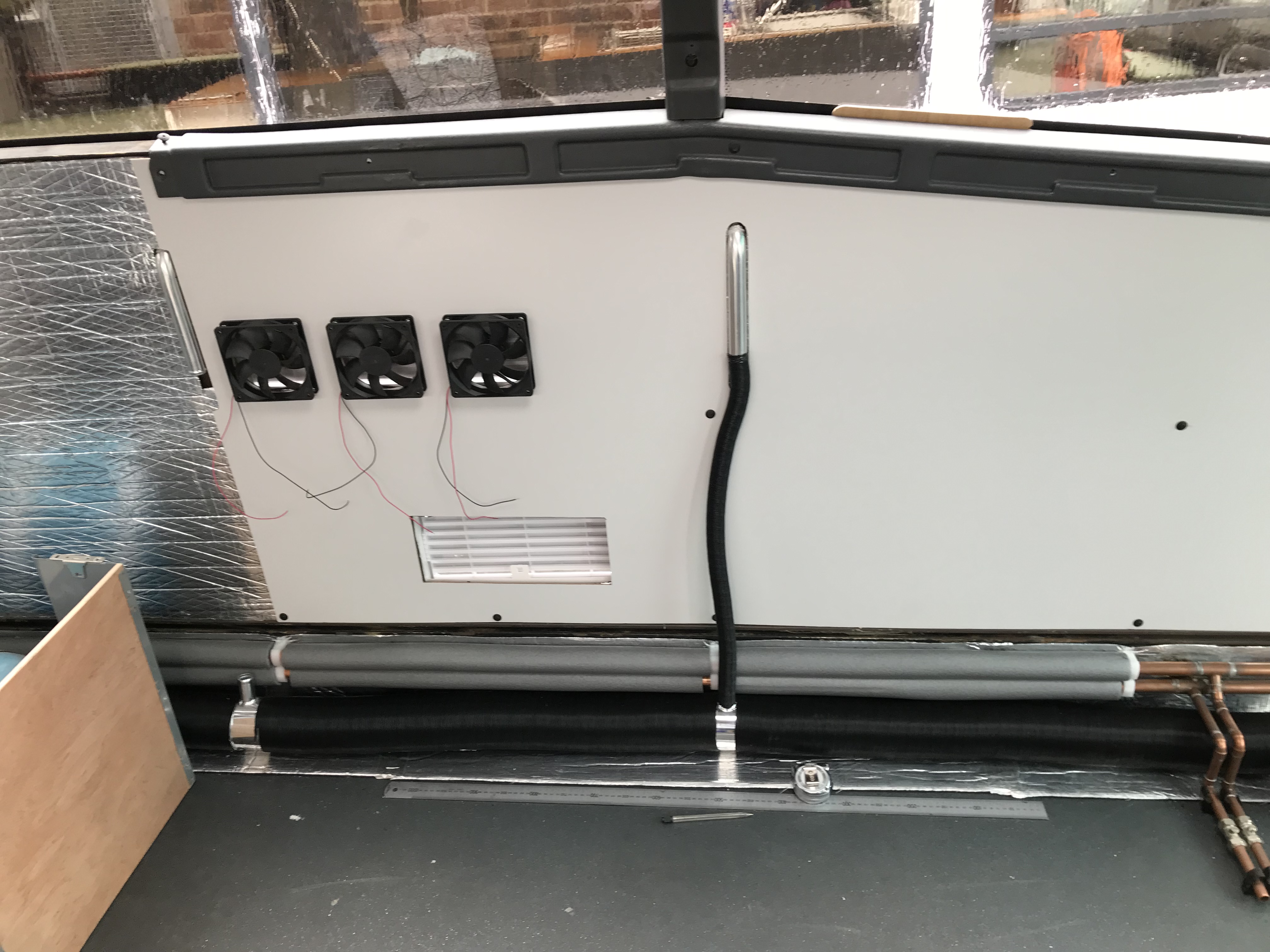

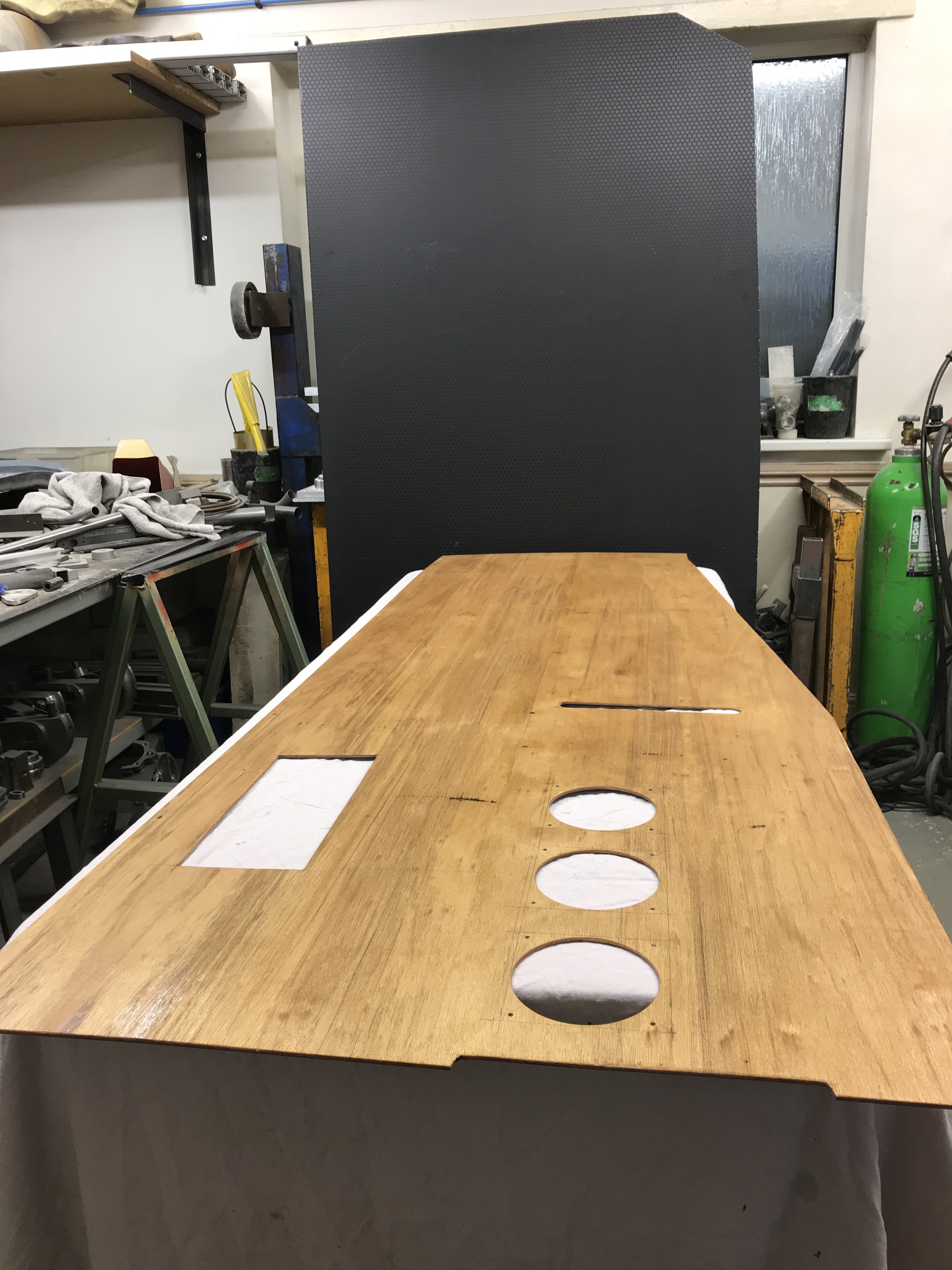

Habitation next. This should be the most complicated wall panel. So worst first and it can only get better. With Anita stopping me being stupid I think we did quite well. I did mess up and ordered the wrong size panel clips so was only able to attach one panel. We did cut another. Each panel had its edges sanded before sealing the edges and backs with yacht varnish. Incorporated into the first panel was three fans for extracting heat from the fridge. Very small M4 fasteners, just the job for Anita.

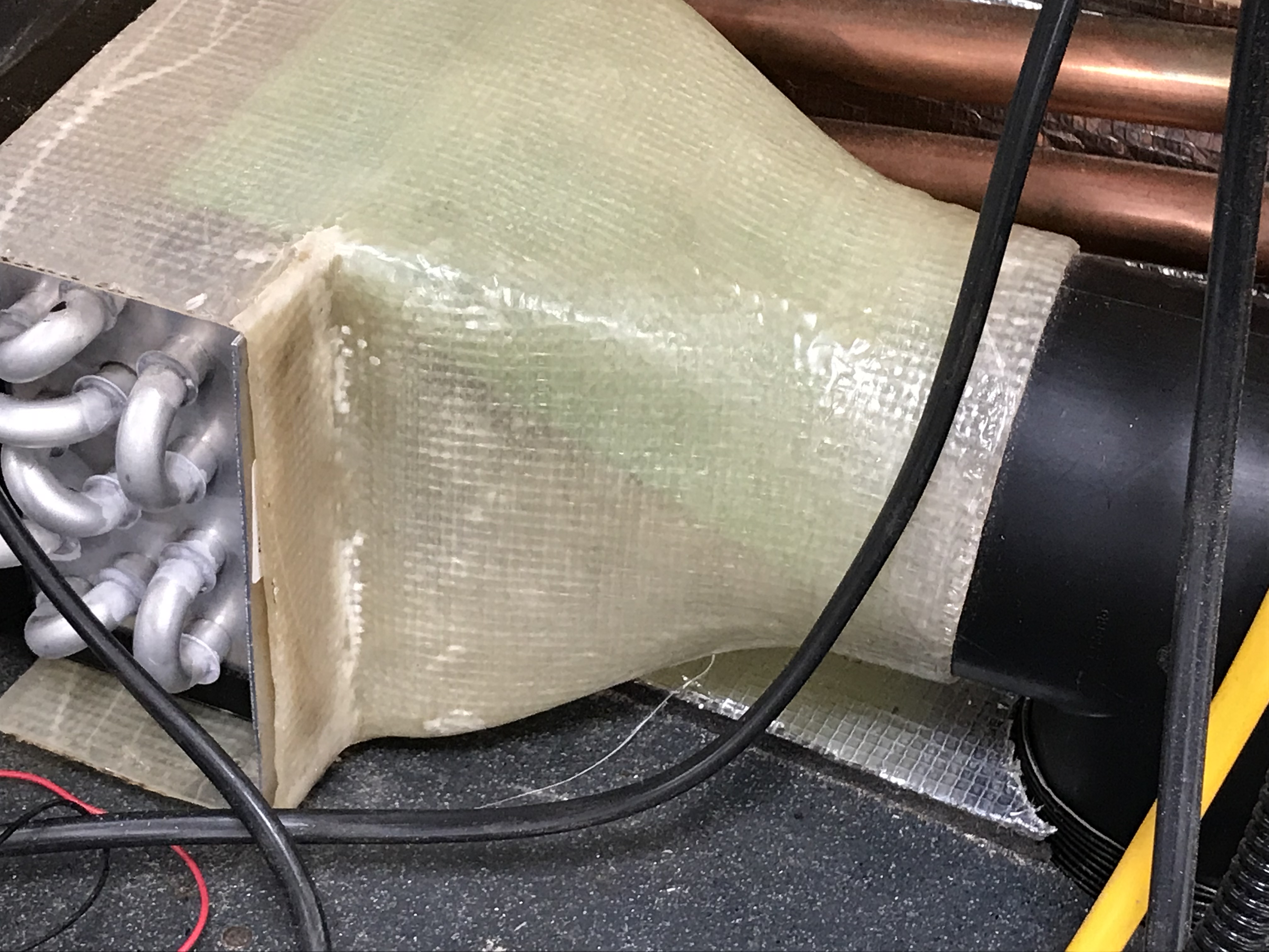

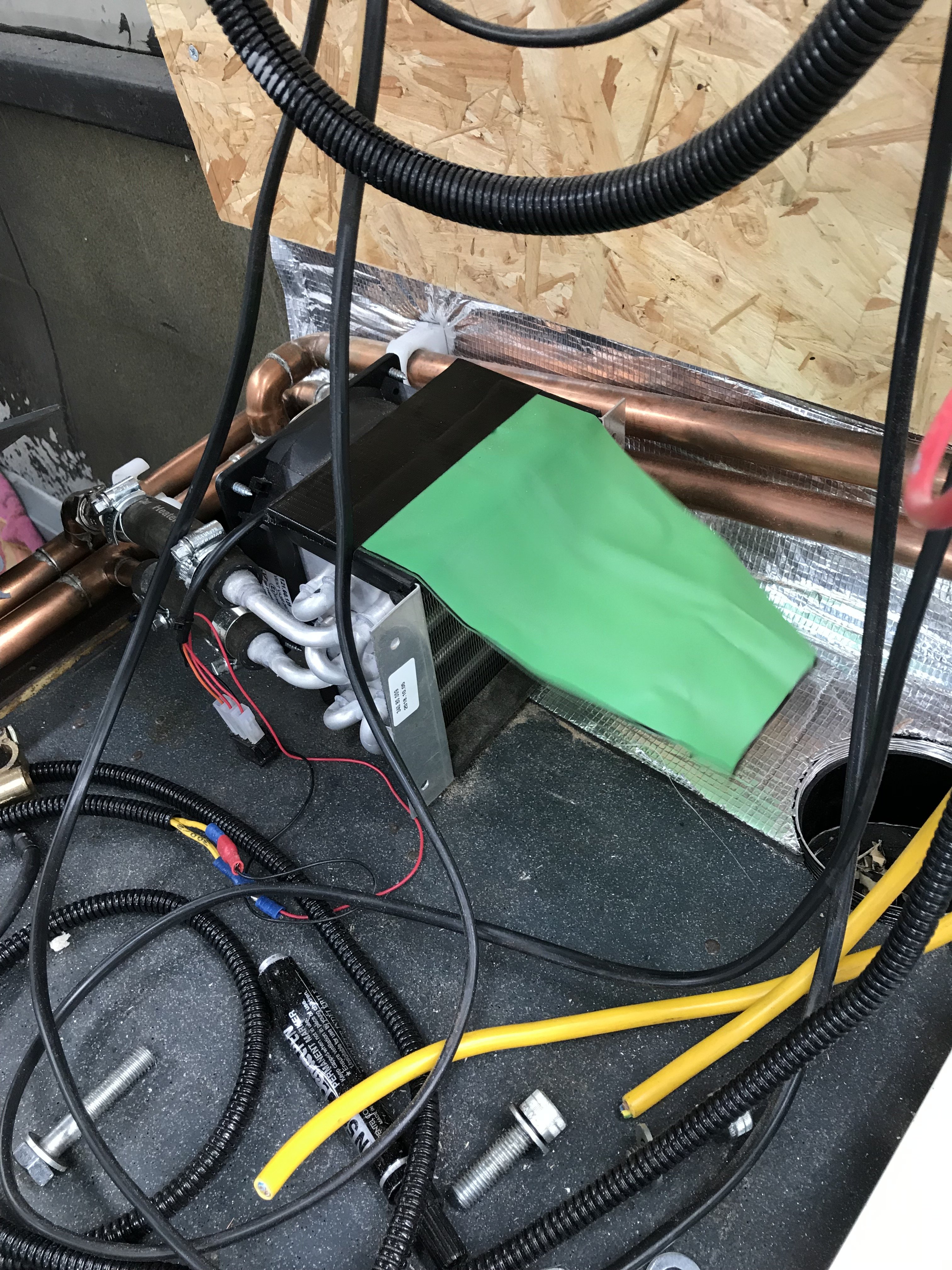

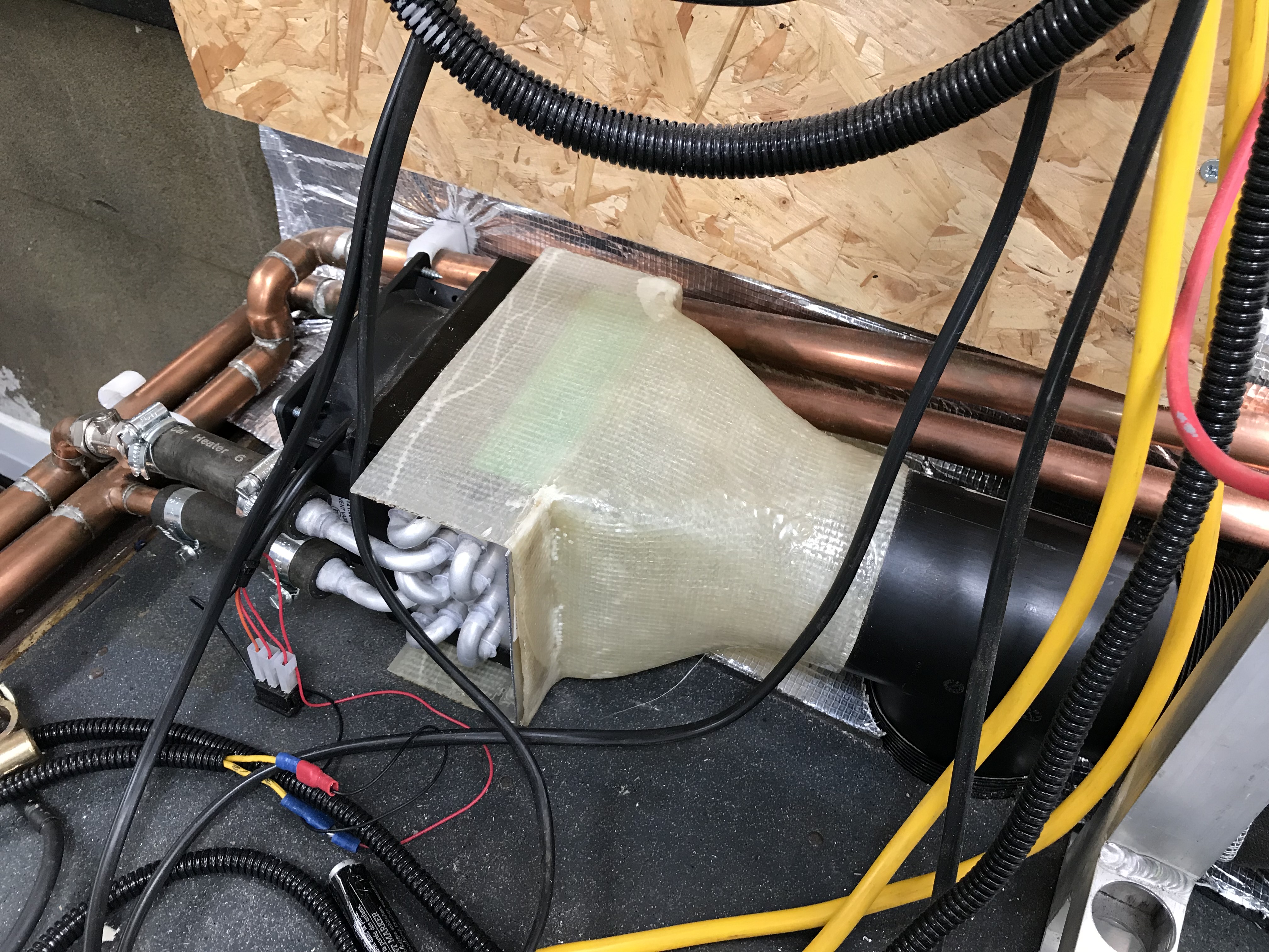

Keeping it simple. I have an air blown eberspacher connected to a length air hose. This runs from one end of the coach to the other. At the other end of the hose I have a water heated fan heater. This has been adapted to also blow into the same length of hose.
When the water heated heater is working some heat passes through the ebsepacher and warms the step area. This heating is normally used whilst driving. There are other air outlets along this hose. This setup seems to work as expected, though not tried on the road yet.
When parked up the air eberspacher will be used. The problem is and was expected, is that hot air is lost from the water heated fan heater at the back! Yes I could put a mechanical valve in place, but that's something else to remember. And no, a Pi controlled servo isn't going to happen.
Some kind of paper gravity controlled flap was my first idea, but I'm not that clever. So a polyurethane rubber flap was made. The pictures show the first test. Then the test with the eberspacher working. Very little heat being lost. Finally the water heated fan heater working. You can see the green rubber conforming to the translucent adapter. BTW the water heated fan heaters are mounted in the garage area.

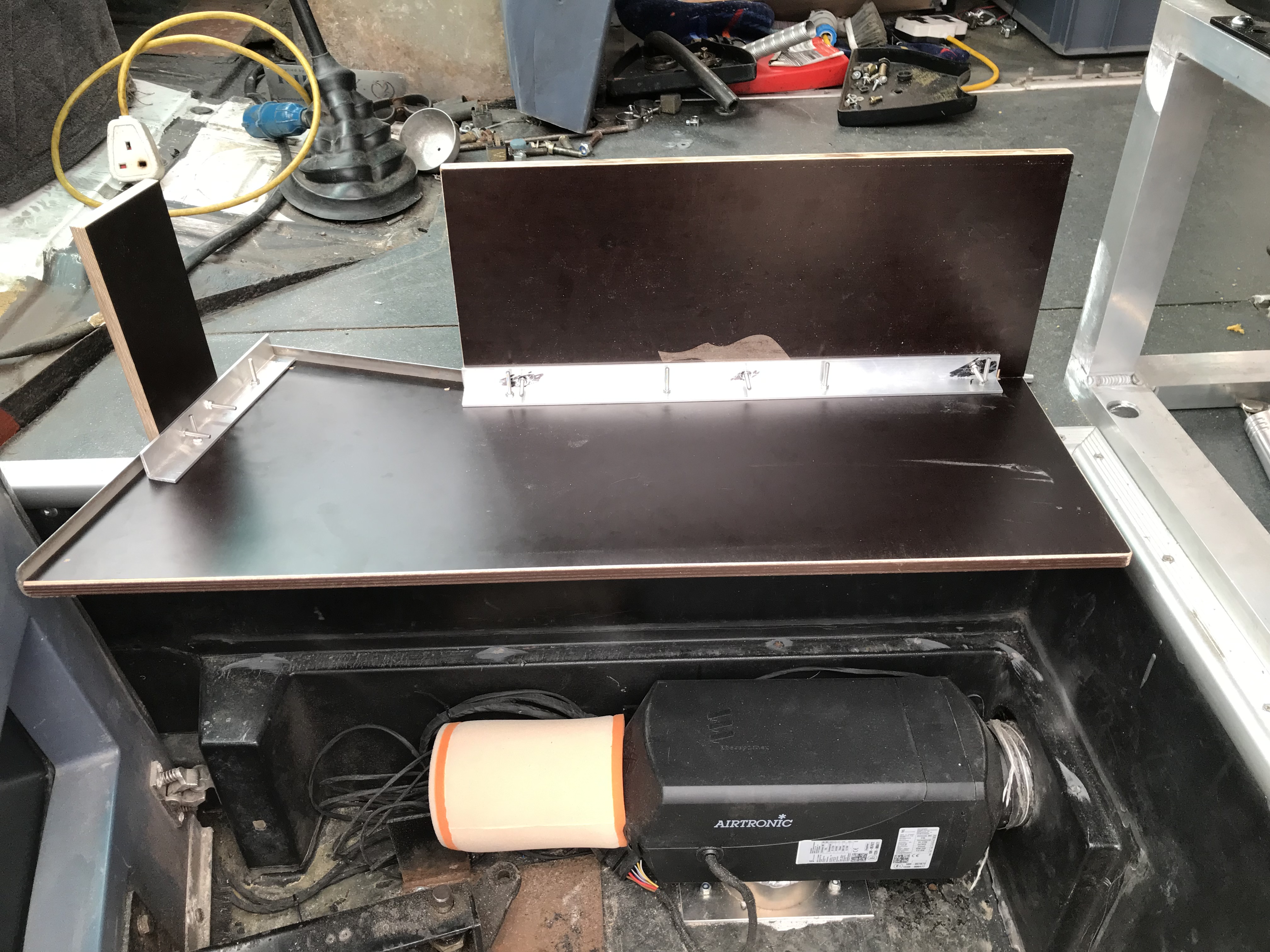

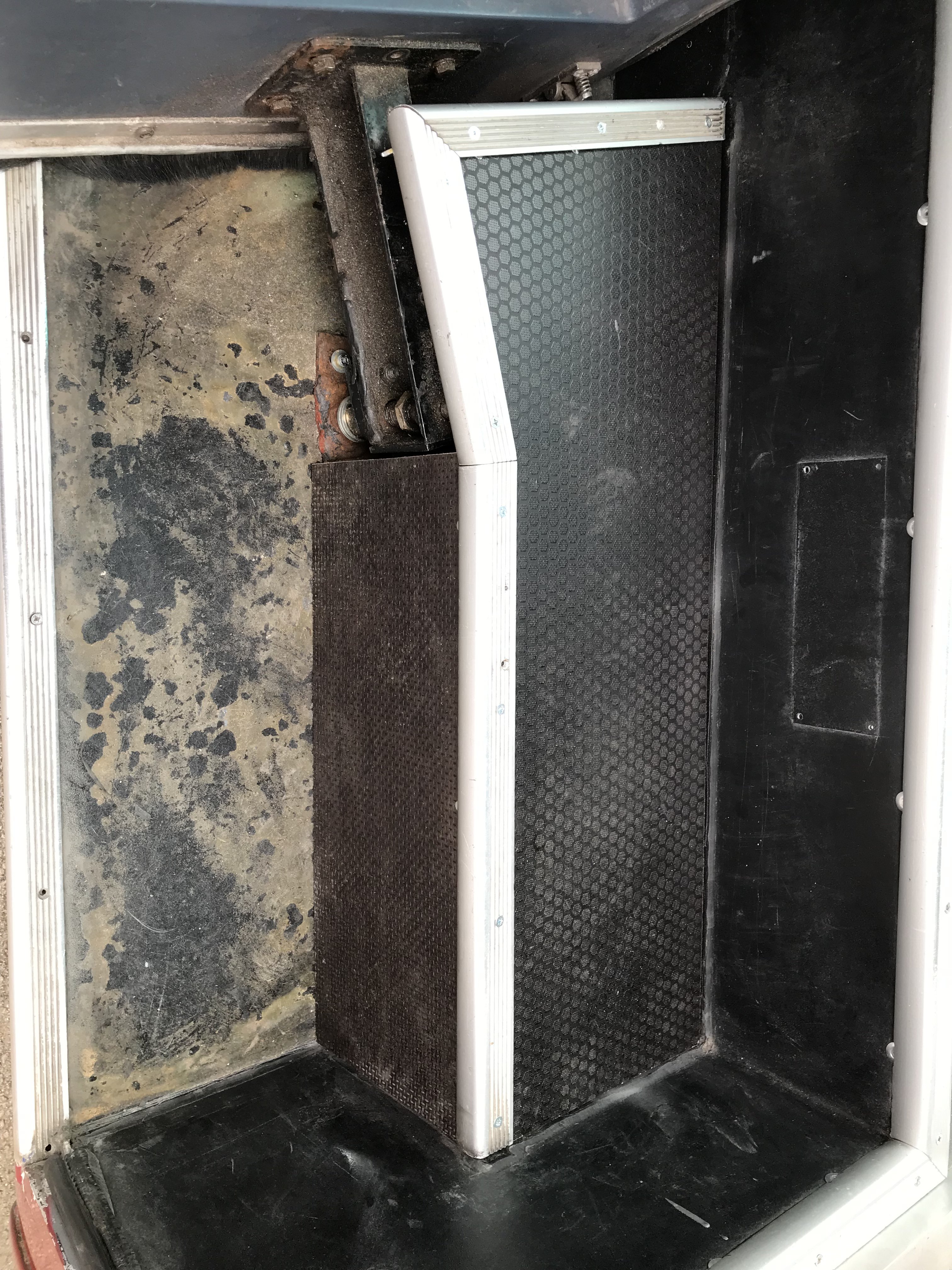

Time to step up to another challenge. I’ve been putting this off for a while, but I don’t know why. A new step is required as the original is rotting. One of the pains being is that it also has to be a removable cover for the eberspacher. The eberspacher has a washable foam filter, so once in a while it would be best to clean it. I’ve also to install an entrance light and door switch. The original lamp was horrible, so I hope to do better. Finding the wiring will be fun as it was part of the air door system, I’ve removed all that. Any ways a couple of progress pictures.

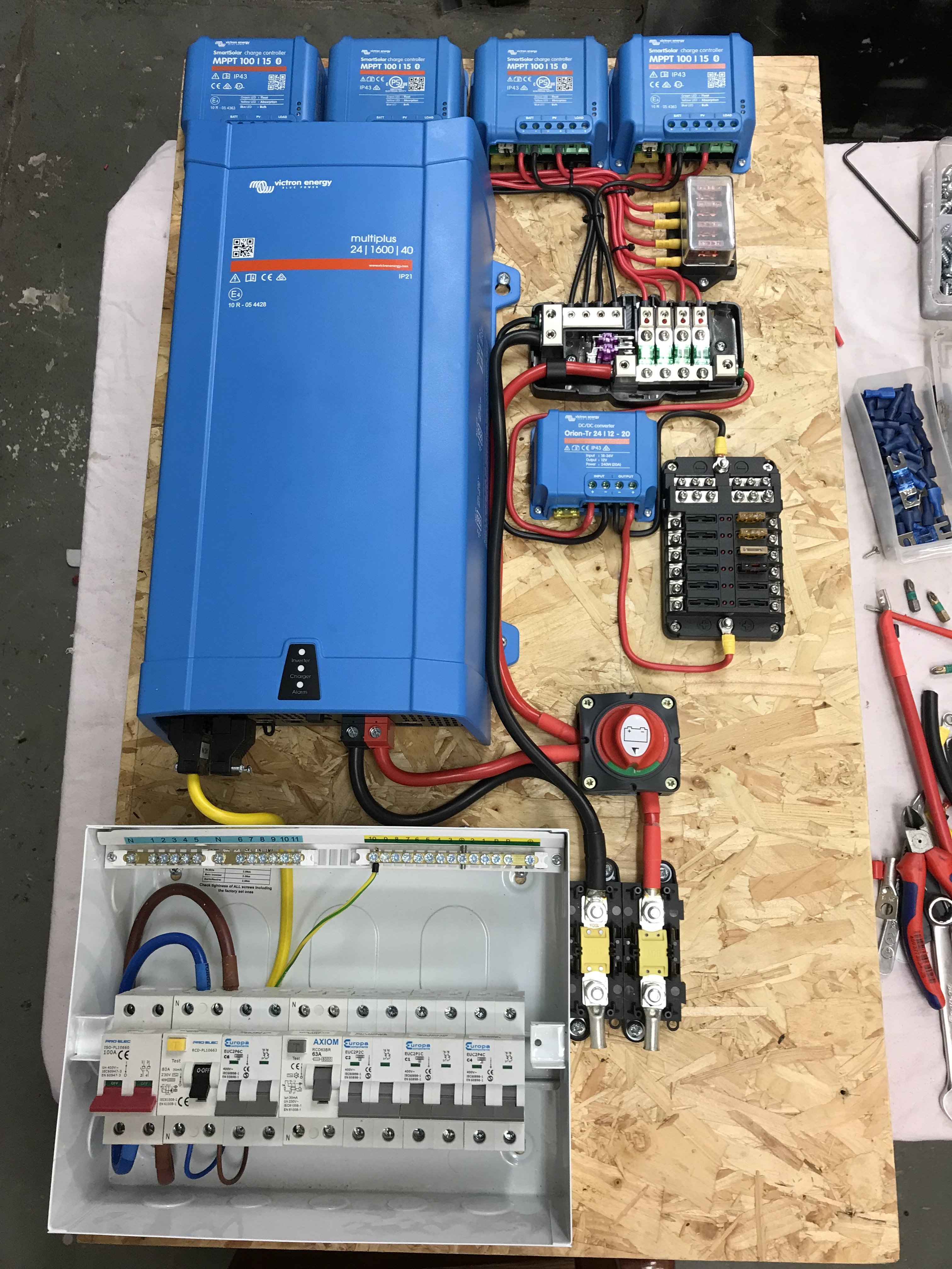

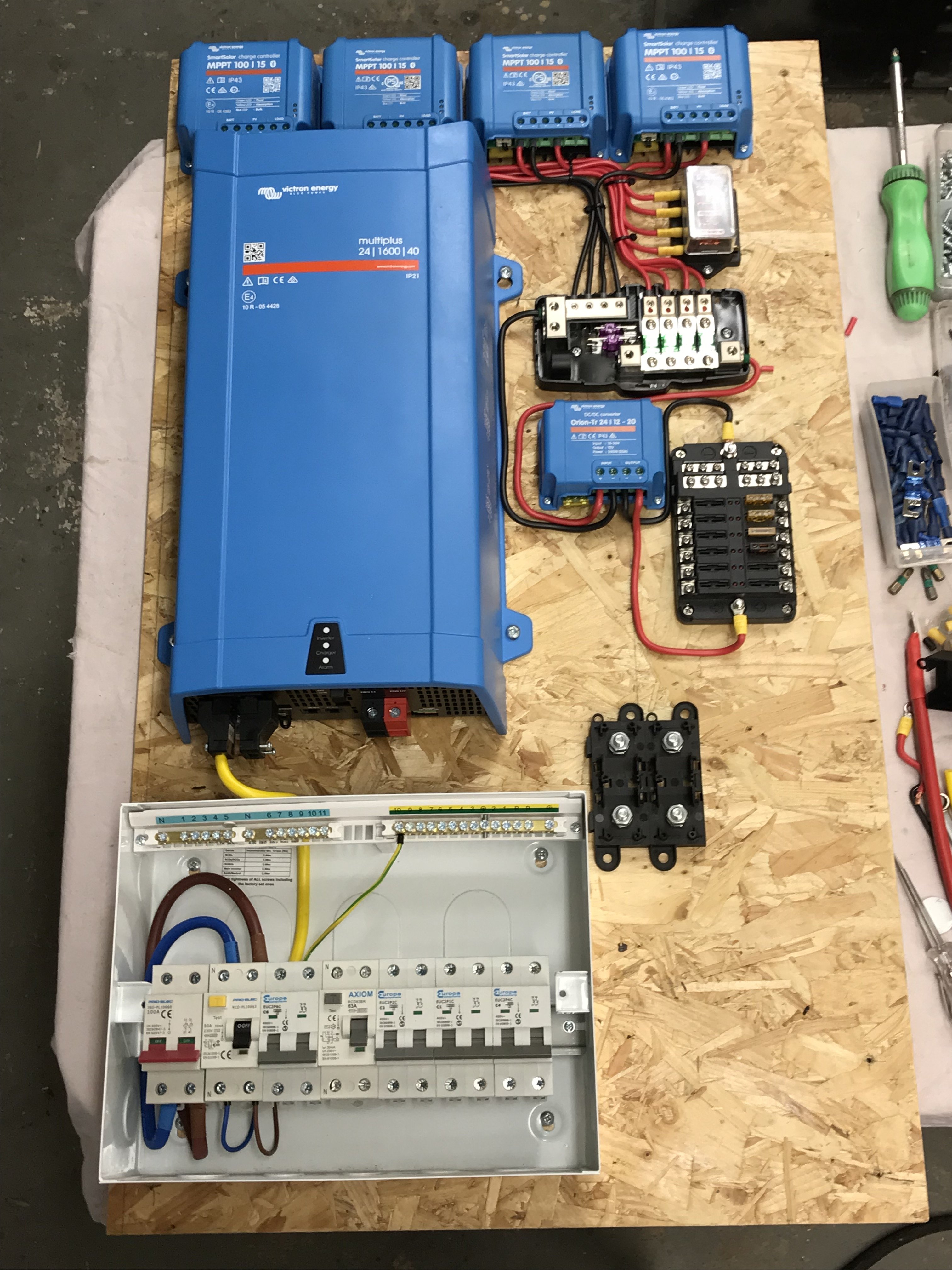

A few more additions to the electrical cupboard. Hopefully I'll be able to shoehorn some relays into the consumer unit. Yes I know the yellow cable is too small, another reason a lack of bits stopped play.
1.5mmsq is actually supposed to be up to the job, but I'll go to 2.5mmsq.
For that length of cable I really would't worry :) 1.5mm2 is good for something like 15.95A and the multiplus has a 16A limit.
(I'd be replacing the L and N connection cables though with fatter ones (they do seem to be in a funny position as well?))
As I’m going to have to buy 50mtrs of 2.5mmsq, I’ll do the lot in it. No I haven’t connected live to neutral lol.

That is very neat indeed (y)
I have just this morning disconnected just about EVERYTHING in my installation to redo. Your cabling is putting mine to shame! (I would post a pic of mine but it would be X-rated for Horror :( ) It's all going to be connected the same again, but look a lot tidier and look more logical now the setup is virtually final (still waiting on my custom programmable VSDR-200 (200A Voltage Sensing Disconnect Relay) as the final piece for the Hybrid Battery but that should be fairly out the way from the rest anyway - hopefully will be programmed and tested in the next week ready to ship to me)
PS. I guess you could switch out the 2-DIN DP Breakers for 1-DIN DP Versions to make a bit more room in the CU?
PPS. Is there a particular reason why you are fusing the -ve connection to the Midi Fusebox?
