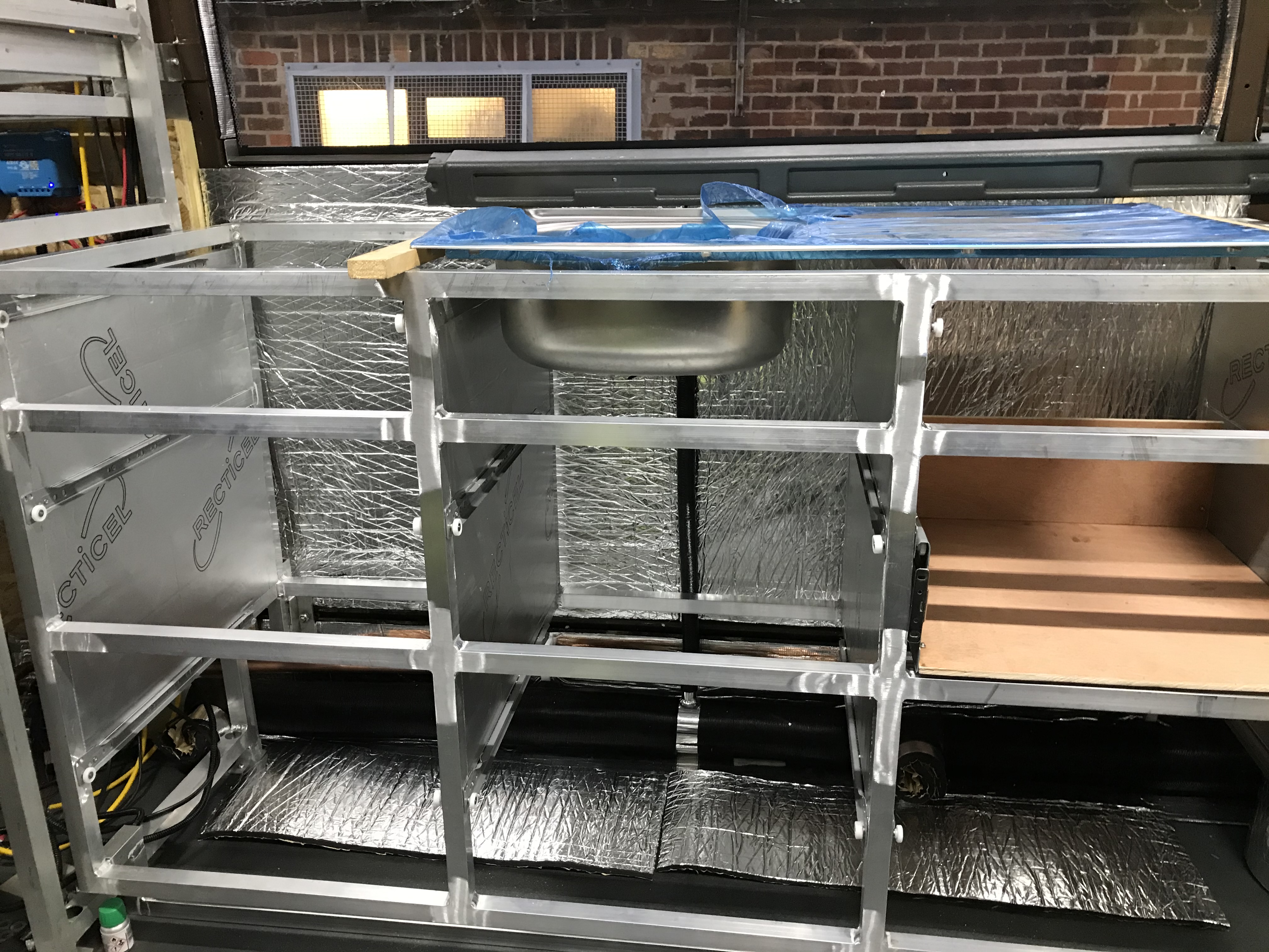

Any way moving on from laying pigeon poo, the kitchen cabinet is back in Betty. Anita made a test drawer to prove the fit. Not so good, my countersunk screws hit the rollers. Try a slimmer drawer and see if that cures it. Once we have them slipping in and out pain free, we’ll brave making a dummy front to test drawer catch ideas.
I’ve used 25mm pu insulation to divide the drawers and put some more sticky foam insulation behind.

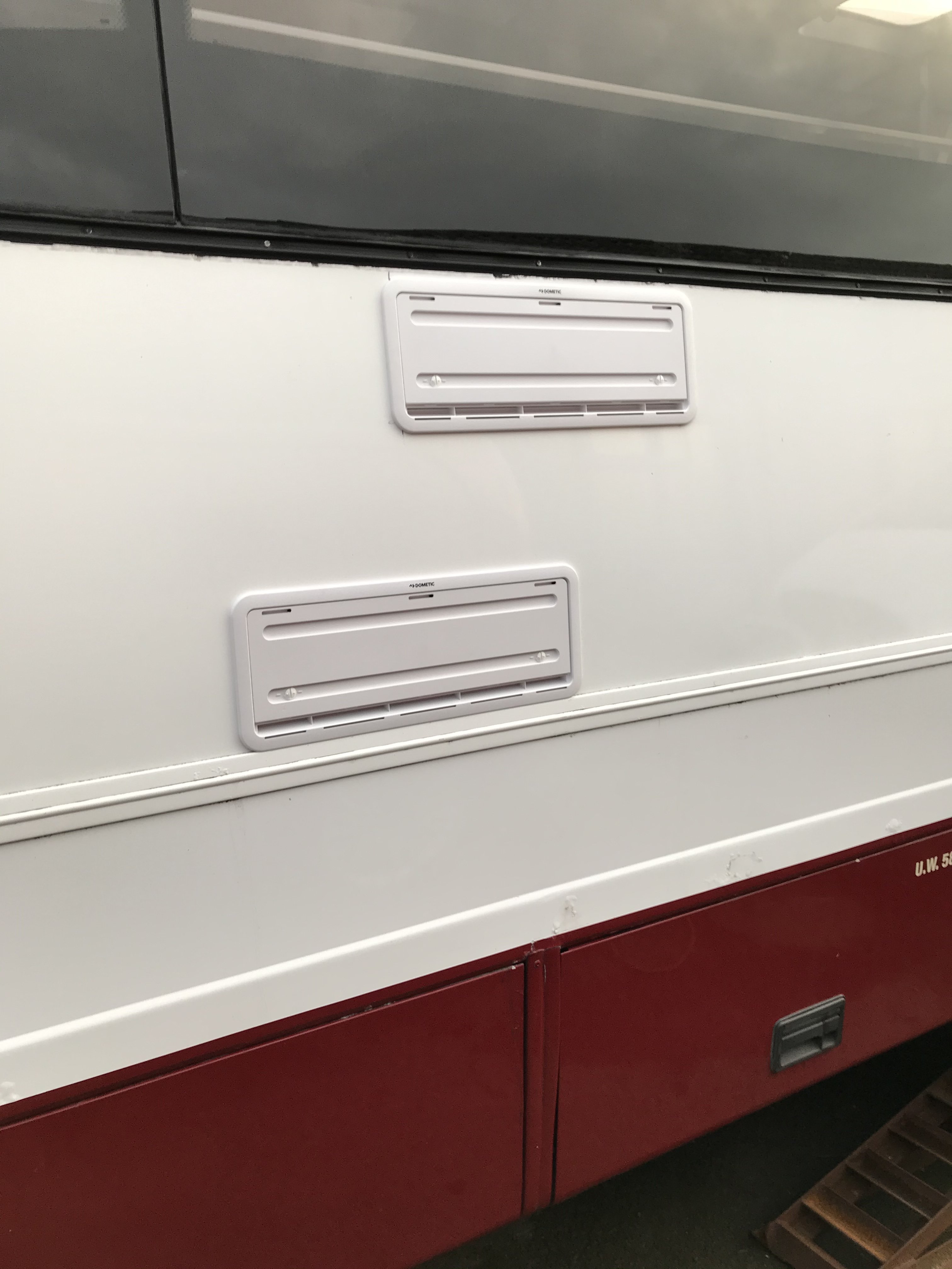

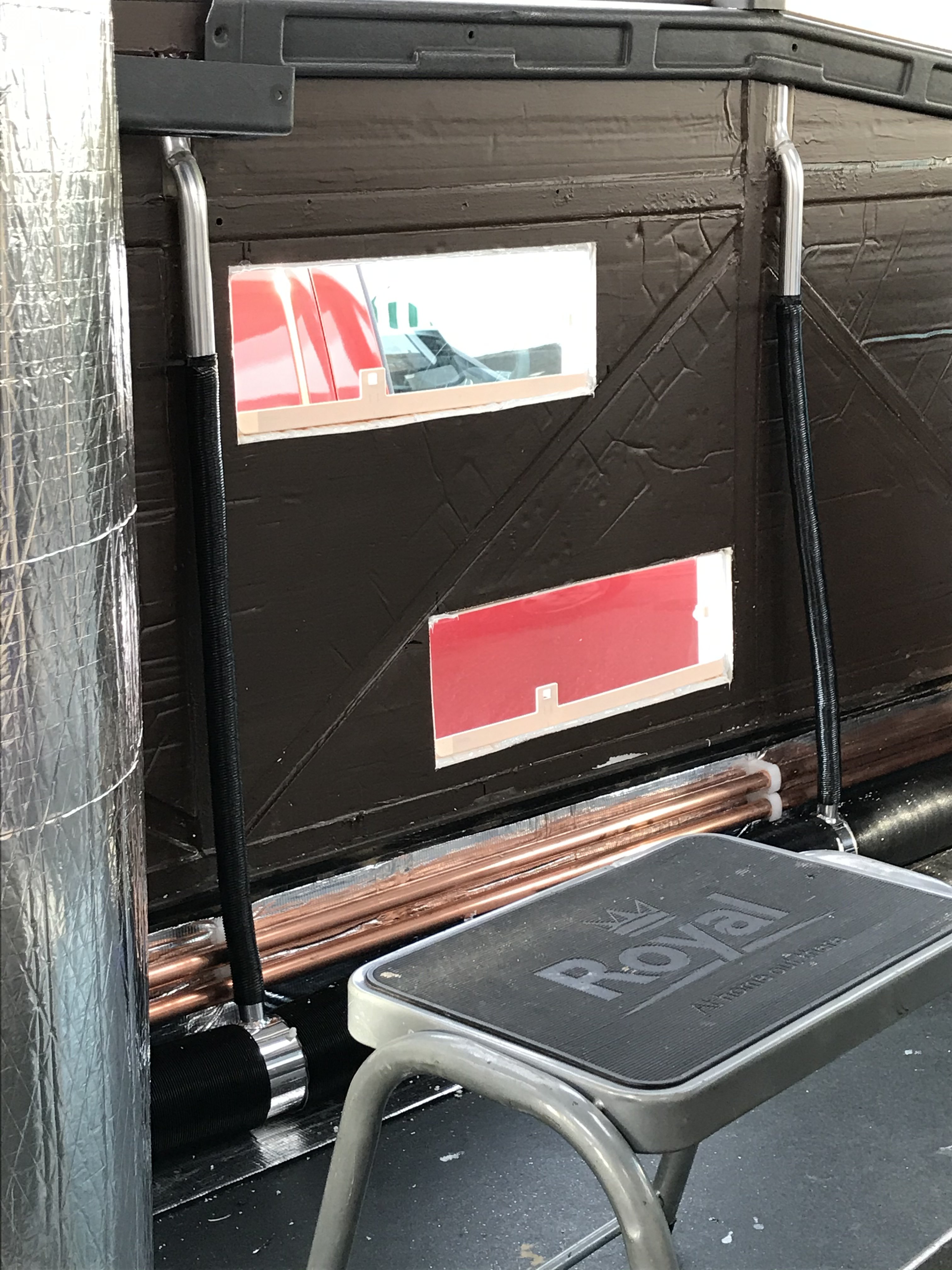

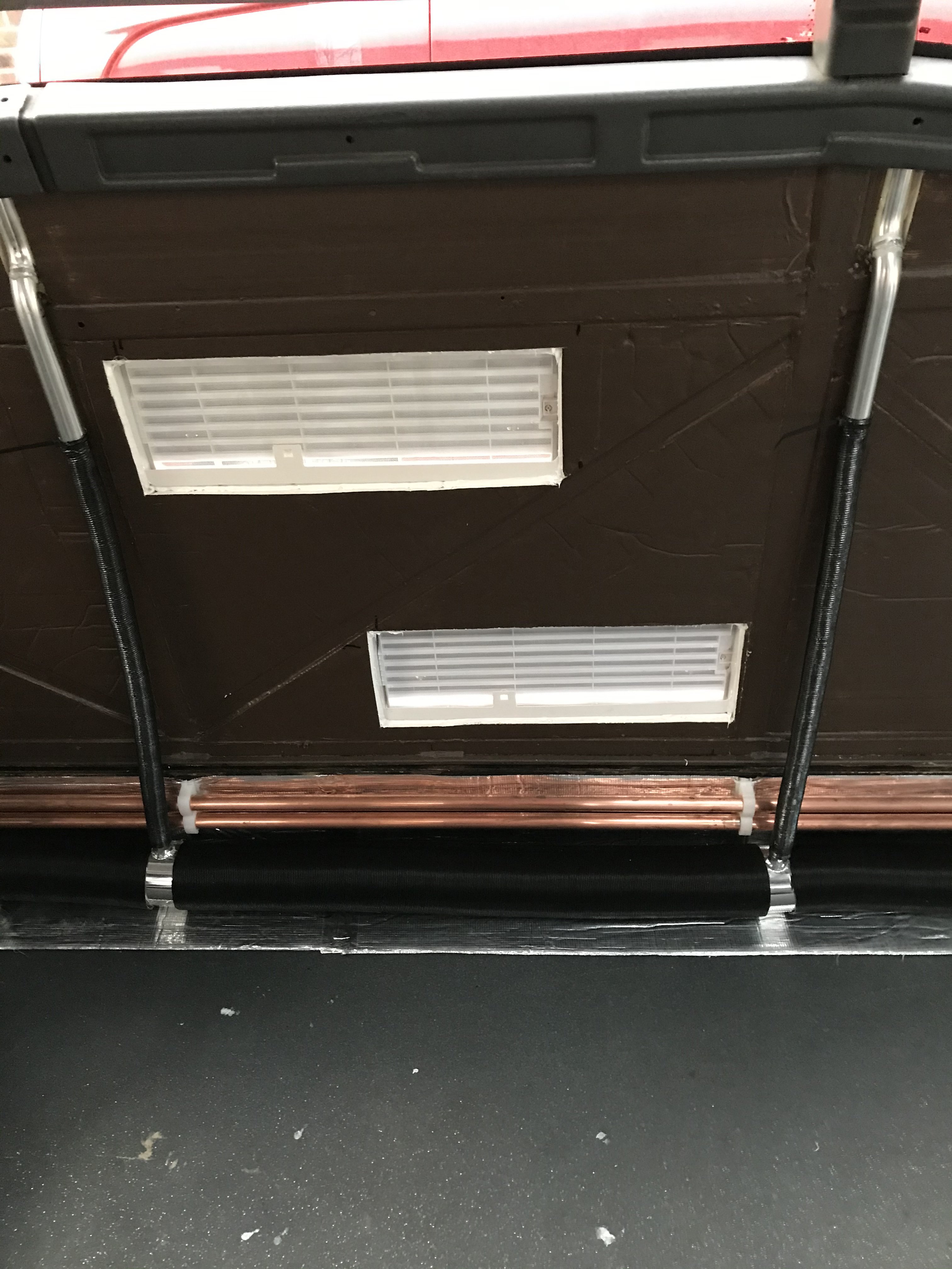

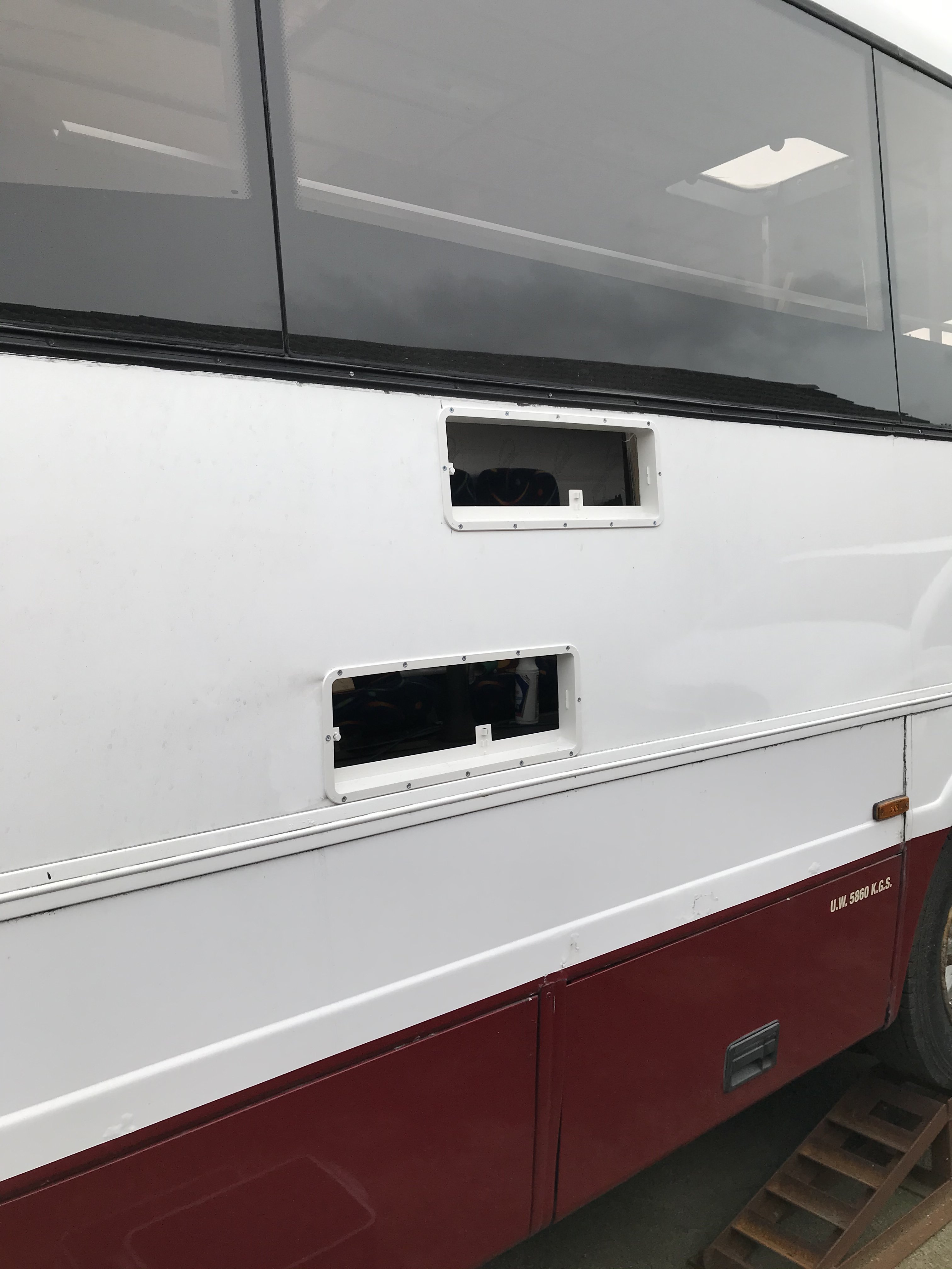

After spending a long time repairing holes, I decided to make some more. Yes I know that they are not vertical to each other, but I decided not to cut any structure out of the walls. One thing I did notice was that stainless steel screws don’t like biting into stainless steel sheet. Galvanised steel screws worked a treat. Another mistake made was not to measure from the same datum. So each vent is not horizontal to each other.

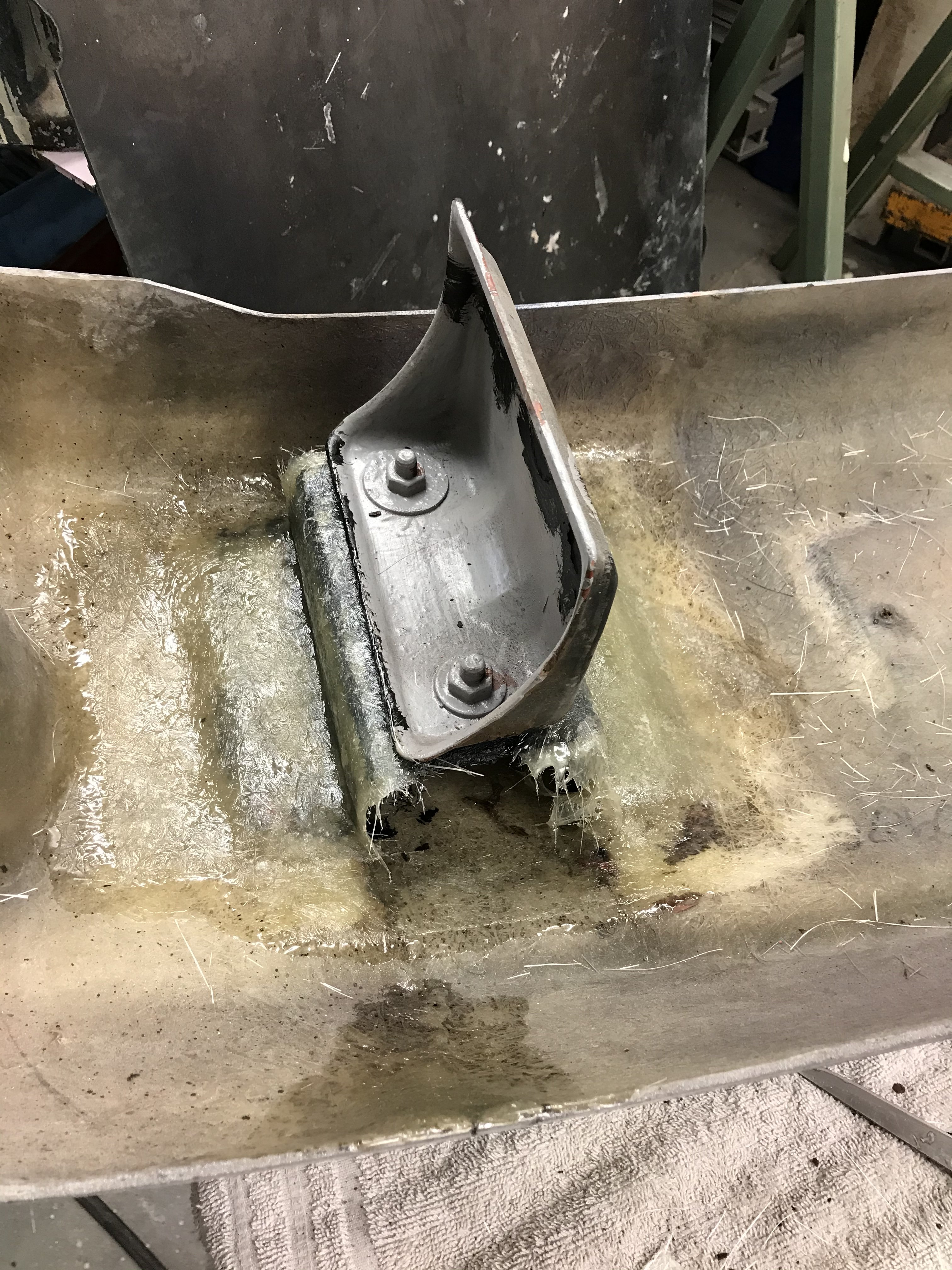

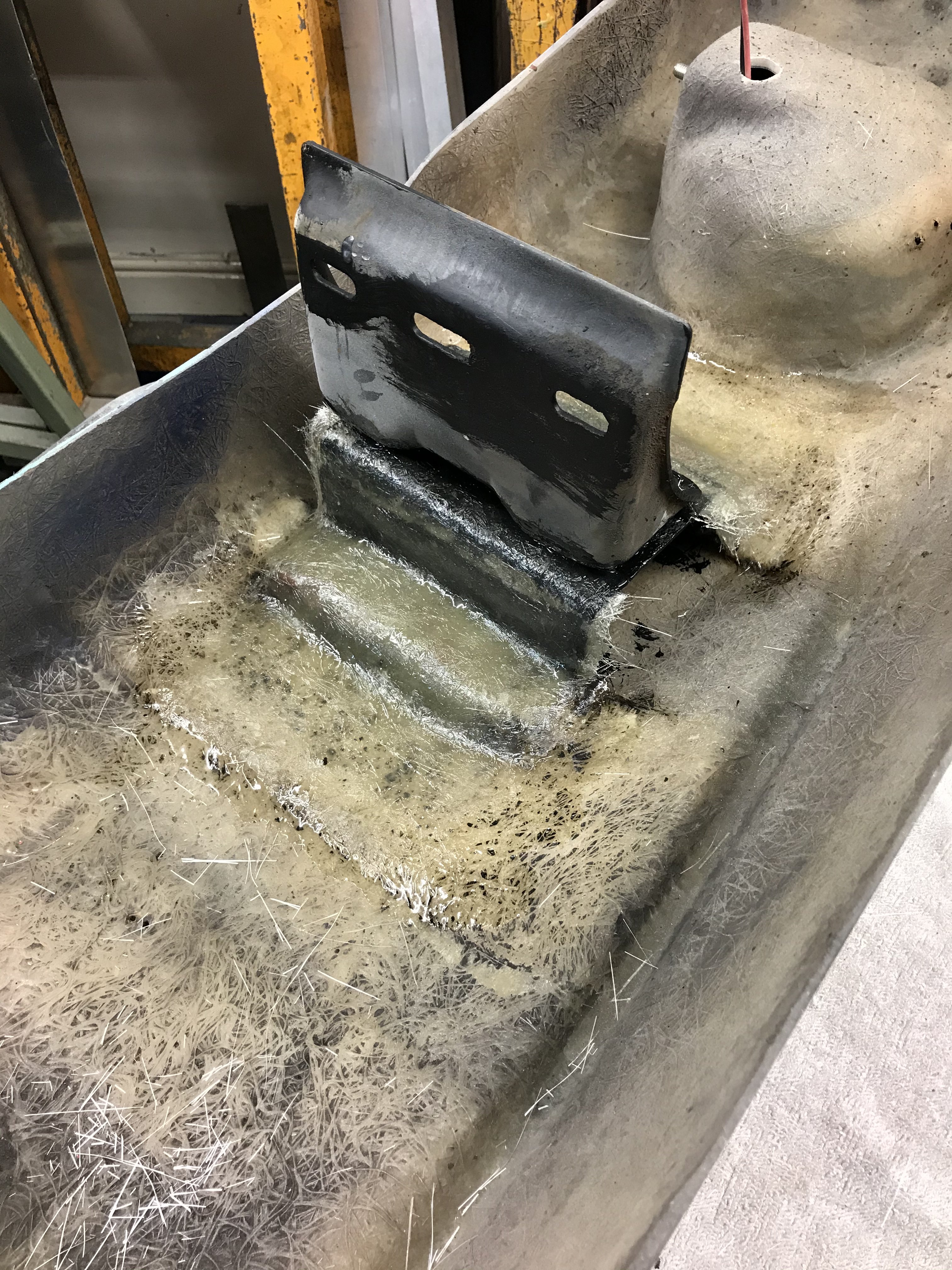

Anita got into repair mode and cleaned the rust scale and bad repairs from the front bumper. Steel treated and new glass fibre reinforcement.

Dd you line up each vent to be parallel to the closest trim line then? they look level to me.

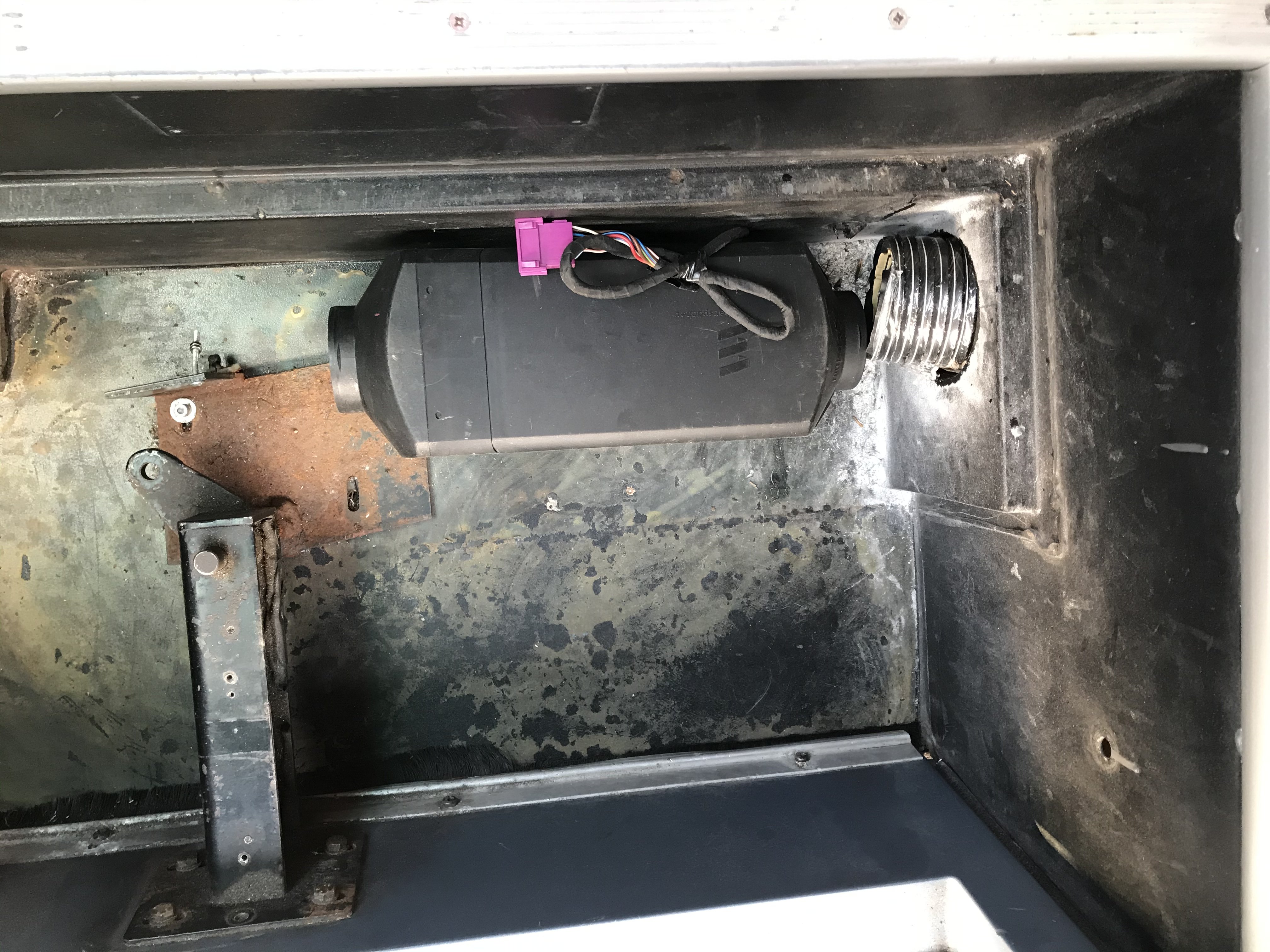

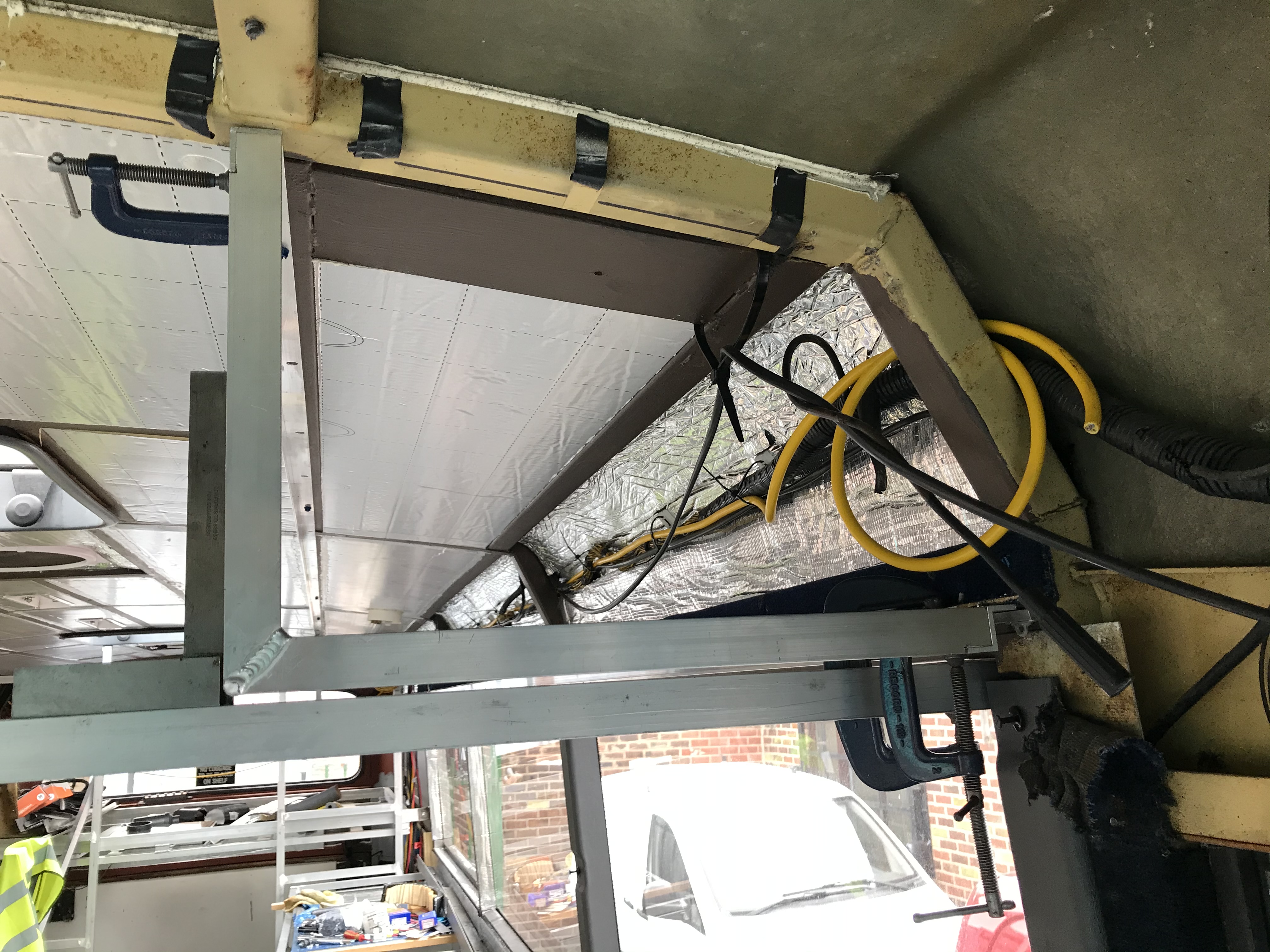

Still more plumbing! The M2 4kw eberspacher has now been purchased, so holes need to be made. Big holes as I’m using 90mm ducting. I was hoping to mount it side on under the step. This would have allowed clean easy runs for the intake and exhaust. Being forced to mount it to the bottom of the step I’ll have to make a top hat pedestal. This will allow the intake and exhaust pipes to bend away from the ground. Pictures on this later. Shown is the flexible hot air pipe escaping from the step and retuning back inside. And of course it fights for space with the water pipes. Another water heated fan is offered in place and I think it will stay there.

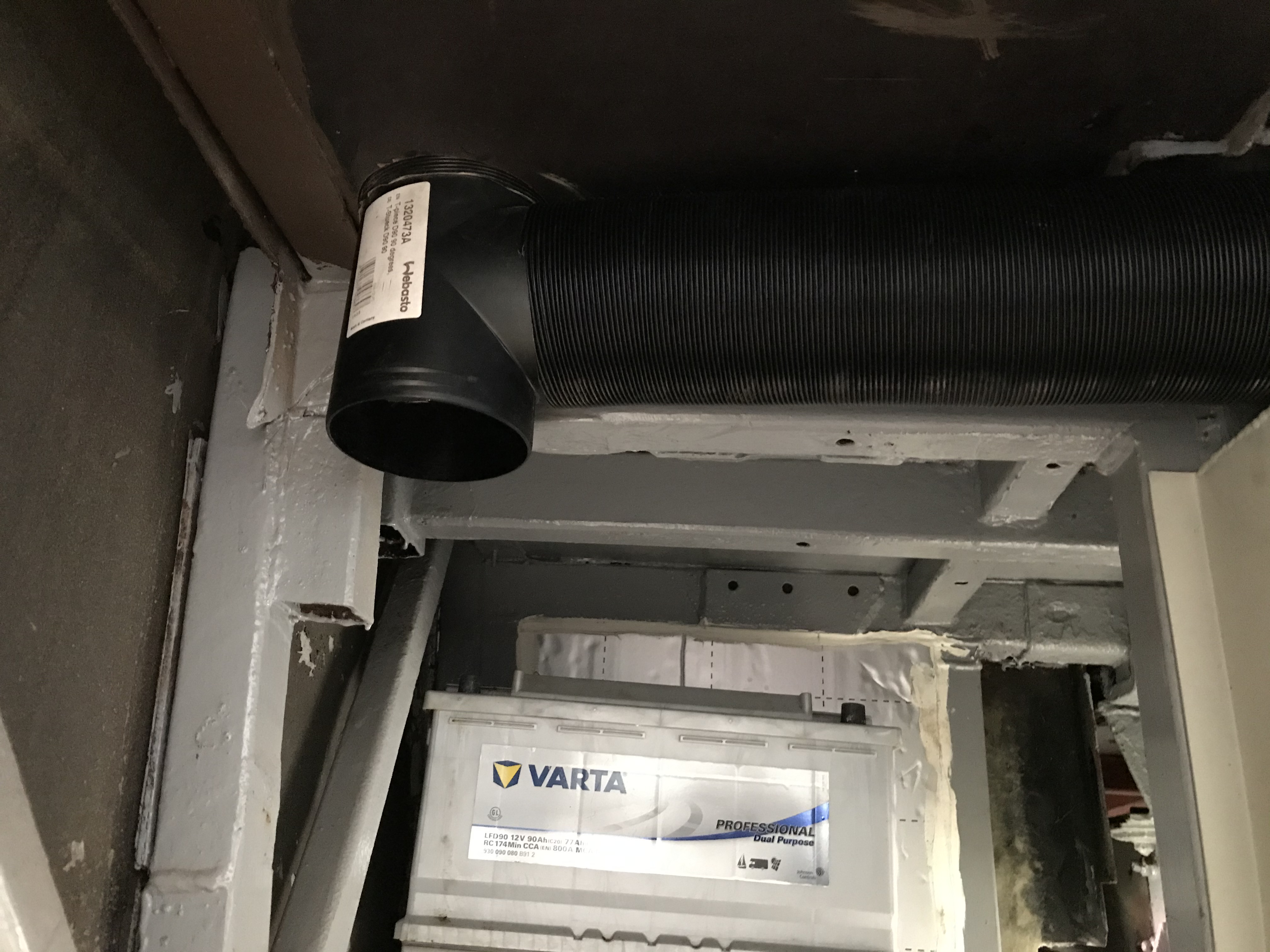

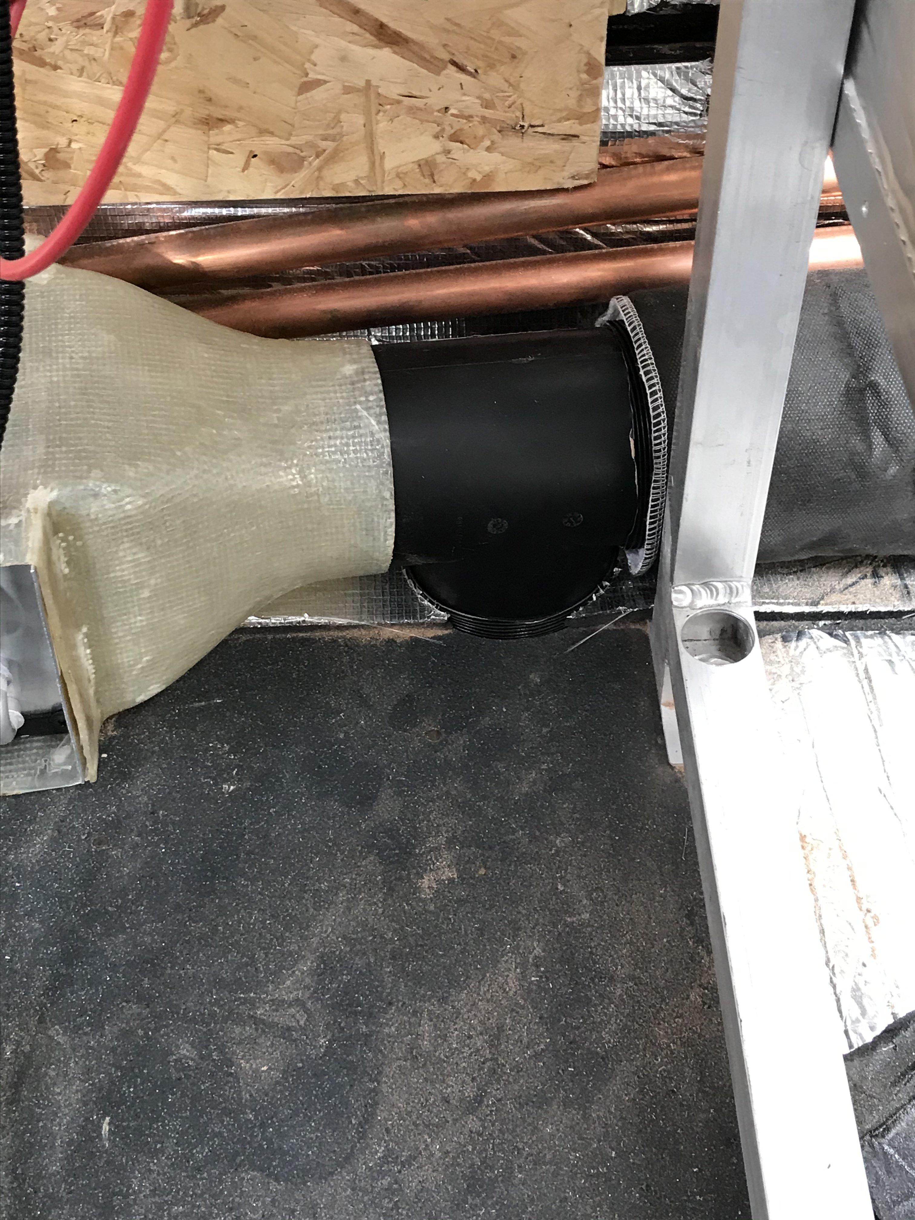

Whilst boring holes yesterday and killing hole saws, I decided to do an easy one and add another bit of plumbing at the back. 92mm hole saw is supposed to be good for 90mm corrugated ducting. It’s not!! And the new hole saw didn’t like cutting the wooden floor.
So armed with a sharp half round file I thought I’d soon get the better of this. The hole laughed at me! Better weapons required. Industrial flexible shaft grinder with a 25mm spiral band. It’s an abrasive band mounted on a rubber holder. The grit is resin bonded. It didn’t take long to resize the hole. As I was under the main floor l cleaned and reshaped some steelwork that I had previously roughly cut with the plasma cutter.
Two Tee pieces joined with some ducting and I’m through the floor. I still have to make an adapter so that I can fit an air outlet to restrict the flow. I don’t want all the hot air heating the garage space. The other side will match, but that’s a job for another day.

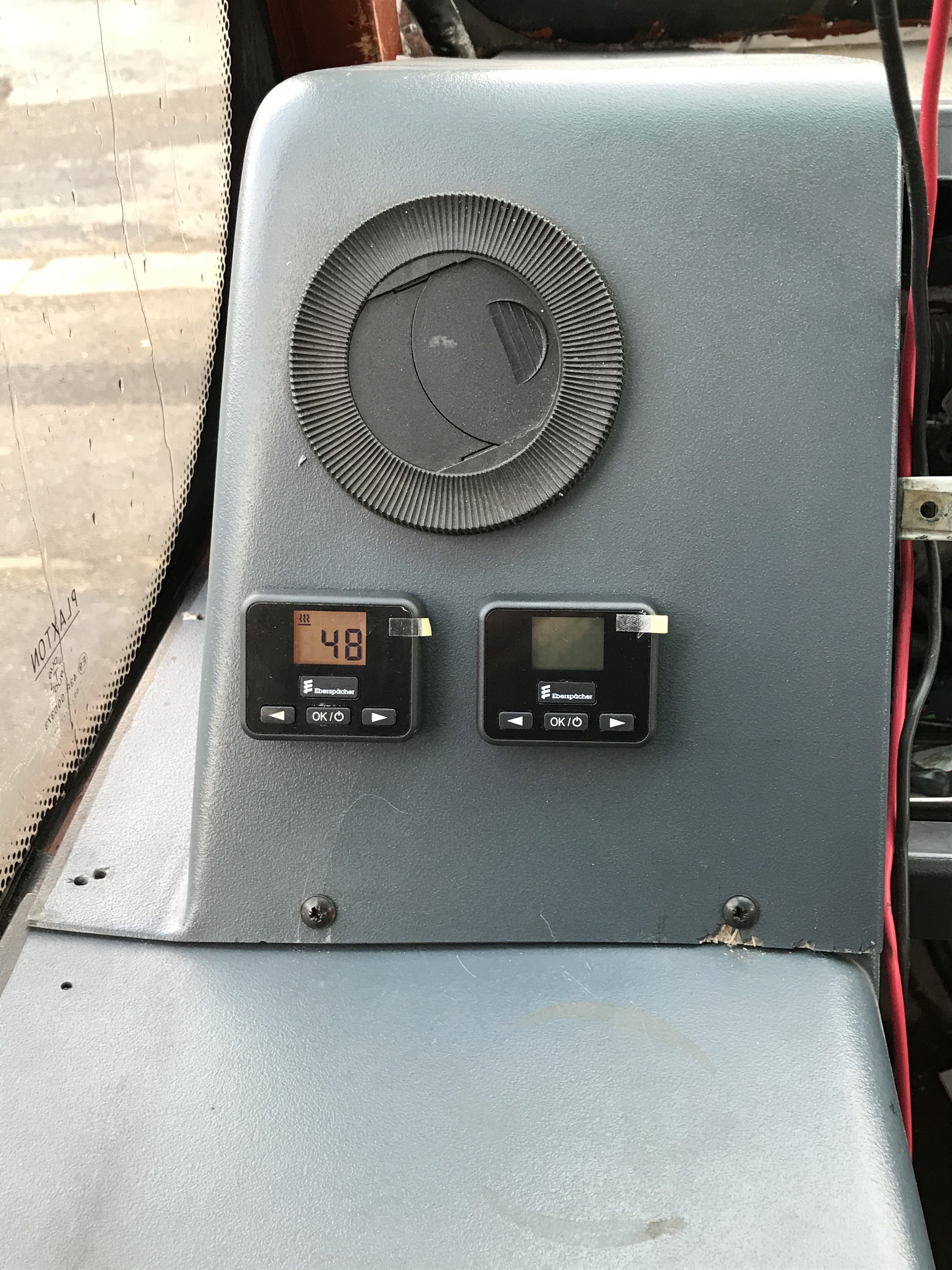

So I hoped a more pleasant job. Two eberspacher controllers to mount. I was hoping for some kind of symmetry, but I thought I’d better look first. Caught you! There is a redundant handle under the moulding, there goes my symmetry.
Wiring can’t be hard? Pins in plugs, no problem. Even locked in place. Now I wondered why I had been given some pins for the sockets? The loom had incompatible connections on it! Then the new connectors need a suitable crimping pliers that I did not have. Not nice, but I made do. Better still the water eberspacher still works.
Duct from L/H rear heater
From above heater

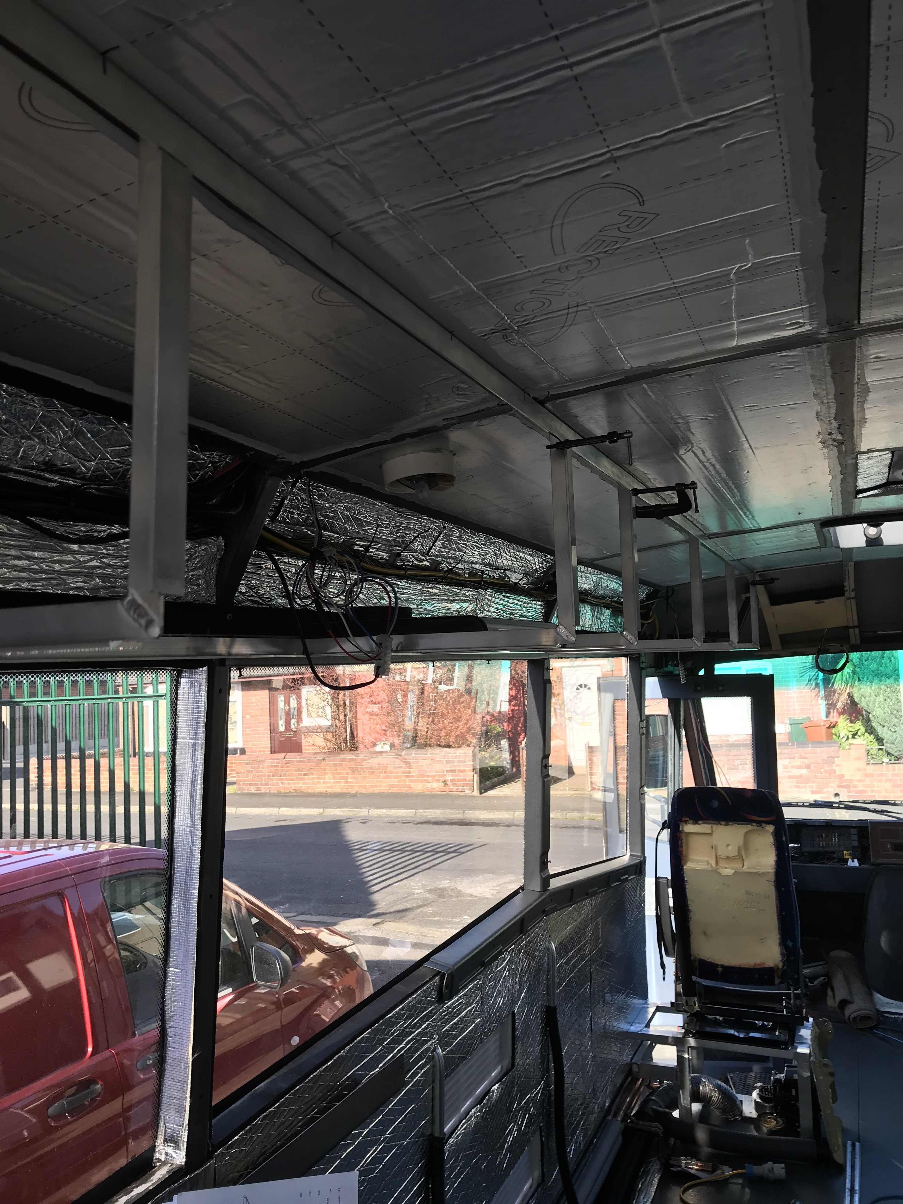

Anita’s was tasked with modifying the angle section that mounts the curtains. The idea being to attach some z section aluminium to hide the curtain track and mount the over head lockers. Lots of holes to drill and mastering a violent air powered rivet gun. At least that job got completed.

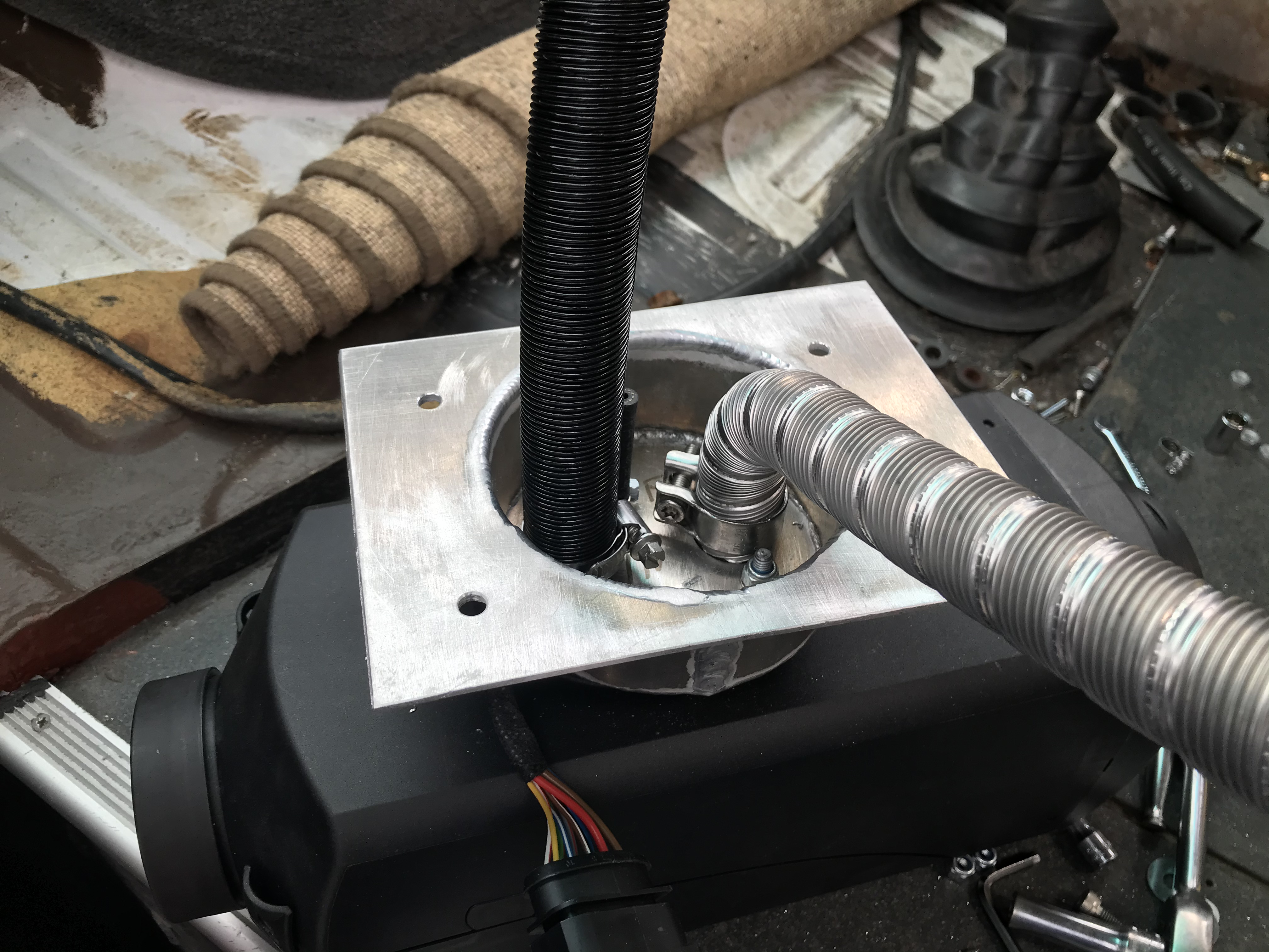

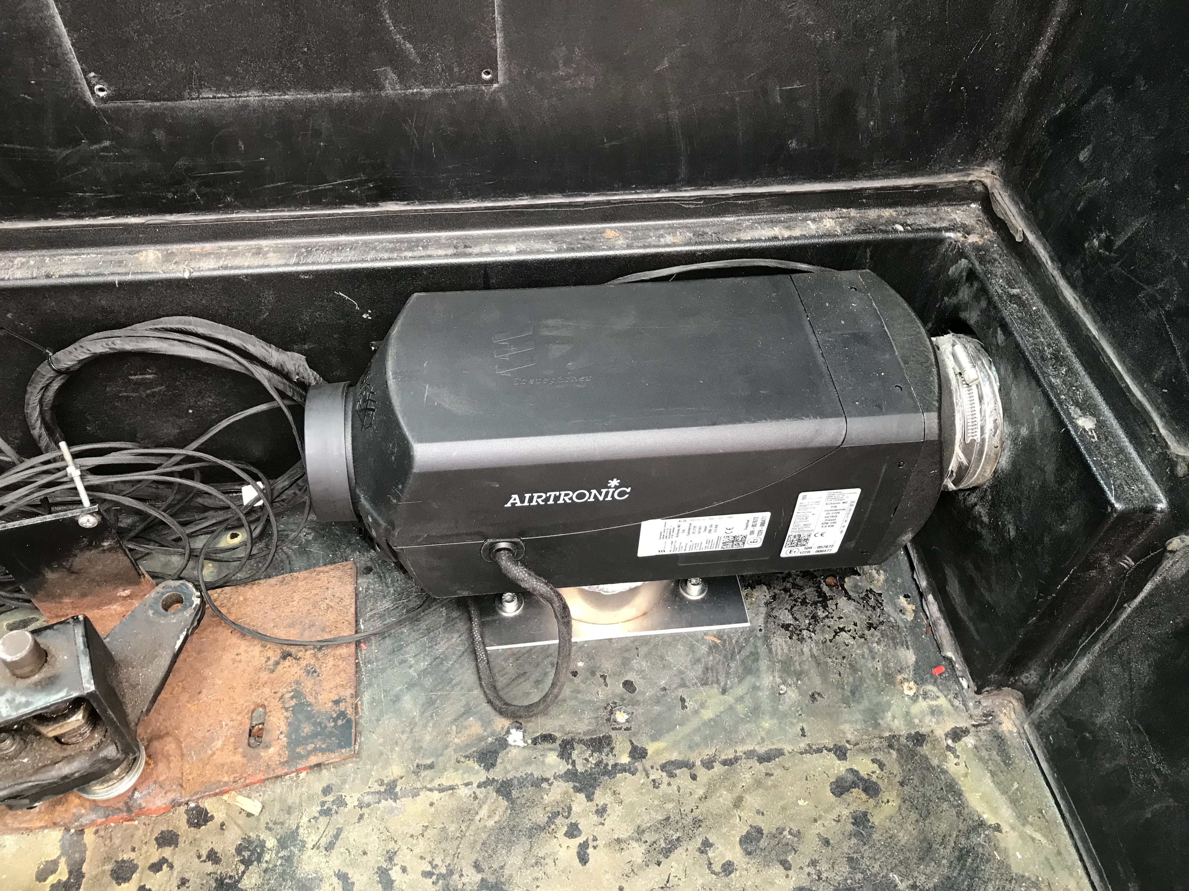

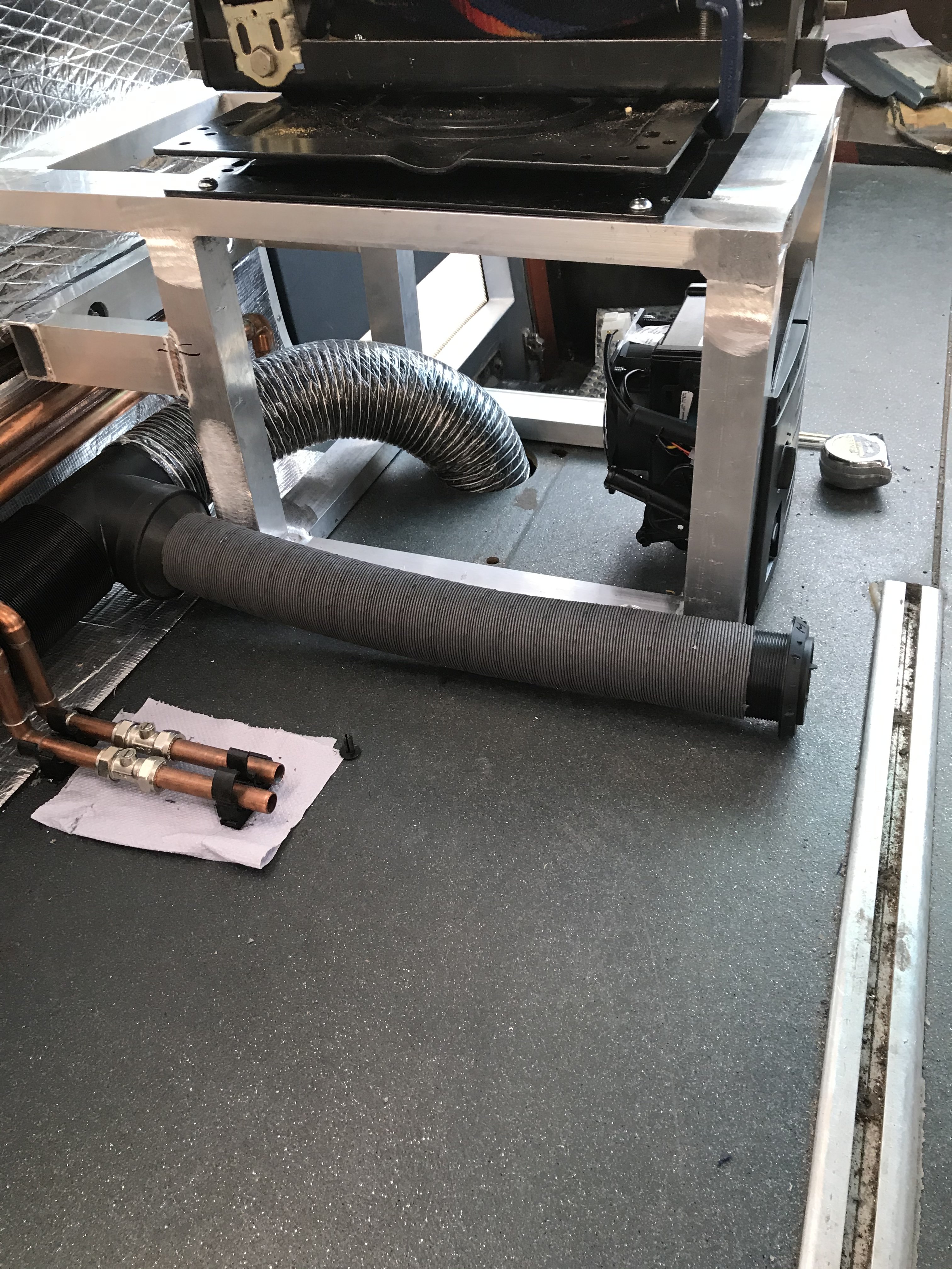

My first task was to mount and commission the M2 eberspacher. I should have taken more time, but I really don’t like sheet metal work. So a rough looking plinth was fabricated in twice the time a good man could have made a nice one.
Typical, the heater didn’t line up with the hole l cut in the step. So out with the flexible shaft grinder and enlarge the hole.
Routing the wiring loom. Even though I had more than enough cable I took the shorter direct route across the step. This will need some p clips later. A couple of hours later I’d managed to feed them though the wing panels. Stress was building and light was failing, time for home.
This morning full of enthusiasm, it wasn’t to last. Fuel and power needed to be routed along side the water eberspacher plumbing. Cable ties had been left loose to aid this. Still no fun as the back is on ramps and I was under the front.
Power connected and just the fuses to fit before it bursts into life. So fuses fitted and some kind of fault code pops up.
So continuity checks done, but still the unable to communicate code. The day ends early in frustration. I wonder if I was sold some duff stuff. Email Mellors in the morning.

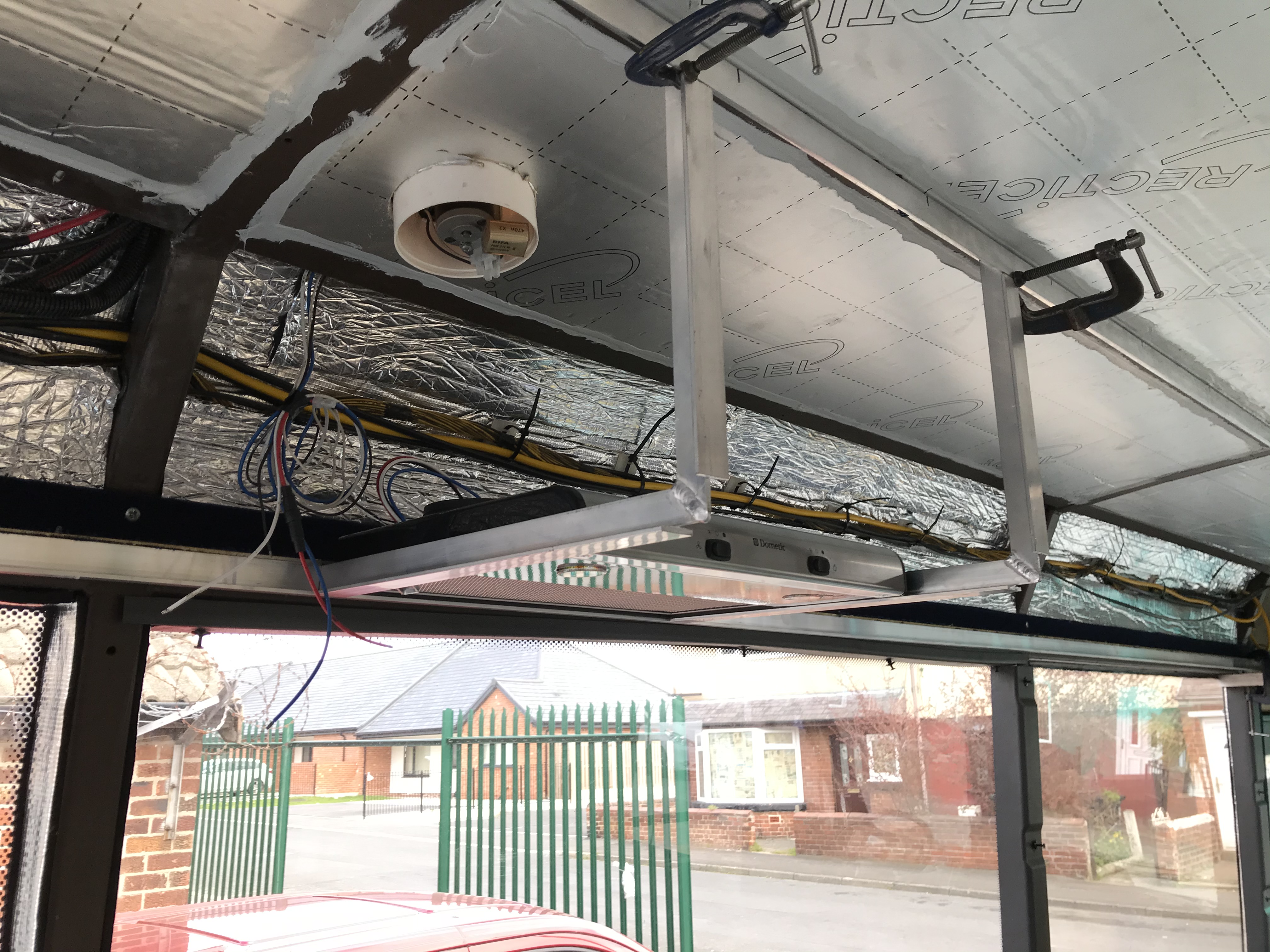

So this weekend has been about “what can we finish?” Not strictly finish-able, we decided to tackle the overhead lockers. Sooner than expected we discovered that some of the material purchased for it was used on the sink cabinet. Though we were able to do enough for a trial fit of the cooker extraction unit. Whilst it was in place it made sense to temporarily wire it and check it’s functions. The shower fan was subjected to the same. More aluminium required, best work out what is required for the shower too.
