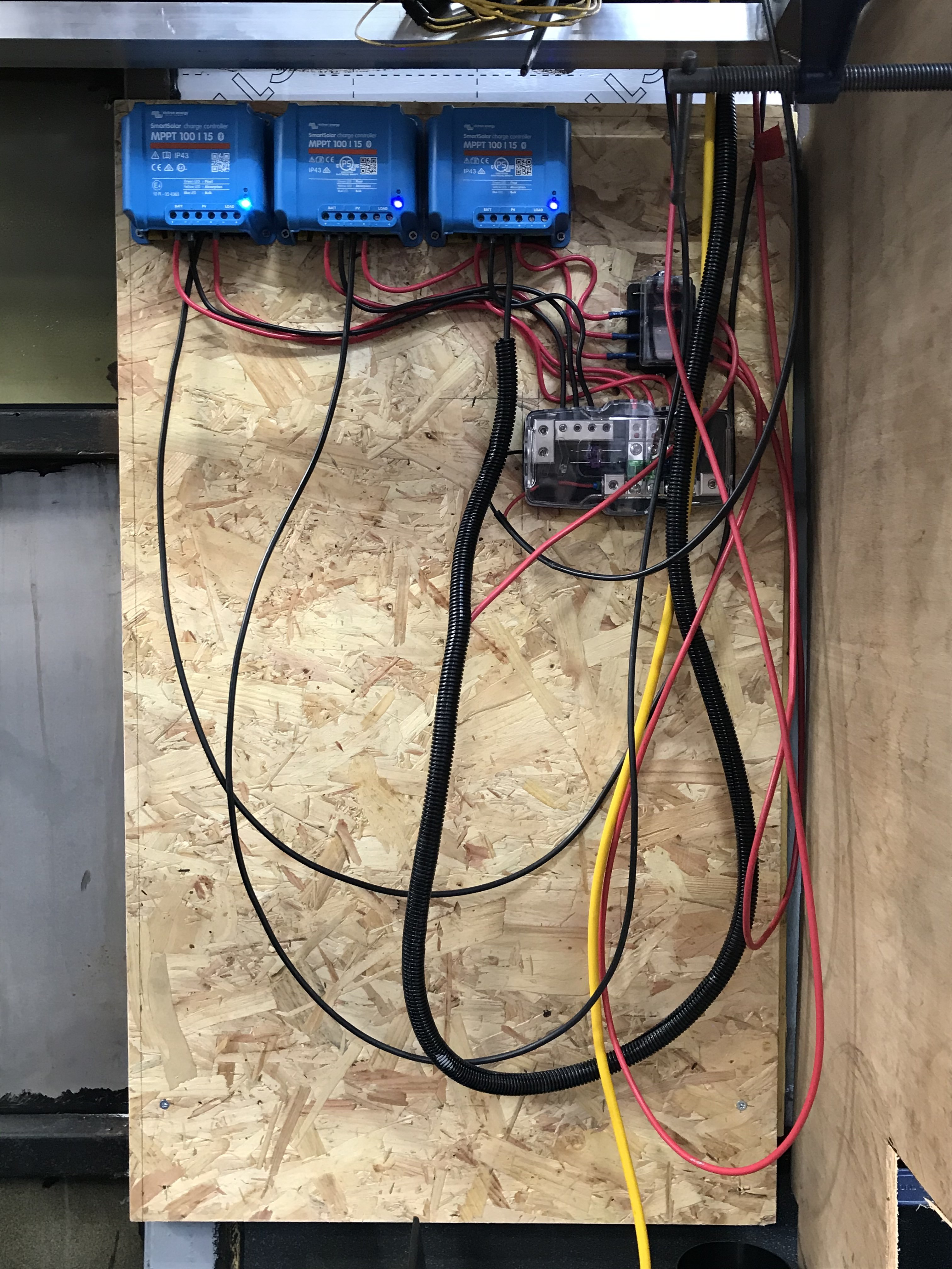

Not many toys at the moment, but enough to join most of the solar controllers together. Yes the wiring is long and scruffy, but it’s safer at this stage.
After more trouble than I hoped for I got all three mppt’s working nicely with each other. At the moment the starter batteries are being used as a load/sink.

Do mppt controllers not like being connected more than one to a battery bank ?
Mine will do hab and starter, if only hab batteries it will be ok for a few but remember the amps will be divided down as you add more.
That used to be the case, one would fight for dominance. So you could have one in bulk and another in absorption or float. Now Victron have given them a good slapping (none were hurt or harmed in the process) and they are supposed to get along nicely. On the bluetooth display it shows the combined power. With very little load at the moment and poor sunlight it's hard to watch them play.

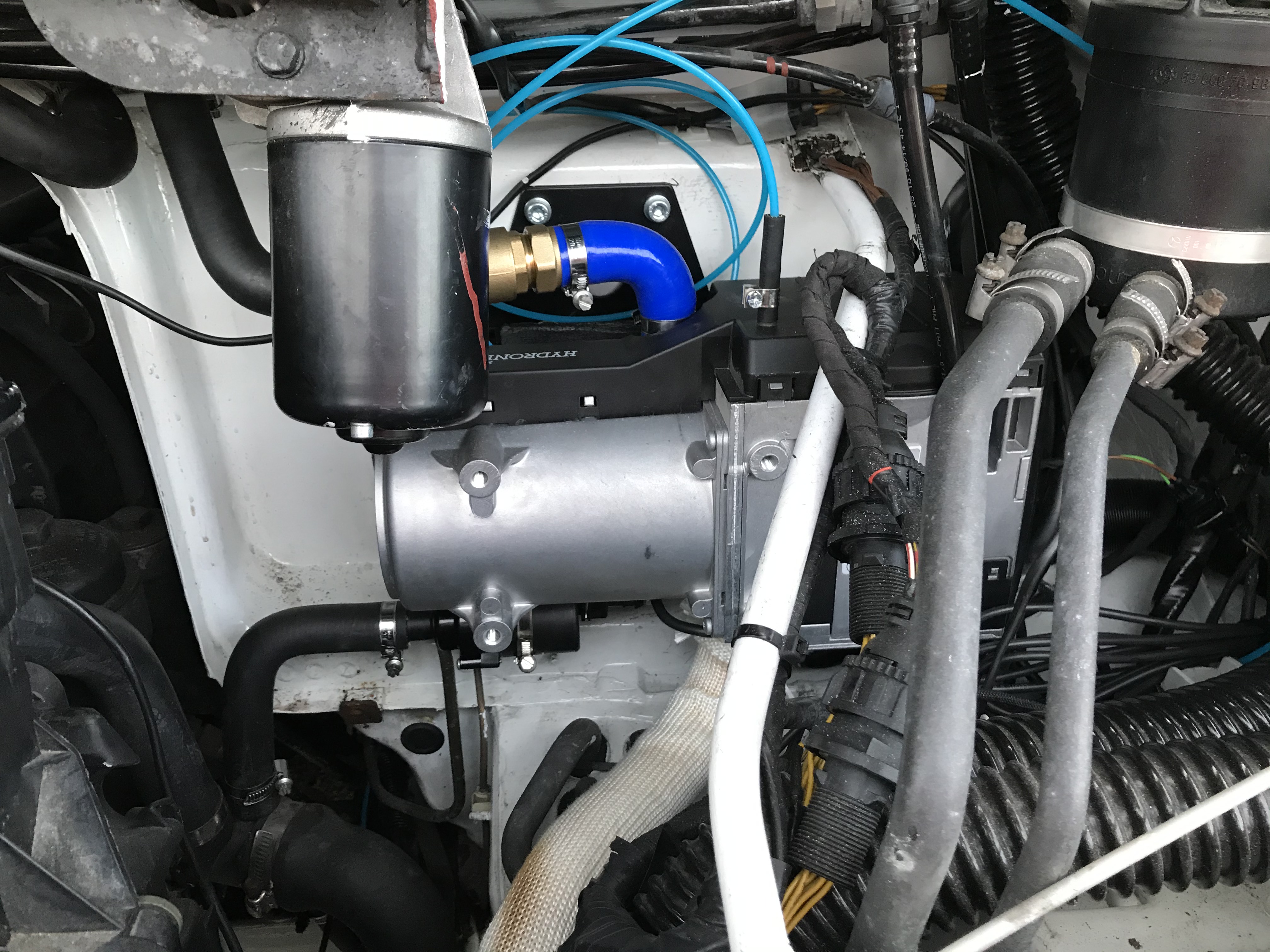

Half a day spent installing the eberspacher M12 fuel pump, how could it have taken so long!
I was lazy and used an existing hole in the chassis to mount the pump. Routing the plumbing was the pain. Trying to find a direct, but safe route for the fuel pipe and pump wiring.
Now having a fuel supply I connected the fuel pipe and power cable to the boiler. Nothing tied in, just rough routed until I'm happy.
As not to run it dry I just tapped into a heater hose. I will not be plumbing as per eberspacher suggestions as I think my solution works better for my needs. With my theory, you have to think of the engine as another boiler. So there will be two boilers capable of heating one circuit.
I'm happy and indeed want the M12 to be able to preheat the engine, but I don't want the engine to heat the M12. So I have fitted a full bore one way valve on the output of the M12. As it's plumbed at the moment I can heat the engine and cab heater, but the engine won't heat the cab heater due to the valve. More about plumbing later as this was just a boiler test.
Some blighter at Mercedes though it would be good to pack bundles of wires and air pipes right where I want to run my exhaust. I've given the exhaust pipe a couple of layers of heat proof socking, but it will require some bracketry made to make sure it doesn't go walkies and burn anything.
I'm still not sure where it's going once it leaves the engine bay, but I'll worry about that latter.

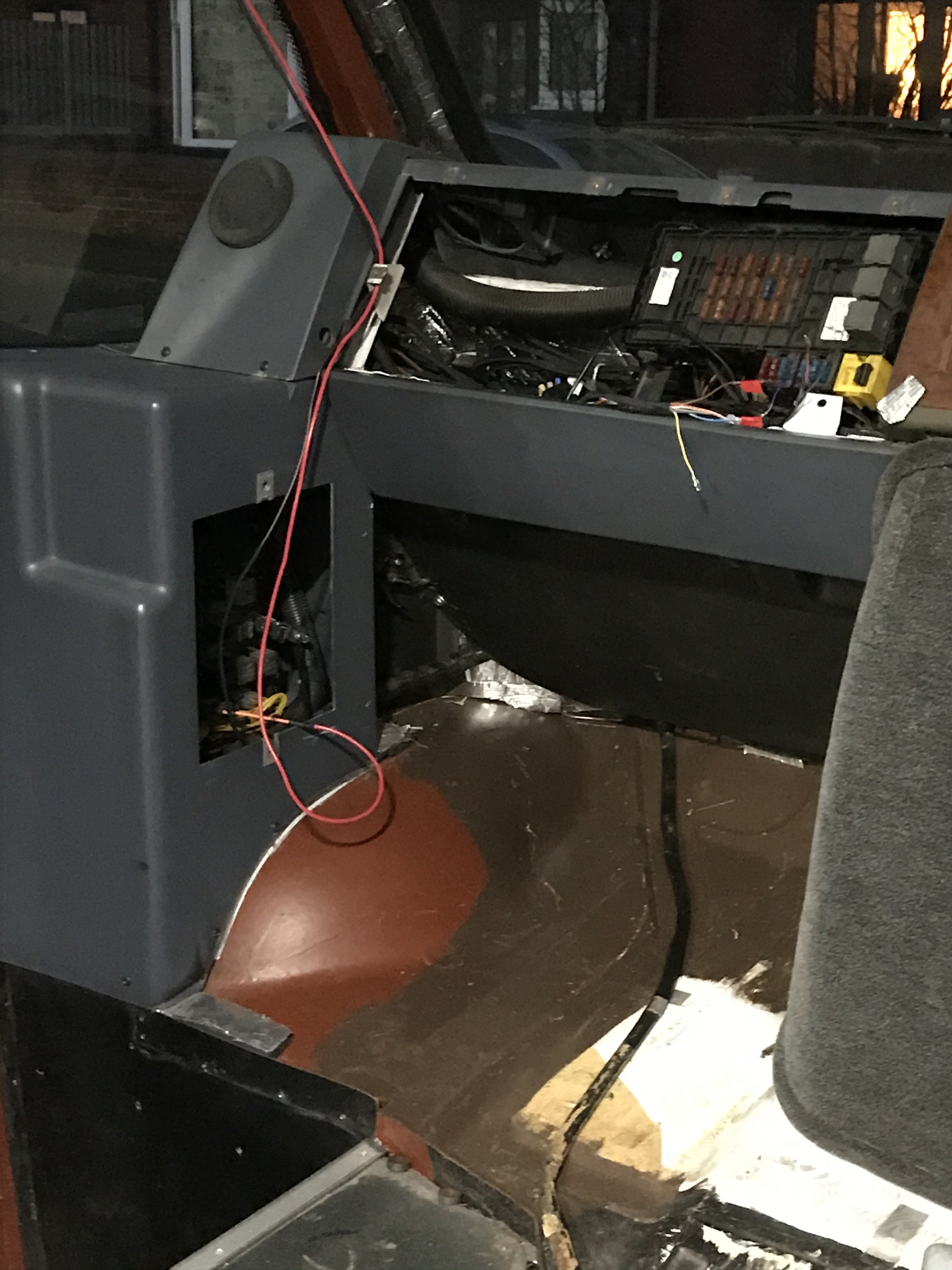

I managed to follow a loom and got the wiring in behind the glove box, handy because also the body control module and fuse board are there too.
Negative easy, ground stud provided for me. Positive looks easy too as there is a power stud on the back of the body control module.
Yes it has power with the ignition off. Turn the isolator off, and it still has power! WHAT! So after some head scratching the penny dropped.
Whilst playing with my MPPT family I used the engine batteries as a load for them. So even though I had turned off the isolator, I was still powering the Mercedes electrics with the solar! Remove fuse, fixed!

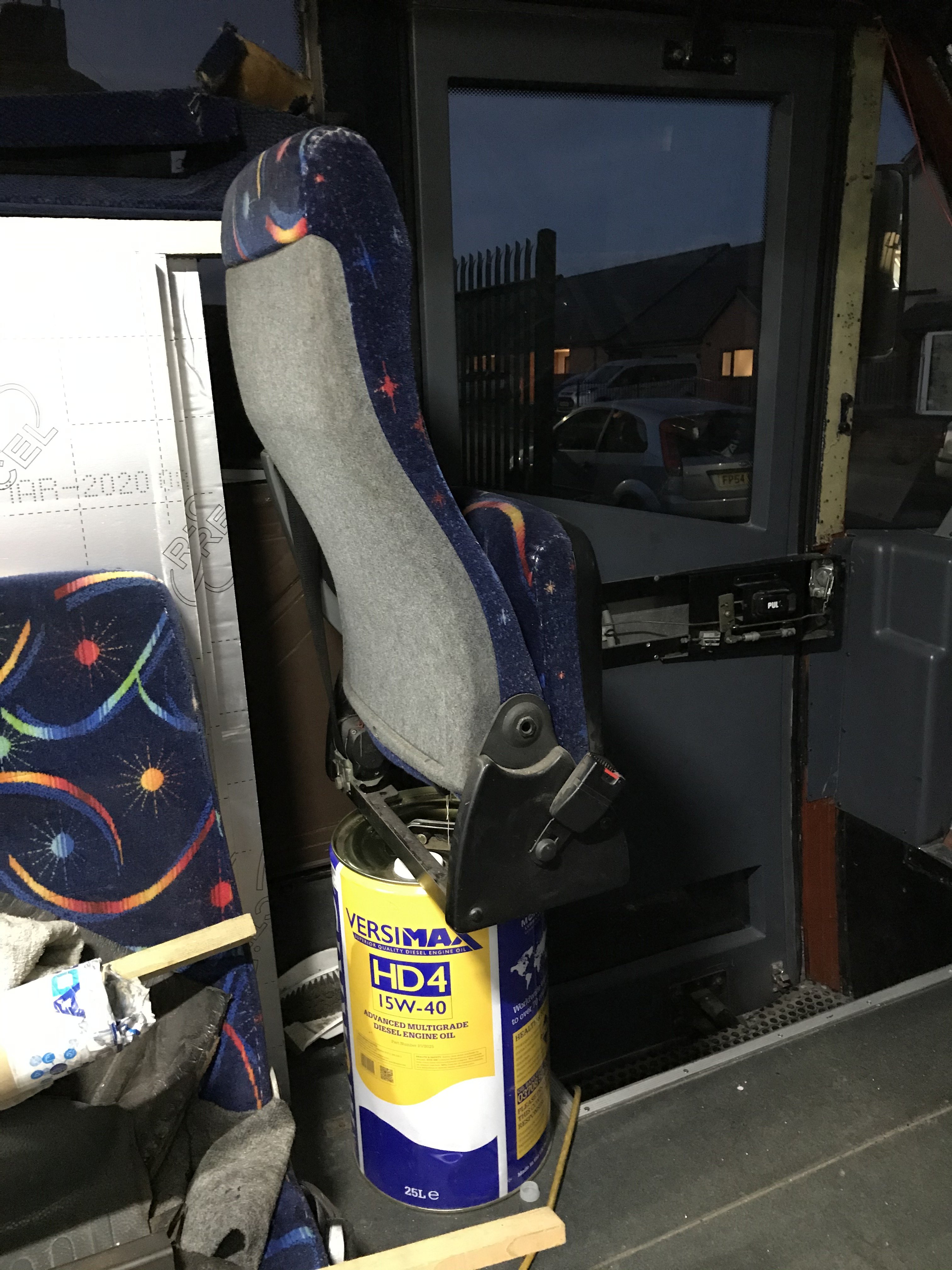

There is another glass fibre panel that forms a cupboard in the footwell, but where I had planned on putting the co-drivers seat it was going to be a little tight.
Executive decision required by Anita. So after some mock-ups, none of my ideas were accepted! The folding base seat we have, will return close to it's original location just behind the door. The mounting structure will be better than the horrible coach idea. I'm hoping to include in it's base, a spring loaded foot rest. Other wise your feet are left to uncomfortably dangle. Whilst at it I'll investigate making a swivel plate too. So that it can be used as a guest seat facing the lounge.

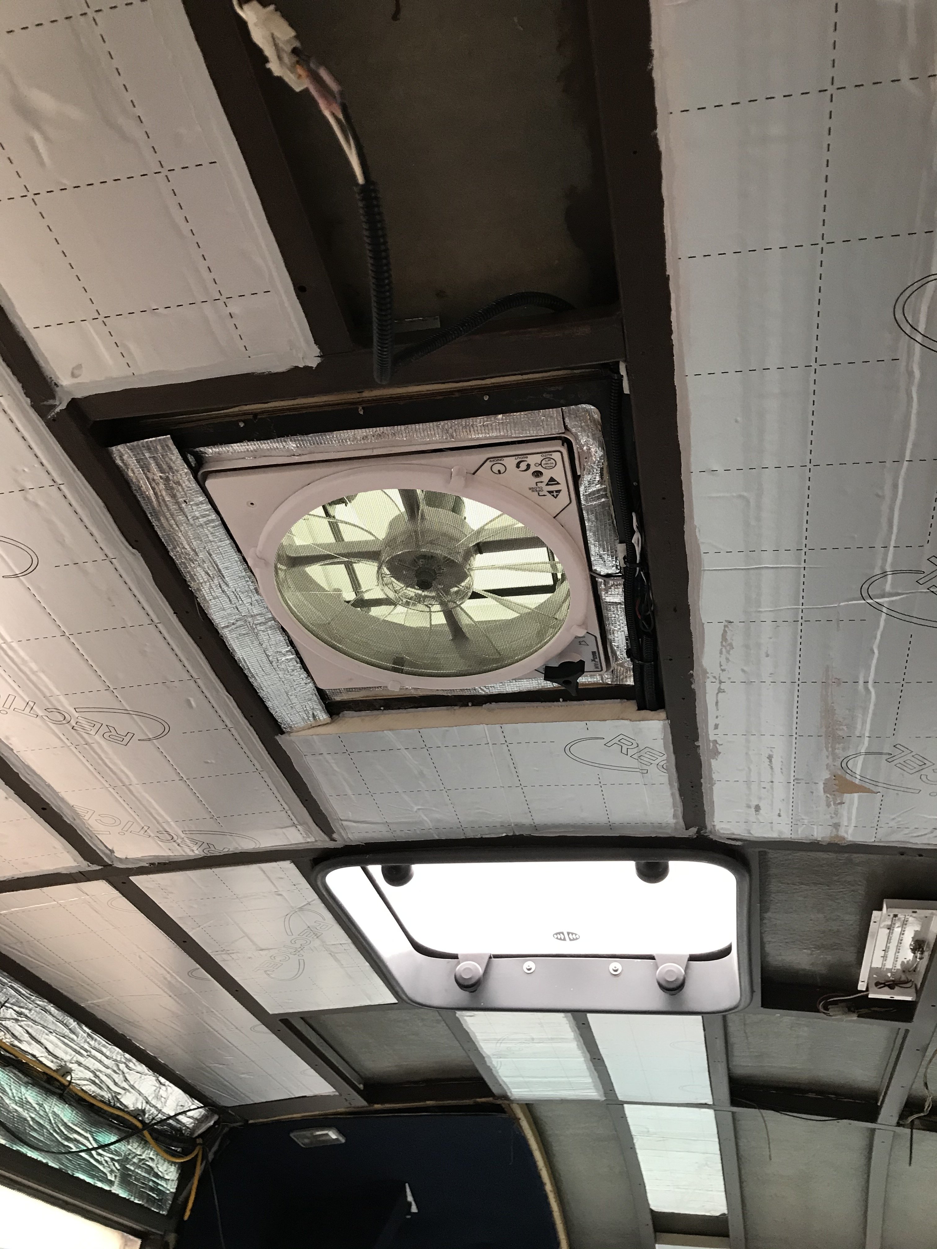

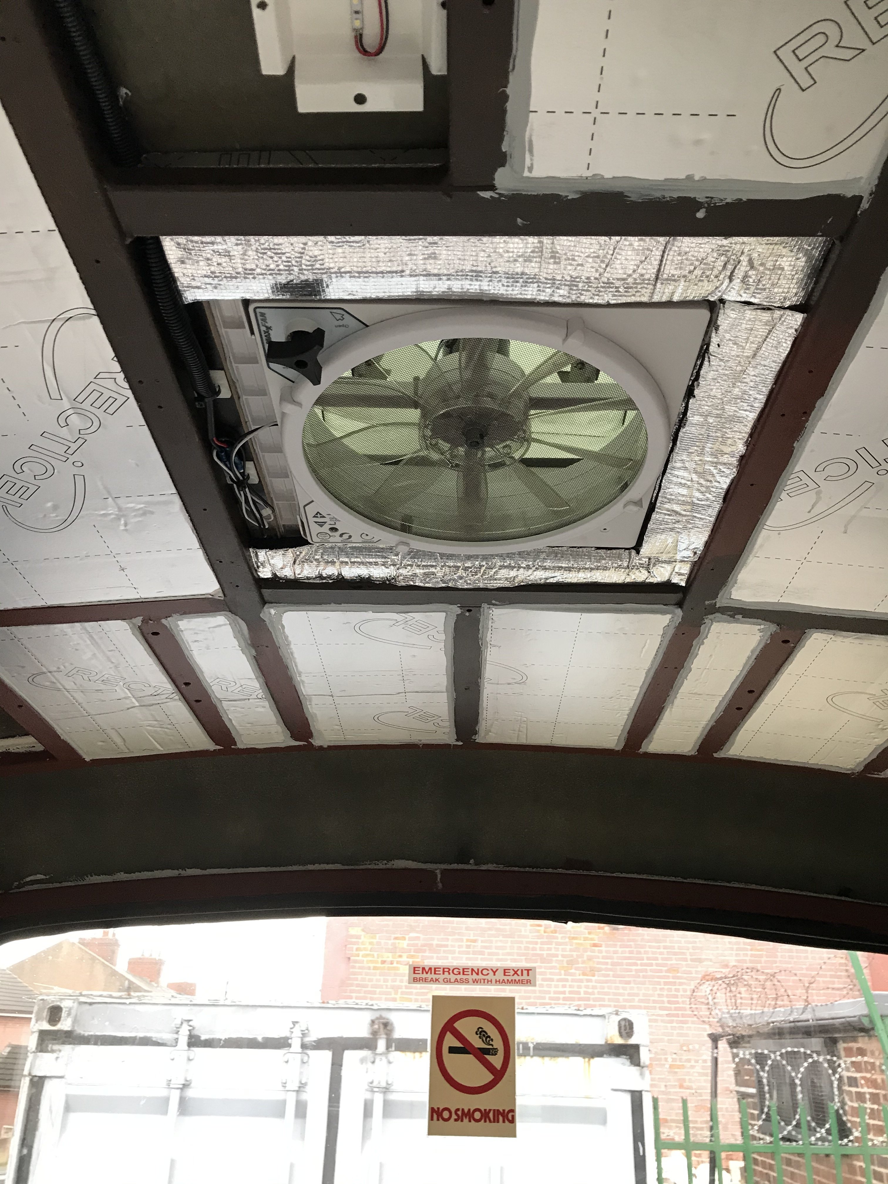

As I now have power to both Maxxfans, it gave me a chance to play with them via remote control.
So yes one controller will operate two fans, but there is a glitch.
The remote control remembers the state it was last used.
For example. If both fans are running, but closed and you choose to turn them off.
The first fan will stop as expected. The second fan will open and continue to run.
You have to press the off button again to close and stop it.
A disappointment, but just fussy really is that you can't stop the fan in a mid position with the remote control.
