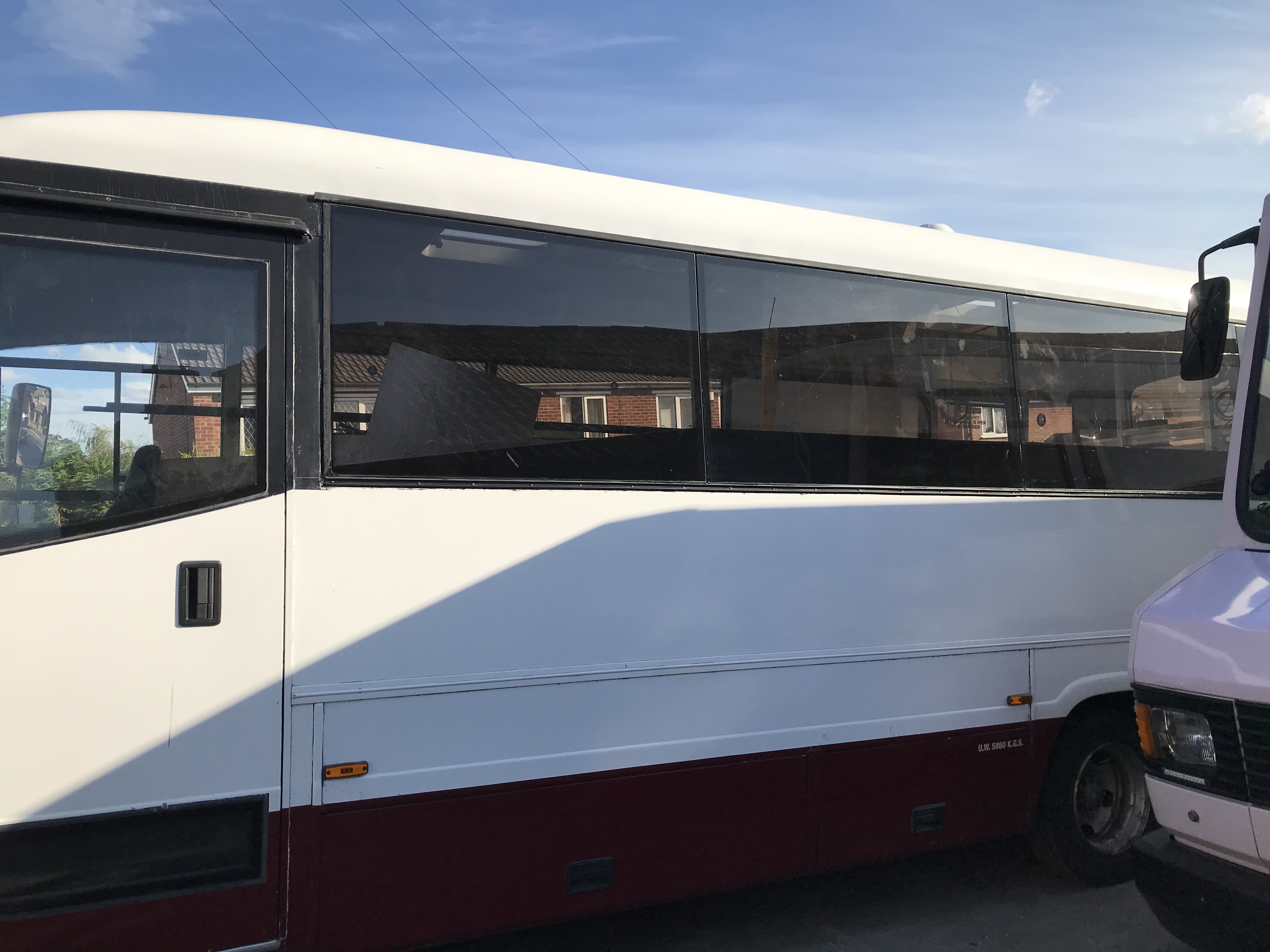

Windows refitted and the new aluminium panel. Still needs backfilling and the trim fitting. Once done a mould can be made before I cut the new door opening.

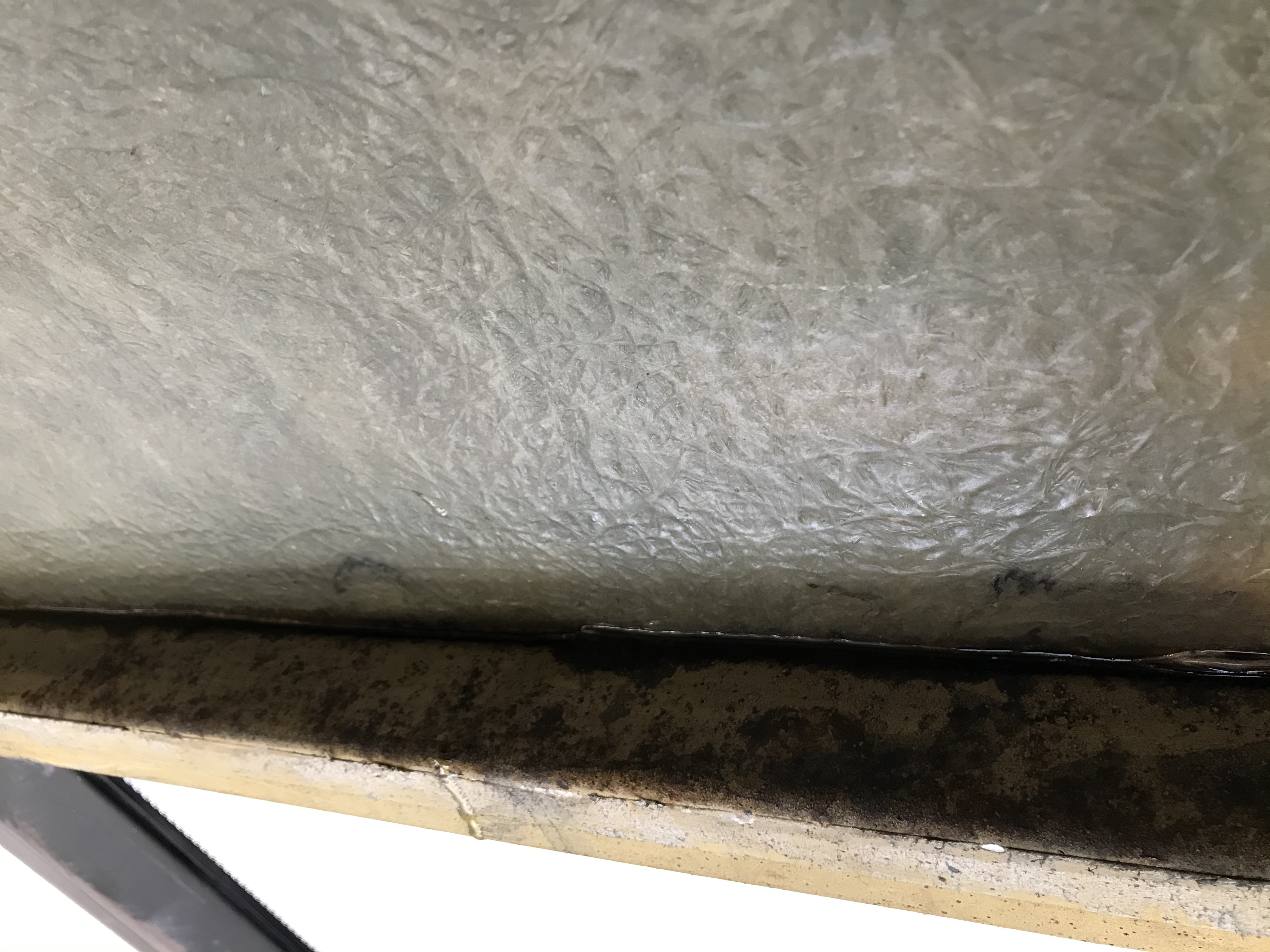

So it rained and water still pored in. :( It seems there is some bonding issues with the gutter strip. It not your usual U channel, it’s more of a Z section to which the windows bond. The roof is bonded in the channel. Should have removed the gutter whilst the windows were out.
So more demolition, one panel was aluminium, but two others were welded :( On the up side at least I can insulate behind. So after much scrubbing and cleaning the joint between the roof and the steel work was clean and dry. Into this edge I pored flexible epoxy and then watched it drip. It takes about 12 hours to stiffen. Nothing leaked out, but I pored in too much.

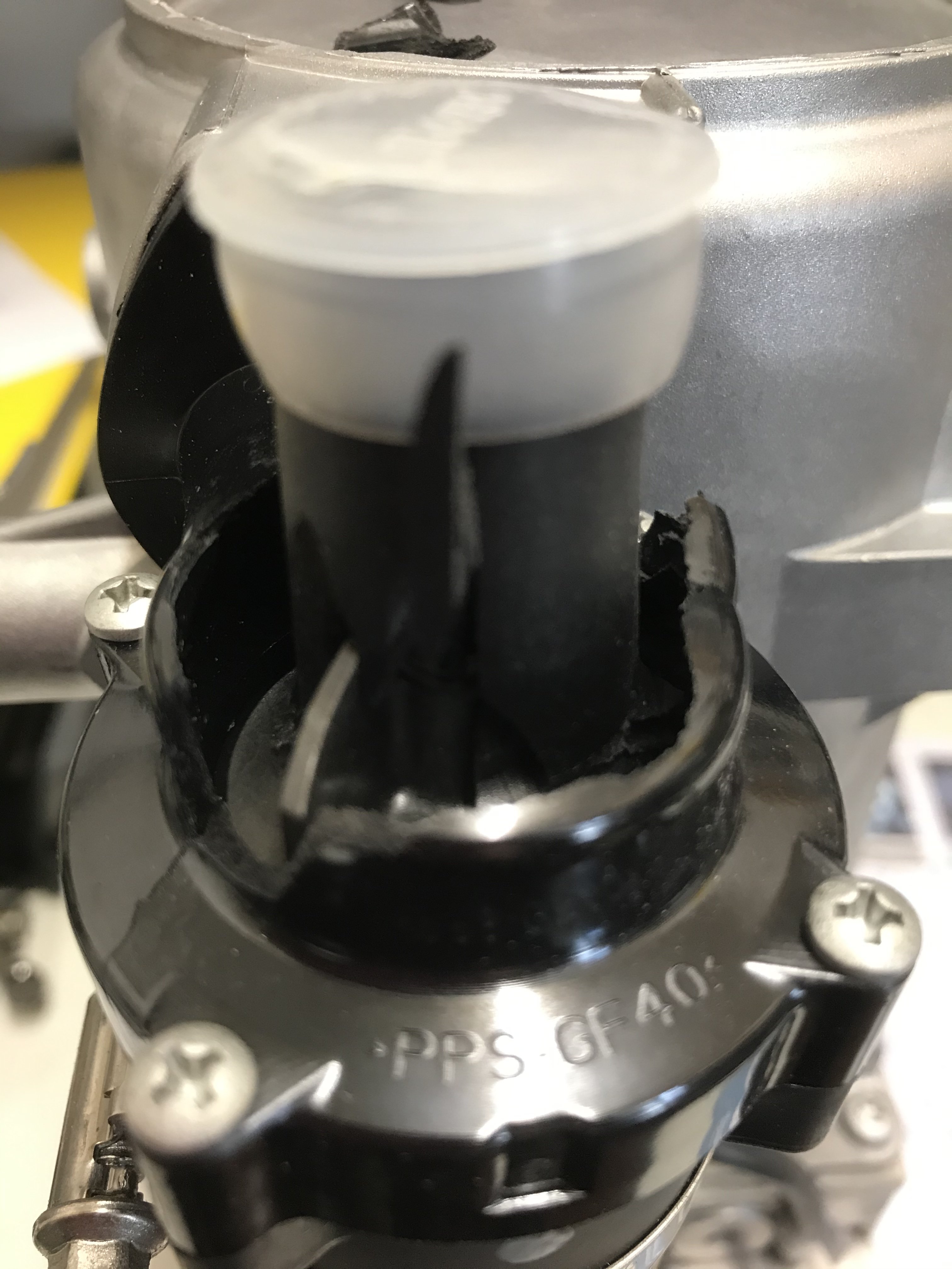

Whilst waiting for the epoxy I thought I’d offer up the new M12 eberspacher. When I opened the box. :( Fortunately Mellor’s replaced it today. :)

Well the flexible epoxy seems to have done the job, so now I’m insulating that once hidden area. Sorry slow progress, Murky is having time spent on it as well as building an extension to our workshop.

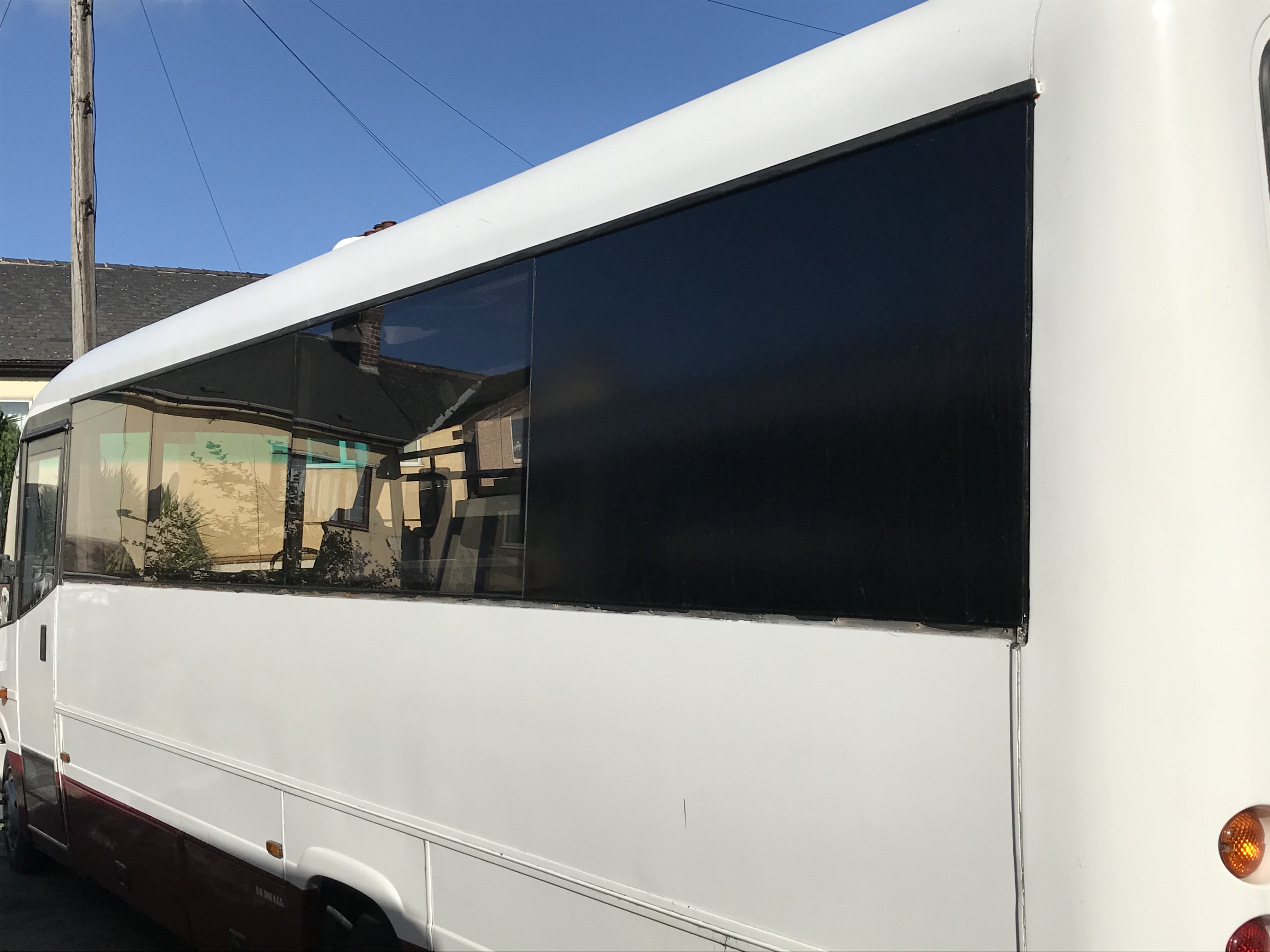

The picture shows the bottom of the windows blacked out. Although expensive I used Bonded window fitting primer. It didn’t go as well as I hoped and will need another coat. If it was not for the fact I will be bonding something else to the window I could just use black paint.

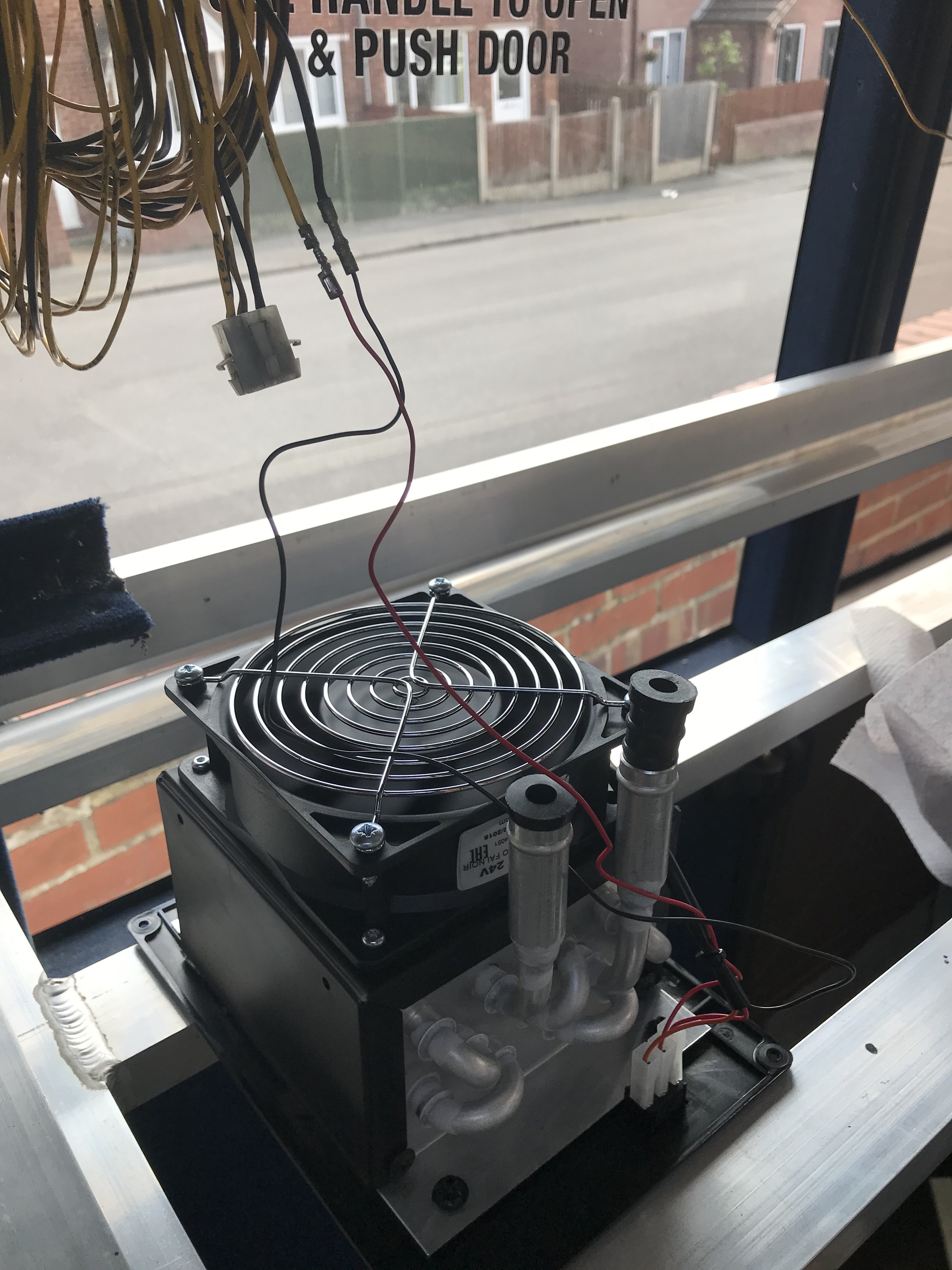

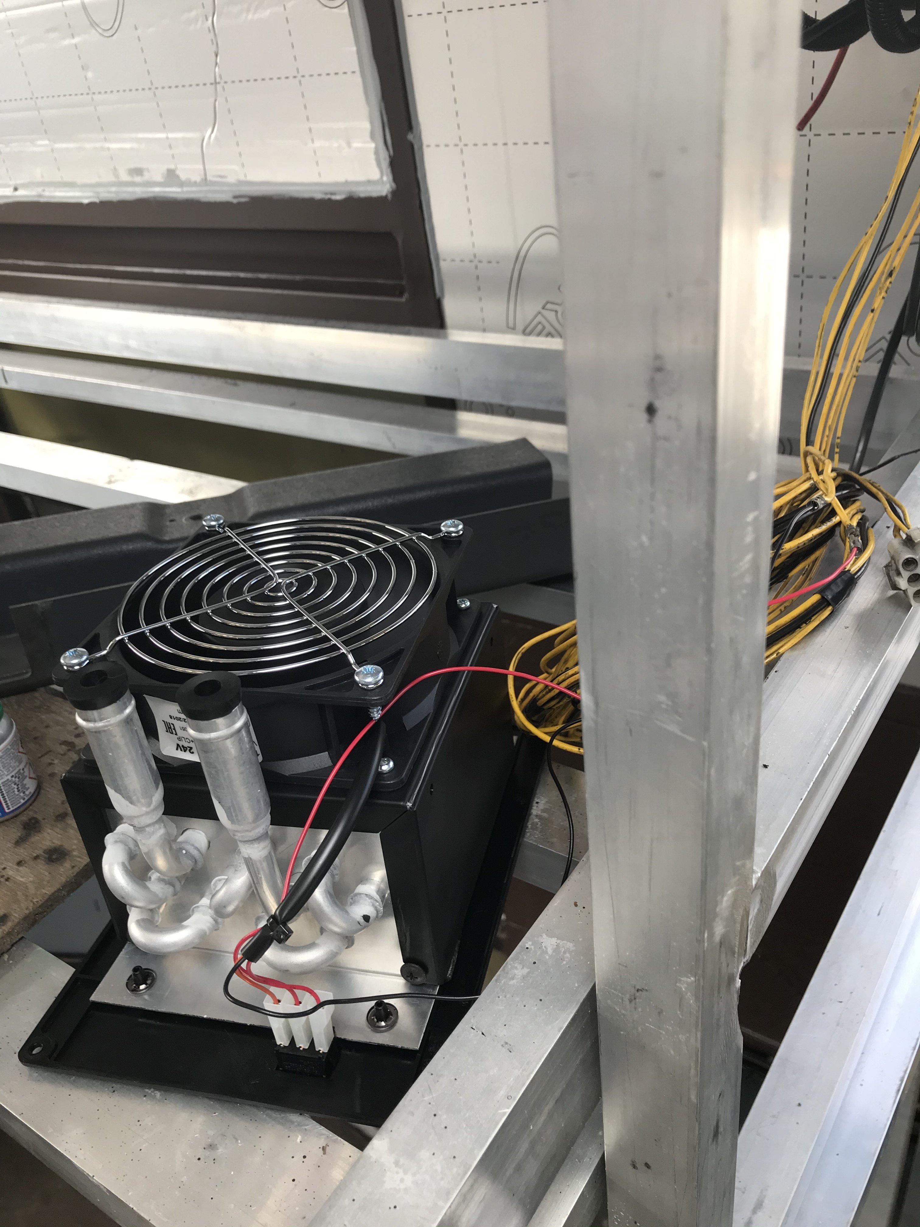

Today some goodies arrived via courier, two 24volt water heated fans.
I won't go into details as to how I'll be using them, that can wait until I get to that stage.
Knowing that a new can of worms was waiting for me I abandoned work for play time.

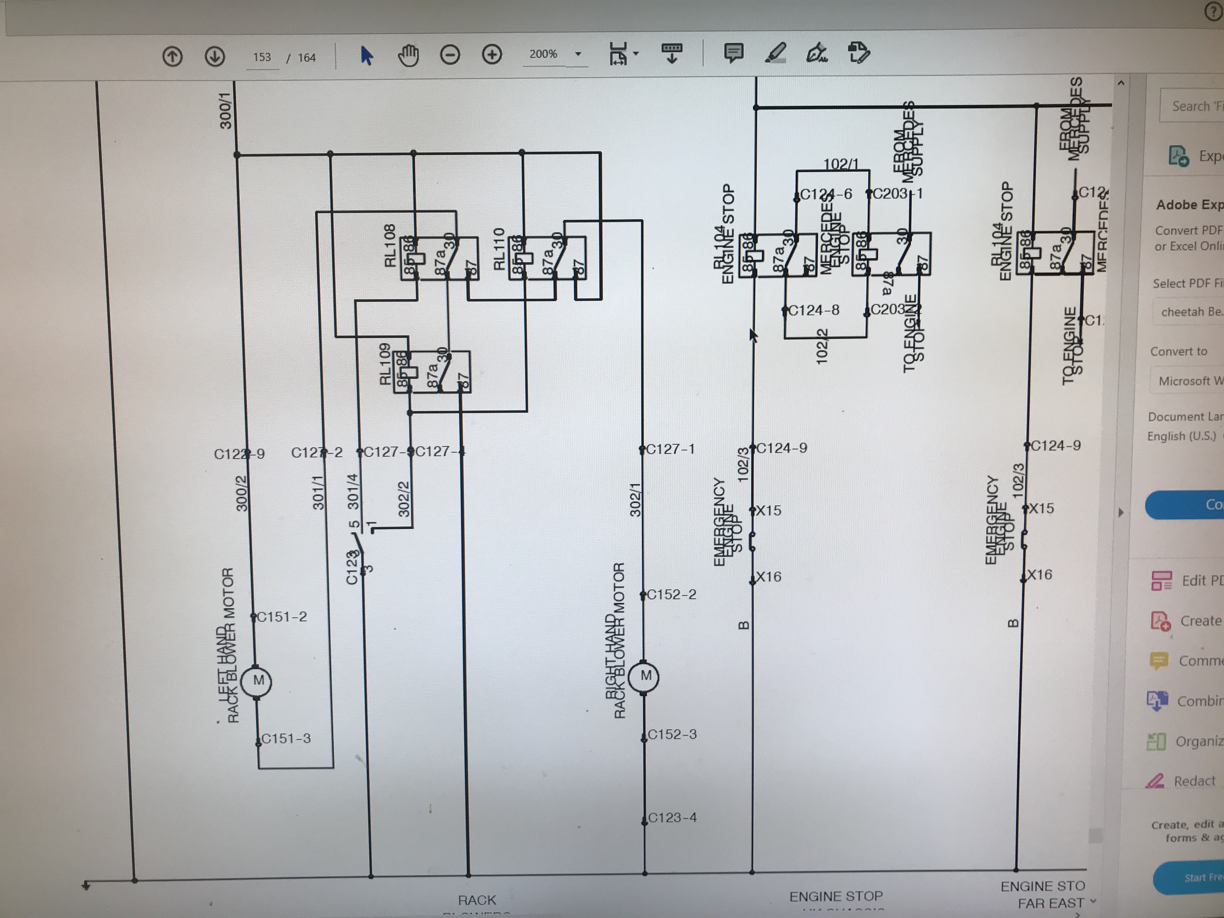

Wanting to use as much Plaxton as possible I wanted to power these fans from the coach wiring loom.
Plaxton go into overkill with the fan wiring. To Avoid using resistors to slow the fan speed they have a relay system that swaps the wiring from parallel to series.
First in the puzzle was to find the switch and the socket. Easy.
Next find the wires to connect the fans, not so easy.
Thought required. After studying the wiring diagram I thought it would be easier to solve in Parallel (full speed)
One fan works, the other doesn't.
I had a pile of redundant relays, so it was easier just to swap them out until I heard the second fan.
Switched to low speed and the fans slowed. Success :)
I know it's not much, but it could have been a pain. Pleased it was solved in an hour.

I have an eberspacher heat exchanger under the bed next to the calorifier, three fan unit. Took a while before I realised what it was. Can be turned on in the cab when driving to warm the hab area
That's the idea. I've done this in Murky. If I isolate the engine from the heating circuit I can add to the Blown air heating by using the water eberspacher. So in a worst case, I have two forms of heating.

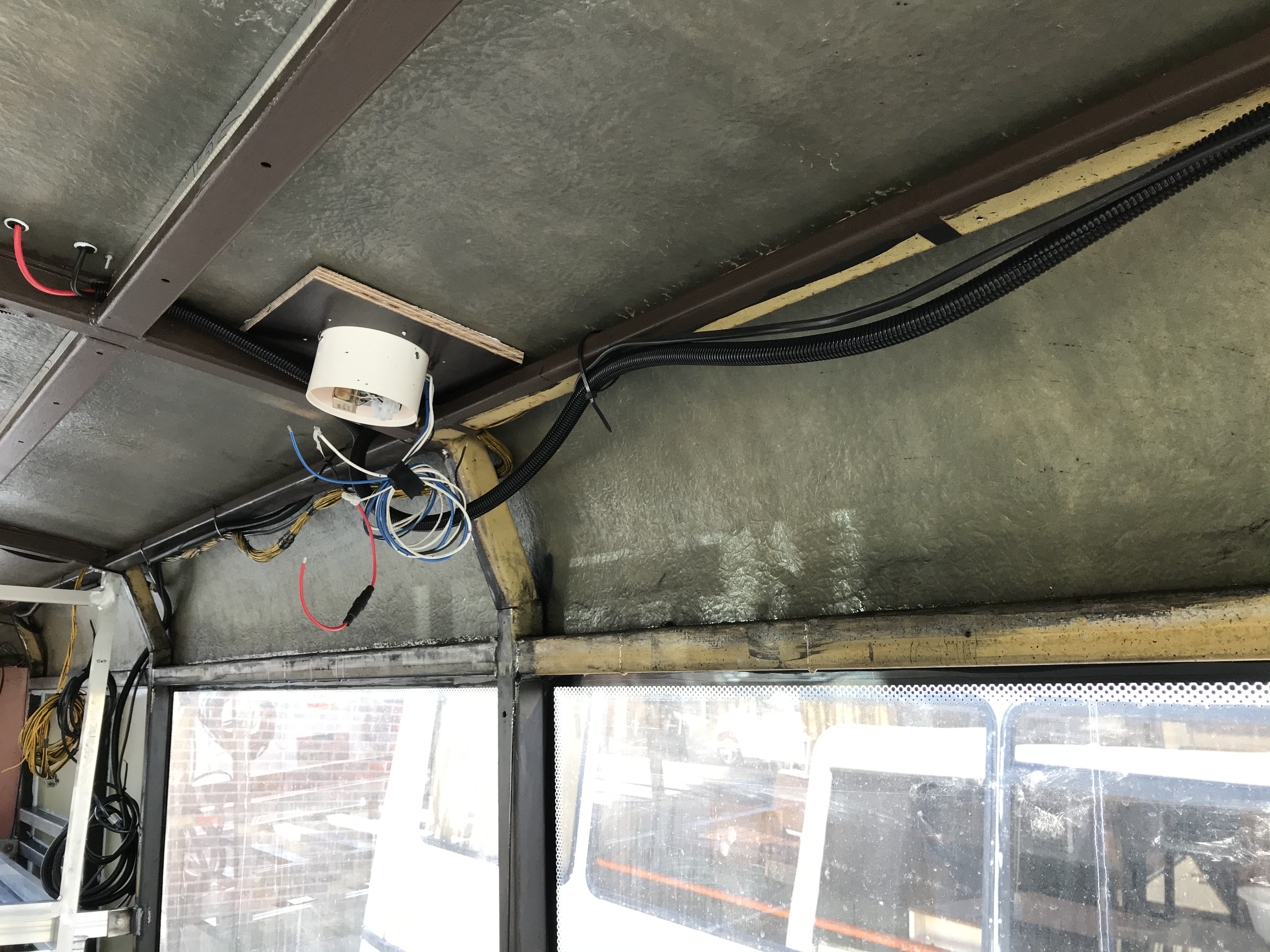

Took the day of today to finish sanding the paint off Betty’s roof. My thirty year old orbital sander fell apart! So rather than fix it I dug out a fifty year old one. I had to swap backing pads as rats had eaten the foam. Oh what a dream to use, I should have used it sooner.

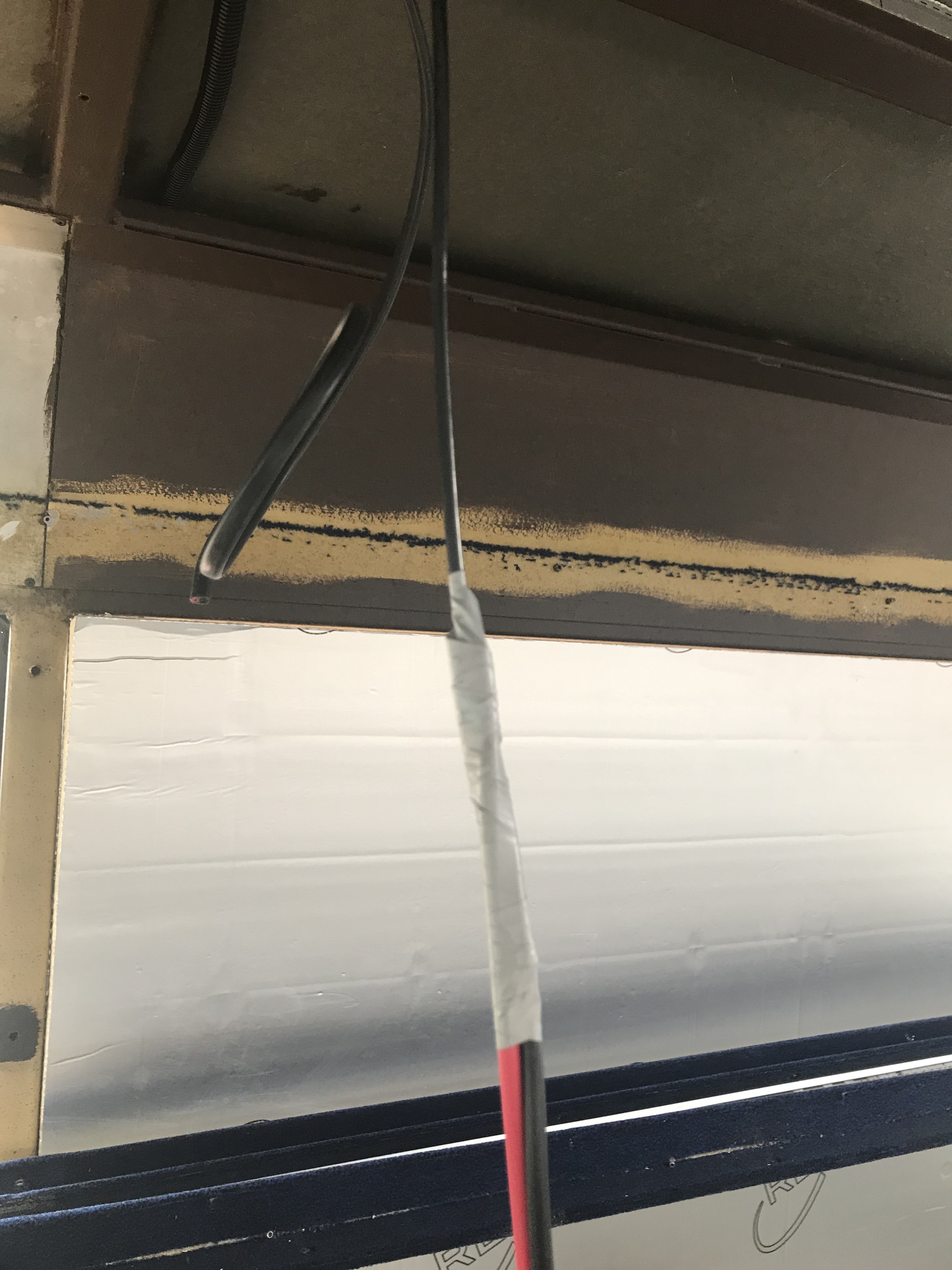

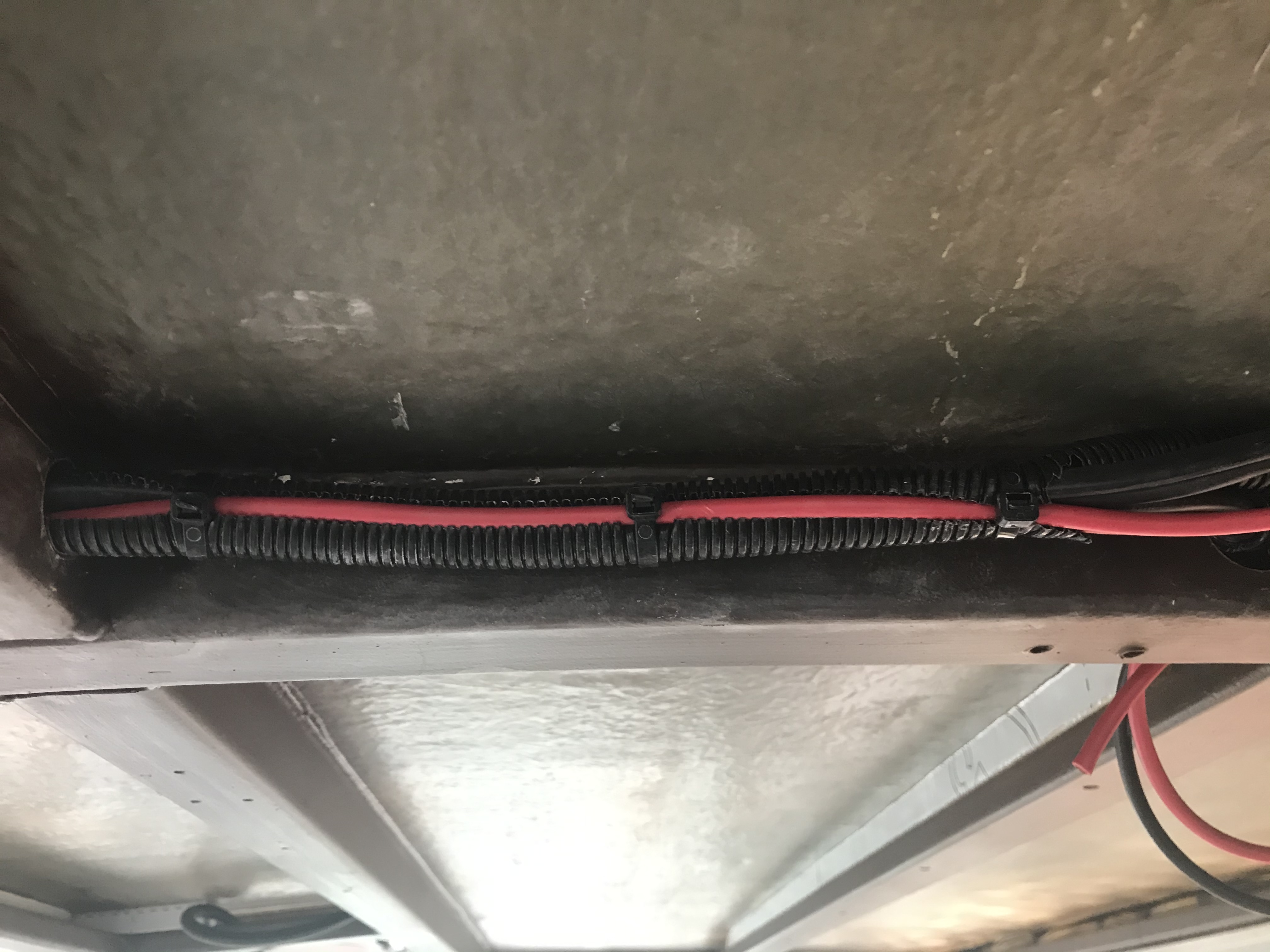

As I mentioned before I decided to fit some extra solar panels. These will have a separate controller. So extra wiring! I’ve pulled out insulation once before, and don’t intend to make a habit of it. In hindsight it would have been the sensible option. The conduit was packed to start with. You can guess that it wasn’t going to go well. In the end I had to solder a piece of welding wire to the cable I needed to pull through. One wire was already in with a fight. Getting the welding wire through was not to bad, but only 10mm peeped through. I ended up using mole grips and a plastic hammer to get the wire through. Once I had enough wire to connect to I gave up. I will connect another wire to this as I couldn’t face pulling through another three metres. I think the conduit must have had a cable tie around it.
The first picture was wishful thinking. The next is what happens if you make the conduit eat to many cables.

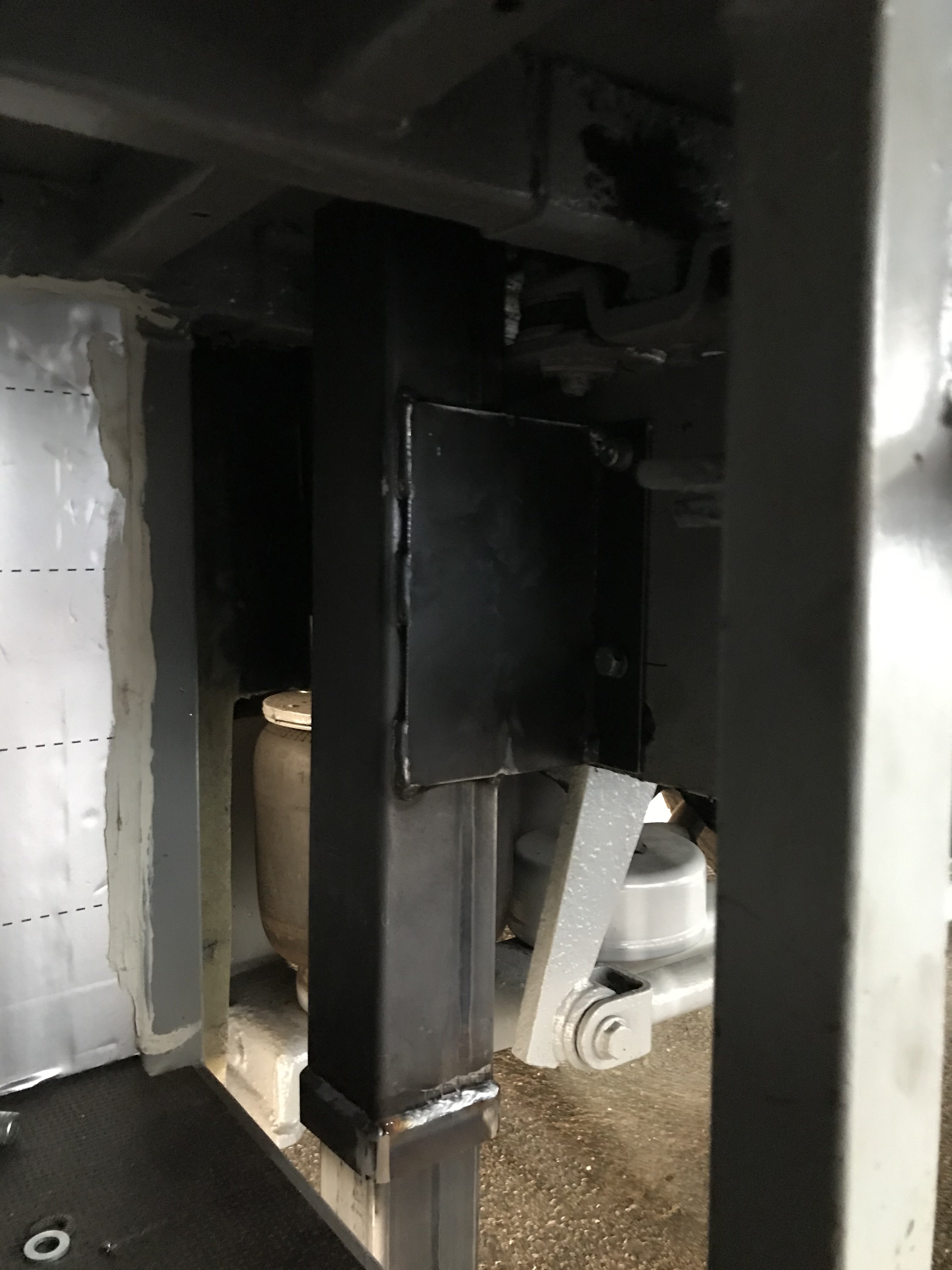

If you stare into the darkness, you’ll see the prototype jacking leg. Still needs ears for the ram and I think some gussets as I’ve had to space it further away from the chassis than I’d like. What a horrible position to drill holes in, but all done on one side so less work in the future. Getting to the expensive stage now. Two rams and a 24 volt power pack.
