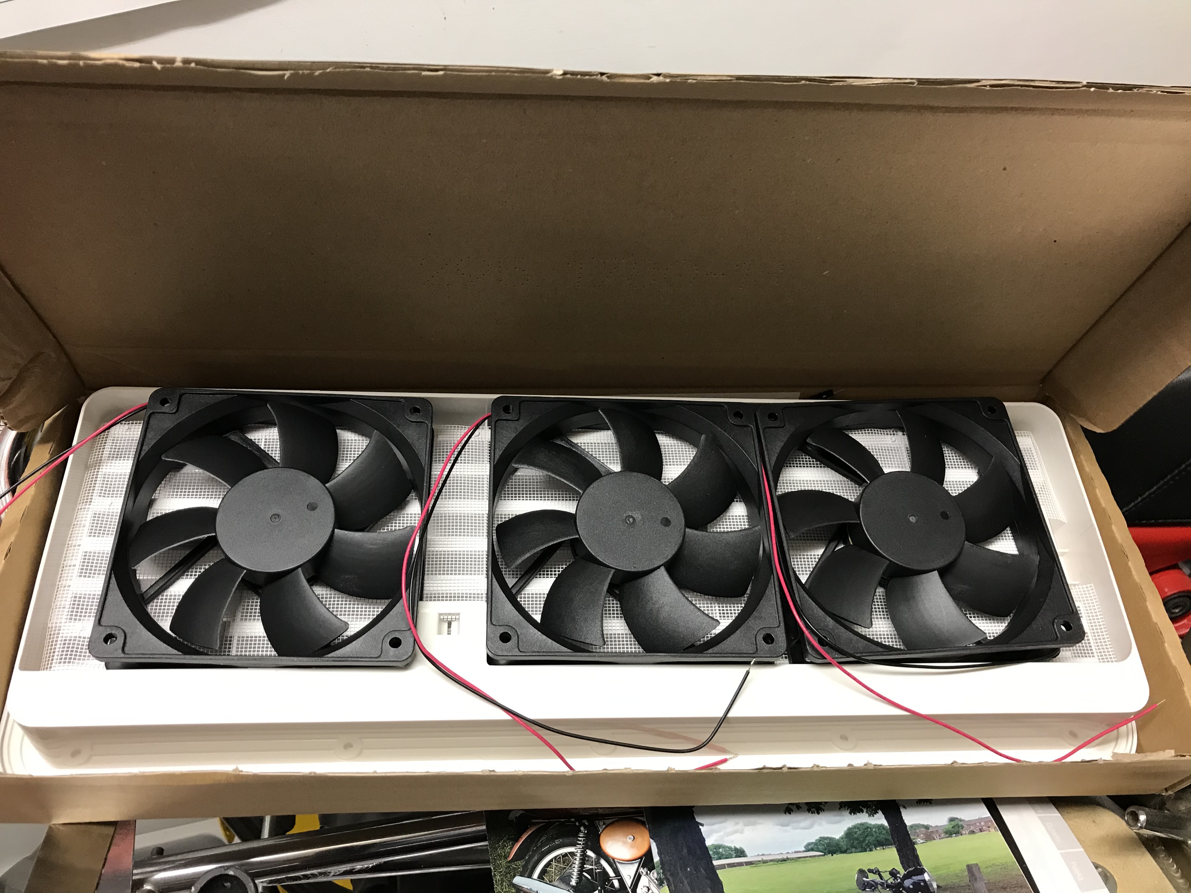

Are you going to do it so the fans gradually kick in one by one depending on the temperature and cooling needed?
Fancy idea there David, but I'm going to keep it simple. Once current is detected in the fridge supply the fans turn on. Once the fridge stops the fans turn off. I have a self powered Chinese current detecting switch, but as yet it won't play. I suspect I'll end up making the device I posted earlier.
self-powered? so drawing power from the circuit it is current-sensing? If so I can't see how that will work as it will need power in order to be active to sense the power? and draw enough power to drive the fans as well?

Just got this little animal to work. It was silly, but I hoped passing the whole power cable though the hole for the fridge would work. Of course it didn't. So I split the mains cable to just pass the live through the hole, and it works. Pleased with the success I might try and use it's switching contacts to switch 24 volts at 420mA and avoid the relay.

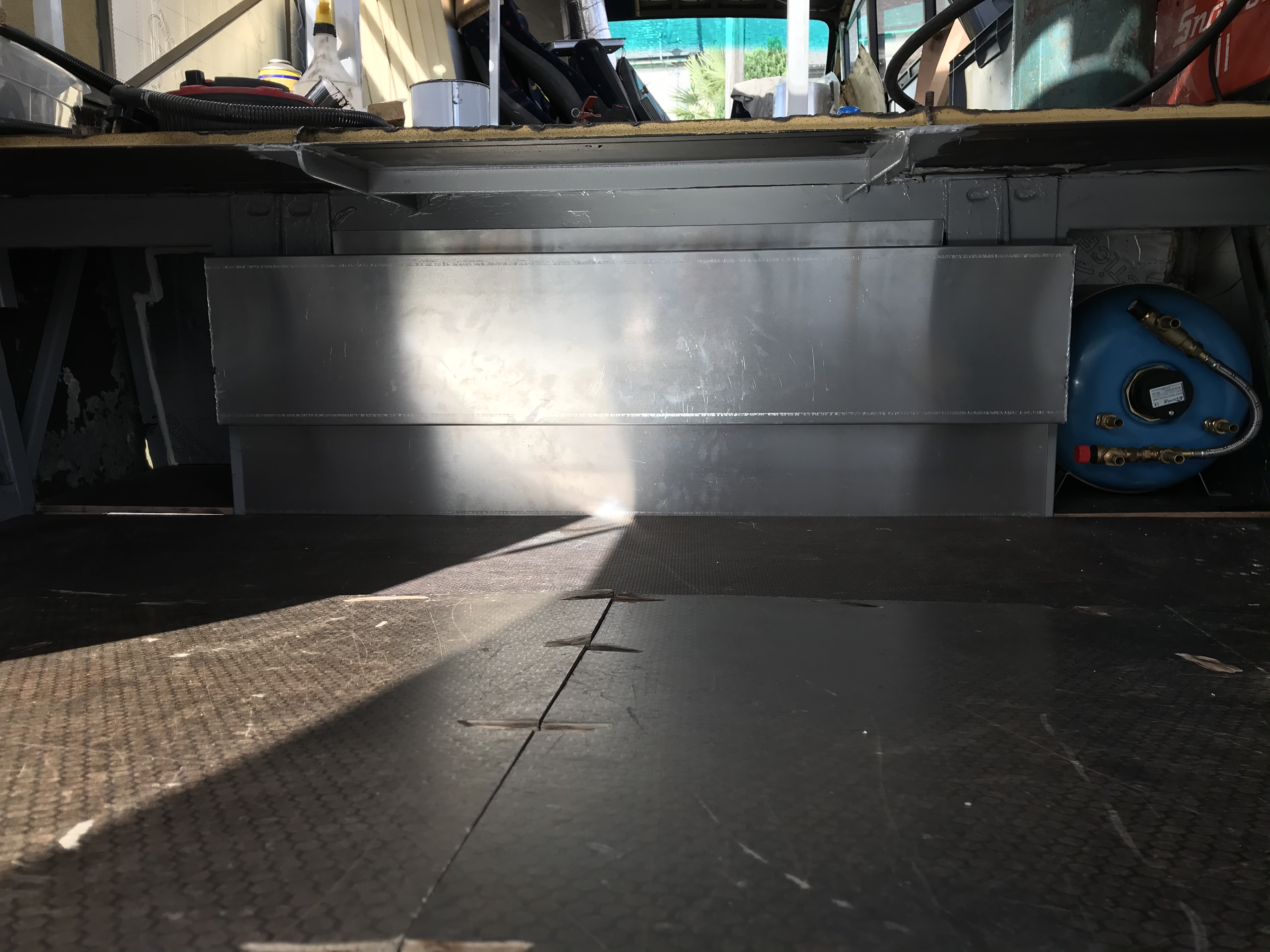

Today was a fabrication epic. We had some 1.5mm aluminium sheet left over from sealing the engine from the cab.
Rough sketch made and we had enough material. 1300mm wide and our Brake Press tooling was only 1250mm. We got away with it. Unfortunately the machine was not big enough to make all the bends, so I had to do a 1300mm open corner weld. That went better than expected. A bit of trimming and we had a panel to close a big hole in its bum.

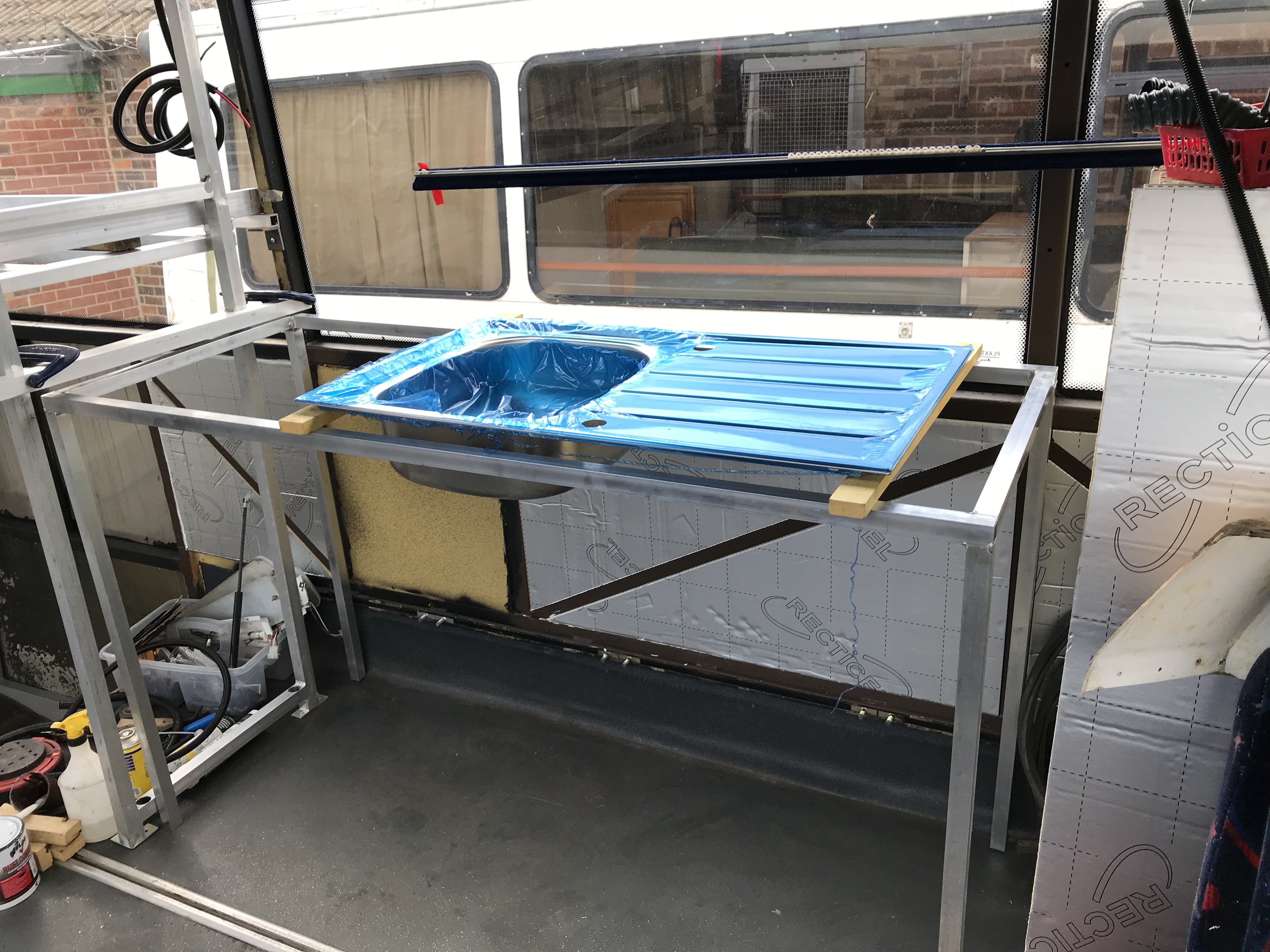

Next we made a quick kitchen cabinet as a tester. Going to have to move the back legs forward to get all the plumbing behind. Then the argument, I wanted the sink drainer on the left hand side as the cooker will be too the right of the sink. I was told firmly that the drainer must be to the right.

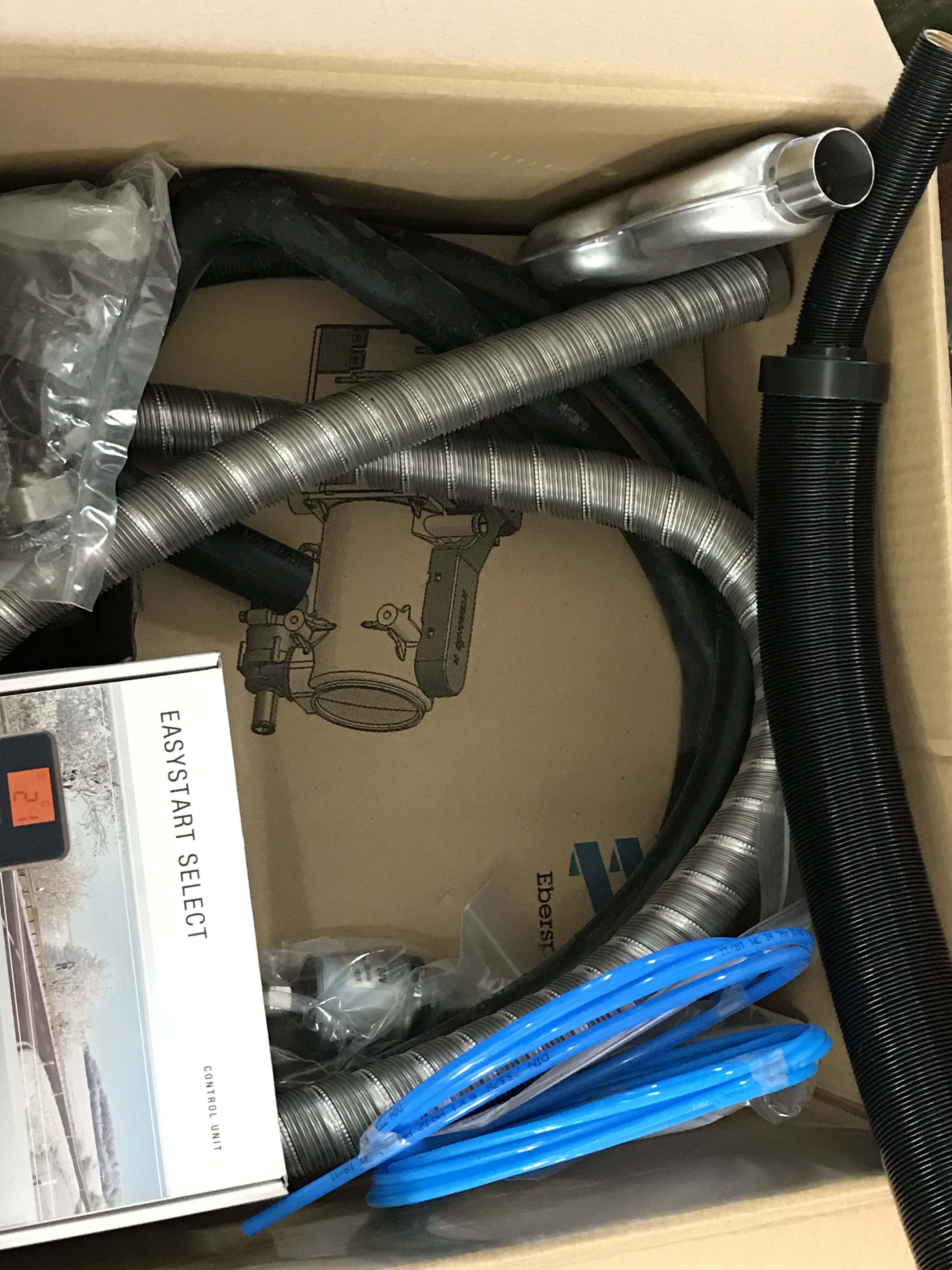

Another box of tricks turned up today. Hopefully once the boiler is fitted I'll be able to enclose more of the front end. All for the sake of being able to get a spanner on four bolts. I'm going to plumb this the way we worked it out for Murky as it worked so well for us.
Window Man appears tomorrow morning to remove two pieces of glass, I do hope the horrors exposed will be minor as we'll be having him back in a couple of days to refit.

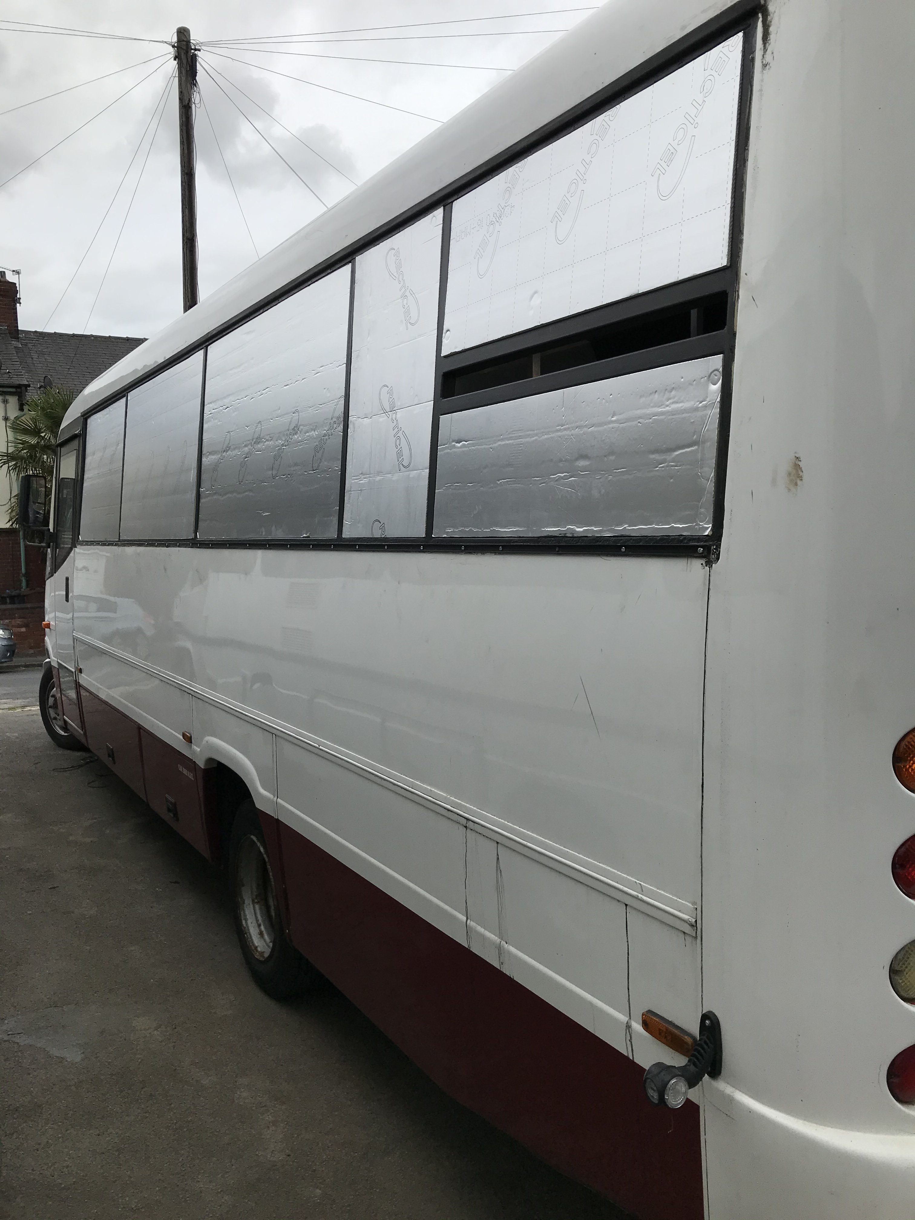

It’s been a bit of an odd week. First two windows removed, so then the panic to get the repairs done. The rear window is being replaced by an aluminium panel. This has been painted outside, etch primer, primer and black. Each coat containing some kind of insect :( . Extra steelwork added for the new door hinges. Come the day of window fitting it was to0 wet. So two more windows got removed!! To try and keep the rain out sheets of insulation were sacrificed.
Window finisher strips from Plaxton, was quoted £100.00 each. 8 needed! Purchased one of each hand and will make a mould from each. Got a better price in the end with some more trim strips. Stock now considered end of life.

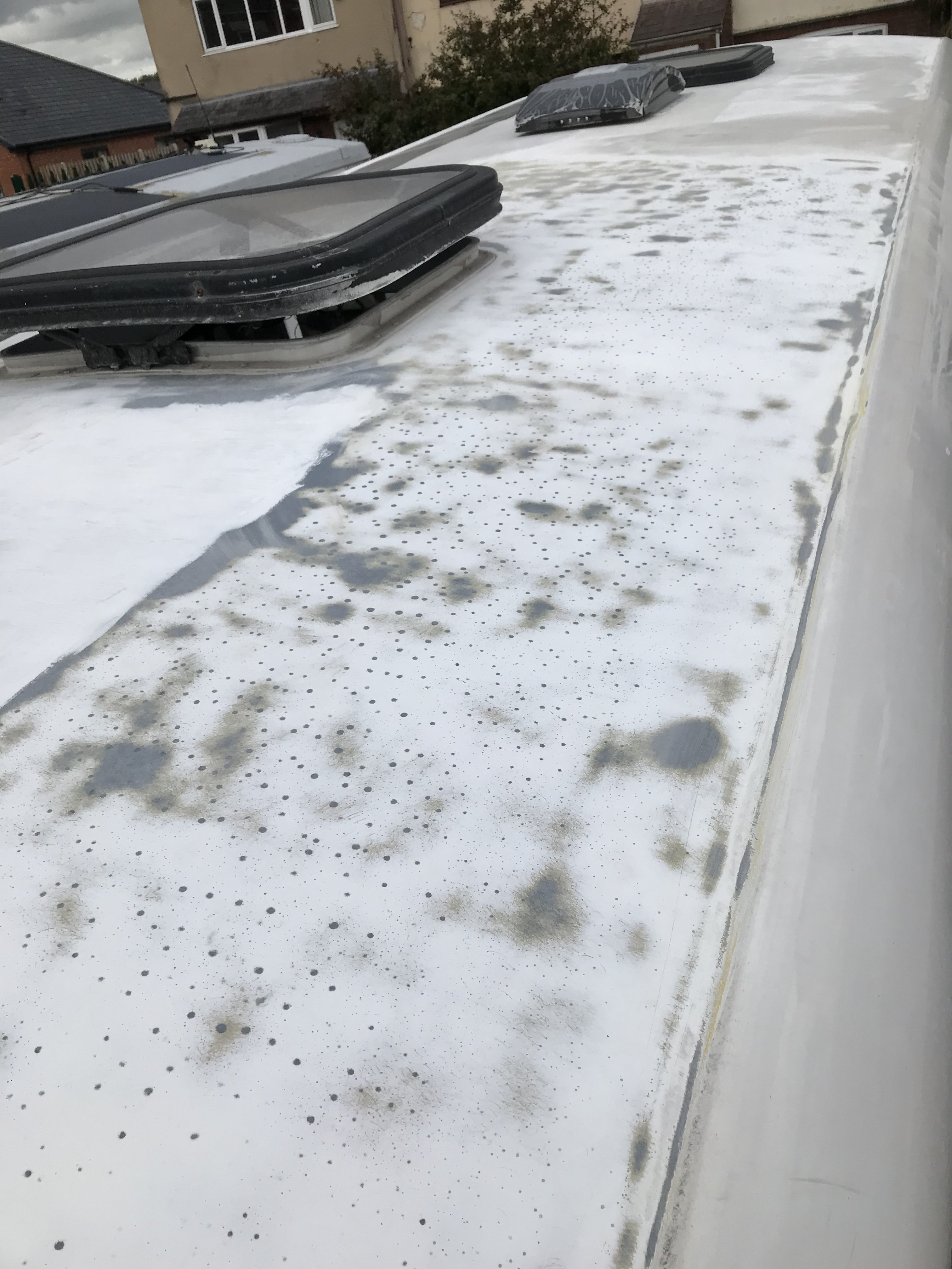

Rather than waist the rest of today I braved the weather and started preparing the roof for some more solar panels.
