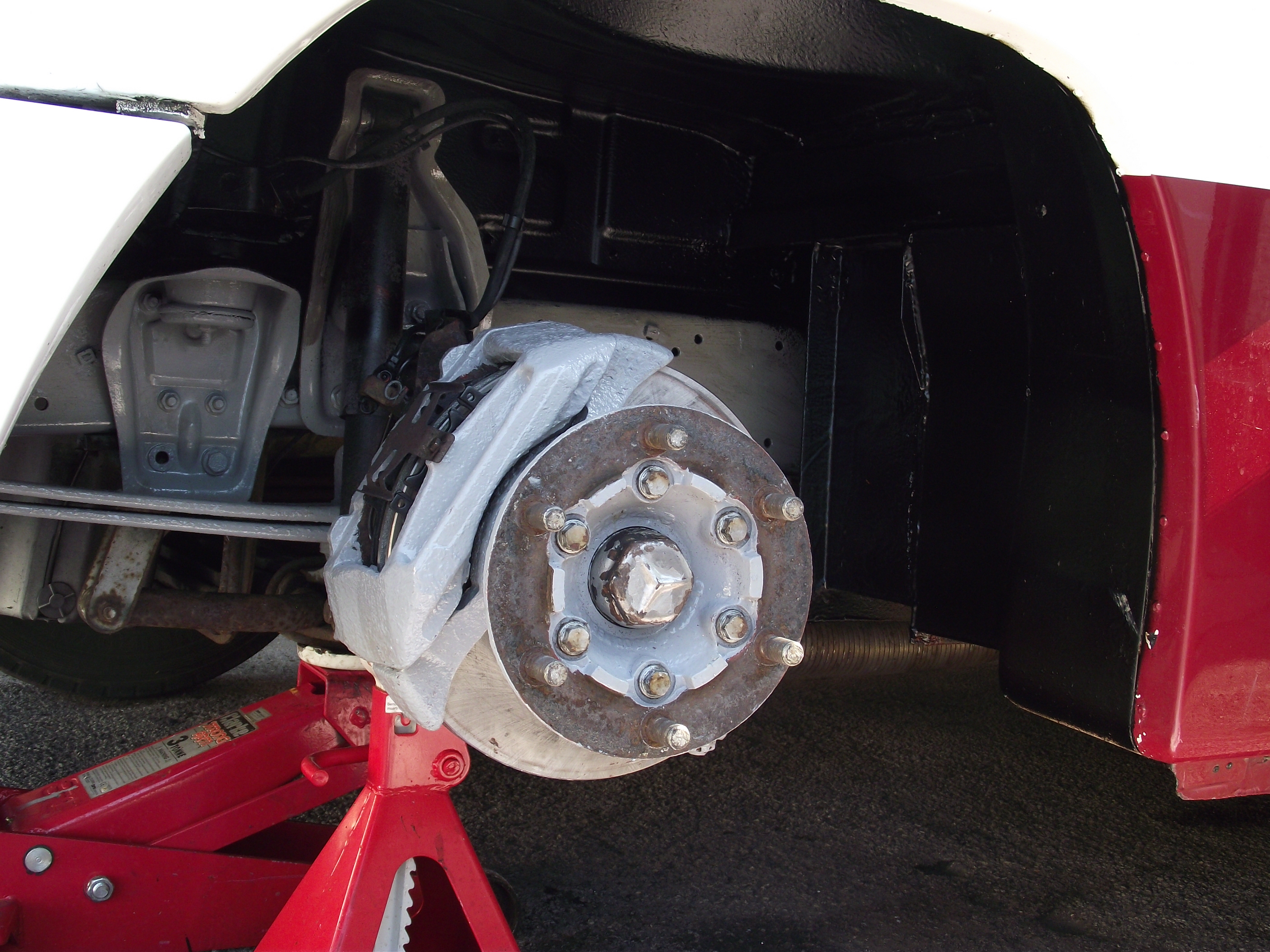

Brake pipe replaced, new brake disc and pads. The hub was washed along with it's bearings. No damaged found so greased and fitted again.
First time bleeding air assisted hydraulic brakes, so much easier that vacuum brakes.

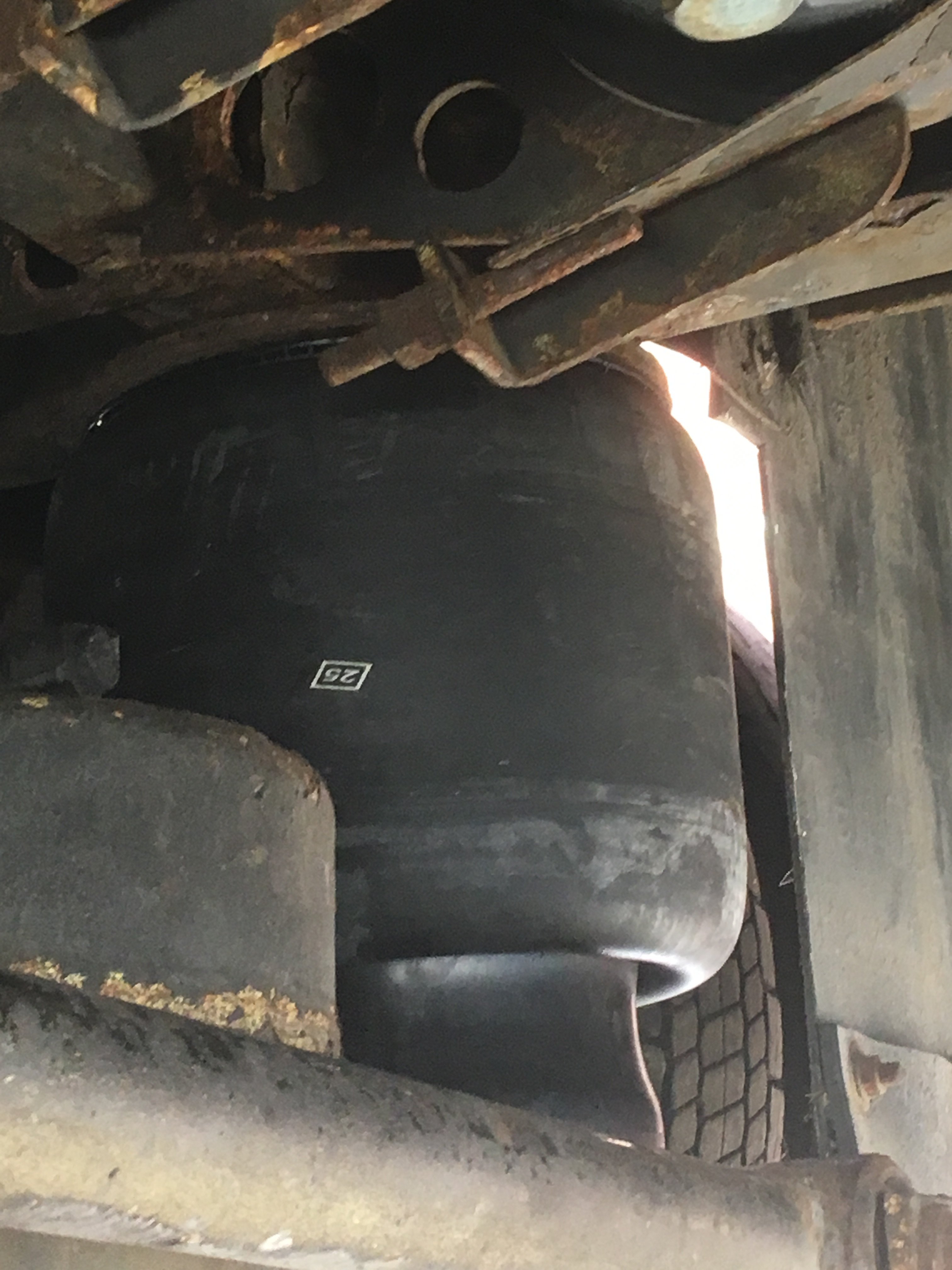

No beautifying this time, I just wanted to get the bag changed to prove that as my major source of air loss. Sod working in this heat as well!
Was a bit worrying as the Mercedes info I read on changing it kept on about the risk of being crushed and death! So I made to aluminium blocks to hold the chassis of the axel as I let the air out. And for good measure I left the jack in place I used to increase my working clearance. A future pain will be getting someone with the box of tricks to set the body height and level.

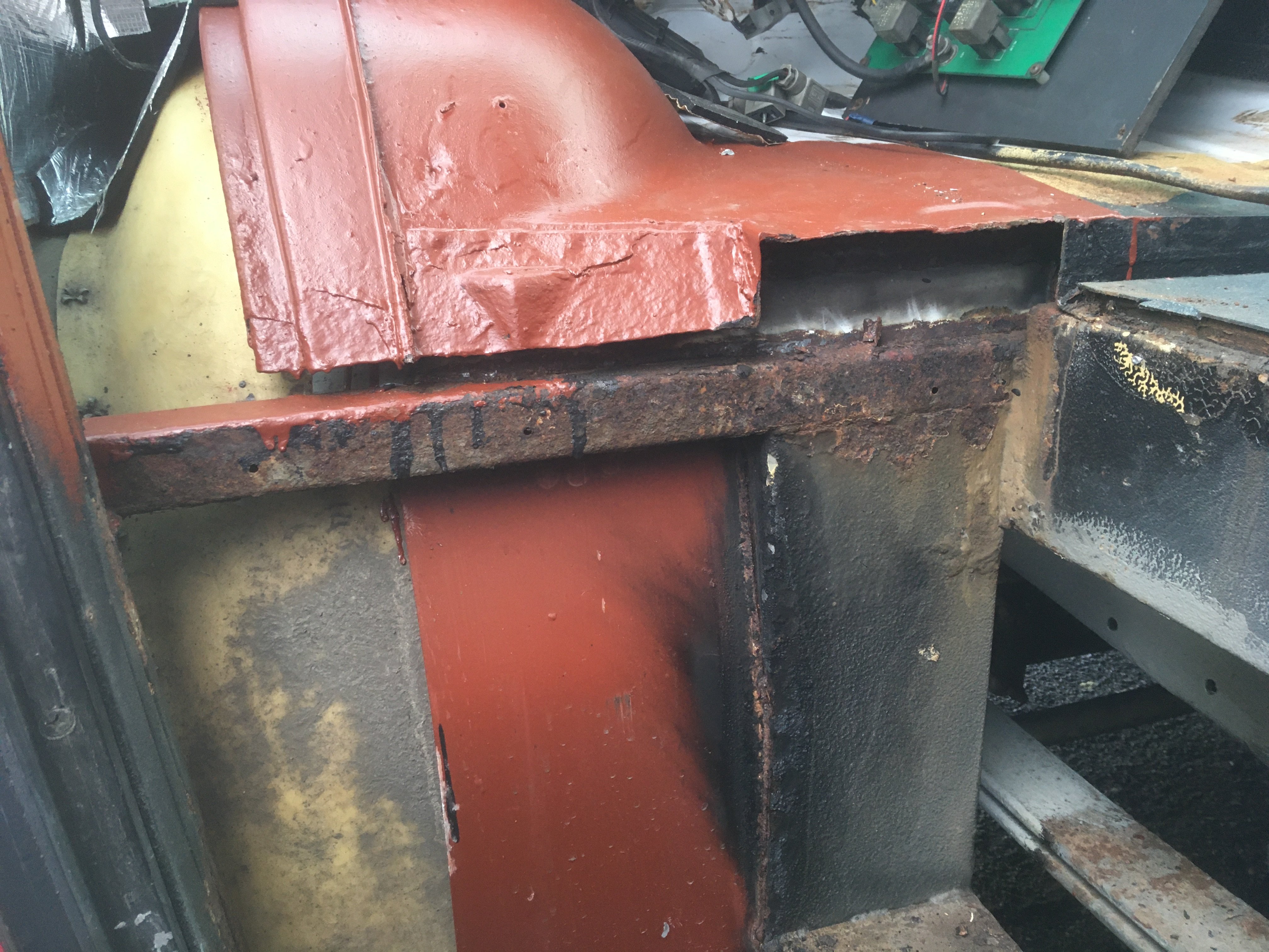

I must admit this build feels more like demolition at the moment. There is a lot to be said for converting a donor vehicle and ignoring as much as possible. I have to admit I was one of those people. As both my previous conversions were in desperation with limited funds and resources, I later paid the price by having to destroy good to repair hidden problems. Today a big hole has been filled and the engine bay is finally isolated from the habitation area. The underside is sound insulated and the top has had the same treatment. A decorative panel covers this, and this is all it had.

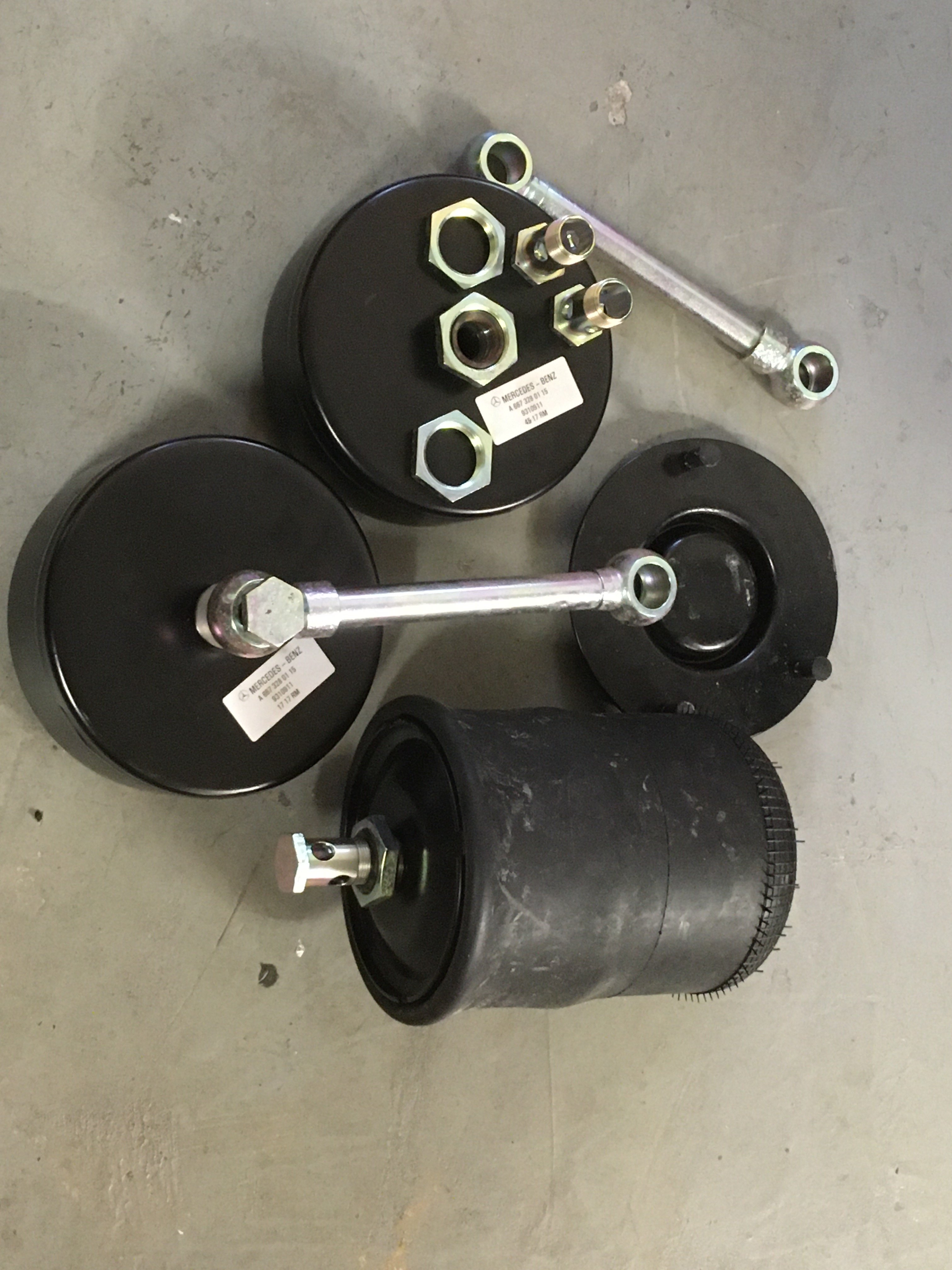

After replacing a suspension air bag for the first time and then discovering multiple other leaks I was somewhat disheartened. Lots more expense and hopefully reclaiming some fittings, I should have the bits to rebuild it. The steel dog bones, banjo bolts and nuts were bead blasted free of rust and then electro zinc plated with yellow passivation (zinc n yellow) The first stumbling block is I haven't cleaned and painted the areas that have been exposed by the disassembly. Second, if I did rebuild it I can test it. As some of the local scum stole the diesel. Lastly I'm not allowed to play outside until my leg heals! :(

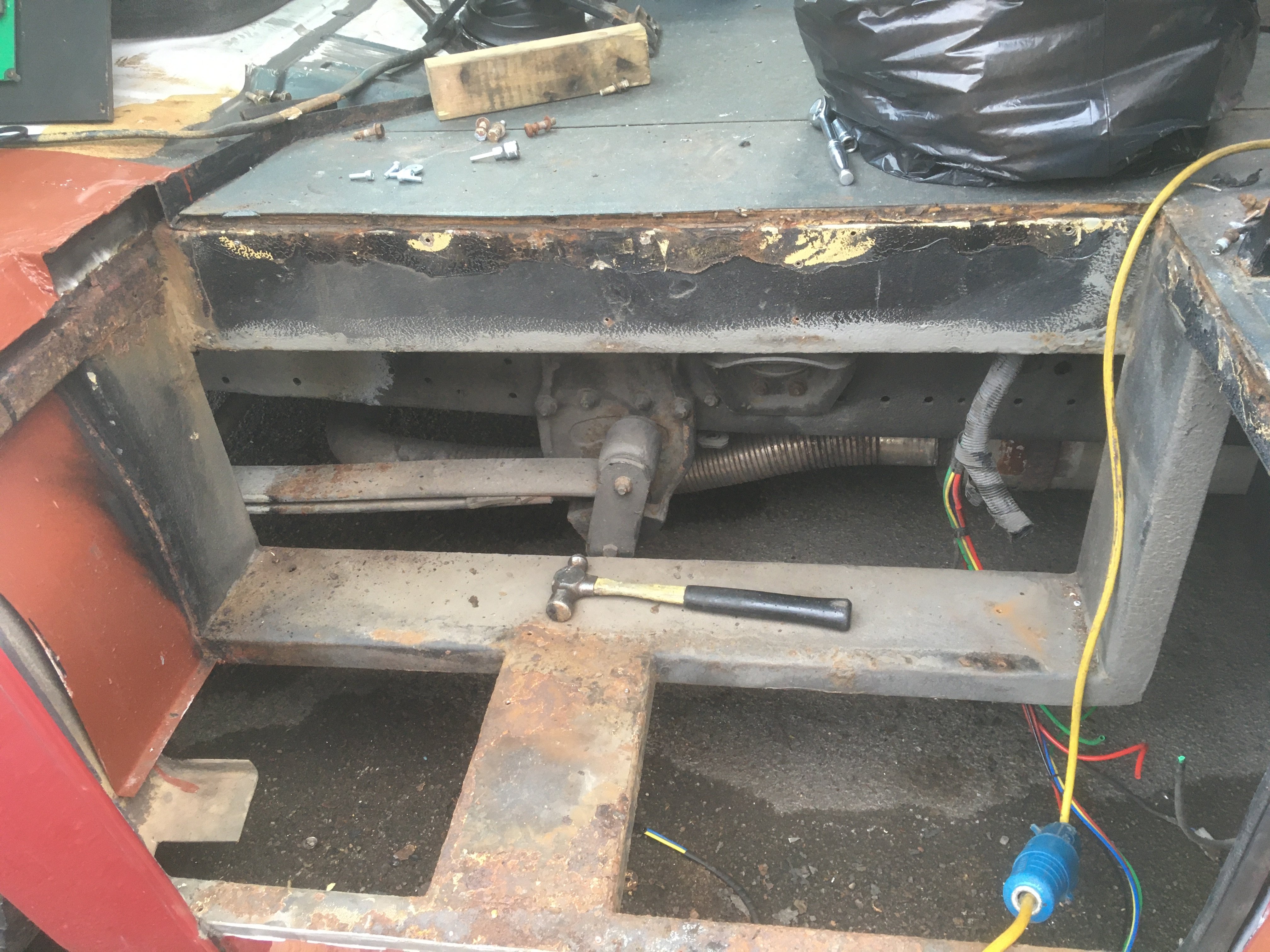

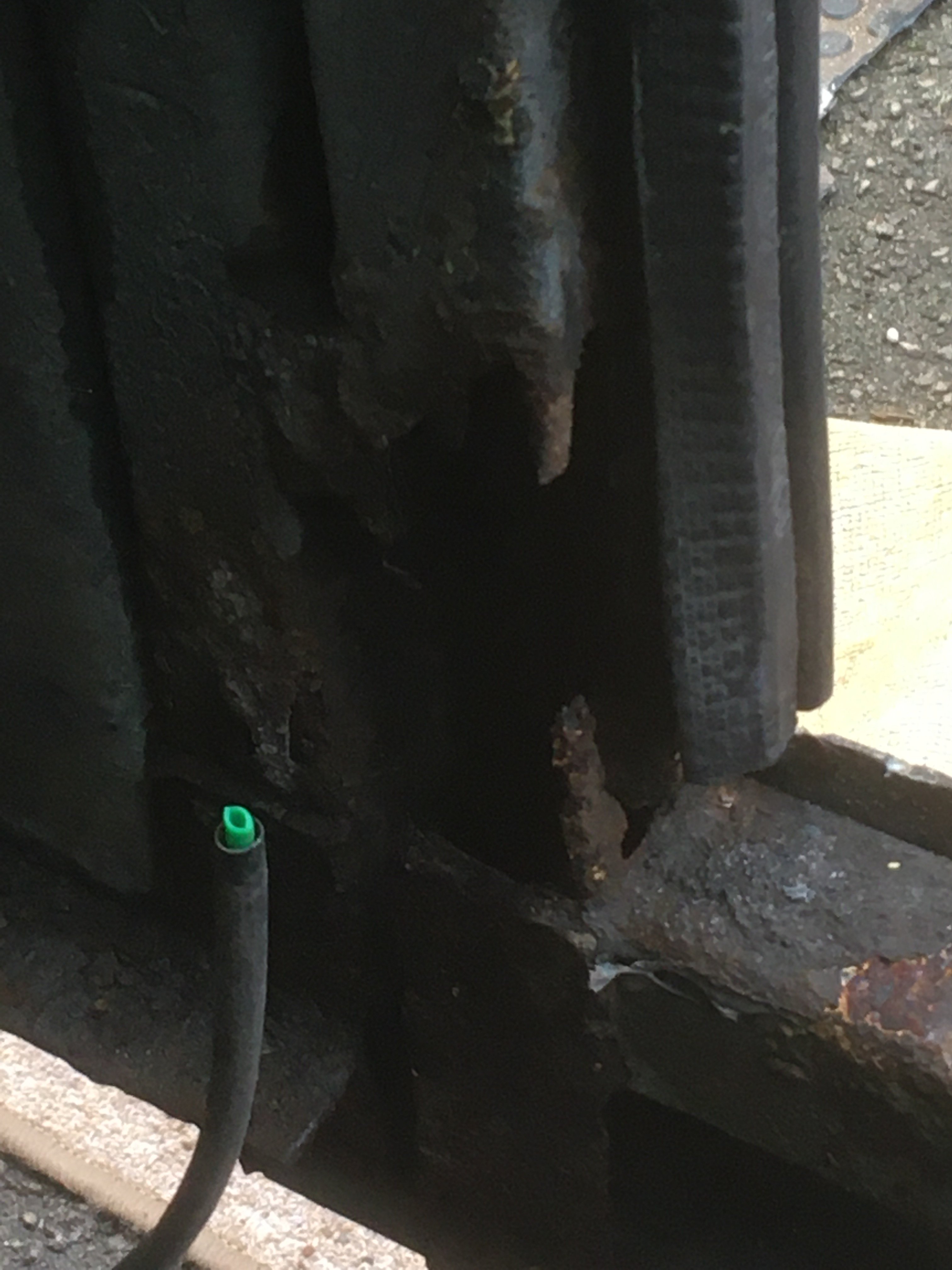

I don’t expect I’ll get much more done this year. Again more demolition. I knew from the wheel arch repair there was hidden horrors, and the only answer was to remove the step. I also expected issues with the back lower door frame that was also hidden. To some it may look horrendous, but I’m surprised it’s so good. I am going to have to make a new lower door pivot plate as it does not have enough adjustment to align the door. With any luck the step that covered the door ram, will be the new D4 eberspacher home.
