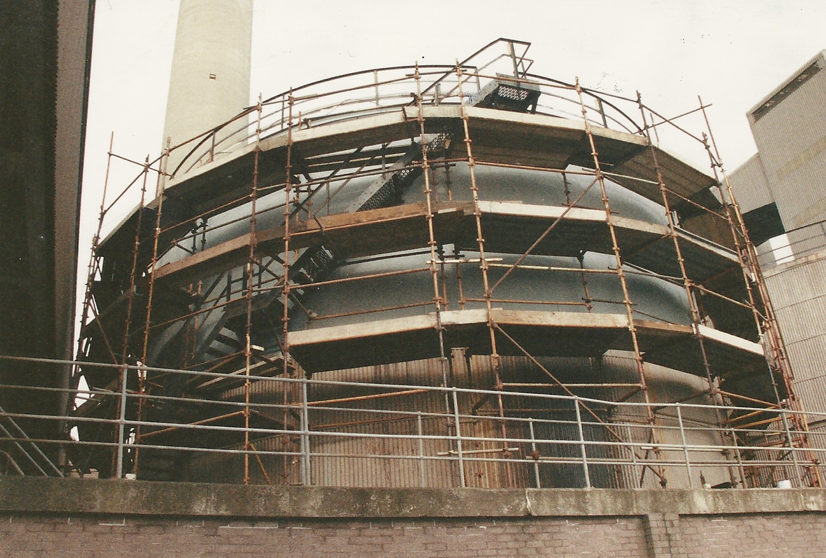

I think you should have shotblased the steel and sprayed with weldable epoxy primer,bare steel is covered in blue scale which lets go,thats why big boats are left to rust before being blasted and primed,this was my main biz.

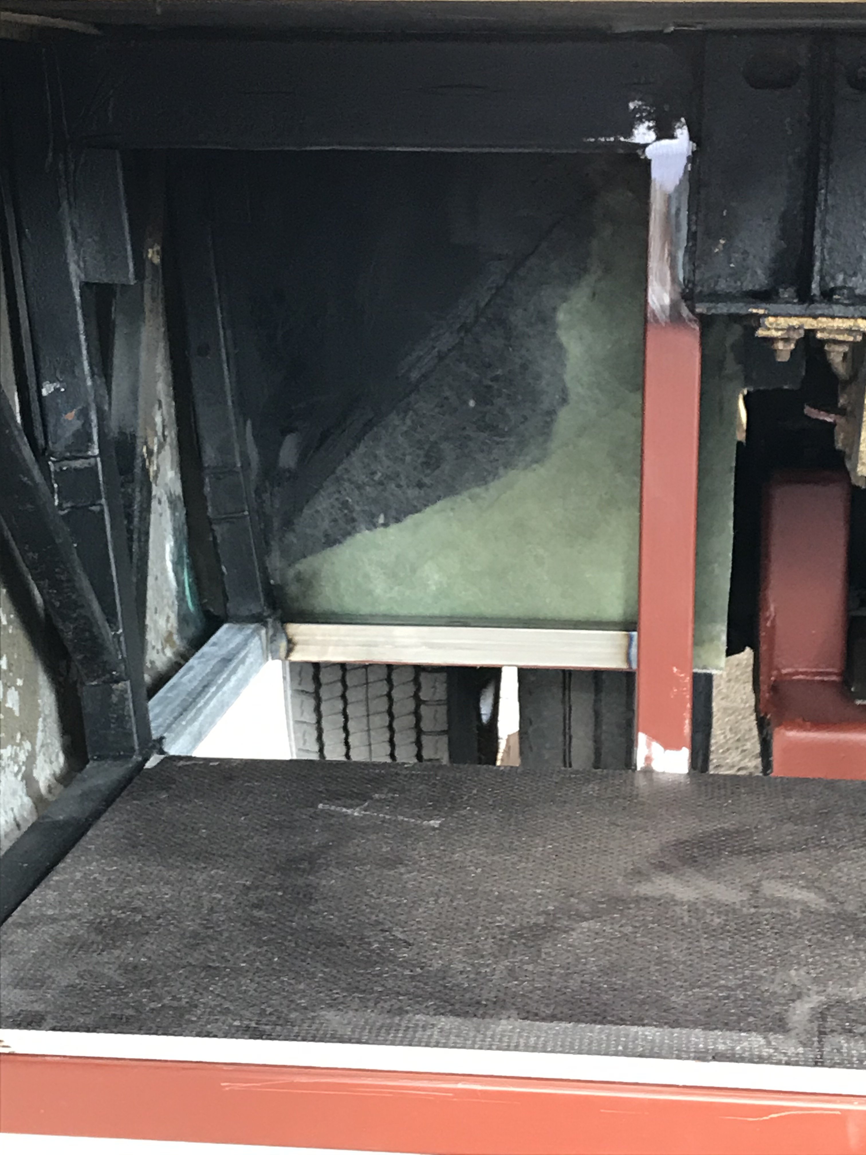

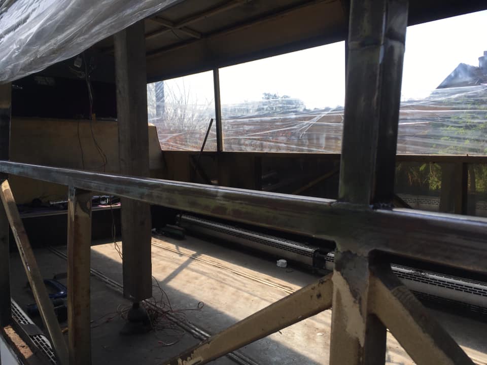

Slow progress, but it is progress. Bags and air chambers removed to aid cleaning and painting. Structure has been added to have a gas locker on the left hand side and a home for the calorifier on the right hand side. The Gas locker will be panelled on the inside to help with the inevitable rough handling of the gas cylinders. The Calorifier home will just have celotex bonded into the frame.
Whilst I was under there glass fibre repairs were done to the wheel boxes. Coach operators run cheap tyres that blow out often it seems.

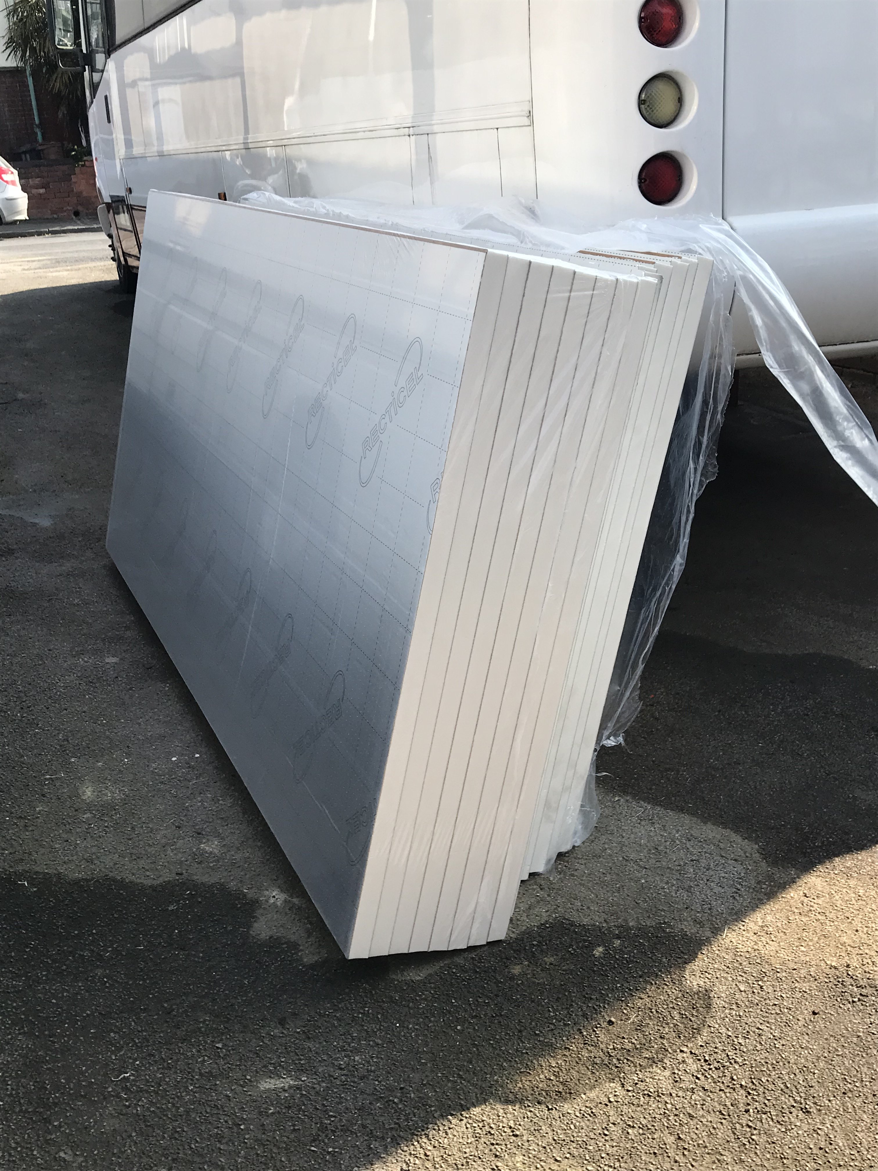

Insulation sheets. It looks like the standard thickness used with the expanded polystyrene was 40mm. So an easy replacement. To level the glass fibre roof I wanted a 20mm sheet so I could cut 40mm wide spacers to attempt to level the roof. I didn't like the idea of trying to cut 20mm slices of the 40mm. I don't really need the insulation at the moment, but the delivery costs make it sensible to buy all at once. All I wanted now was the 20mm. So all the insulation sheets turn up today. No 20mm!! substituted with 25mm!!

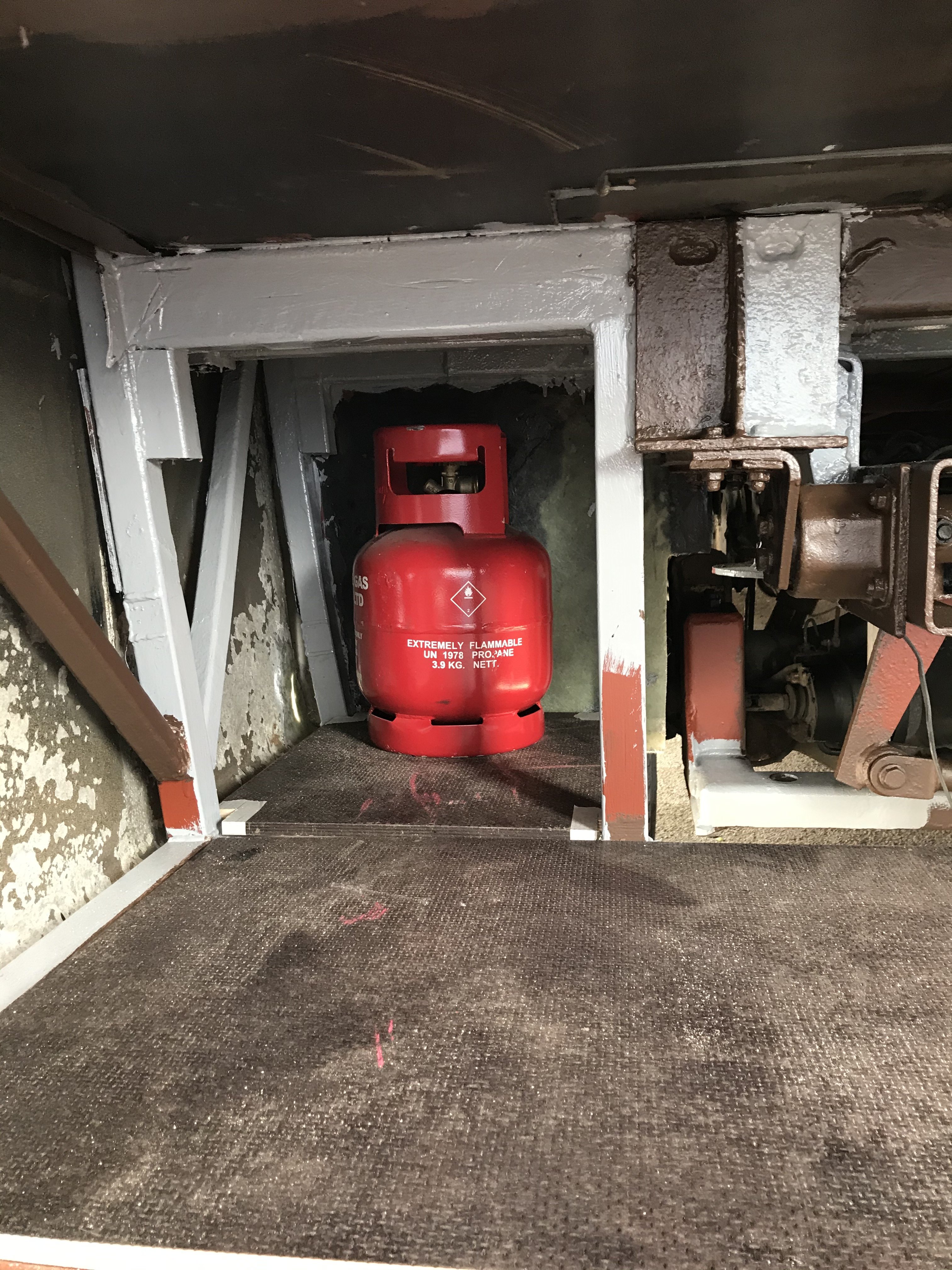

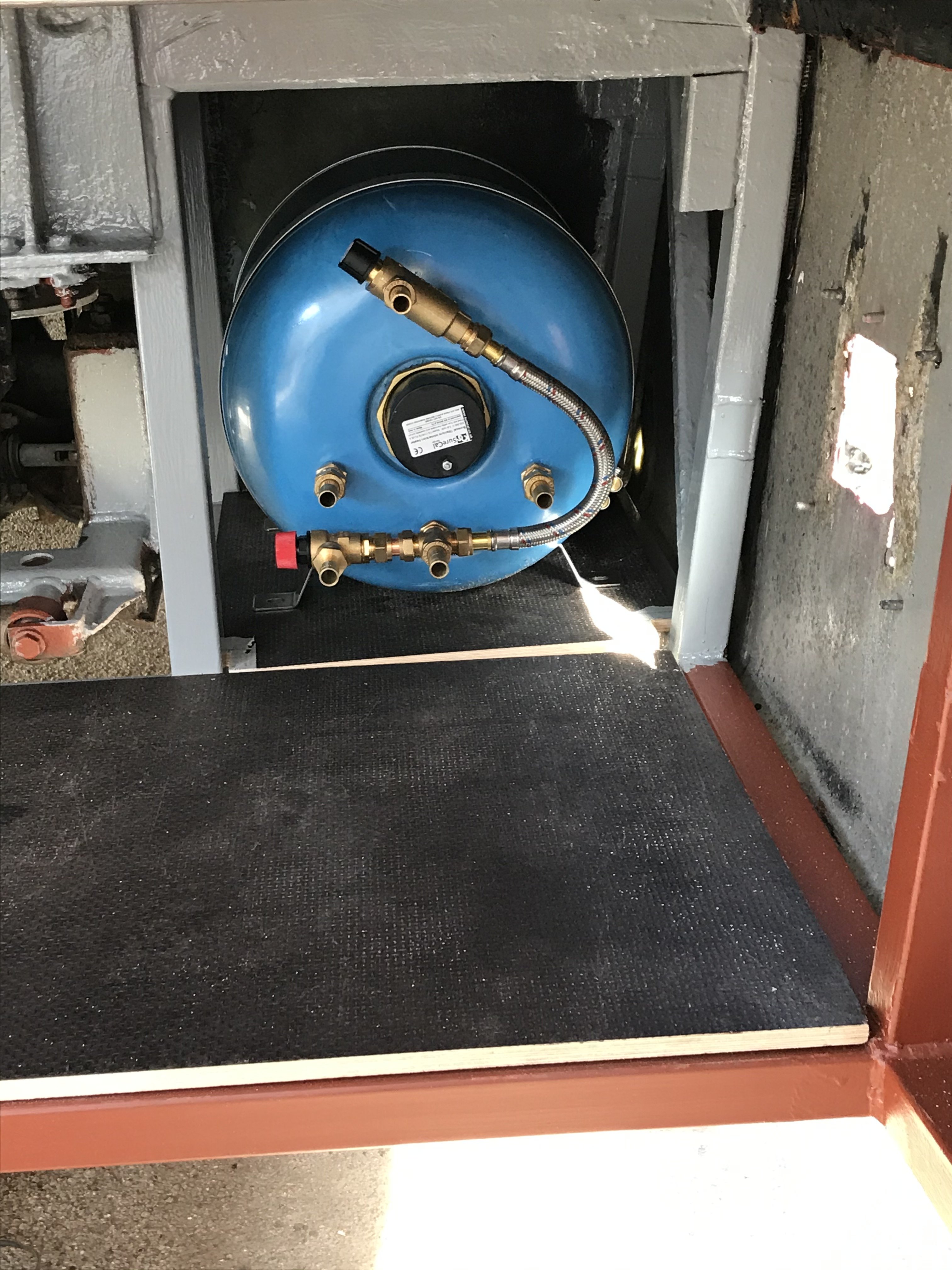

Calorifier turned up today, so a test fit couldn't be resisted. It's going to be snug, but it'll be ok. Once installed any space around it will be stuffed with insulation.
Also a trial fit of a gas cylinder. Again snug for two cylinders, but it'll be ok. The access door will be on the outside. Unfortunately a bracing bar will cross the door opening. Something that will have to be lived with. The cooker will not be far away, so the gas pipe run will be short.

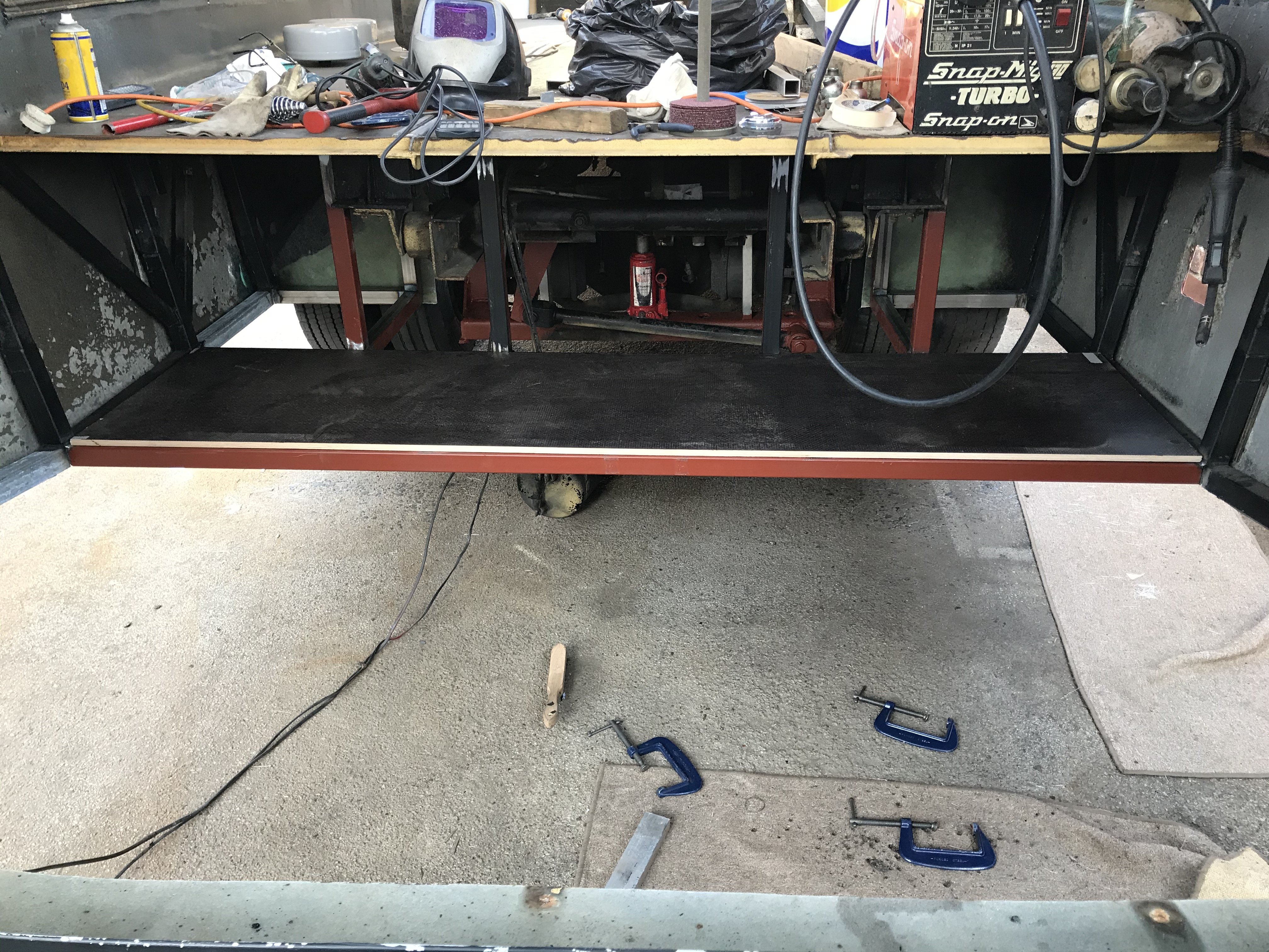

A couple of action shots of Anita fabricating the garage floor outer supports for me to weld in.

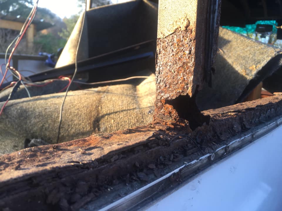

Any more pics, I'm converting an 05, surprised at the state of the box section inside and how difficult it is to remove panels.

That's the best way. Strip all the panels off.
How do you get the side skirt around the batteries off? I had to cut it in half. Also had to cut the cab as the panel below the windows was rivetted to the front edge of the box behind the cab.

Have you discovered the appalling way the engine bay isn't sealed from the cab? You probably know better than me now, but the stainless panels appear to be attached with double sided foam sticky tape!

Hadn't noticed that yet, upgraded from an 811 thinking I wouldn't have to deal with rust, how wrong was I?
I'd have drilled the rivets out, I'm yet to tackle the battery box metal work. Go slow and think about how they connect stuff. It will save you time in the end.

It will be worth it in the end. Just be careful about the steel you use and adding weight. Also the long runs can distort the body like you'd never imagine.
