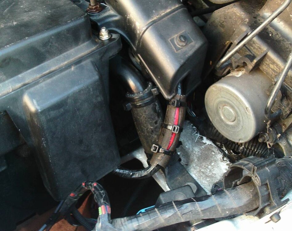

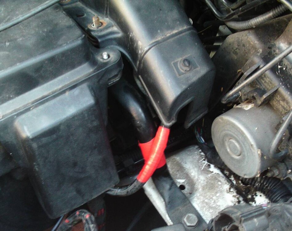

Sometimes there is only one way to sort problems.It seems that every time I take the cover off the fuse/relay box something different happens. Is it, I thought, the fuel hose over the top that has to be moved over to get the box top off, that is the problem. So with that hose hooked up out of the way of the box cover I tried the engine and hey, it went. Still needed the ignition switch half back on to turn off the engine. Did the re-parking which allowed me to perform a much need clean of the drive. Turned engine off and on again and off to check but the third time I tried to start up it failed to go again. Weird. It will be some silly little thing, I am sure. I have not tried it again but I would be surprised if another tweak of that pipe does not have the desired effect.
