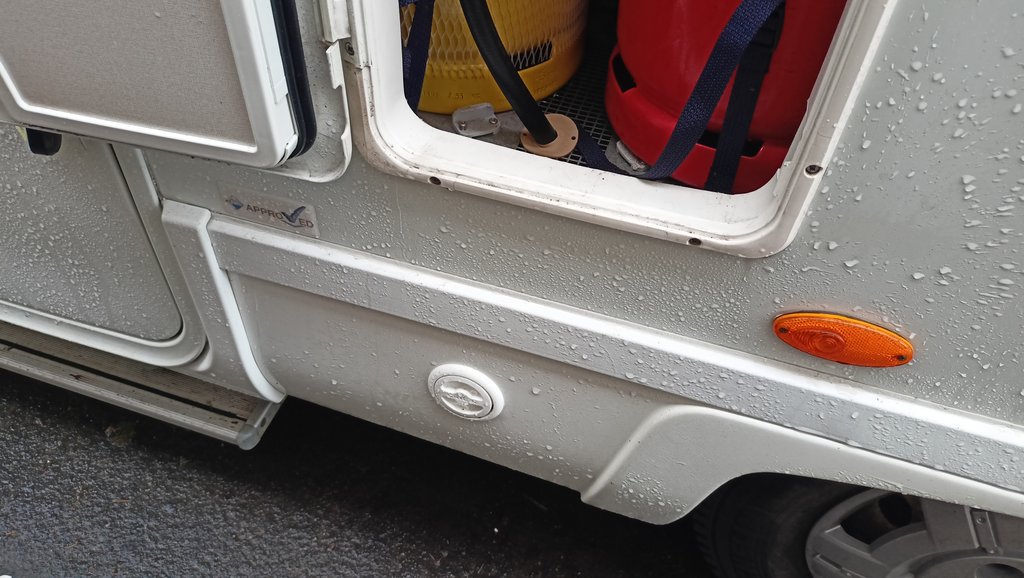

The trick is to keep the Gaslow topped up when you see it regardless of where you are, so you hardly use any Calor, we've not had to yet and I have an almost full one at home anyway as I'd bought them before I thought frig it and got the Gaslow.Yeah I think thats best. If I make the right hand side one the one that comes out it will be easier. Its the most expensive option of course. As long as its easy to swap them. It was your gas usage and a couple of others that made me wonder if we were using more gas than most in the old van and maybe 1 calor and 1 Gaslow would be ok in a newer van but if it works out the same average usage in this one it wont be most of the time. Ill end up swapping to the calor more often than I would like to.
And yes of course Calor in the doorway, I always get them to lift the full ones in anyway, too easy to put your back out at my age.
You need to get a tank fitted then you'll be fine.
I already have lol, mentioned you when I was speaking with him yesterday.Yeah I will. I'm name dropping you and Rob. Better still, give him a ring and tell him there is a VIP Rock Star coming today that hasnt got a clue WTF he wants.He will know who you mean!

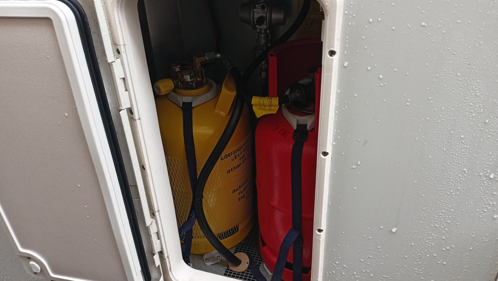

Not a chance. The locker is shite.With a bigger door which is an easy fit you can get an 11kg in as I mentioned ages ago, height would be the problem on some vans, I could do it on ours but it's not worth it as we drive more than Barry.
Its a right wriggling act to get the right hand Calor out as it is. Even if they had got an 11kg in there is no way you would get a 6kg Calor in as well. the door is the biggest problem but the locker is just too small also.Thought cCharlie had an angle grinder, was sure he could get an 11kg in. Cosmetics though…![]()
I dont see why he says swapping is dangerous, it is precisely the same procedure as swapping a Calor bottle.

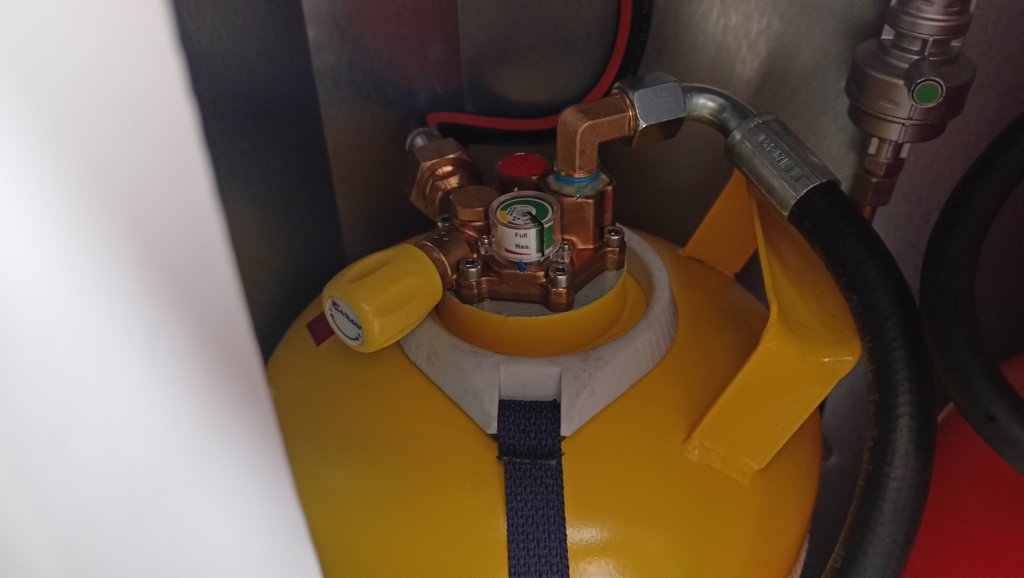

There is T in the system Niel, that is where the POL fitting goes and the second bottle has a mushroom end on the fill pipe at both ends you turn off the bottle, run the gas out on the lit hob, and simply swap the bottles, I've done it on three vans and no issues, I grant you it may not be normal but the parts are out there.If you had a twin bottle system it isn’t only the pig tail you have to disconnect, it will have a fill pipe linked from number one bottle to number two. It isn’t the same as using an exchange cylinder. You would need to make sure you have capped the full pipe properly whenever you went to an exchange bottle. If you are struggling to get in with access then it could easily become a problem. It’s one thing reaching in and adding/removing a Calor pig tail to an exchange bottle, different when you need spanner’s and have to make sure connections are properly made and tightened.
