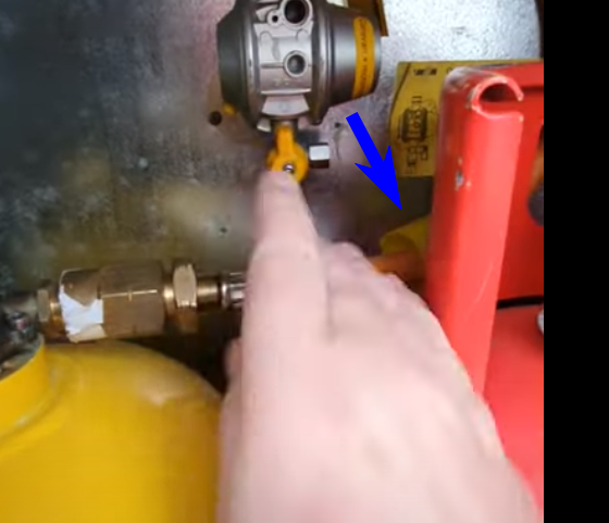

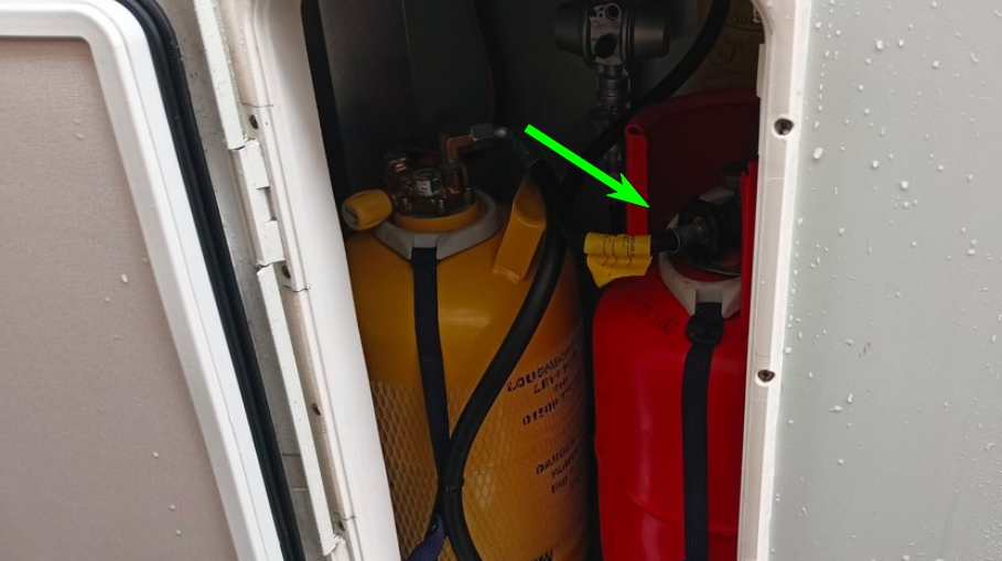

I didn't just do it without first taking advice Niel. it's all pipes and fittings and as long as you are aware of what you are doing then it's safe.You have a tee on number one cylinder fill valve then a pipe into an elbow on number two cylinder. The fitting you show goes onto the different tee that feed to the regulator.
If you disconnect the feed to number two cylinder and leave the fill pipe uncapped you will have high pressure gas escaping when you go to fill up.
There are all sorts of things you can do (someone has set up a system to refill SafeFill bottles with an external filler) but it doesn’t make it safe. Autogas 2000 work to the Gas Safe LPG regs and would not fit or advise anything that doesn’t comply. You can assume everyone is competent at doing things.
