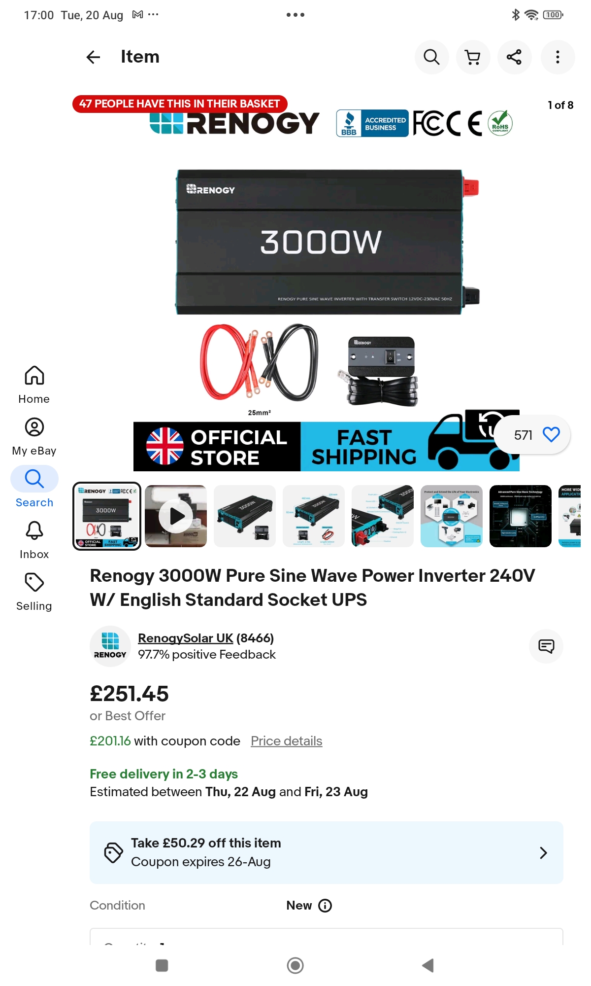

This seems a good price at the moment from Renolgy eBay site, using the code HAPPY20 which knocks 20% off the price.
