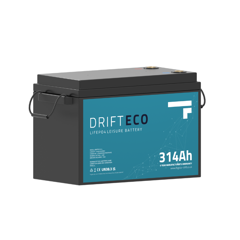

I see they have introduced an Eco Drift series, seems to have no heat pads, which I haven't got now or bluetooth which if you already have the Victron set up is no real hardship. Downside is the 6 year warranty instead of their normal 10 years. They will be available in August, 306ah for £499.00.

Just looked at the sale and sadly it doesn't include the Drift Eco which I have pre ordered, not surprised though as it is a good price already.
Interestingly though they say on the website that they are expecting the first shipment of the 305AH Eco in October 2024 but they have sent me an email telling me it will be shipped in 2 weeks.
Just thinking about this and it may well be that the first batch of the 305's may all be pre ordered so they are now taking pre orders for a second batch.
Did I read earlier somewhere else that the Fogstar drift eco does not have Bluetooth for monitoring or did I imagine it?
I'm pretty sure it doesn't Barry but it's not of great importance to me although it would be a nicety.
