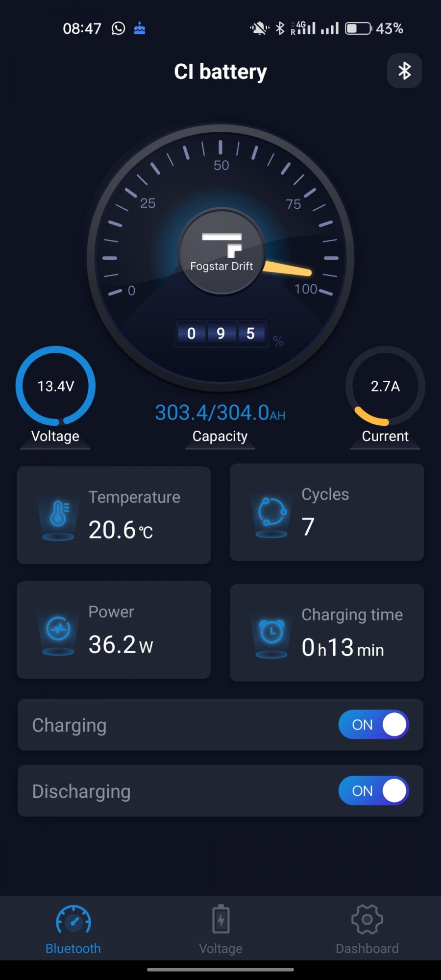

Fogstar Bluetooth display, my battery actually tops out at around 317.5ah. Being a geek I like to monitor solar input, charging input etc so the victron stuff is ideal, beats train-spotting. Using the Orion 30a Bluetooth screen I was able to see that the amps were throttled down to 25a when it was hot. I've contacted the dealership that fitted the Orion complaining about the heat and throttling issues and asked if it's possible to pay the extra difference and exchange it for the 50a Orion. They asked for the serial number and I'm waiting for them to get back to me 🤞
