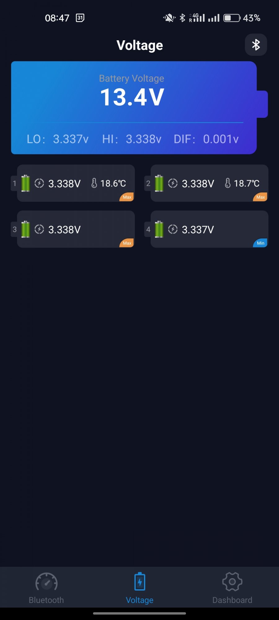

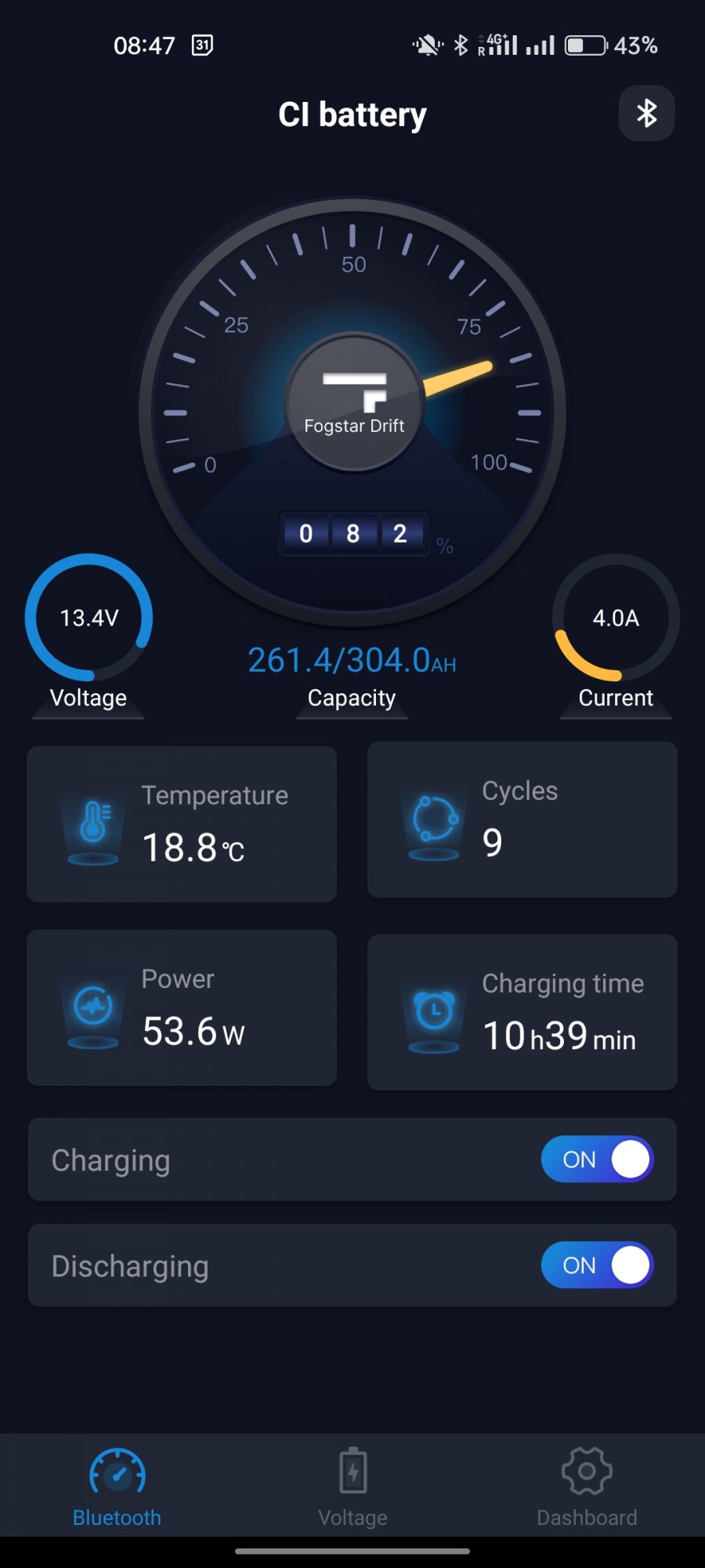

Looking for advice, would there be any advantage adding the victron smart shunt into my intended system or does the Fogstar battery App give me all the information that the smart shunt would.

Thanks for the recommendation, But do you know if the Fogstar App gives you the same information as this, when it is Bluetoothed to your phone?
Sorry the answer is I simply don't know - not fitted yet. But my understanding is that the monitor will give an accurate, at a glance detail of the state of charge of your battery and also detail of time remaining as well as an alarm when the battery is getting low or something is amiss.
I'm sure others will fill in more detail though.
Screenshots from the Fogstar app, I also have the Victron Bluetooth mppt, 30a B2B and ehu charger which give me all the information I need.
If you are an "App guy", then the info from the Fogstar app will give you what you need.
Where something like the Alii Monitor wins is having a physical display (ignoring the comments above) that you can glance at for a basic check instead of having to get the phone out.
Taking my example above, the person who got the BMV-712 went for that as he could use his phone to check the info via the Victron app (al la Fogstar App), but his wife could also just look at the display if she wanted to see the SOC before putting the inverter on, for example.
