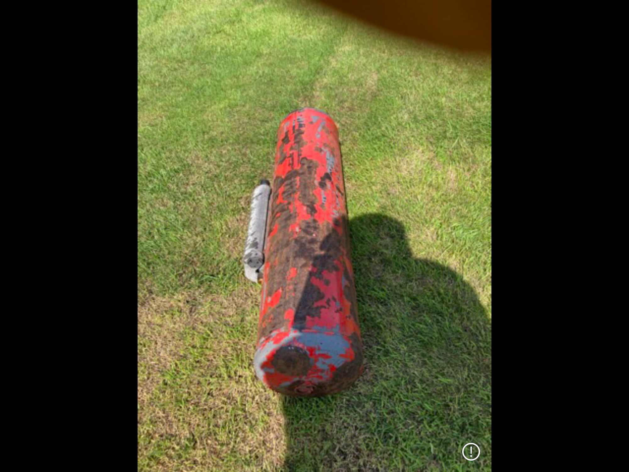

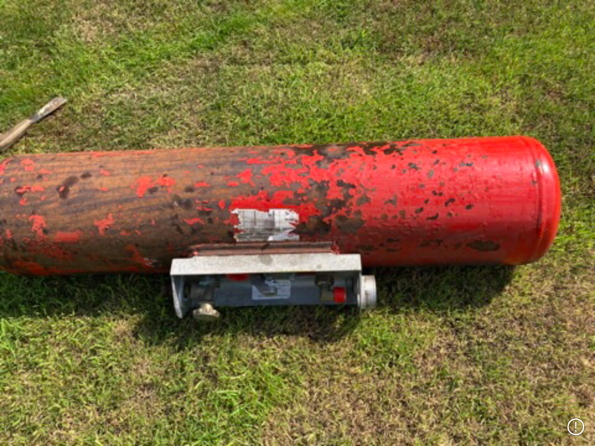

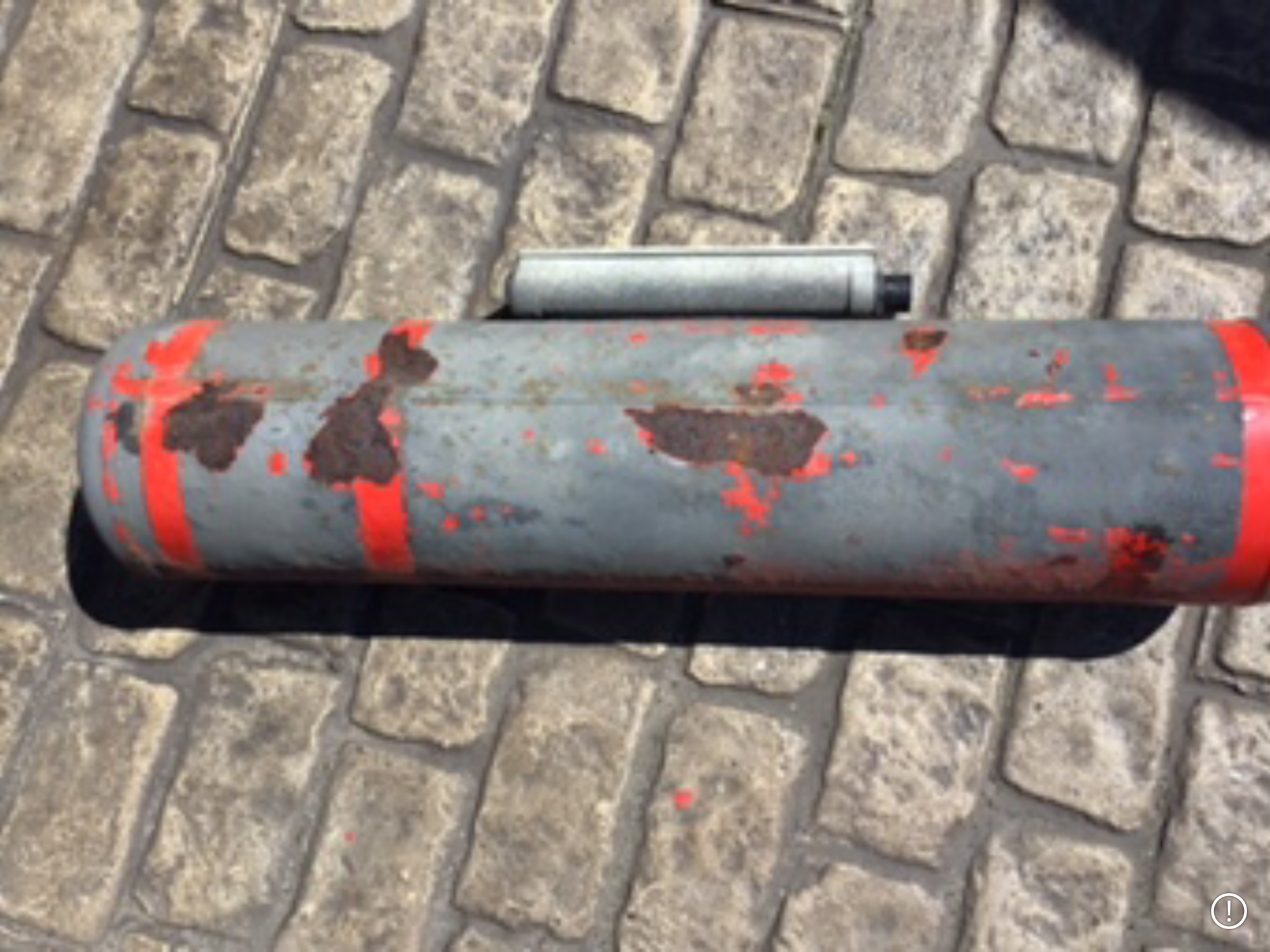

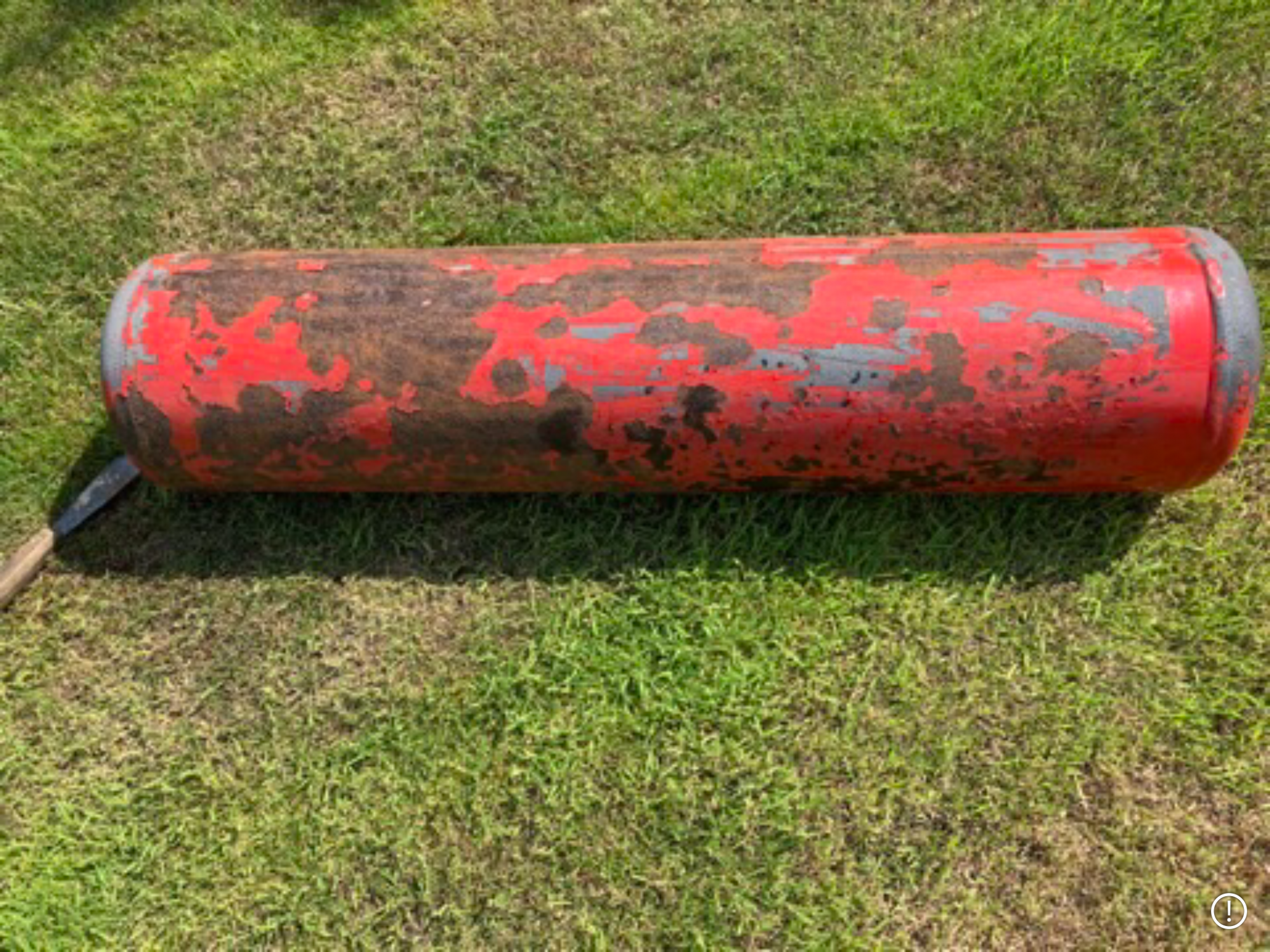

They DO. You don't have to spend long at Charlies seeing some of the tanks removed from vans. Even had an ambulance rush in one day with gas leaking everywhere. Depends how well they have been looked after, both the tank itself and the straps/brackets run throughI keep hearing this 'when it needs replacing' trope. They don't wear out.

Modern steel and manufacturers aren't that busy Trev. Every tank sold has instructions about after care and inspections. End of the day manufacturers would probably say as the valves are rated 10 years that's all the tanks need to do. I have been there when 3 year old rusted through tanks have been removed though. I want to say one was 2 years old but I may be remembering that bit wrongIf the tanks and staps were shotblasted and painted properly from day one then the life would double, no one bothers.
