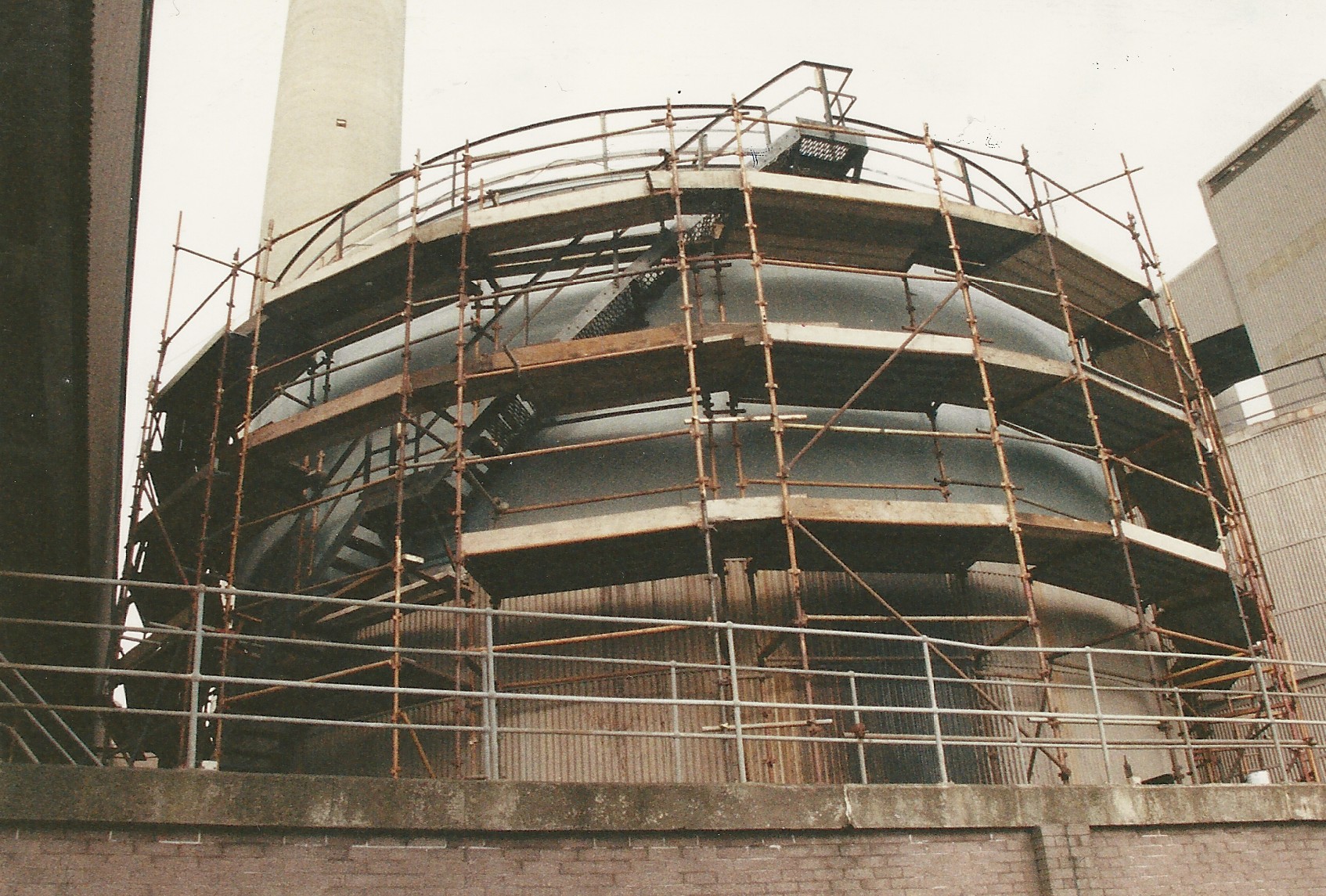

Because it looked very rusty. Turned out it was very very solid metal but that was hard to tell until it was off.
We all make mistakes. Learn from mine.

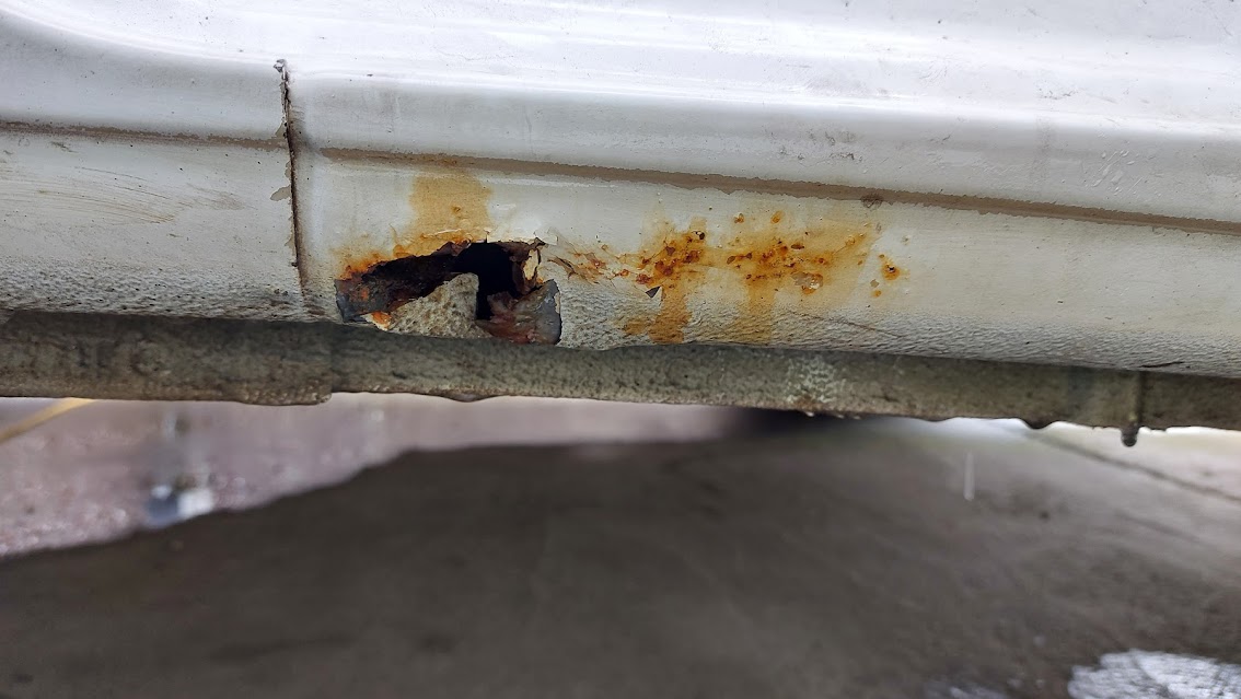

Sevel models from what year, the van I've recently sold, was 2011 and I had to have rust holes in the drivers door sill welded over, the rest looked OK, I kindly filled the sills with Dinitrol after welded up, for the next owner
Sevel models from what year, the van I've recently sold, was 2011 and I had to have rust holes in the drivers door sill welded over, the rest looked OK, I kindly filled the sills with Dinitrol after welded up, for the next owner View attachment 149772
Decent of you to add the Dinitrol.
