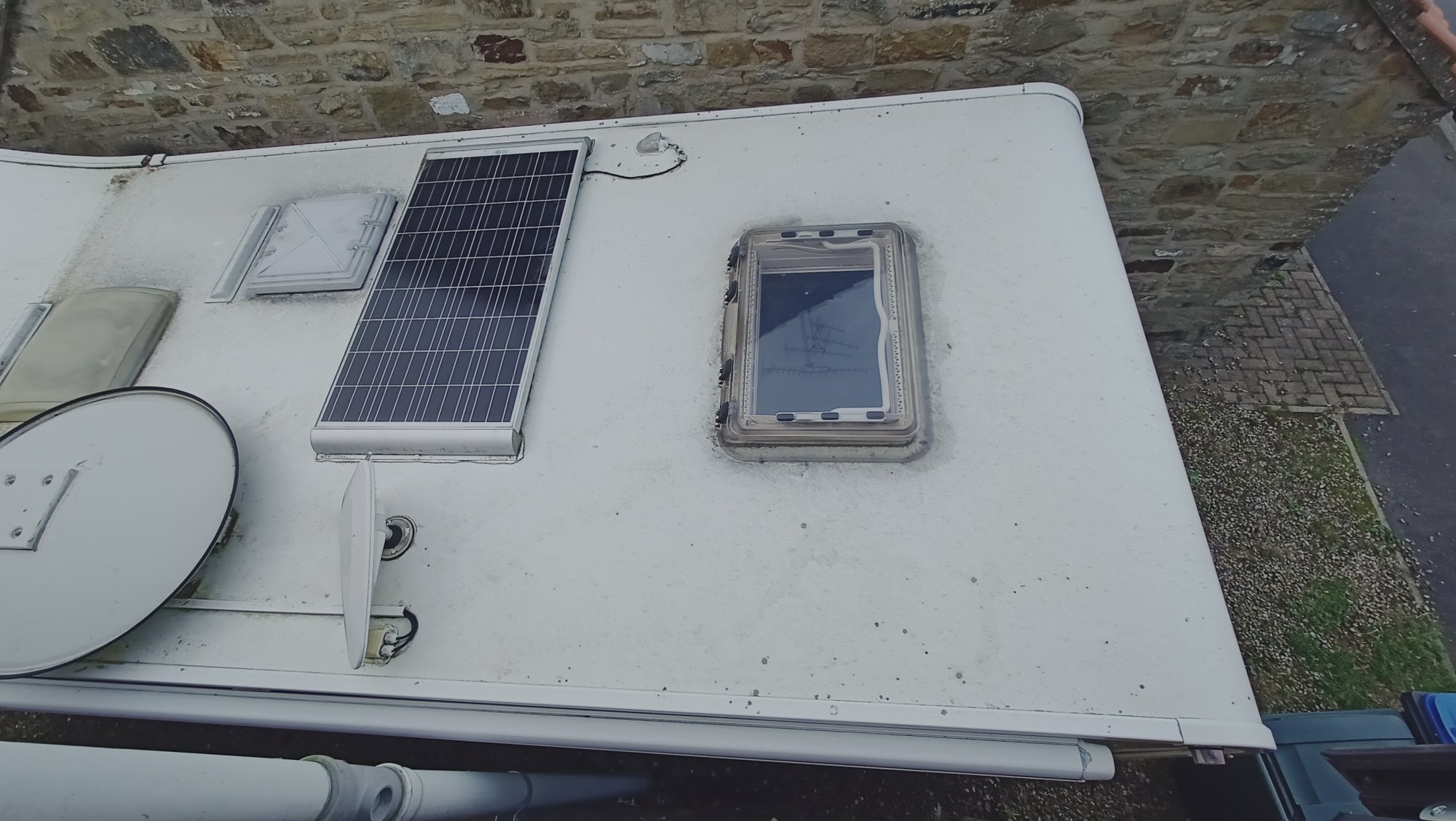

Anyway looking at a closer inspection of my roof today I'm not sure Off grid solutions could fit 2 x 140w Victron panels on the spare space up there. I think there is room for one or two thin but long panels either side of the rear skylight but for a big van space is limited. I still think that panel is much bigger than the old one.
It reminds me of the magic roundabout, but once on this roundabout there is no way off.![]()
Replace the one you have with a 250=300w new one.
What beggars belief is why they never filled that one big space with a larger panel in the first place! Its not like they are expensive. I gather though that removing them is way too tricky to bother with and that roof cable entry gland is now in the way of putting anything bigger in.
My flexible panel was a mare to remove Barry, but that one shouldn't be too much trouble.
You can always move the roof gland, I presume the cables go into an overhead locker? If that is the case you can always move the gland further along, feed the cables through and connect to the old cables inside the locker.
That bracket looks well stuck on though and it would presumably need a bigger bracket for a bigger panel. I might be able to squeeze a 120 down the side behind the Satellite dish and TV aerial. The TV aerial is redundant really. Its just in the way. Or maybe a tiny 80 or something on the other side. Dunno. Will have to measure it properly.
If I am sticking another panel on a single 120 would be enough to match the extra 120 battery.
I tried a makeshift cheese wire to cut through the old sealant but was getting nowhere with it. In the end I used an old (well it's old now!) carving knife laid flat on the roof and that was much easier.

they go through the steel on a panel van quickly as well Ken loli used a reciprocating saw with a blade i’d sharpened on the grinder quite scary how easily it went through the mastic ! under the brackets
