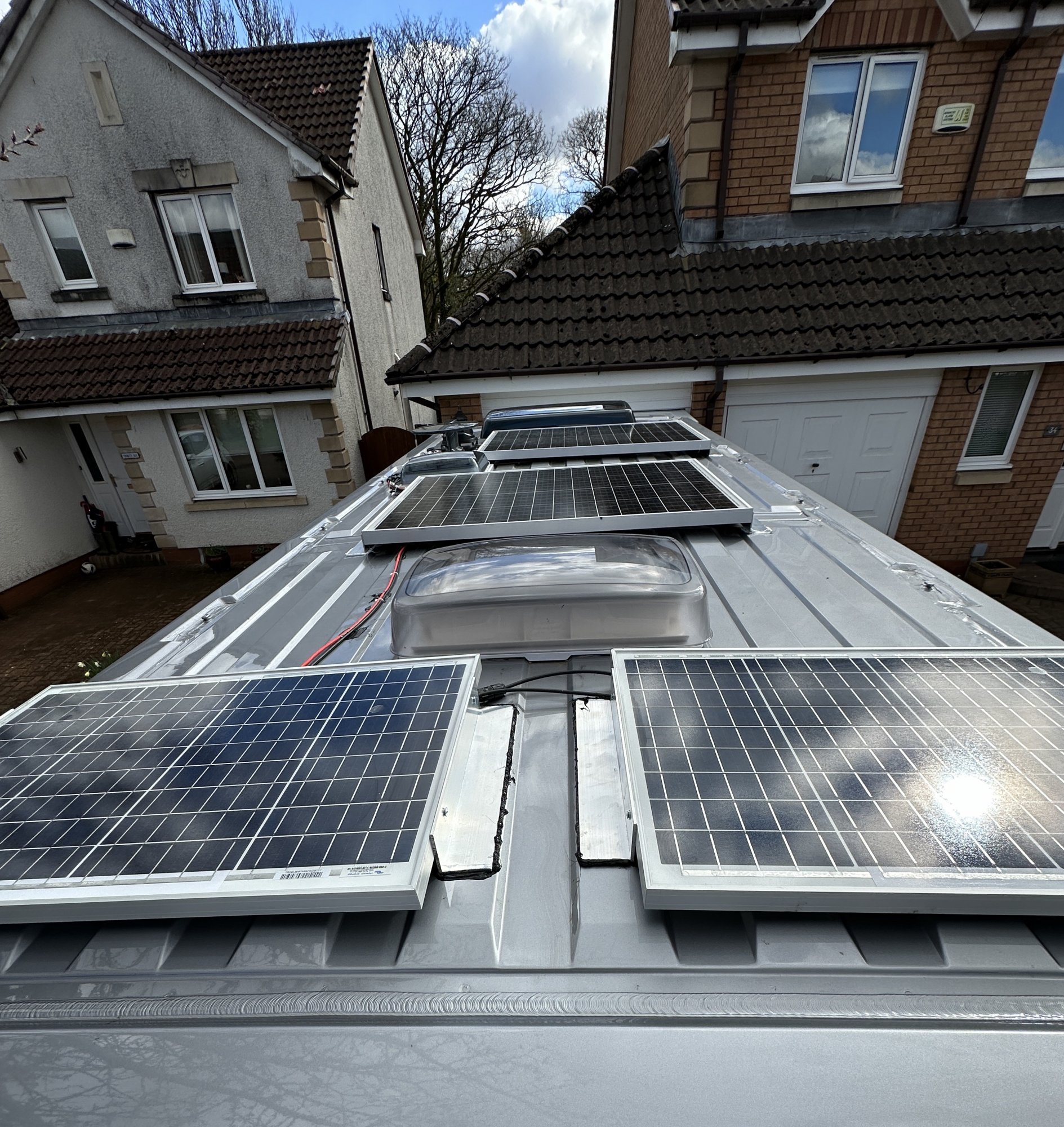

Don’t buy a cheap inefficient PWM controller, get your hands on a MPPT, and don’t buy one just big enough to handle your solar array, get one that will handle something a bit bigger, and preferably Victron. I have 330w of solar, but have managed 400w in summer since fitting a larger solar controller.
As for fitting a second 120w panel, I would fit this and even more if your roof takes it.
Panels are cheap as chips and fitting additional panels is child’s play.

This is my roof Barry, if I could squeeze more on I would.
