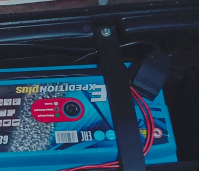

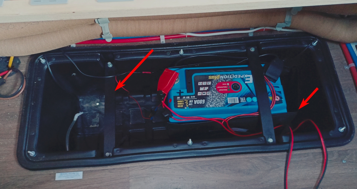

All I used on the old van was the MPPT controllers screen which told me the current voltage on the old van. All I know is that when we swapped from a 120ah lead acid to a 120ah AGM it made a world of difference and Im talking about when the lead acid was in good fettle. I was told up thread that a 120ah AGM would make no difference and would discharge at the same rate as a 120ah lead acid and that does sound logical. After all its 120 amp hours so its usage is measured in time right? No, not right. It most definitely lasted longer. This new 120ah I would say replicates the usage of the original 120 lead acid I had but as you suggest it could be two things. It could be there is more draw on the new van and it could be that the two methods to measure the voltage are not the same. Dunno.
I don't think the controller is the issue. (if there is an issue). Its holding the charge for long enough once its charged hence the idea of trying just a second battery.
