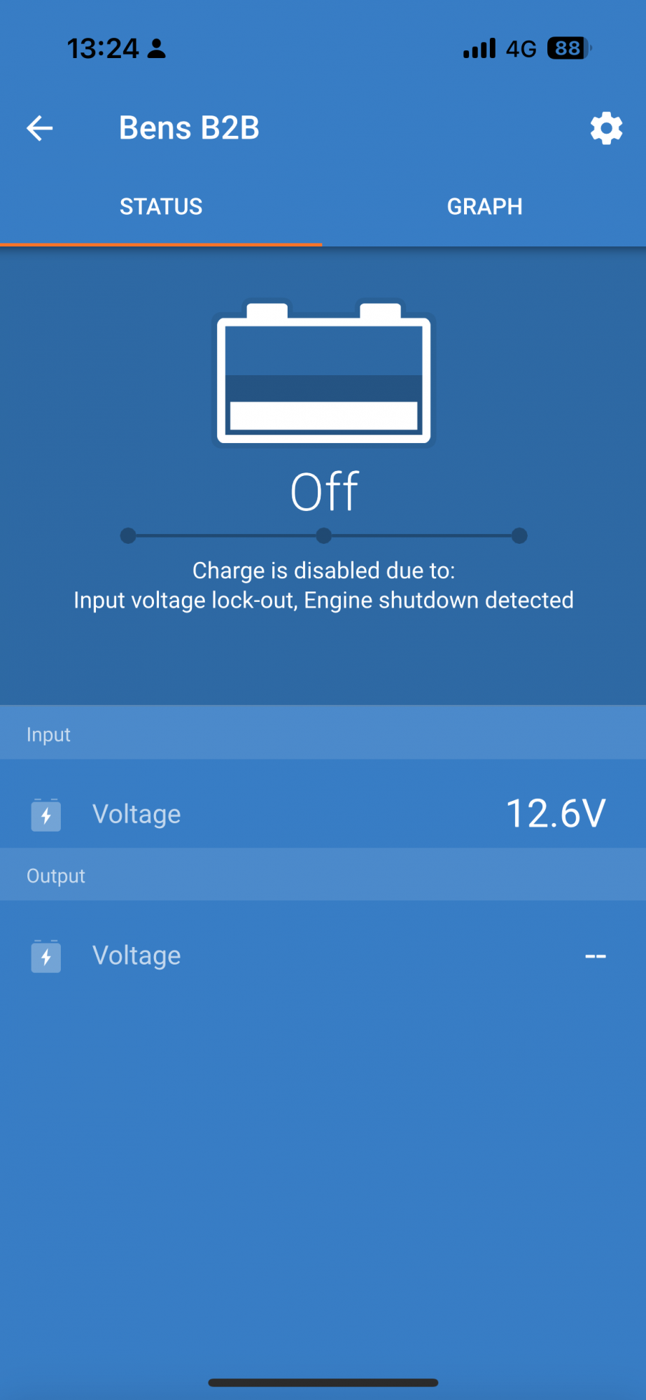

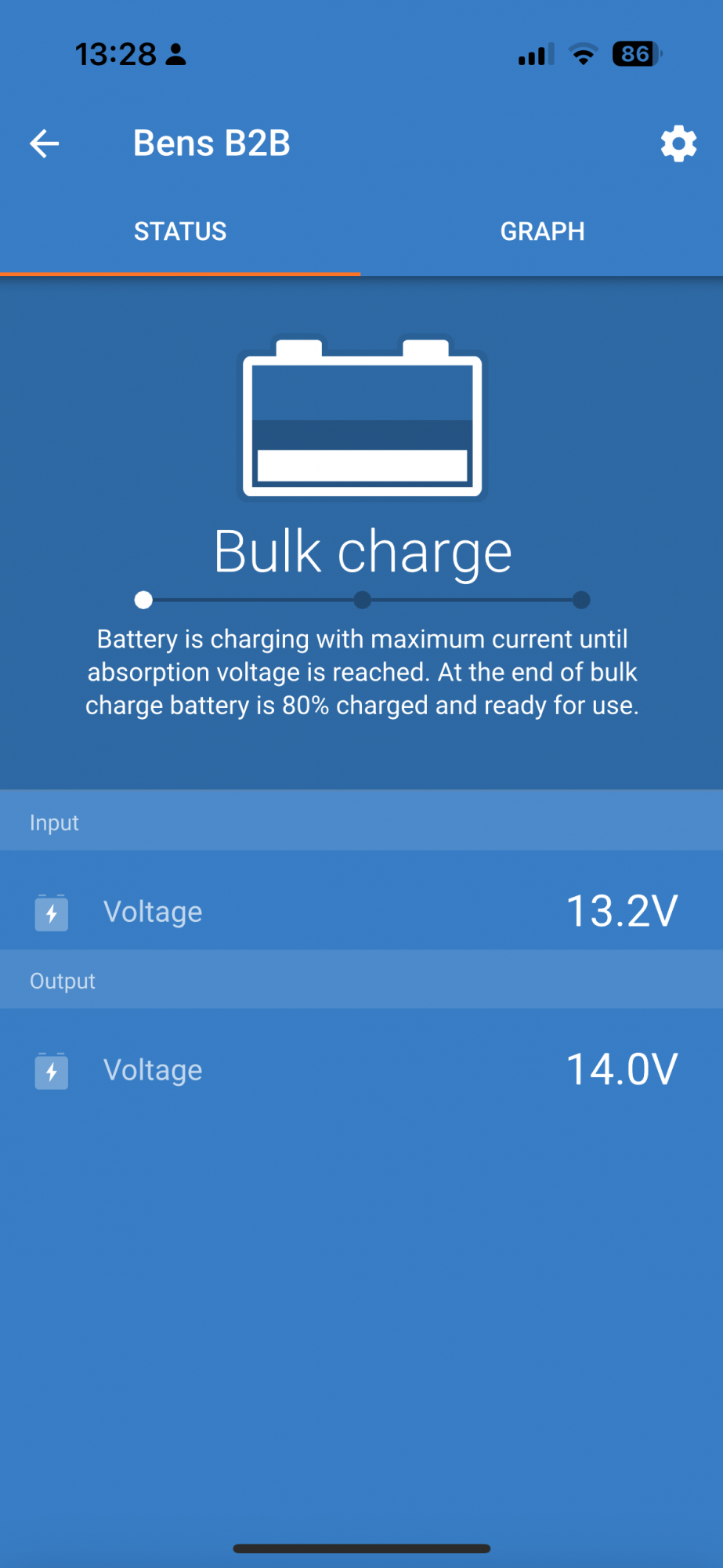

Would be interesting to have a DVM connected to the input to the B2B while driving with a decent load just to see what the cab battery voltage is getting up to . Pity there's no option to disable the 'smart' bit from these alternators too.
