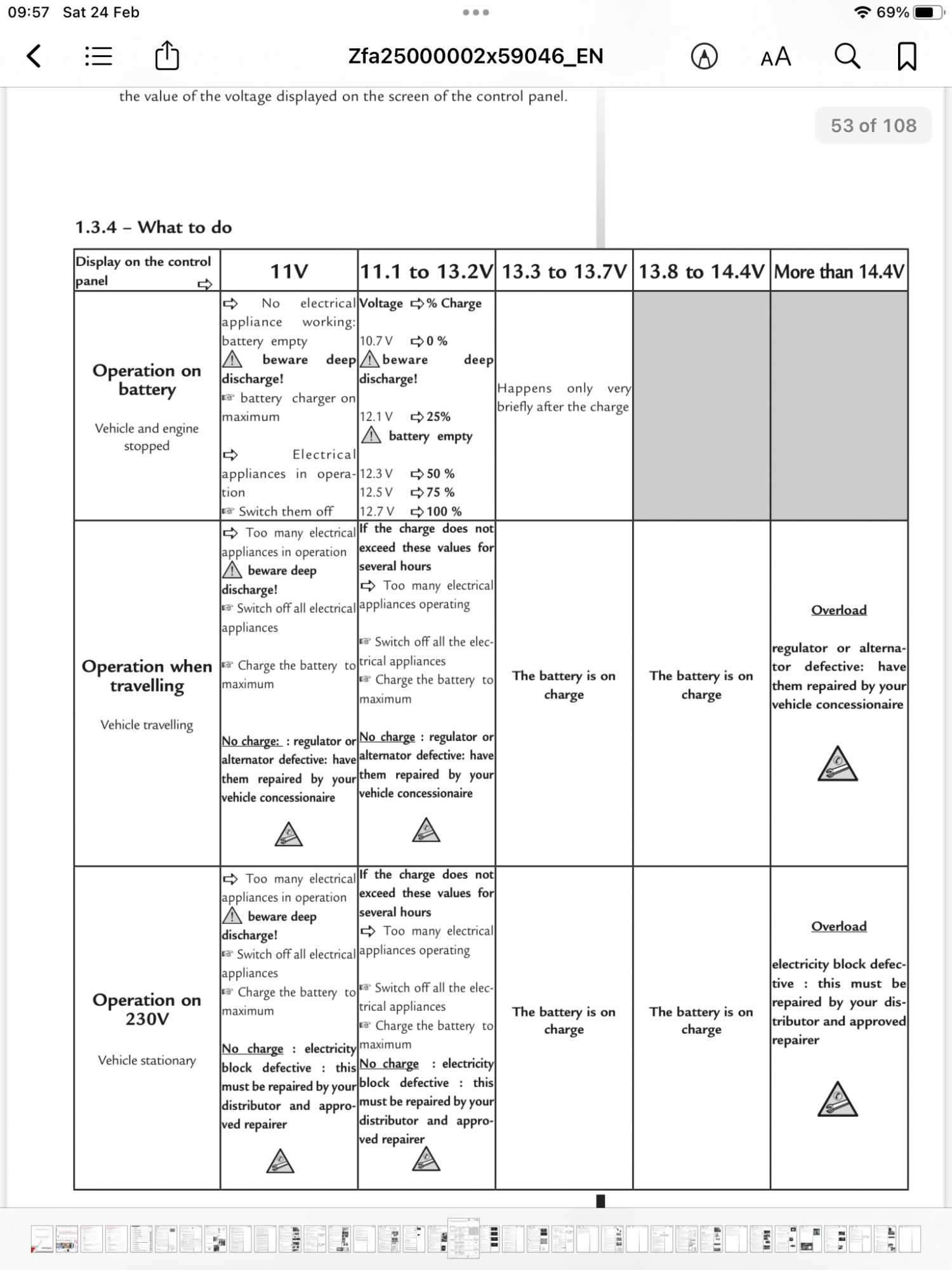

Just found this on the Rapido manual.
The section on when driving looks interesting.
This may well be a stupid question but would running the B2B feed directly from the alternator make it see load and work as you want?
Bear in mind those voltages discussed in the first two columns would be appropriate to Lead Acid battery types. Lithium would be in the +13V for 90% of the charge state.
So the guidence (and it is only guidence) is kind of out of date in that situation.
