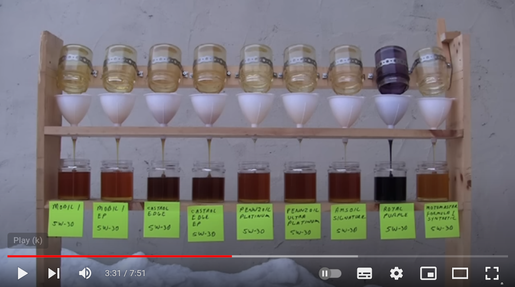

Are you sure? Its many years since I studied it, but I was taught that even multigrades get thicker when cold. They just don't get as thick as single grades do.
So at a certain cold temperature the 75/90 would be as thick as a 75w would be at that temperature
And at a certain hot temperature the 75/90 would be as thick as a 90w would be at that temperature
But it would still be thicker when cold
It may apear to be thicker but all on utube to see what happens, low number will flow in cold weather and first starts in the morning where 90% of wear happens to engines, a 10/40 semi is a good all rounder, but do use what the makers say for out climate.
OIl flow -20c
