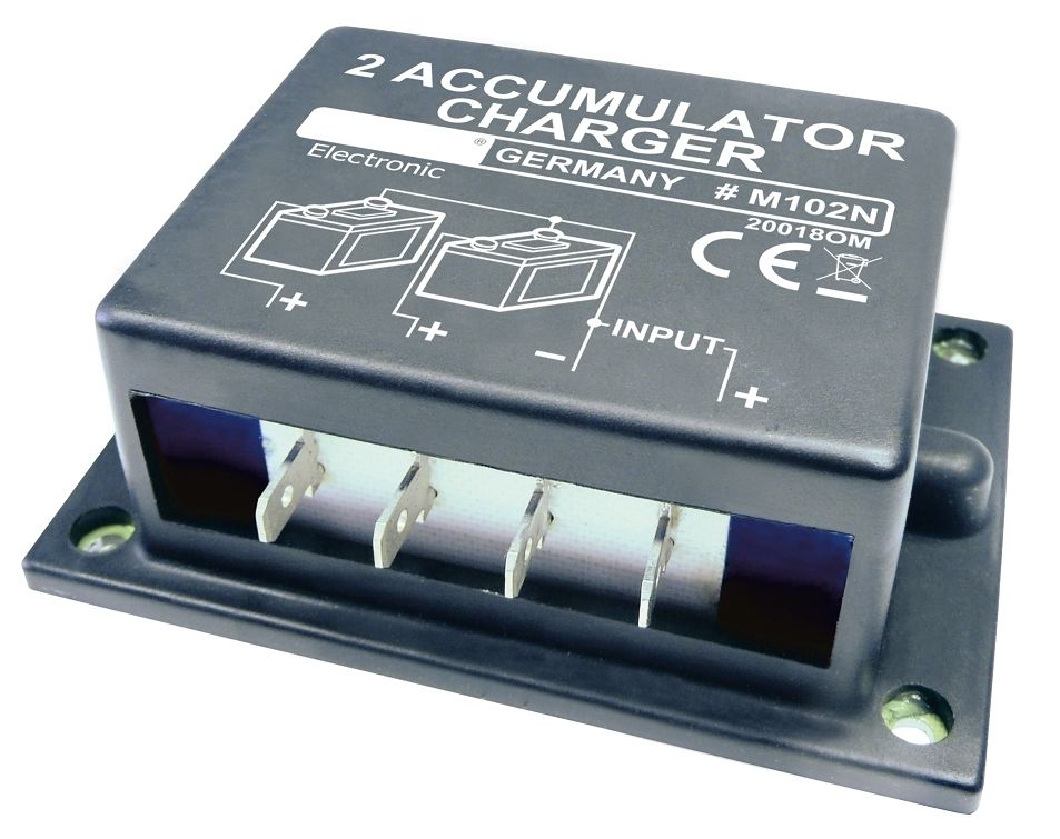

Or one of these could be handy.
Or one of these could be handy.View attachment 80517
Morning Trevskoda. I’ve looked at your post and purchase of one. Now then,I like what you’ve sent but I’m rather perplexed by it although, I see how handy this can be. Would you have a photo of your connection and place of situ in engine compartment. I seem to take in this method rather than the reading aspect which comes later. Bearing in mind to get to the back of my battery (picture in my post) is a minefield with all the wire coverage over the top of it. Once I know if the battery is not working to it’s full capacity and needs replacing. I am going to have these wires re routed by the professionals, away somehow off the battery to make it easier for access Thank you.

Simple,this little unit is a float charge to 13.7 v ,if you want it to charge starter battery from les ones then connect pos in to a les battery and ground to body,then any of the two pos outlets to the starter battery.
This will then keep the starter battery on a float without switches and relays.
Some wire and connections will be required,crimp tools and connectors are on ebay ,good luck.
Well Trev. I’m going to have someone do this for me. It’s all the wires I’ve mentioned that HAVE to sorted before more are added. I do like it though and thank you

This device is just a pair of diodes in a box. Pretty good diodes that can carry 10 amps (or more with a heatsink added), but diodes none the less. I forget how much voltage they drop. I may remember to measure it later.
It's clever in that it won't let electricity flow from one battery to the other, but if you put a voltage on the input, the battery with the lowest voltage will get the charge.
Unfortunately, that may not be what you want. If one battery is fully charged, its voltage will be perhaps 13v. The other battery is only half charged and the charger would be bringing it up to 14.5v in the bulk charge phase.
This device will push power into the wrong battery in this situation.
But a bigger problem is that if you connect an mppt solar controller to its input, the controller won't work: they require a power feed from the battery to start up, and this device stops them getting any power at all.
This device has its uses, but if you are keeping the batteries maintained in a long period of layup, a wire with a fuse or a 21w bulb in line is a better approach.
