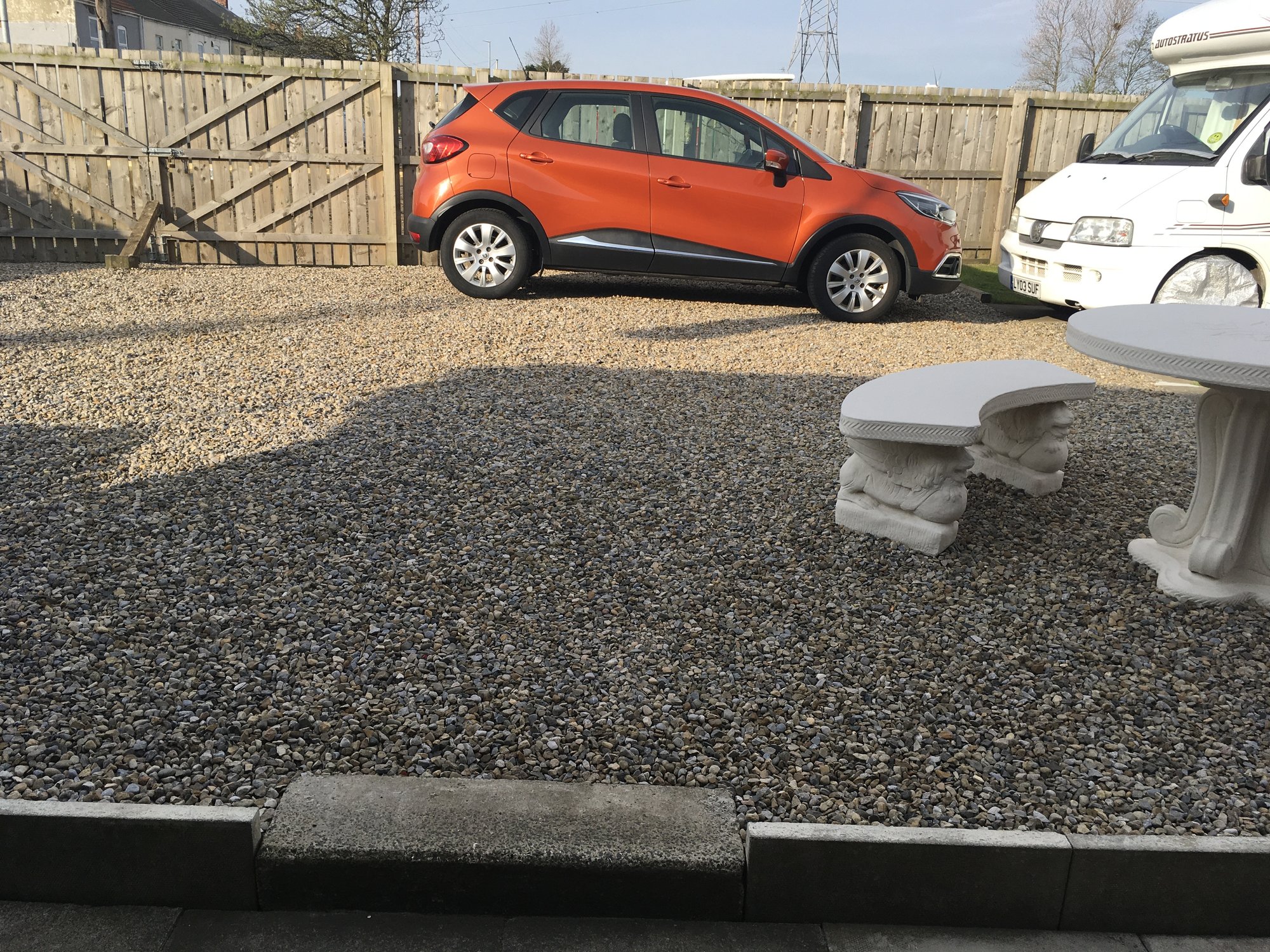

Thank you Robmac. I think it’s going to be a hefty bill insight. I’m hoping another expert will come on board. Problem being I have is if I can’t get it going (in the future to garage) there is no way a recovery truck can get in my property to even tow me out. It is through a gated side way entrance.
It takes a 3 point turn to drive it out onto the gravel area first
