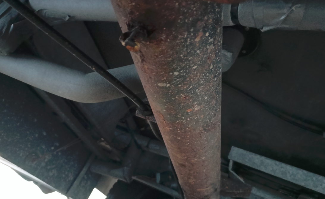

I was told that you have to jack it up so wheels are off the ground & pump until it pushes out at the joint
AL-KO Axle Repair and reconditioning
Fully remanufactured and reconditioned AL-KO rear axle as fitted to Hymer, Ducatto, Swift, etcwww.fraserbrowneng.co.uk
I suggest you consider carefully the above web page.
As manufactured the single nipple fails to direct grease to where it needs to go. In addition the bushes are badly designed.
I had my axle overhauled which in addition to a much better design of bush adds a further nipple to ensure that grease does go where it should to ensure axle longevity. The advice from Fraser Brown is to grease the axle much more frequently than AlKo recommend - ideally at 1,000 mile intervals which I have been doing since the overhaul.
In my case, as referenced by @TJBi above, a mistake during the reassembly process was made. This was determined several years later and having established this fault, Fraser Brown are going to strip the axle down again and rectify any resultant excessive wear. This is happening later this month free of charge. (I am combining a visit to their workshop with a Scottish tour.)
