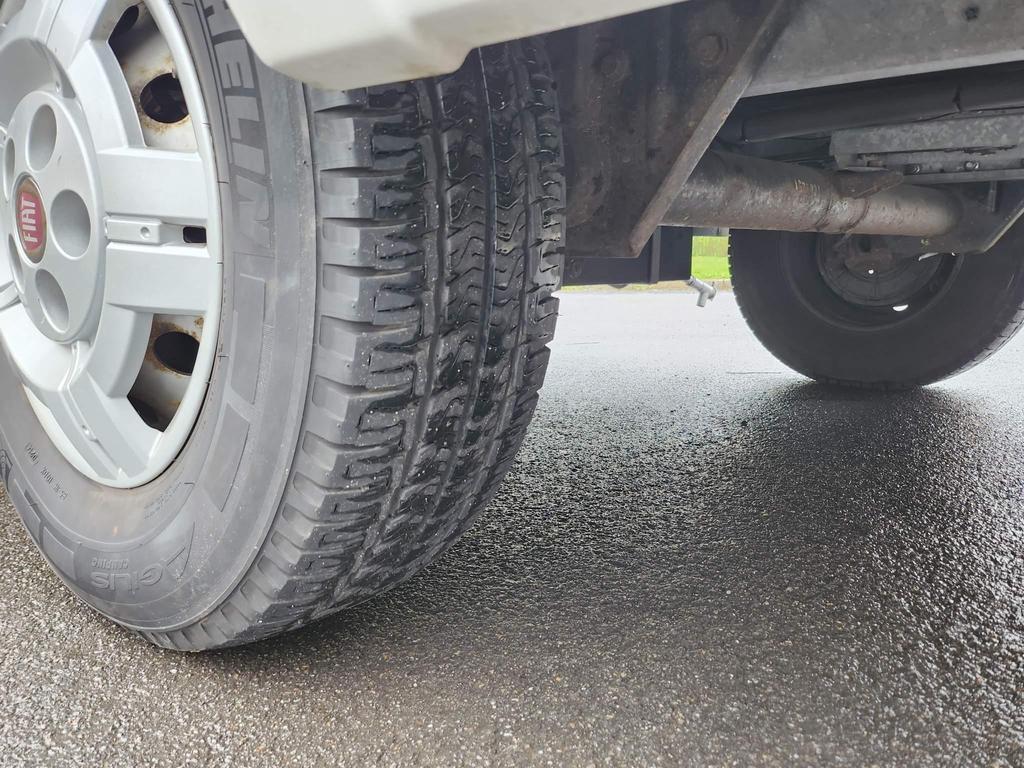

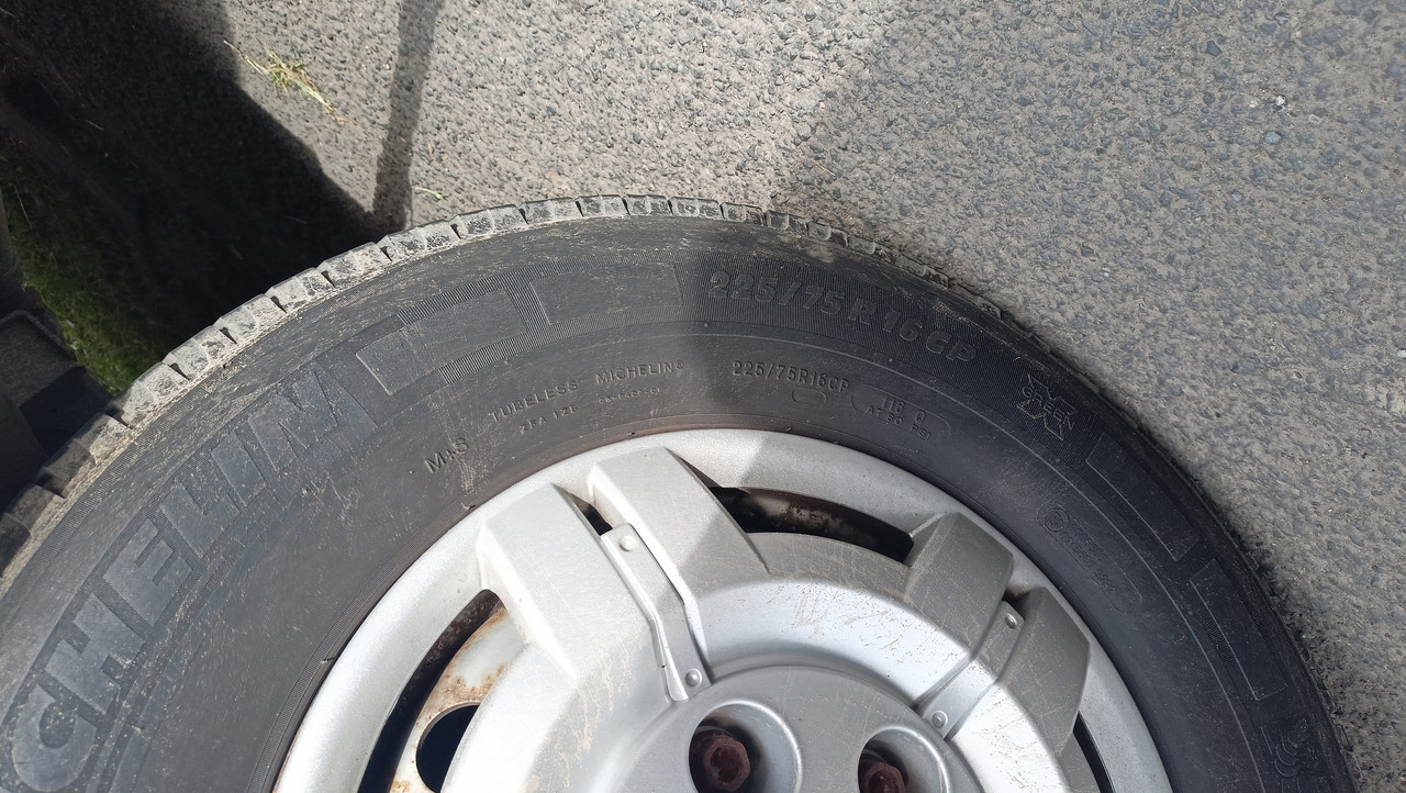

I upped mine to 121 's as with the scooter in the garage it was getting close to the load rating, and I've had 2 tyres split too on the back axle, not overloaded but on the limit. Michelin and Conti.
16" wheels on the Maxi Chassis has the bigger brakes too. Went to Van tyre for the 121's, Plenty of overkill now.
Load Index Load (kg) 118 1320 119 1360 120 1400 121 1450
Thanks. I reckon we should be ok as if I have done my maths right we will be well within the 2400kg limit on the back with the two tyres combined loading rate of 1250kg each. The available payload on the rear axle was 700kg and even after doing the maths with the rack and bike and adding an extra 400kg (200 on the front and 200 on the back) for all our stuff it was still nowhere near the limit. I think (hope) it will be fine.
