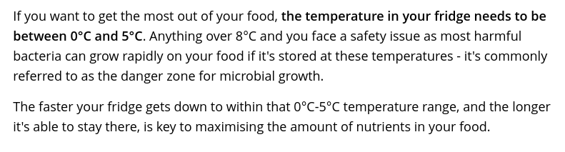

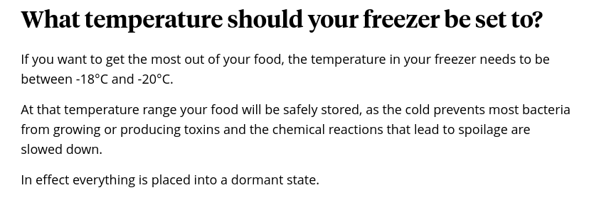

Noted thanks.A fridge must be at 2c for food stuffs, and a freezer at -20c

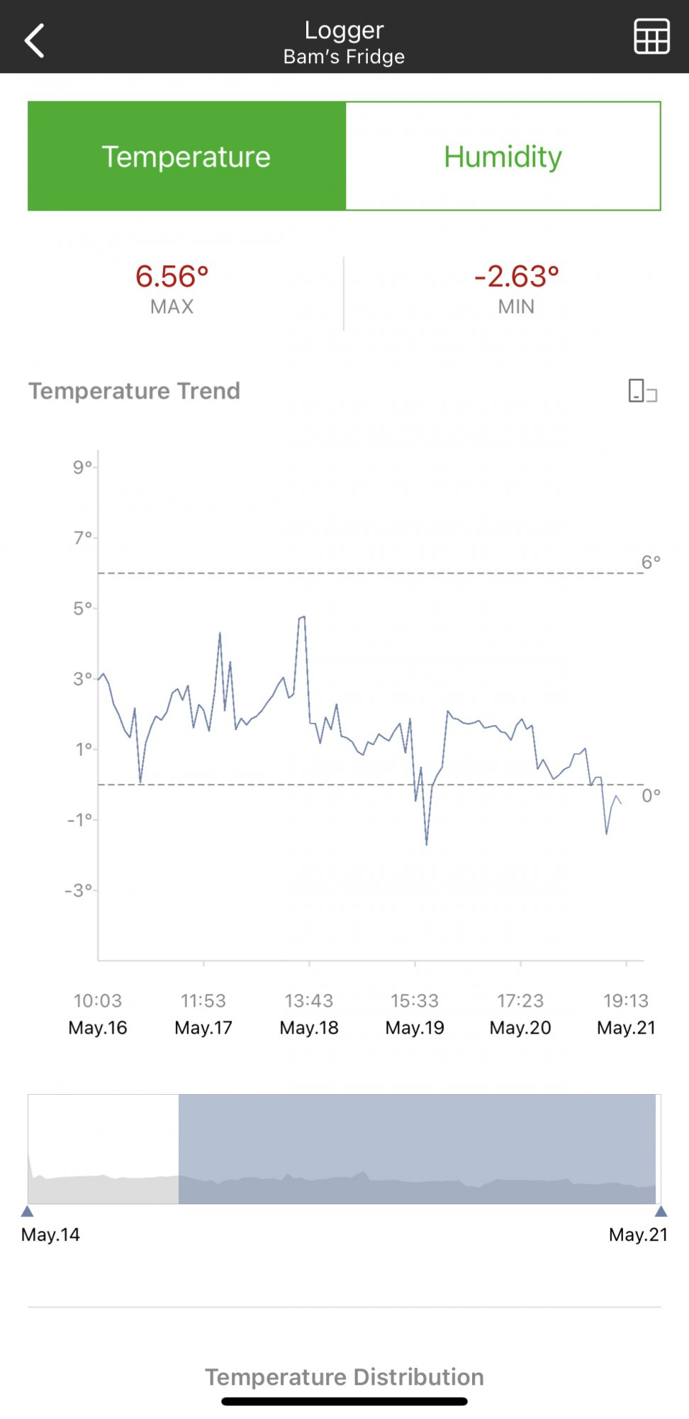

Apart from the door opening spikes and the attempt to run it on setting 3 rather than 4 around midday on the 18 the fridge has been behaving well. It just goes too low sometimes![]()

We seem to be at about 700 wh per day at 4 of the 5 settings as 3 lets it get to over 6 deg C before kicking in.

Incorrect, data from food safe council.-20 is so we can get the food home from shops ,, the feezers can be set lower , say -5 or evan -1 as it need to just do ice cubes and ice cream or ice packs and save power. I'm Not going to have a leg of lamb in there.
Think this was the data Charlie used with that Hymer as he couldn’t keep ice cream. Even though the guys at Lowdhams said it wasn’t fit for purpose Dometic said it was fine, turned out the spec they used was for cool boxes. Scandalous what manufacturers can get away withIncorrect, data from food safe council.View attachment 108840View attachment 108841
