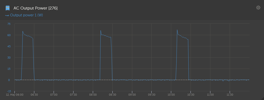

USING the fridge makes a remarkable difference as well. when I say "using", I mean opening door to take food out, put food back, etc. The official figures and most consumption data (including mine) will be based on the door kept closed. I have noticed that when I look at my power logging for the fridge, I can actually tell very easily when I load it up or do any kind of re-arranging - the 'cool' goes very quickly through an open door and much faster than you might imagine. I wonder if that was a factor in your 30Ah vs 60Ah power use days?

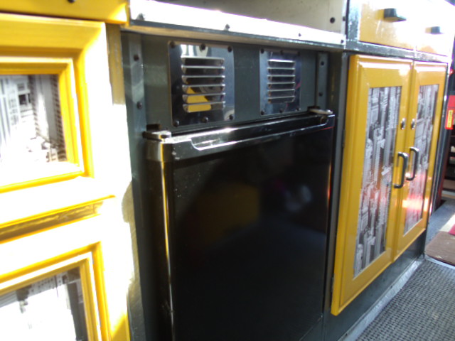

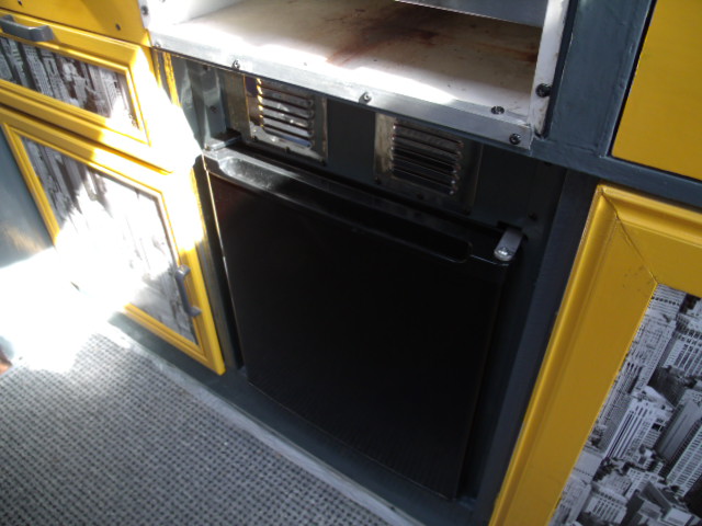

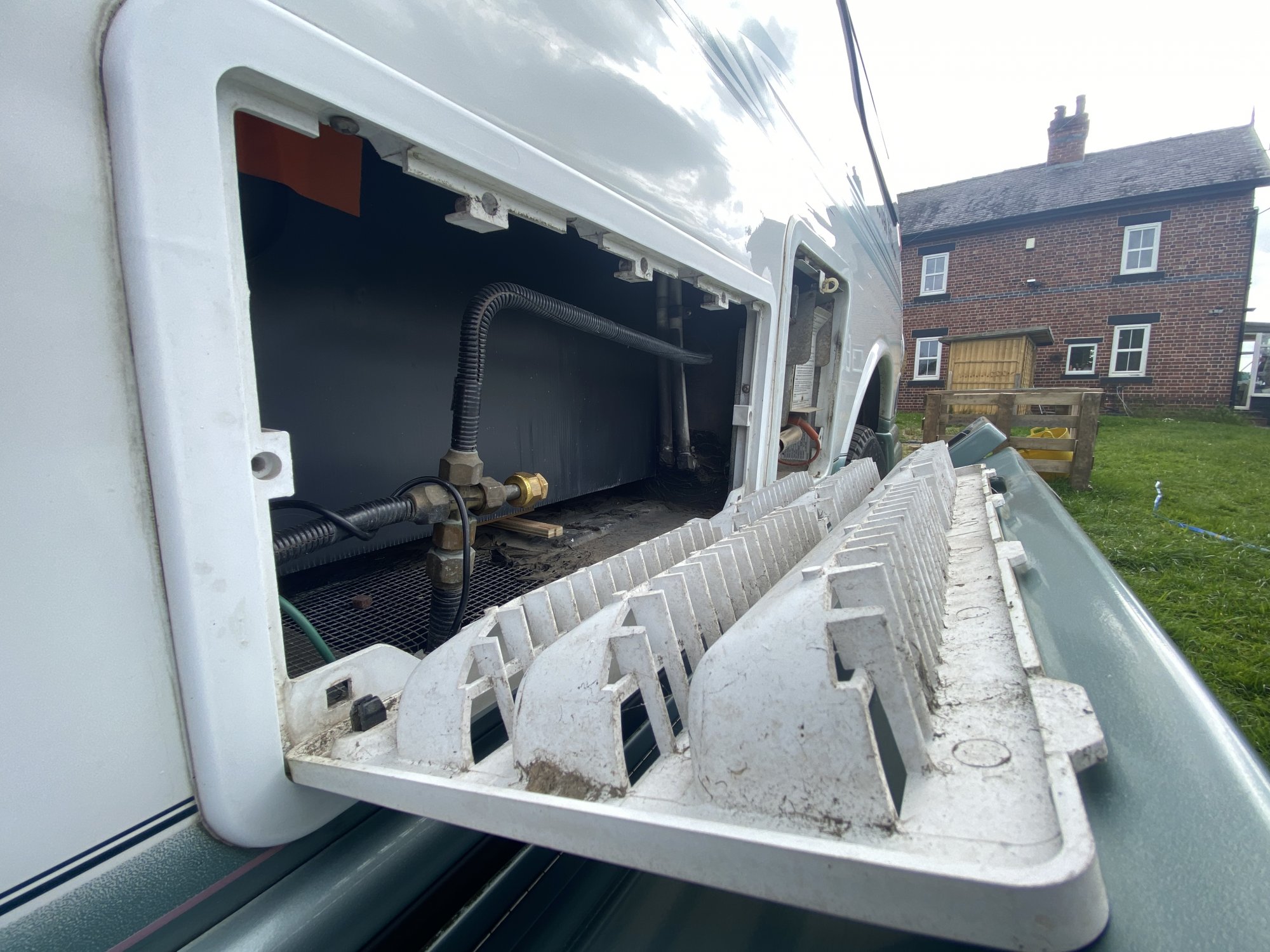

As you have fitted the Compressor Fridge where the old 3-Way fridge is, you could take advantage of the venting and fit a cooling kit if you think the fridge migght be getting hot and so less efficient?

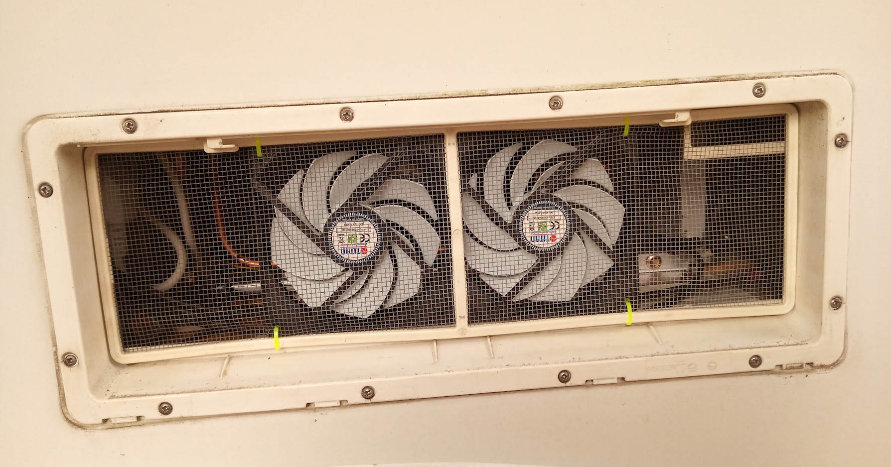

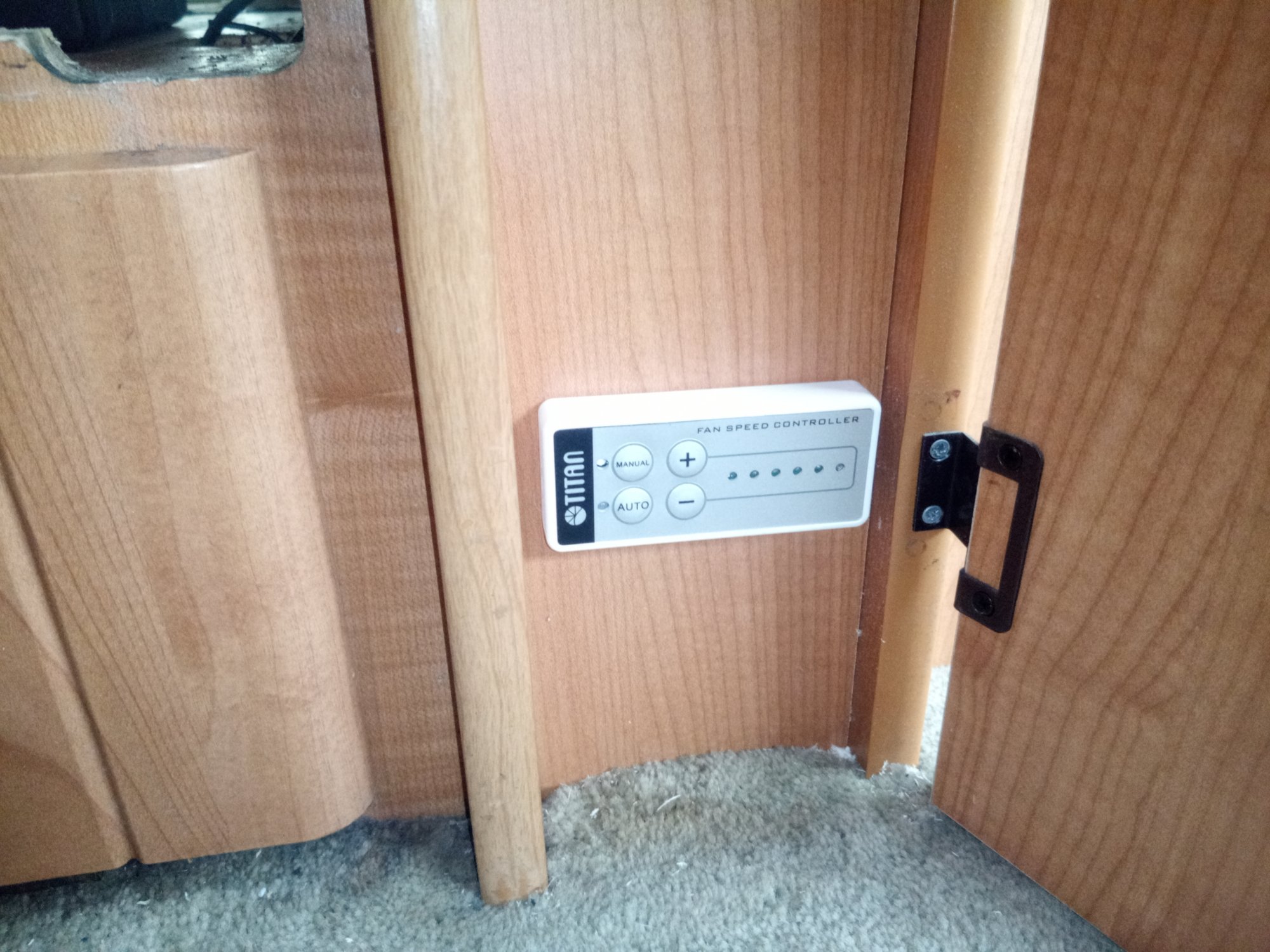

I fitted a "proper" cooling kit to mine. When I say "proper" I simply mean a commercially packaged all-in-one kit with temperature-controlled speed control and a nice little control panel. You can obviously rig up your own more cheaply, but I decided to treat myself
I found the fans fitted perfectly on the Thetford mesh vent screen ...
