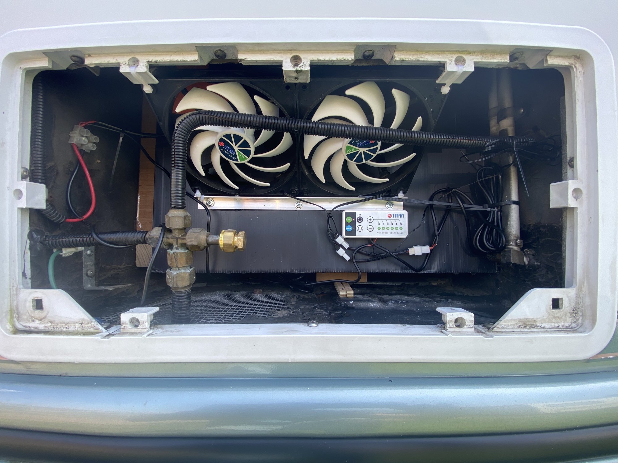

I think the potential issue is that the fans might just circulate cold air in and out of the grill without it being pushed up the back of the fridge to the top where the work is done. And the already hot air that is just circulating up by the fridge fan too. I’m pretty sure that’s what happened with my attempt to improve things with the 3way.
A compressor fridge is quite a bit different to an Absorption. The heat is generated by the compressor unit which is at the bottom of the unit. there is no heat generation anywhere else. With my last camper, the (compressor) fridge was not vented externally at all and I fitted a computer fan that pointed directly at the compressor. When it kicked in, the temp drop was notable.
If you were trying to improve cooling/airflow to a larger degree (maybe in a very hot environment?) you could fit fans to both the top and bottom vents, with one set to push and the other to extract.
Do you have the fans in the top sucking hot out or in the bottom blowing cold in.
bottom, blowing outside air in directly at the rear workings of the fridge.
It never gets really hot anyway. The fans were a precaution that I use since fitting a CRX into my T5 conversion which had no airflow at the rear and while it never failed to work, it did hit 50C at the back, and felt that was a bit too warm.
First fan setup in van after T5 was temp on/off controlled computer fan. motorhome setup is the posh Titan kit.

I had assumed that the fans were at the top drawing air out. That's why I suggested blanking the areas to the side of the fans.
In that scenario, which is my installation, not blanking it will bleed air from the sides into the fans. That is the line of least resistance to the air flow. I remember picking up this tip from instructions for fitting a bathroom extractor fan. It advised explicitly not to site the fan near the door but as far away as possible to ensure that air was drawn through the room rather than drawing air through the doorway and straight out through the fan.
I think the description was 'short circuiting' the air flow.
I suspect that pushing air from the bottom it will be less of an issue though I'd still be inclined to do it.
Yup, I can see if you are pushing air out, you would want to do that.
I suppose sucking the air in it could go straight out on the sides but the distance between fans and 'target' it is unlikely.

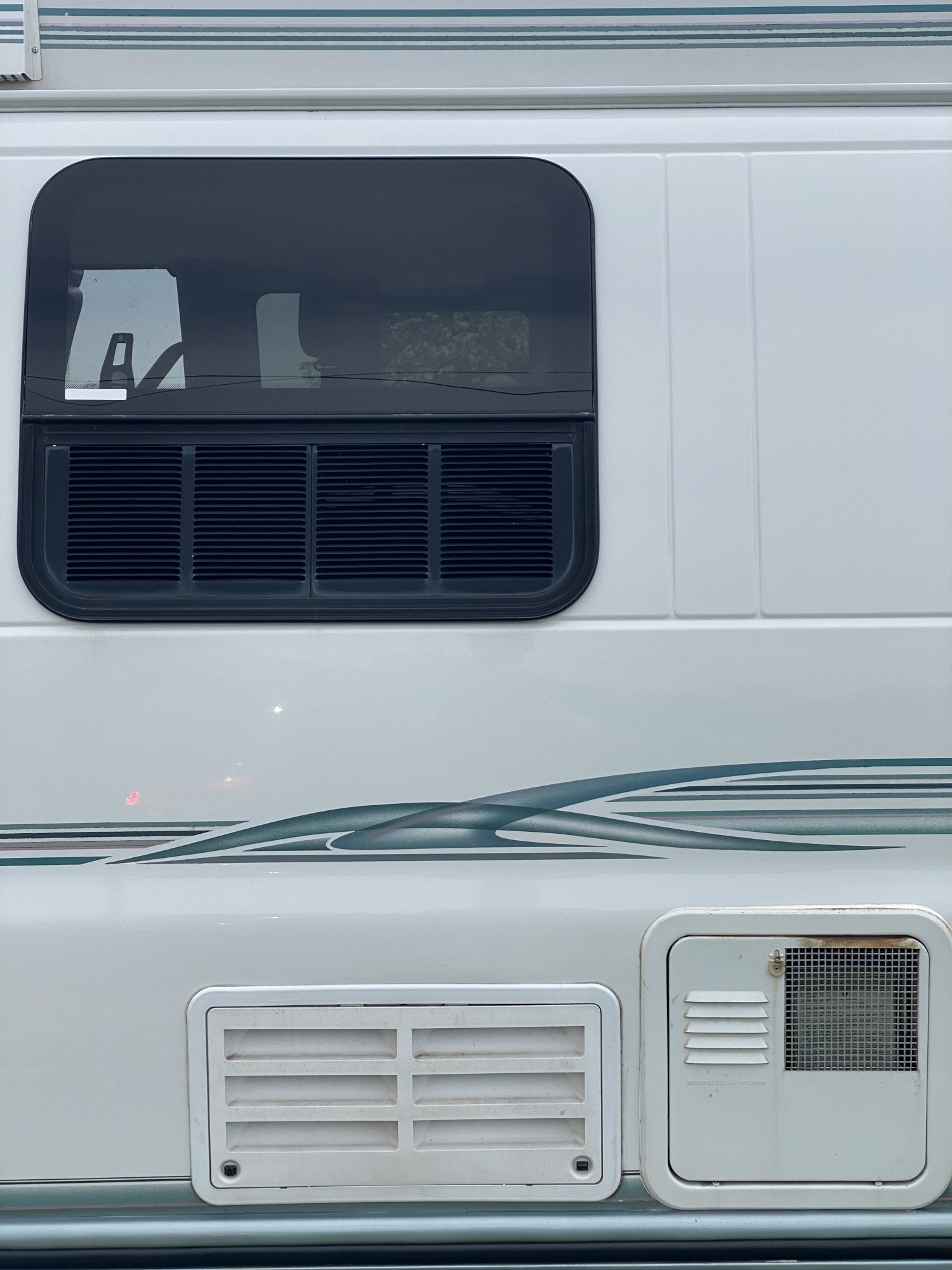

Right now, the vents are actually blocked off currently top and bottom to stop the fridge getting too cold from the natural venting. About time to remove those now.

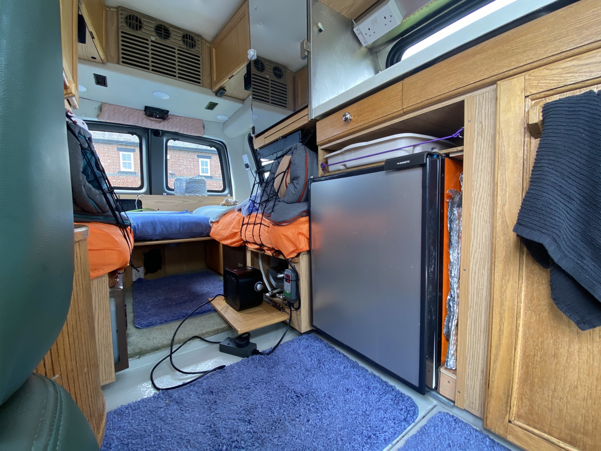

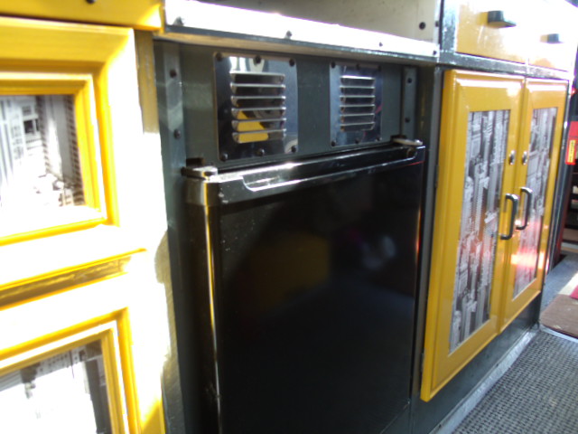

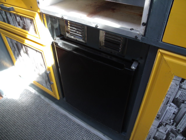

How come there is no cooling piping on the back of my we fridge, its all closed in and you can hardly hear it run, I did put vents above just to keep air around it and to stop any damp or smellsView attachment 108636View attachment 108637

My top vent is mat black so heats up in direct sunlight… I have wondered if that interferes with the draw the vents achieve. Hence trying the vent fan.
The fans are in … I can’t find anywhere convenient to mount the control panel so it’s stuck to the back of the fridge ;)
It’s been warm and windy here today and fridge is on the shaded side and I haven’t seen/heard them kick in so that’s good.

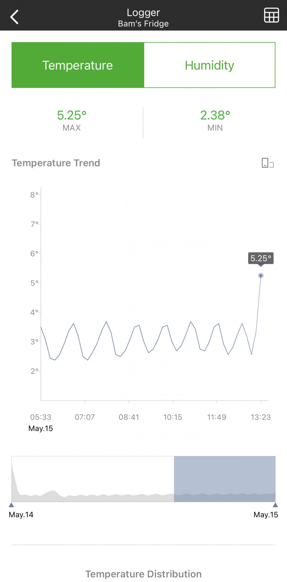

Bought a cheap Bluetooth thermometer to monitor temperature and it seems additional insulation would indeed be a good thing as temperature rises as fast as fridge cools. Even without the door opening where temp jumps up.

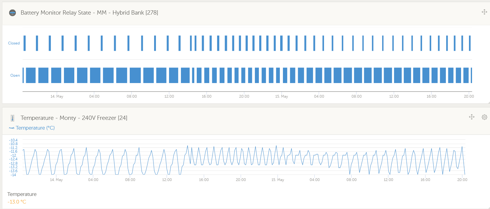

I found fridge internal temps vary much more than you would expect between the compressor turning on and off. And this was true of both normal 240V domestic fridges and a 12V Weaco motorhome fridge.
I no longer use the fridges own thermostat to control when it goes on, but just set it to max and use an temp sensor that goes to the Cerbo and then goes to a relay that activates when the freezer goes above -11.5C and off again (cutting power) when it goes below -12.5C. A very tight range, but even then the range varies more than that as the effect of the compressor running is delayed, but still is a significant improvement on leaving the fridge to its own devices. Also allows you to set the temp appropriate to the use e.g. I have it set so it operates as a 2* Freezer rather than a 4*, which is fine for my needs as well as using a little less power overall.
Relay State is Fridge power control - Fridge has power when closed, no power when open;
Temperature is the Freezer (can monitor better on Freezer section than Fridge I found).

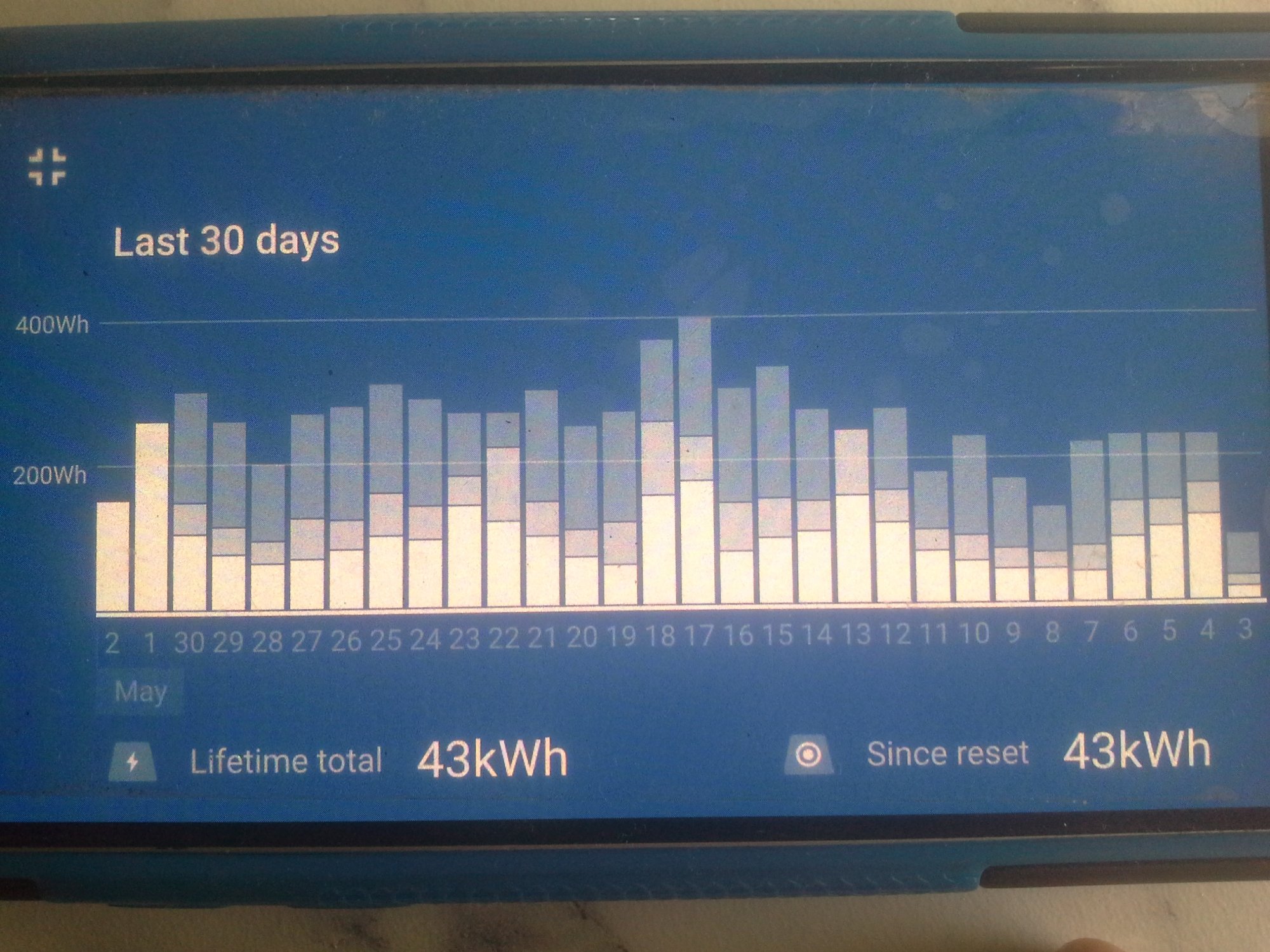

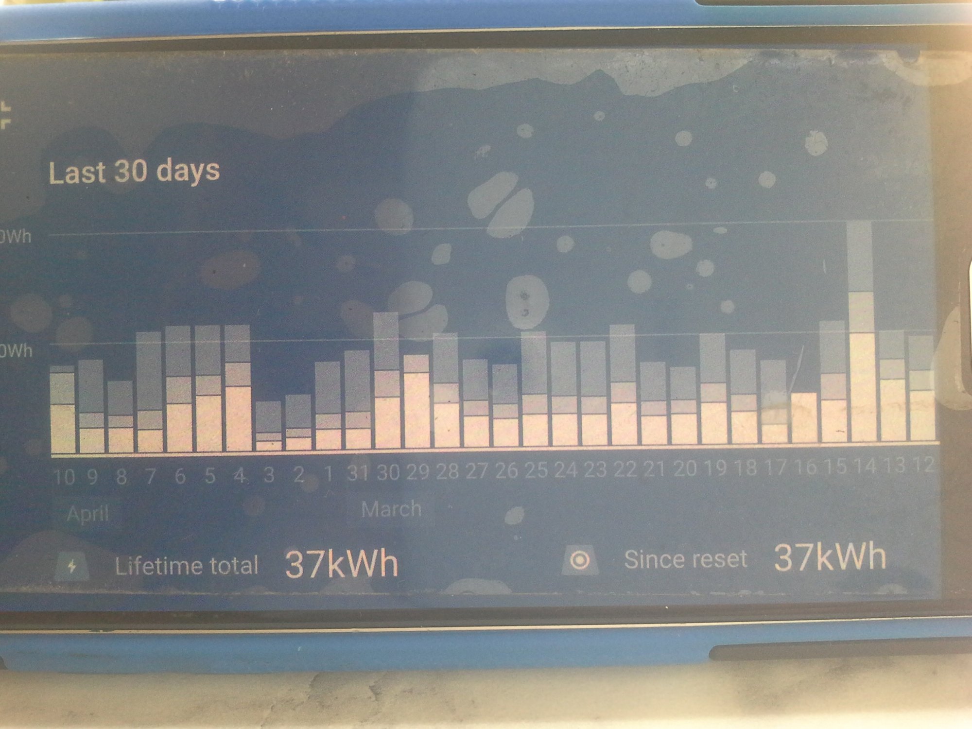

I turned it up to half way about a month ago to go to hereford and 200w solar wont fully charge battery its at about 80%so ill have to use b2b to fully charge
The pics have dates and watts used with fridge only apart fom time away.
