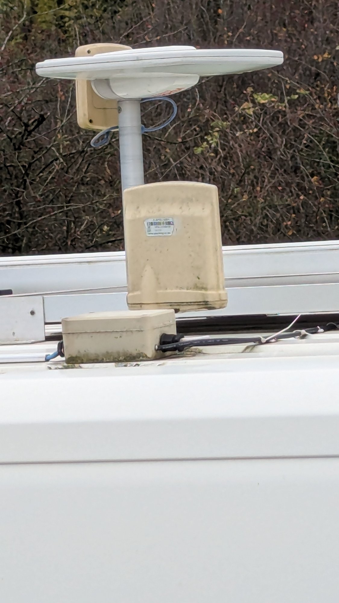

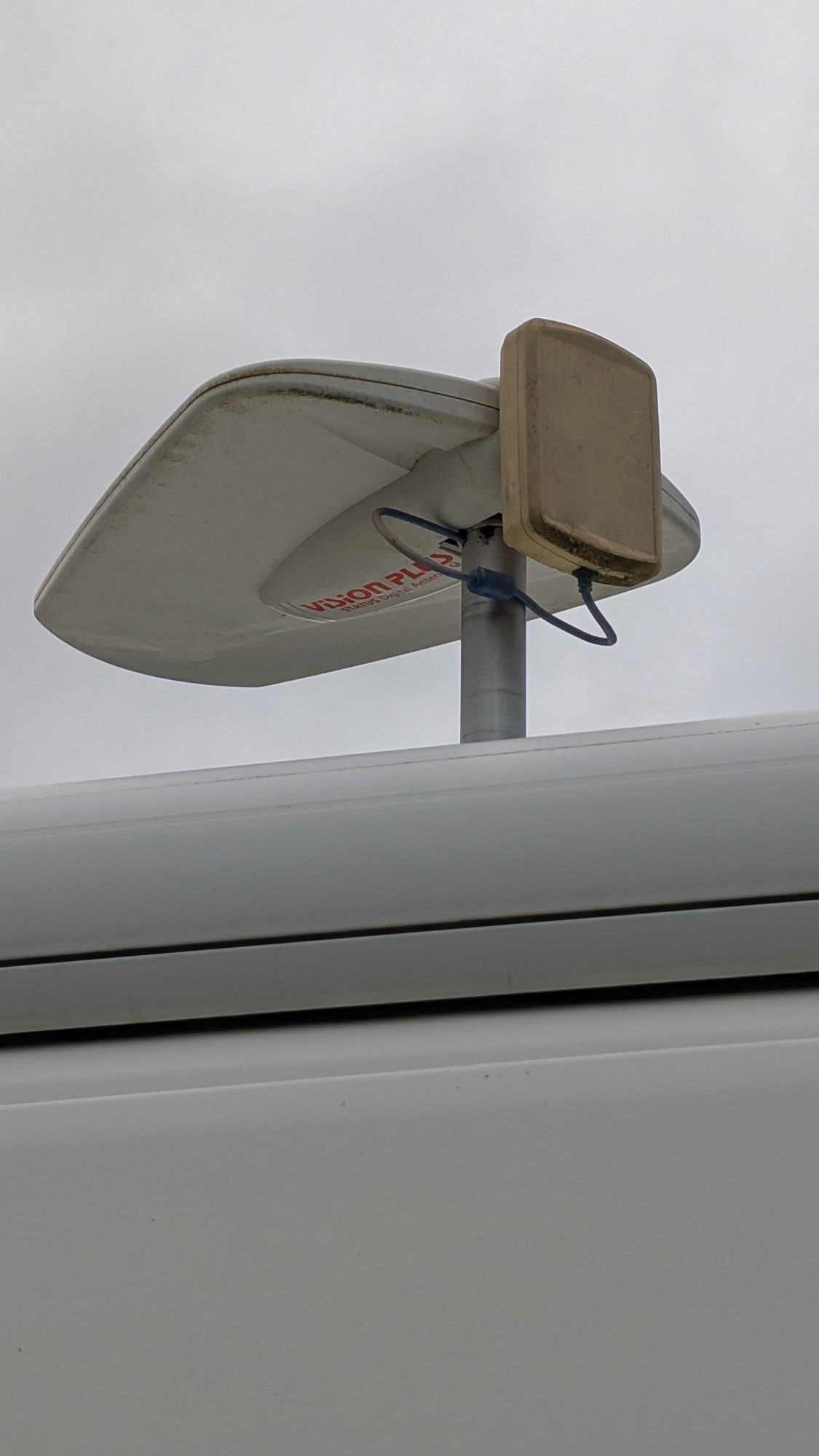

Can you mount your WiFi antenna to the vision plus antenna? This is what I did and then fed the WiFi cable down the vision plus pole along with the TV coax cable.Good evening friends. I'm in the process of transferring our WiFi set up from our campervan to our "new to us" motorhome. I don't want to drill any holes in the roof so I'm thinking of doing away with the current vision plus aerial, but using the pole to mount our WiFi aerial to, the feeding the twin WiFi cables down the existing pole. I would like to have some sort of TV aerial still and have read on a forum that someone had used a stubby magnet mount TV aerial and got good signal from it on a non metal motorhome roof, but obviously couldn't mount it permanently to the motorhome roof. My plan would be to use 3m vhb tape and Sikaflex to secure the magnet mount to the roof permanently then feed the cable along with the WiFi aerial cables down the vision plus mast. I'd then plug the mag mount TV aerial cable into the vision plus amplifier, then to the TV. Has anyone done this? What are everyone's thoughts?

Merl can you still set your tv aerial up for local transmitters in the vertical mode, and does that affect the wifi.Can you mount your WiFi antenna to the vision plus antenna? This is what I did and then fed the WiFi cable down the vision plus pole along with the TV coax cable.
When I fitted my 4G antenna I changed the solar roof gland for a large weatherproof box and fixed the antenna to that and then routed the antenna cables through the same roof hole as the solar.

Yep, it's still 'spinable' for vertically polarised TV transitions Bill.Merl can you still set your tv aerial up for local transmitters in the vertical mode, and does that affect the wifi.
