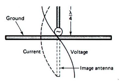

The idea of a magmount is so the metal roof works as a ground plain, on f glass this does not happen unless you open the roof and glue tin foil underneath.
However some dont require a ground plain as the reflection of the q wave is built in, so be carfull on what yoyu buy or install.
However some dont require a ground plain as the reflection of the q wave is built in, so be carfull on what yoyu buy or install.View attachment 147130

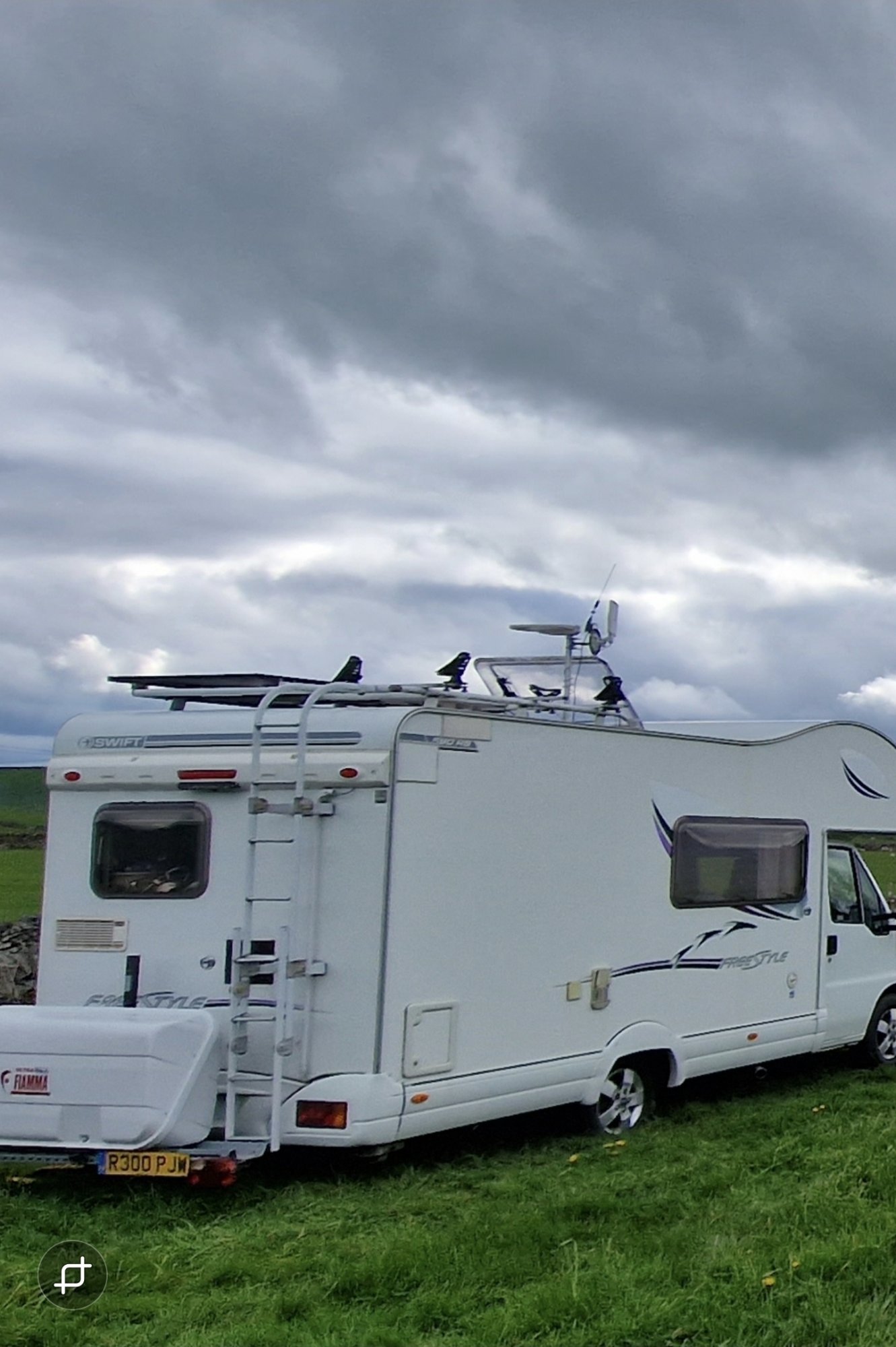

I just left the TV aerial there (works fine and gives a metre or so extra loft...)
Xpol antenna was mounted to it....
Now our 3 network 5g receiver has replaced that.
