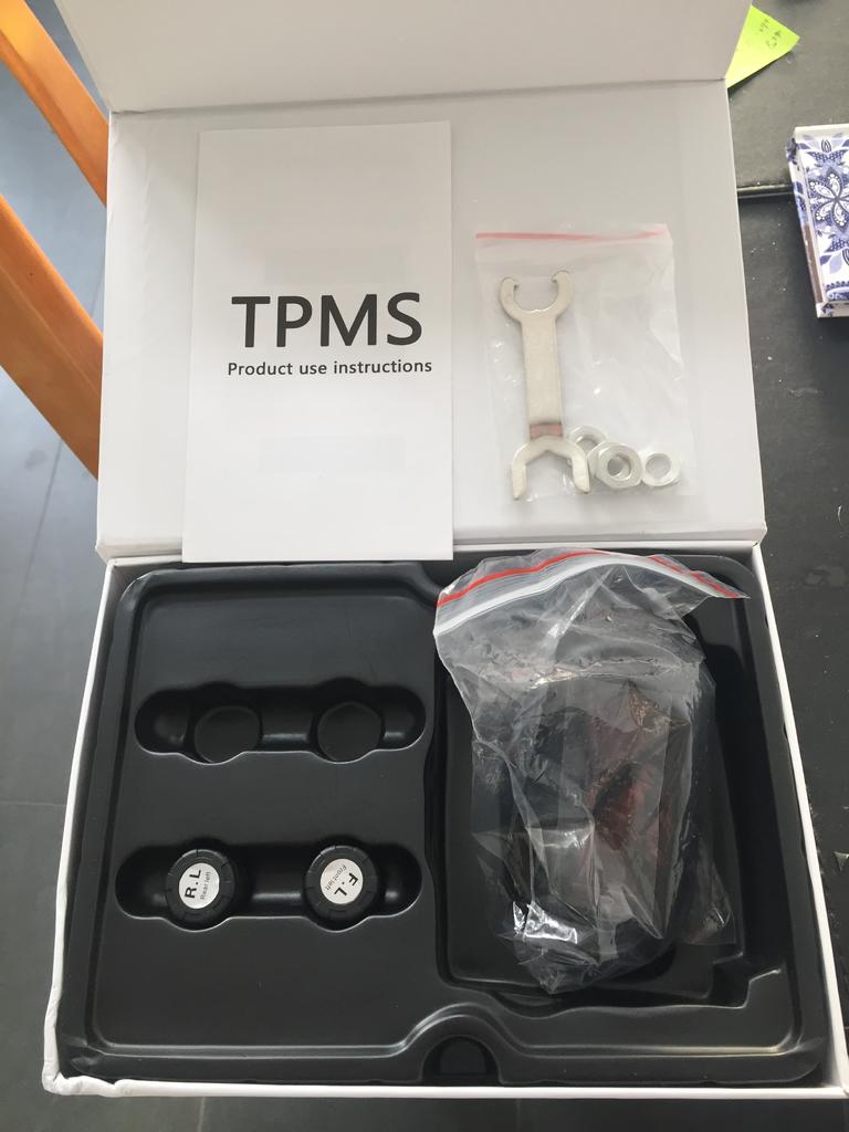

Just installed the system and it was so simple and it works a treat.
I checked my tyre pressures before installing the system and it’s accurate.
You only have two buttons to set up your preferences re bars or psi, and Fahrenheit or centigrade, and your parameters for pressure and temperature warnings.
I was unsure what temperature to receive warnings at I set it to 65c (advice would be welcome on that one)
I set the minimum pressure warning to 68psi and the max to 82psi.
I don’t think you get a warning when the batteries are running low, but at £2.15 for ten on eBay I will simply do so every year. Word of warning getting into the batteries is difficult. I had to resort to using mole grips on the sensor case whilst using the supplied tool to loosen the inners.
Batteries come fitted but no usb to micro usb for recharging the solar powered display if required.
I purchased a 3m lead on eBay for £2.10

Did you get any instructions as mine didn’t have any?One of the sensors isn’t registering and I was wondering how to reset it?
Here's the manual

FWIW, I scanned the instructions for the TPMS that I bought (i.e. the one in the opening post) and zipped them up. It's a large file (about 22MB) and I've made it available on Dropbox here. HTH, Geoff
Sorry just saw your pm.
Yes I did get instructions but they are very basic.
I have taken these photos for you, but I can send better quality images via email if you wish to pm me your email address.
Or send me your address and I will print them up and post them to you.
But I would contact the supplier.
