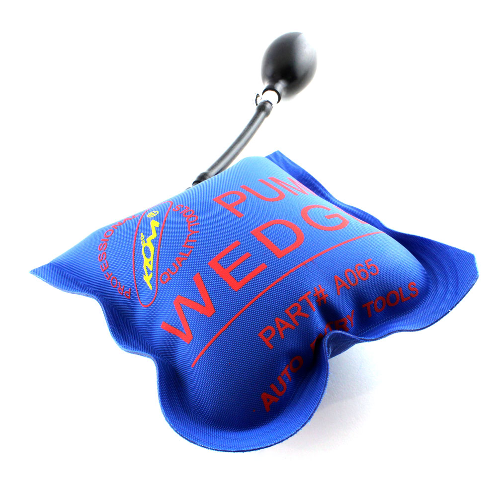

I am thinking not so much of lifting capacity but physical size - they tend to be ballon shaped? and also distort width wise to a degree with the weight on top. I'm just picturing a big fat ballon all pushed out while lifting the panel up a bit
Small Inflatable Air Wedge - open doors, windows, raise heavy objects and furniture
A small sized car air wedge. Increase your access to car locking systems within doors etc.www.ukbumpkeys.com
That should lift a panel about 3-4 inches from flat....
Designed for holding car door tops, open to be, able to get a slim tool in to open it.
I wasn't being negative....Depends how close you put it to the pivot point. Depends on its orientation.

I've used them for years... And they won't give you enough lift.
IF you sited them at the hinge point they would split the hinges/damage the panels before they lifted the panel.
