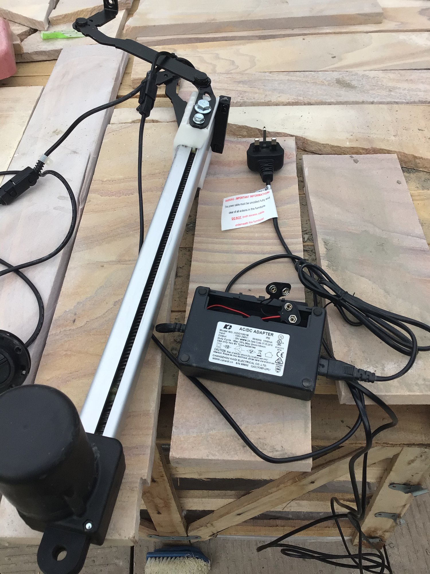

Watched a couple of youtube's. Got to agree with Exwindsurfer, my panels sit to close to the van for an actuator to work. Unless you know better.i have posted a picture of the mechanism under another thread ‘electric winding mechanism’ it has a pair of hinged View attachment 95876cranked levers on the end to turn lateral movement into vertical
Easy to solve, fit a link arm at 45d up at base of panel at one edge leaning in to panel, then a ram mounted at base but tilting arm up to bracket, when the ram runs it will push arm and lift panel, the arm will now be 45% the other way with panel now 45% up.Watched a couple of youtube's. Got to agree with Exwindsurfer, my panels sit to close to the van for an actuator to work. Unless you know better.

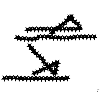

There is a fault in your hypothesis Trev. Dammed if I can see it though.Easy to solve, fit a link arm at 45d up at base of panel at one edge leaning in to panel, then a ram mounted at base but tilting arm up to bracket, when the ram runs it will push arm and lift panel, the arm will now be 45% the other way with panel now 45% up.View attachment 95944
