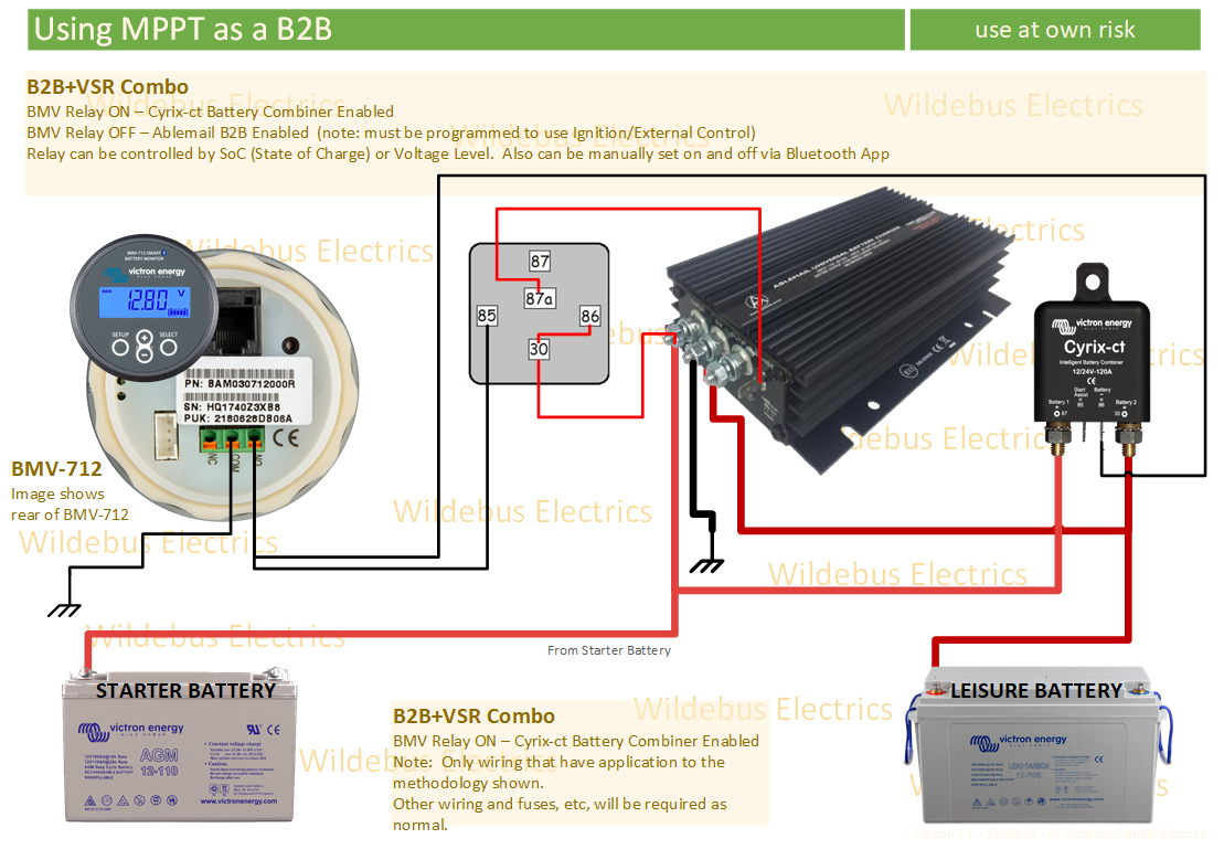

I will append my current Victron diagram to suit the Ablemail and post it :) . FWIW, the same design will, I think, also work with the Redarc BCDC Controller.
As an aside, I think I have found why the 60A model didn't run at full speed always ... the OFF-Voltage was set a bit too high to suit my aged Alternator. After making an adjustment, it is working much more as expected :)
I see a circuit diagram coming 😁.
Here you go ....
This involves an little extra relay compared to the Victron. But this does add a little extra flexibility as well. On the BMV, you have a built in relay with an NO (Normally Open) and a NC (Normally Connected) output. If your control device only has a simple on/off (open/closed) rather then this dual output, then an extra relay would be needed anyway.
In the wiring above I have shown it as it could be used by the CCGX as well as the Venus GX or BMV (the CCGX only has a NO output).
When the Relays NO is open (relay off), the output (which would otherwise would 0ve) is open, so the VSR cannot operate, and the extra relay is off. This means pin 30 and pin 87a are connected and the B2B is allowed to operate.
When the Relays NO is closed (relay on), the output is 0ve, the VSR has its ground so can operate, and the extra relay is also on. This means Pin 30 is connected to Pin 87 and Pin 87a is open - meaning the Voltage sense connection to the B2B is floating and the B2B cannot operate.
(I could use the Relays NC connection and use Pin 87 instead of 87a instead if using the BMV or a Venus GX, but there is actually an advantage to not doing so - using NO only and Pin 87a means that the relay is typically off and not drawing any power when the control switch/Relay is off. A tiny saving power, but still a saving :) )

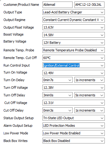

For the Ablemail, you need to chose a specific setting in the Ablemail AMC 30-12-12 (highlighted below within the various selections - the Run Control Input setting).
