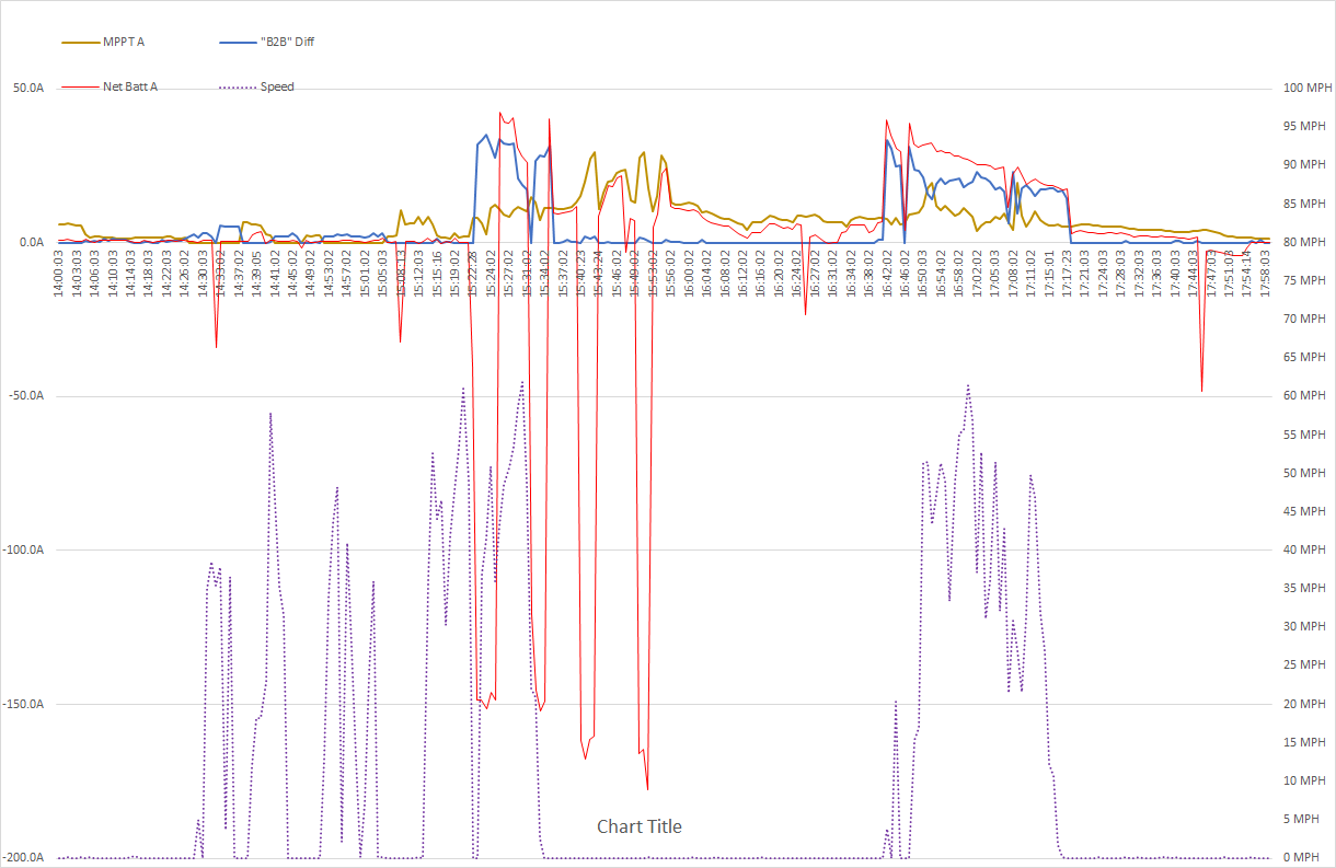

I went out in the van yesterday, and the new Victron B2B was used for the first time "in anger". It was also a reatively sunny day so the Solar was doing its thing as well.
I tried my best to plot the charging from the MPPT and from the B2B against what the overall system was doing and this is shown below.
I also turned on the water heater (a 2000W load) to get some demand going - you can see that load with the big negative spikes in the graph, and how the B2B and MPPT respond to that demand on the battery system.
I've also added the vehicle speed to the chart (you can then see the period when the engine would have been stopped as in the shops so the B2B would be inactive)
Nice to see some data David. Solar peaking at a little over 25 Amps?
Do you think there was any gain in State Of Charge? Just wondering if you can heat your water and at the end of the days drive and have a 100% SOC and a tank of hot water. That one of my ambitions (while doing only about 150 miles/day).
Time to buy shunt, put in the B2B +ve line and log even more data :)

I started the drive (after 15:00) at full 100% SOC, and by 17:30 was back to 100% with a full hot tank of water (my tank is only 10 Litres, mind).
Total distance driven? maybe 40 miles
Solar yesterday peaked at 401W and 29.4 Amps. I am curious what the current will actually max out to on the 100/30A Controller. If I am setting 29.4A at a peak of 401W, and the controller is rated at 440W, 30A max current means a very high voltage 14.66V to achieve that power rating (My controller is set to 14.2V Absorption).
Definately getting some good combination charging - hitting over 40A with the pair when the heater was on (if the Cyrix ct was live rather than the B2B it would likely have been better. Could have maybe set it up so when the heater is actually running, the Cyrix kicks in (that is a potential option in the Venus OS setup - relay can be set to go on if the current load exceeds a certain level)

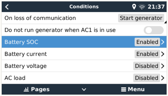

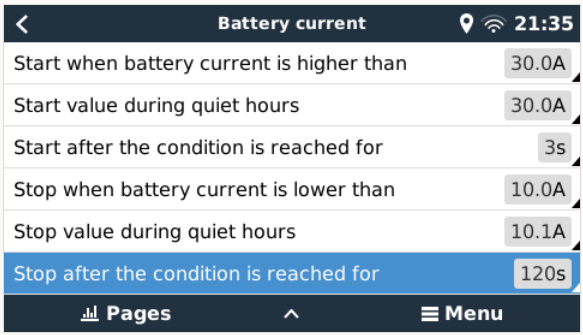

First a "heads up" on naming .... I am using the "Generator" selection in the Venus configuration, where the Generator in my case will actually be the Cyrix ct-230A Battery Combiner (aka VSR in essence).
Went into the settings for Battery Current and set it up for the VSR to be enabled when the current goes over 30A for over 3s (set it for 3 seconds as I can hit that for upto 2 seconds when the Fridge kicks on).
The VSR will turn off once the current goes below 10A for 2 minutes (I have the water heater set to cycle on and off. The off cycle is less than 2 minutes (I think?) so this means when using the heater, the VSR will stay on while the water heater is in its general heating mode.

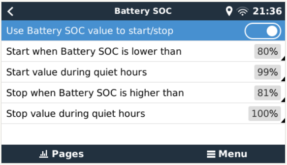

The Battery State of Charge control I did tweak a bit after initially doing the test
I setup "Quiet Hours". Usually used to avoid the generator coming on in the middle of night, but I have it set up for a very high 99% SOC Start, and a quiet time of 7AM to 8AM.
The Fridge will have come on a few times overnight and by 7AM, the Battery SOC will have dropped below 99%. This means the VSR will turn on if the solar is providing charge, and the result will actually be some Starter Battery maintenance for upto 1 hour a day.
And finally, you can chose multiple causes of activation of the relay, so not stuck with a one or other only
Quite pleased with this setup :) The system will use the VSR when the battery needs bulk charging; switches to B2B when the charging needs to be at a higher voltage and more controlled at a higher battery SOC level; but when there is a high demand (water heater in this case), the VSR will kick in automatically to help deliver the high current demand (y)

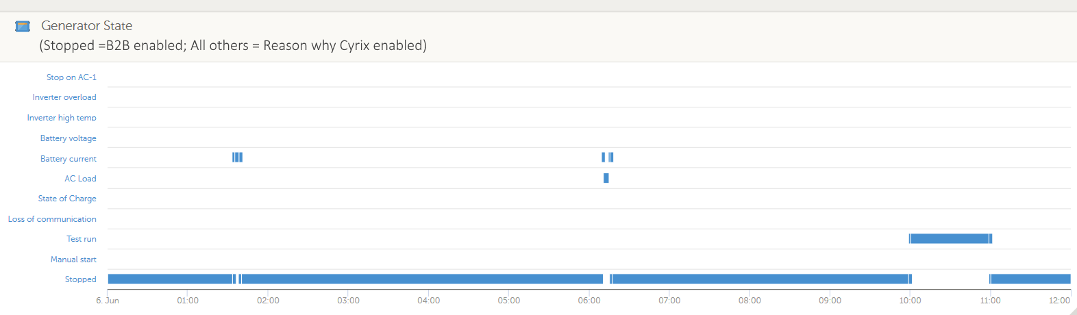

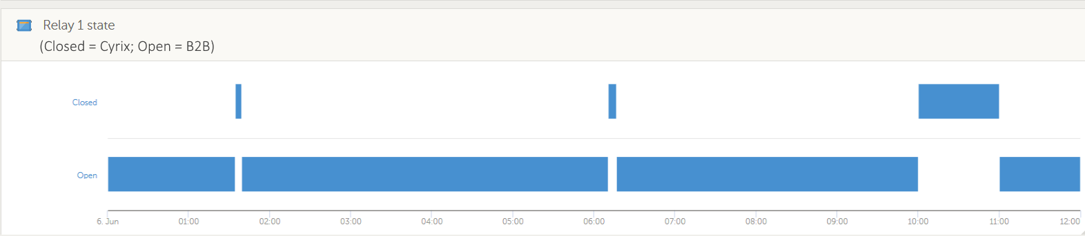

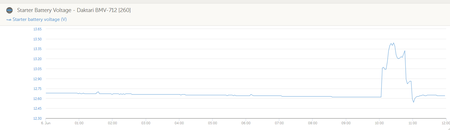

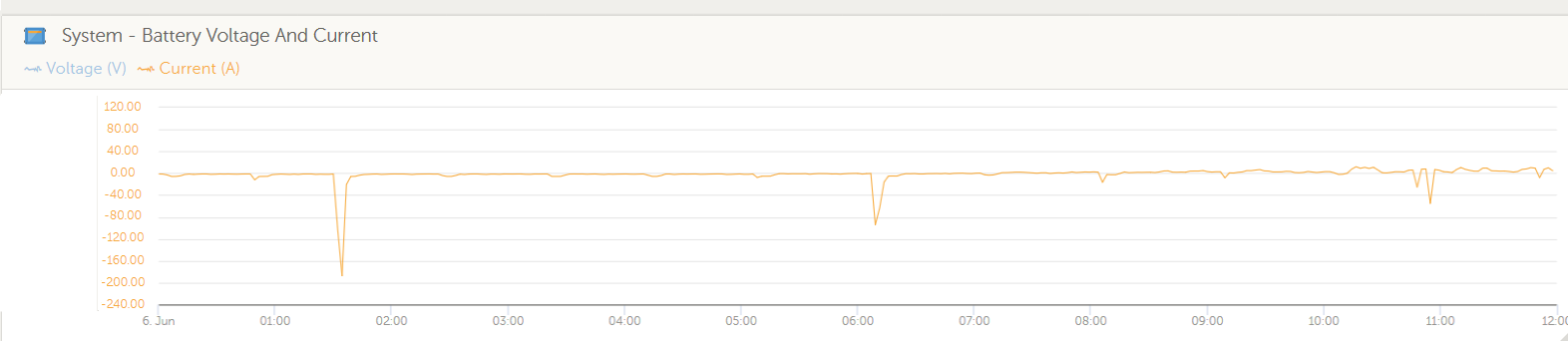

So the graphing. I've done this as four images so it should be visible on a smaller screen still, but is best viewed as each directly under the one above to line up the timeline.
You see the dips where the heater comes on (Graph #1 - Battery Current). Graph #2 - Relay State shows the relay closes at those times, as well as for a longer period between 10:00 and 11:00.
Graph #3 - Generator State shows the reason for the relay being closed and Graph #4 - Starter Battery Voltage shows the effect on the Relay Closing (so enabling the Cyrix VSR) on the Starter Battery
In the example above, the relay closing due to the heater going on and thus enabling the VSR actually made no difference. This is important as the vehicle was stationary and the engine not running. This means the voltage levels are too low for the Cyrix/VSR to actually turn on and so no power taken from the Starter Battery. If however the engine WAS running, the vehicle side (battery& alternator) would contribute to the demand.
At 10:00, the Relay turns on (the reasoon is show in Graph #3 is "Test Run"), and this enables the Cyrix/VSR, allowing it to work IF the voltage levels are high enough. Because the solar was working at that time and putting in a charge, the battery voltage had risen enough to turn on the Cyrix/VSR and so the the Starter Battery gets connected to the Leisure Battery and a charge starts to go in - but just for an hour until the relay in the Venus GX times out, disabling the Cyrix/VSR unit and forcing a disconnect despite the Leisure Battery Voltage being still at a high level.
