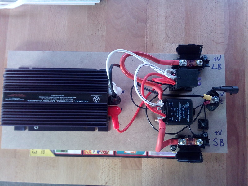

Rather than spending £600 to test the CTEK, I thought I would build my own version of their D250SA+SmartPass to see how effective it will be in reality (There are no widely promoted equivalents of the 250SA+SmartPass as CTEK have somehow managed to get a Patent on the concept).
This is my combined 30A B2B +120A Relay (actually a Victron Battery Combiner) - so should beat the CTEK 20A B2B + 100A Relay in performance as well.
B2B+VSR
by David, on Flickr
The CTEK switches between the two using the battery voltage state. I am using a more precise Battery State of Charge to perform the switch.

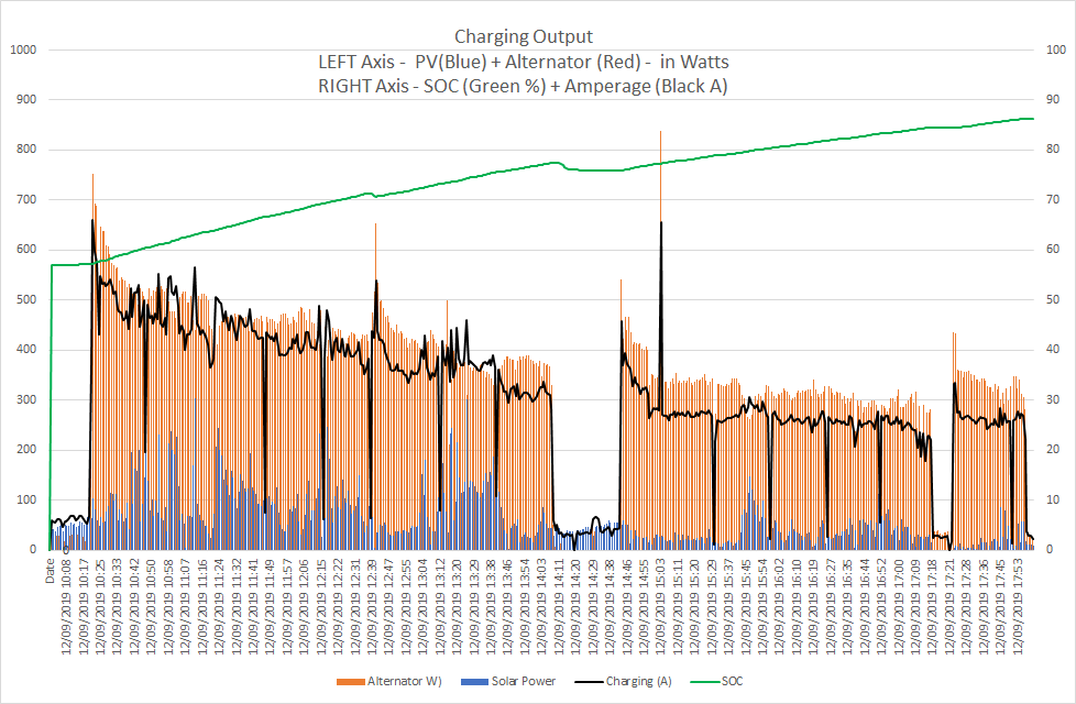

How did it do?
This graph shows a fairly long journey from 10:30AM to 6PM with a lunch stop of around 30 minutes.
The Leisure Battery Bank was at around 57% SOC at the start of the journey. I was getting charge from both Alternator and Solar.
Because of the way the data is sampled, there are apparent dips and a few spikes on the black line - that is an effect of the fridge compressor in-rush and should be ignored.
This shows the battery was getting over 30A effective charge until the battery was at around 78% SOC, so more than the B2B could put out. However it hardly went over 50A for any length of time.
Also bear in mind that Lead Acid Batteries had recommended charge rates that are very rarely over C/4 (i.e. Maximum Charge Current of 25% or 25A into a 100Ah battery) and often only C/5 or even C/10 (10A per 100A of Battery), so you would have to have a very big and well discharged Battery Bank to be even close to the 100A Smart-Pass (or 120A Relay in my case).
The other aspect is the Alternator Performance - can your alternator deliver such high current for a continuous period?

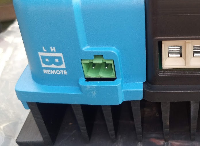

Now what is a little different about this unit (apart from Bluetooth- the obvious bit) is that like many of other Victrons products, it has a Remote Control feature. It doesn't mean you can get BBC1 on it, but it does mean you can incorporate a control level that can be harder to do with other makes.
Previously, my B2B-VSR Combo test rig used both high and low power relays to direct the charging +12V to the right device. This worked, but was a bit messy and the extra relays and connections added in extra losses ...
With the Orion-Tr, it is possible to control if the unit goes on by applying certain voltage levels to one or other of the remote input plug
essentially you use a -Ve signal on the L pin or a +Ve signal on the H pin, so a nice degree of flexibility and choice there.
I used the "L" pin option, which meant that if there was a -Ve signal present, the Charger is allowed to operate, but if there was no -Ve signal (i.e. floating), the Charger is disabled.
Whilst not specifically a control signal, a Relay (any relay) requires a ground connection so it is possible to use the same principle, i.e. to have a relay disabled when the -Ve is floating and allowed to work as normal when the -Ve is present.
So we have both the B2B and the Battery Combiner (aka VSR) both able to be disabled and enabled in the same way - a -Ve control signal.

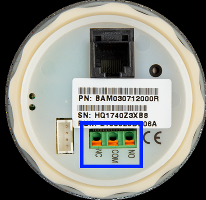

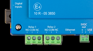

I am using the Relay 1 on the Victron Venus GX to provide this control signal
The connections to Relay 1 are NO, COM & NC - NO = Normally Open, COM = Common and NC = Normally Closed.
By connecting the COM to -Ve (i.e. Ground), the Relay will either relay that -Ve to NO when the Relay is on, or to NC when the Relay is off.
I can then connect the NO output to the VSR and the NC output to the B2B, and depending on the state of the Relay, either one or other will be allowed to operate, but never both and never neither at the same time
For my setup, I am using the Venus GX, but the identical setup can be achieved with the Victron BMV-712 Battery Monitor, as it has a relay with the same NC, COM & NO connections - Here is a picture of the rear of the BMV-712 to show this.
Word of note: These relay type is not present on all Victron Monitoring devices. None of the other Victron BMVs (including the Smart Shunt) have a relay feature. The SmartShunt does not have a relay. The other Victron BMVs, plus the Colour Control GX (CCGX) have a relay, but it only has the NO and COM connections, so to add in the NC function, an additional 5-pin control relay will be required (a simple thing to do, but one to be aware of).

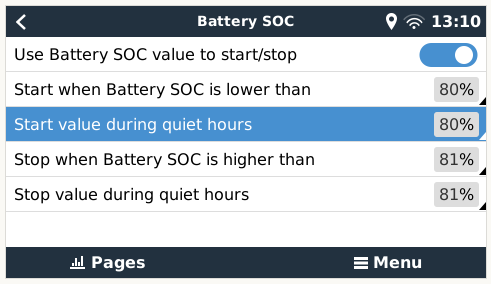

Next Stage was setting up the relay. Not going to go into great detail on this but basically you can configure the GX devices and and BMV-712 to have the relay go on and off depending on what the battery voltage is or what the Battery State of Charge is. I use the State of Charge (SOC) and have the relay come on when the SOC is below 80% and off when above 81%
So when SOC is below 80%, the relay switches on, the COM and NO get connected together and the connection to the VSR ground terminal is now -Ve. Because the NO Relay output is now not connected and floating, the B2B (connected to NO) is disabled.
As soon as the SOC goes above 81%, the relay turns off, whch means the COM and NC are connected. Now the -Ve to the VSR is floating so that cannot operate and the signal to the B2B "L" remote input is -Ve, whuich means the B2B can operate as normal.
Step 3 is now done and that is actually the last step (y) You have a SOC controlled B2B + VSR combo that will allow as much charge as the battery bank can accept to come into it at lower state of charge levels, only limited by what the alternator will provide (and if it is more than the 120A of the Cyrix -ct 120A, you could use a bigger VSR, such as the Cyrix ct-230A), and when the battery is at a greater state of charge, the system will switch to the B2B Smart Charger to provide a probably higher voltage and a proper charging profile.

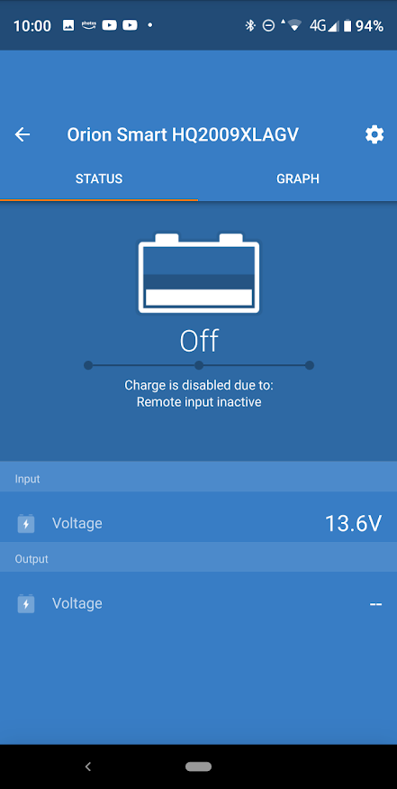

First, the SOC of the Battery is below 80%. This means the relay is OFF, and therefore the B2B is disabled and the VSR is enabled (remember, it is always one OR other enabled)
You will see that the input Voltage is pretty high at 13.6V? That is because the VSR is on as the Solar is active, triggering the VSR to come on, and so the starter battery is getting a charge as well.

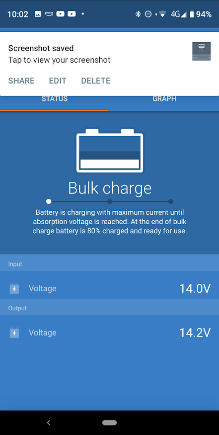

I start the engine next
Despite the starter battery rising to 14.2V from the Alternator running, the B2B is still disabled as the SOC is too low to enable it (at lower SOCs, we want more current in so want the VSR to be used)

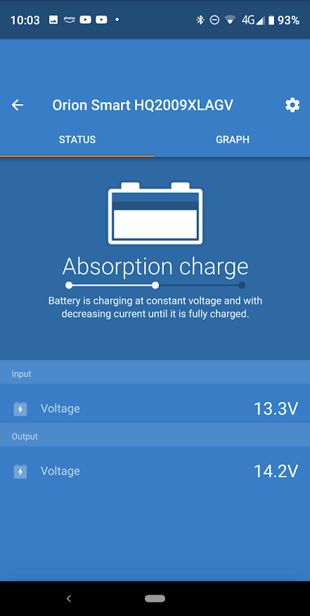

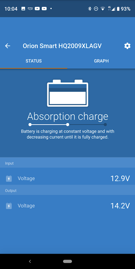

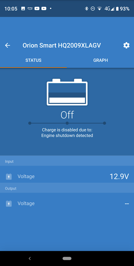

I then turn the engine off. The B2B does not turn off instantly as it is a Voltage controlled device so it will stay on until the starter battery voltage drops down to whatever has been configured as the "charger off" value.
Going .... Going ... Gone!
So once the input (starter) voltage is below that value, the B2B is disabled due to the engine shutdown but will come on again automatically when the engine starts up again as long as the Leisure Battery SOC is above 81% - if below, then the VSR comes back into play instead.

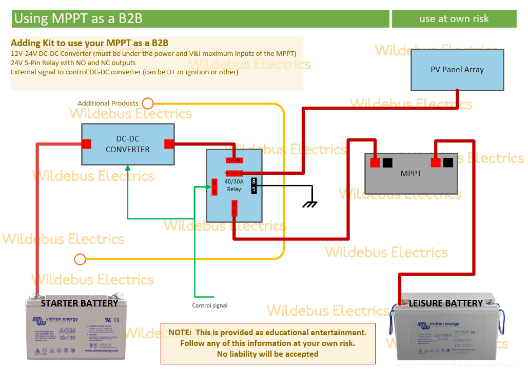

Orion-tr 12V-24V DC-DC converters, connect the output to your existing MPPT Controller and then you would have a B2B setup with little additional expense (you would also. Need to have a relay to switch the MPPT between the PV panels and the Orion-tr, but that is easy enough and can be controlled by the same signal that turns the Orion-tr on and off.
That's an interesting and clever idea. I would need a wiring diagram for that though I think.
Don't think that's just me !! Their naming standards are crazy
that was a "royal" we :)
If you wanted to look at using a DC-DC converter for B2B, this is one way to take advantage of existing kit (but note the disclaimer at the bottom! (again a "royal" note;) )
