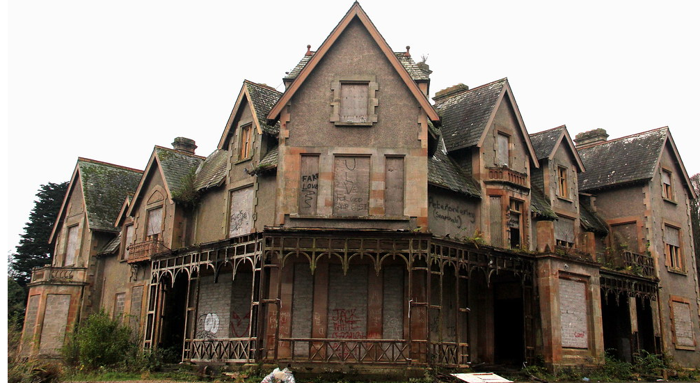

My daughter (her and her family live with us) want me to buy this Trev (see the link) she even said that they would take out a mortgage to help buy it.
Thats a lot of property Darn Sarf for £650k Rob! Looks cracking. Plenty of space for motorhomes and bikes! :D You should move up here though! We could tear up those mountain passes all day long, get shitfaced after and live happily ever after! :ROFLMAO:
I am considering it Barry. It needs a lot of modernising but it's liveable and loads of room for a boat on a trailer which I could launch at a slipway just down the road. It is listed though so I reckon any repairs would be expensive in the future.
It's a million+ house though really so there must be a reason why it's so cheap. I reckon it will get snapped up by a developer and then mysteriously burn down.
