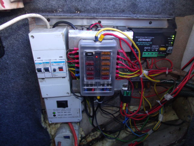

After reading and listening to wildebus i had to do a complete rebuild of electrics, numax charger is behind the fuse box.

My solar reg does both, one amp to starter, my on board 10ah numax will also charge starter and hab with a switch and 200ah relay running through battery cable, this gives me the advantage of starting the engine using all batteries if required.
