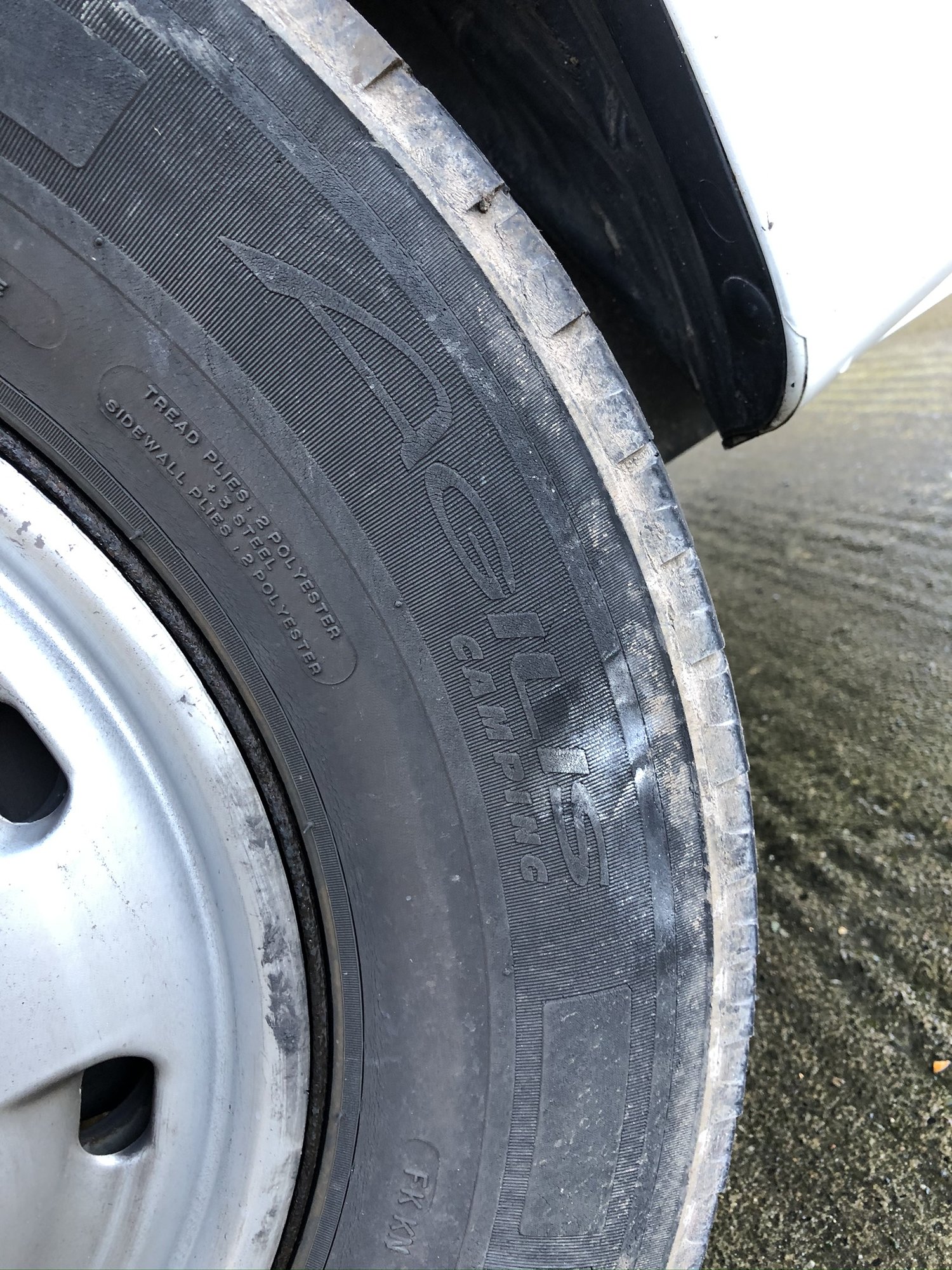

Right I've checked the pressure ratings on my tyres - the van tyres have max capacity at 75 psi and Camping at 80 psi.
But the listed plies in sidewall and tread are the same!
225-75-16C is 10 Ply Rating - presumably this is what allows 75 psi.
We are rapidly coming to the conclusion that there is something different about the Michelin Camping tyre as its max pressure rating is markedly higher than standard tyres.

By "stiffened" sidewall I would think that that means extra reinforcement to be able to take the higher maximum pressure specified.
The rubber of the tyre being basically a bladder, it gets its shape and structure and strength from the strength of, and way that, the plies are laid up inside. And the higher the pressure inside the stiffer it becomes.
I suspect that say a van tyre running at 65 psi would be similarly "stiff" to a camper tyre run at 65 psi, rather than 85.
85 is 30% higher than 65, so the tyre must surely be significantly more strongly built to withstand this, when you consider the overall pressure on the total area of the sidewall it is enormous. All held in by just two windings of polyester strands in the ones in the picture above. Perhaps those plies are much stronger ones, or more tightly wound ?
