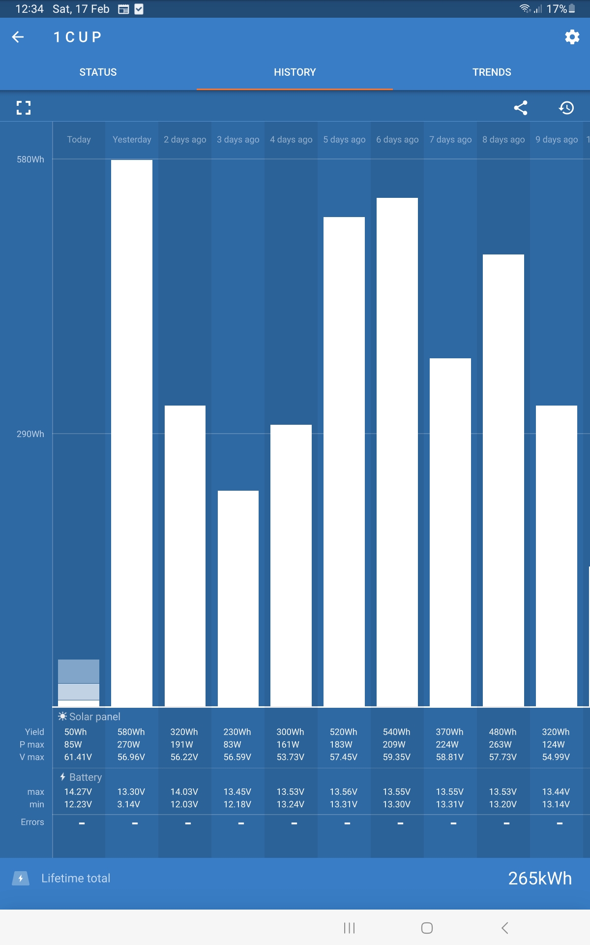

Van stay put in the sun mppt worked 500w lol

Am I reading that right, you harvested almost 1200Wh of solar plus driving most days? How much power have you used in that time as you have a lot of lifepo4 don’t you(500Ah ish)?
