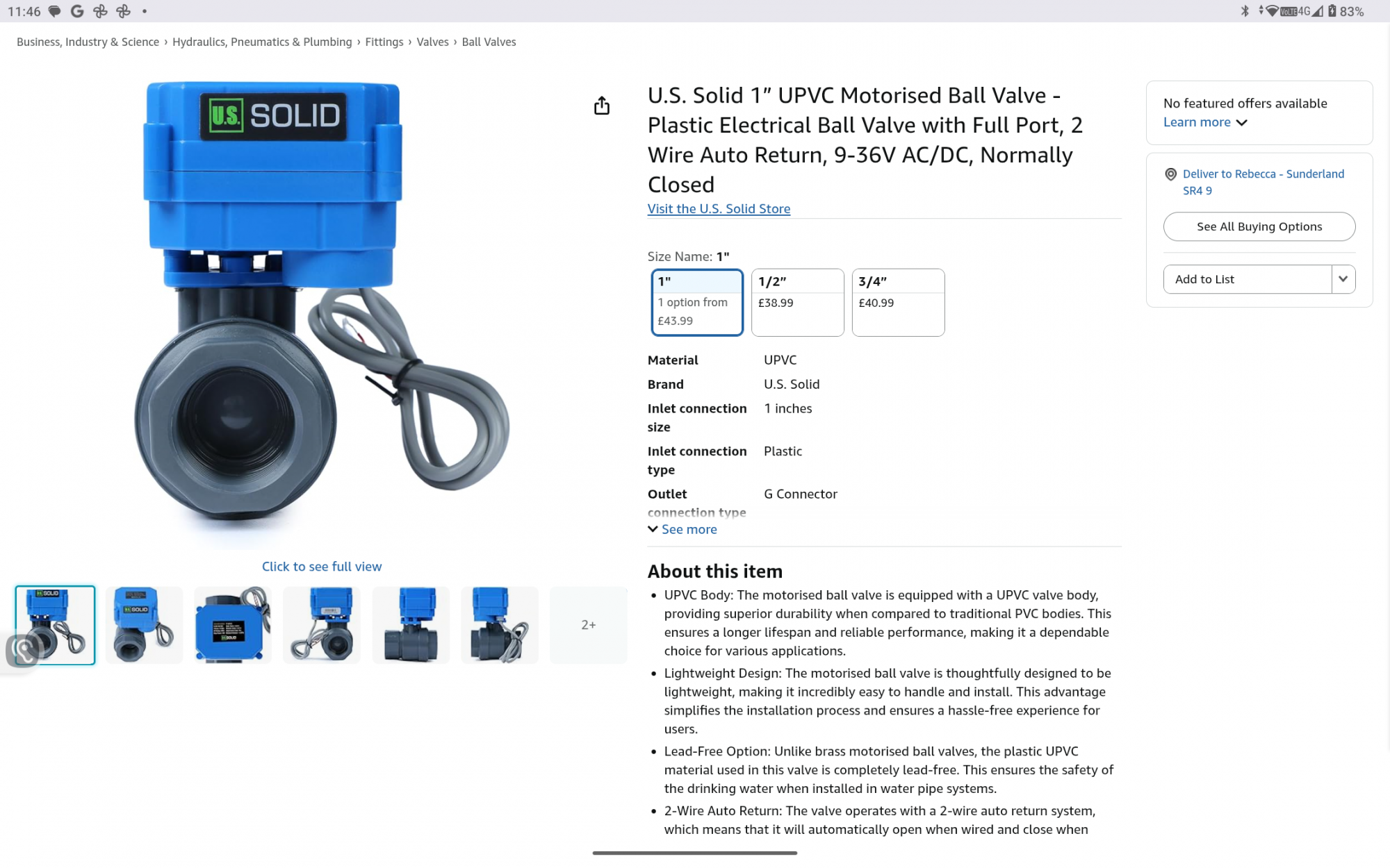

I had problem's be with my fresh water valve being stiff to open so I fitted this electric valve one flick of the switch and it’s empty no crawling around on the ground jobs a good un

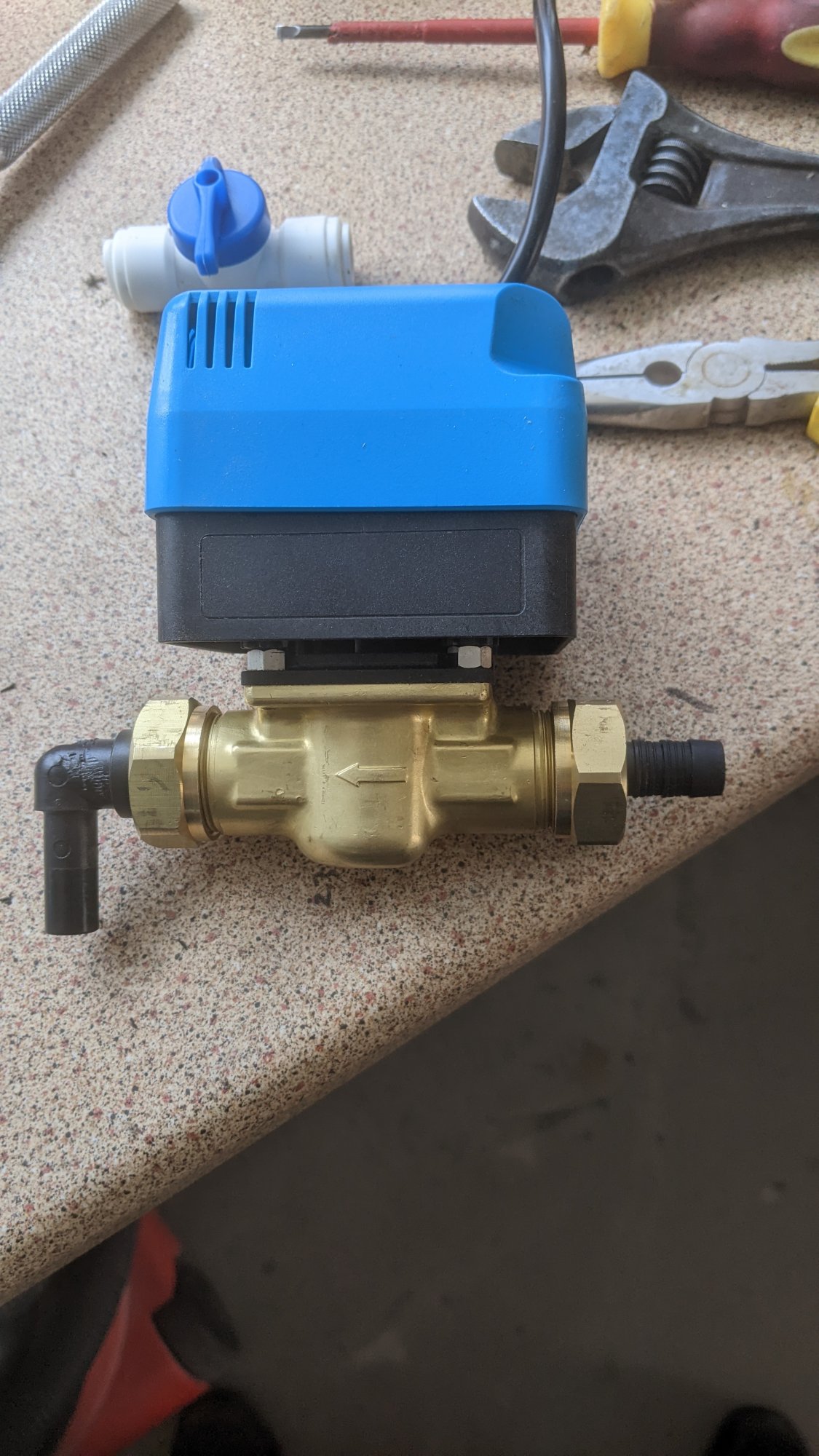

I did the same with my water tank dump valve Jeff, my tank is inboard and the manual valve was a right pain to get to so I mackled a 22mm central heating zone valve to do the job. It needs 240v to work it so I have to plug it in but there's no problem with accidentally dumping all our drinking water if a 12v switch gets accidentally switched on😡
Mine is 12v Merl and I have on occasion forgot to close it while filling up lolol
