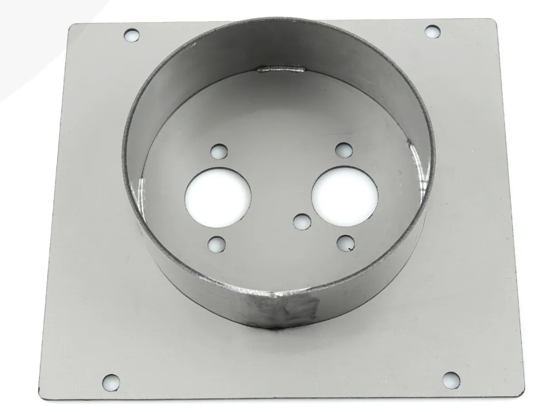

Still not safe for use in enclosed spaces IMHO as doing so can leave the exhaust connection with the possibility to leak ...On temu,getting cheaper by the day.View attachment 137824View attachment 137825

Other than that ....
Hole in floor for the turret and some care routing exhaust etc
