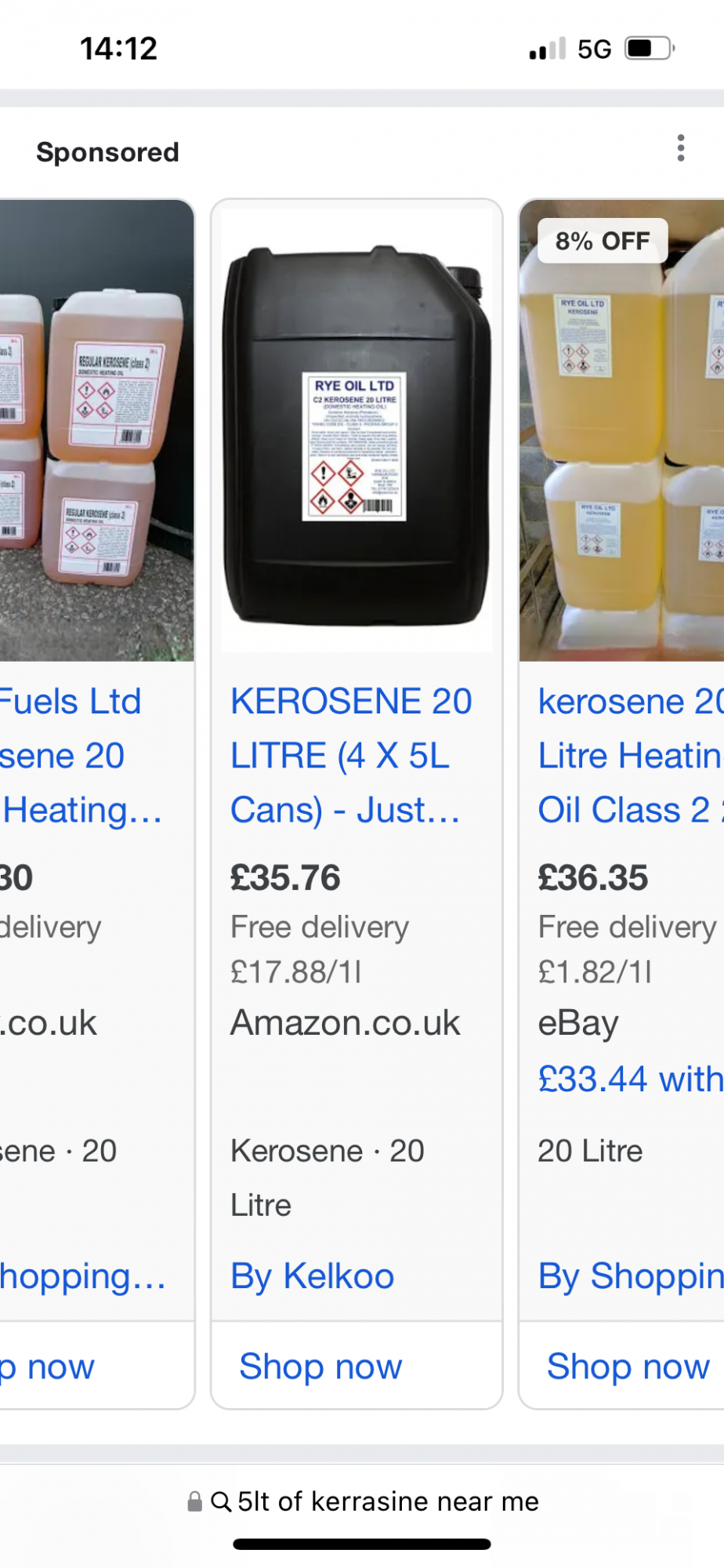

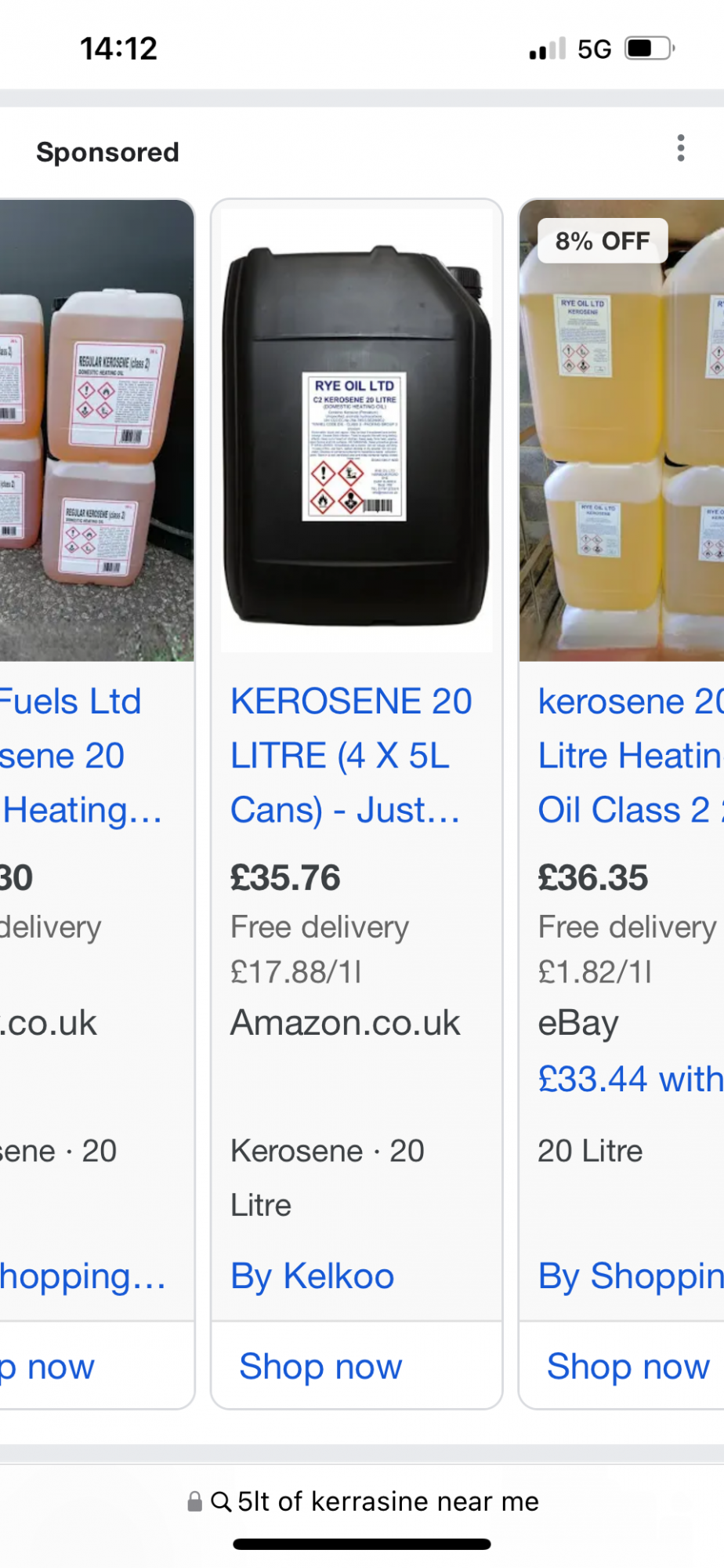

ALTHOUGH I just checked the price of Kerosene near me AND on Amazon & it’s MUCH mor expensive than Diesel in BOTH regards 😳.

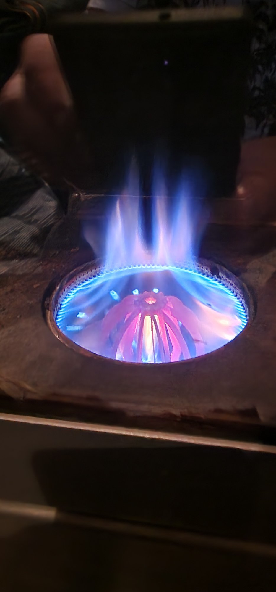

I have fitted one of the all in one units in a small conservatory that Caz uses as a smoking room. Its a 5Kw heater but room is only small so its only ever on low so far apart from start up.
Its using approx 0.1 litres per hour at that so 10 hours per litre
